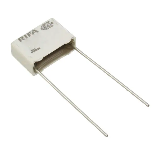

    薄膜电容 径向 2.2nF ±20% 18.00 x 5.50mm
PME295RB4220MR30 数据手册
AC Line EMI Suppression and RC Networks PME295, Metallized Impregnated Paper, Class Y1, 440 VAC/480 VAC Overview Applications The PME295 is constructed of multilayer metallized paper encapsulated and impregnated in self-extinguishing material, meeting the requirements of UL 94 V–0. Safety capacitors for bridging of double or reinforced insulation applications, requiring voltage testing up to 4,000 VAC at 60 seconds. PME295 capacitors can be left in place during this test. Benefits • Approvals: ENEC, UL, cUL, CQC • Rated voltage: 440 VAC/480 VAC 50/60 Hz • Capacitance range: 470 – 4,700 pF • Lead spacing: 15.0 mm • Capacitance tolerance: ±20% • Climatic category: 40/115/56/B, IEC 60068–1 • Tape & Reel packaging in accordance with IEC 60286–2 • RoHS Compliant and lead-free terminations • Operating temperature range of −40˚C to +115˚C • 100% screening factory test at 4,000 VAC, 50 Hz, 2 seconds Click image above for interactive 3D content Open PDF in Adobe Reader for full functionality Legacy Part Number System PME295 R B 3470 M R30 Series Rated Voltage (VAC) Lead Spacing (mm) Capacitance Code (pF) Capacitance Tolerance Packaging Y1, Metallized Paper R = 440 B = 15.0 The last three digits represent significant figures. The first digit specifies the total number of digits. M = ±20% See Ordering Options Table New KEMET Part Number System P 295 B E 471 M 440 A Capacitor Class Series Lead Spacing (mm) Size Code Capacitance Code (pF) Capacitance Tolerance Rated Voltage (VAC) Packaging Y1, Metallized Paper B = 15.0 See Dimension Table First two digits represent significant figures. Third digit specifies number of zeros. M = ±20% 440 = 440 P = Paper See Ordering Options Table One world. One KEMET © KEMET Electronics Corporation • KEMET Tower • One East Broward Boulevard Fort Lauderdale, FL 33301 USA • 954-766-2800 • www.kemet.com F3064_PME295_Y1_440-480 • 3/15/2019 1 Film Capacitors AC Line EMI Suppression and RC Networks – PME295, Metallized Impregnated Paper, Class Y1, 440 VAC/480 VAC Benefits cont'd • Highest possible safety regarding active and passive • High dV/dt capability flammability • Impregnated paper provides excellent stability and • Excellent self-healing properties ensure long life even when reliability properties, particularly in applications with subjected to frequent over voltages continuous operation • Good resistance to ionization due to impregnated dielectric Ordering Options Table Lead Spacing Nominal (mm) Type of Leads and Packaging Lead Length (mm) KEMET Lead and Packaging Code Legacy Lead and Packaging Code 6 +0/−1 30 +5/−0 C A R06 R30 H0 = 18.5 ±0.5 L R19T0 H0 = 18.5 ±0.5 XLTF1 R25X2 Standard Lead and Packaging Options Bulk (Bag) – Short leads Bulk (Bag) – Maximum length leads Tape & Reel (Standard reel Φ = 360 mm) Tape & Reel (Standard reel Φ = 360 mm) 15 Native 15 formed to 7.5 Dimensions – Millimeters FRONT VIEW SIDE VIEW L B H d 0.5 LL p p B H L d Nominal Tolerance Nominal Tolerance Nominal Tolerance Nominal Tolerance Nominal Tolerance 15 15 15 15 ±0.4 ±0.4 ±0.4 ±0.4 5.5 6.5 7.5 8.5 Maximum Maximum Maximum Maximum 12.5 12.5 14.5 16 Maximum Maximum Maximum Maximum 18 18 18 18 Maximum Maximum Maximum Maximum 0.8 0.8 0.8 0.8 ±0.05 ±0.05 ±0.05 ±0.05 Note: See Ordering Options Table for lead length (LL) options. © KEMET Electronics Corporation • KEMET Tower • One East Broward Boulevard Fort Lauderdale, FL 33301 USA • 954-766-2800 • www.kemet.com F3064_PME295_Y1_440-480 • 3/15/2019 2 Film Capacitors AC Line EMI Suppression and RC Networks – PME295, Metallized Impregnated Paper, Class Y1, 440 VAC/480 VAC Performance Characteristics Rated Voltage Capacitance Range Capacitance Tolerance Temperature Range Climatic Category Approvals 440 VAC 50/60 Hz (ENEC) 480 VAC 50/60 Hz (UL, cUL) 0.00047 – 0.0047 µF ±20% −40°C to +115°C 40/115/56/B ENEC, UL, cUL, CQC Maximum Values at +23°C Dissipation Factor Test Voltage Between Terminals 1 kHz 1.3% The 100% screening factory test is carried out at 4,000 VAC, 50 Hz, 2 seconds. The voltage level is selected to meet the requirements in applicable equipment standards. All electrical characteristics are checked after the test. Measured at 500 VDC after 60 seconds, +23°C Insulation Resistance Between Terminals: 12,000 MΩ In DC Applications Resonance Frequency Recommended voltage ≤ 1,500 VDC Tabulated self-resonance frequencies f0 refer to 5 mm lead length Suppression vs. Frequency, Typical Values dB Attenuation 70 60 50 4,700 pF 1,500 pF 470 pF 40 30 20 10 0 f 1 3 5 10 30 100 200 MHz © KEMET Electronics Corporation • KEMET Tower • One East Broward Boulevard Fort Lauderdale, FL 33301 USA • 954-766-2800 • www.kemet.com F3064_PME295_Y1_440-480 • 3/15/2019 3 Film Capacitors AC Line EMI Suppression and RC Networks – PME295, Metallized Impregnated Paper, Class Y1, 440 VAC/480 VAC Environmental Test Data Test IEC Publication Endurance IEC 60384-14 IEC 60068-2-6 Test Fc IEC 60068-2-29 Test Eb IEC 60068-2-14 Test Na Vibration Bump Change of Temperature Procedure 1.7 x VR Vac 50 Hz, once every hour increase to 1,000 VAC for 0.1 second, 1,000 hours at upper rated temperature. 3 directions at 2 hours each 10 – 500 Hz at 0.75 mm or 98 m/s2 4,000 bumps at 390 m/s2 Upper and lower rated temperature 5 cycles Passive Flammability IEC 60384-14 IEC 60384-1, IEC 60695-11-5 Needle flame test Humidity IEC 60068-2-3 Test Ca +40°C and 93% RH, 56 days Approvals Certification Body Mark Intertek Semko AB UL Specification File Number EN/IEC 60384–14 (440 VAC) SE/0140–13D UL 60384–14 CAN/CSA–E60384–14:09 CQC IEC 60384–14 E73869 CQC16001145221 Environmental Compliance All KEMET EMI capacitors are RoHS Compliant. © KEMET Electronics Corporation • KEMET Tower • One East Broward Boulevard Fort Lauderdale, FL 33301 USA • 954-766-2800 • www.kemet.com F3064_PME295_Y1_440-480 • 3/15/2019 4 Film Capacitors AC Line EMI Suppression and RC Networks – PME295, Metallized Impregnated Paper, Class Y1, 440 VAC/480 VAC Table 1 – Ratings & Part Number Reference Maximum Dimensions in mm B H L Lead Spacing (p) 0.00047 0.00056 0.00068 0.00082 0.001 0.0012 0.0015 0.0018 0.0022 0.0025 0.0027 0.0033 0.0039 0.0047 5.5 5.5 5.5 5.5 5.5 6.5 6.5 6.5 6.5 7.5 7.5 7.5 8.5 8.5 12.5 12.5 12.5 12.5 12.5 12.5 12.5 12.5 12.5 14.5 14.5 14.5 16 16 18 18 18 18 18 18 18 18 18 18 18 18 18 18 15 15 15 15 15 15 15 15 15 15 15 15 15 15 64 59 54 49 46 43 40 37 33 31 30 27 24 22 2,000 2,000 2,000 2,000 2,000 2,000 2,000 2,000 2,000 2,000 2,000 2,000 2,000 2,000 P295BE471M440(1) P295BE561M440(1) P295BE681M440(1) P295BE821M440(1) P295BE102M440(1) P295BJ122M440(1) P295BJ152M440(1) P295BJ182M440(1) P295BJ222M440(1) P295BL252M440(1) P295BL272M440(1) P295BL332M440(1) P295BQ392M440(1) P295BQ472M440(1) PME295RB3470M(1) PME295RB3560M(1) PME295RB3680M(1) PME295RB3820M(1) PME295RB4100M(1) PME295RB4120M(1) PME295RB4150M(1) PME295RB4180M(1) PME295RB4220M(1) PME295RB4250M(1) PME295RB4270M(1) PME295RB4330M(1) PME295RB4390M(1) PME295RB4470M(1) Capacitance Value (µF) B (mm) H (mm) L (mm) Lead Spacing (p) fo (MHz) dV/dt (V/µs) New KEMET Part Number Legacy Part Number Capacitance Value (µF) fo (MHz) dV/dt (V/µs) New KEMET Part Number Legacy Part Number (1) Insert ordering code for lead type and packaging. See Ordering Options Table for available options. © KEMET Electronics Corporation • KEMET Tower • One East Broward Boulevard Fort Lauderdale, FL 33301 USA • 954-766-2800 • www.kemet.com F3064_PME295_Y1_440-480 • 3/15/2019 5 Film Capacitors AC Line EMI Suppression and RC Networks – PME295, Metallized Impregnated Paper, Class Y1, 440 VAC/480 VAC Soldering Process The implementation of the RoHS directive has resulted in the selection of SnAuCu (SAC) alloys or SnCu alloys as primary solder. This has increased the liquidus temperature from 183°C for SnPb eutectic alloys to 217 – 221°C for the new alloys. As a result, the heat stress to the components, even in wave soldering, has increased considerably due to higher preheat and wave temperatures. Polypropylene capacitors are especially sensitive to heat (the melting point of polypropylene is 160 – 170°C). Wave soldering can be destructive, especially for mechanically small polypropylene capacitors (with lead spacing of 5 to 15 mm), and great care must be taken during soldering. The recommended solder profiles from KEMET should be used. Consult KEMET with any questions. In general, the wave soldering curve from IEC Publication 61760-1, Edition 2 serves as a solid guideline for successful soldering. See Figure 1. Reflow soldering is not recommended for through-hole film capacitors. Exposing capacitors to a soldering profile in excess of the above the recommended limits may result in degradation of or permanent damage to the capacitors. Do not place the polypropylene capacitor through an adhesive curing oven to cure resin for surface mount components. Insert through-hole parts after the curing of surface mount parts. Consult KEMET to discuss the actual temperature profile in the oven, if through-hole components must pass through the adhesive curing process. A maximum of two soldering cycles is recommended. Allow time for the capacitor surface temperature to return to normal before the second soldering cycle. Manual Soldering Recommendations Wave Soldering Recommendations 300 Following is the recommendation for manual soldering with a soldering iron. 2 +3 seconds maximum 260°C 250 First wave Recommended Soldering Temperature Temperature (°C) 200 400 350 Soldering Iron Bit Temperature (°C) Second wave 300 Cooling ∆T < 150°C Preheating 150 ca 2°C/second ca 3.5°C/second typical T preheat 100 ca 5°C/second 115 °C max 100 °C 250 Typical 50 200 150 0 0 100 40 80 120 160 200 240 Time (s) 50 0 0 1 2 3 4 5 6 7 8 Soldering Time (seconds) The soldering iron tip temperature should be set at 350°C (+10°C maximum) with the soldering duration not to exceed more than 3 seconds. © KEMET Electronics Corporation • KEMET Tower • One East Broward Boulevard Fort Lauderdale, FL 33301 USA • 954-766-2800 • www.kemet.com F3064_PME295_Y1_440-480 • 3/15/2019 6 Film Capacitors AC Line EMI Suppression and RC Networks – PME295, Metallized Impregnated Paper, Class Y1, 440 VAC/480 VAC Soldering Process cont'd Wave Soldering Recommendations cont'd 1. The table indicates the maximum set-up temperature of the soldering process Figure 1 Dielectric Film Material Maximum Preheat Temperature Maximum Peak Soldering Temperature Capacitor Capacitor Capacitor Capacitor Capacitor Pitch ≤ 10 mm Pitch = 15 mm Pitch > 15 mm Pitch ≤ 15 mm Pitch > 15 mm Polyester 130°C 130°C 130°C 270°C 270°C Polypropylene 100°C 110°C 130°C 260°C 270°C Paper 130°C 130°C 140°C 270°C 270°C Polyphenylene sulphide 150°C 150°C 160°C 270°C 270°C 2. The maximum temperature measured inside the capacitor: set the temperature so that inside the element the maximum temperature is below the limit. Dielectric Film Material Maximum Temperature Measured Inside the Element Polyester 160°C Polypropylene 110°C Paper 160°C Polyphenylene sulphide 160°C Temperature monitored inside the capacitor. Selective Soldering Recommendations Selective dip soldering is a variation of reflow soldering. In this method, the printed circuit board with through-hole components to be soldered is preheated and transported over the solder bath, as in normal-flow soldering, without touching the solder. When the board is over the bath, it is stopped. Pre-designed solder pots are lifted from the bath with molten solder only at the places of the selected components, and then pressed against the lower surface of the board to solder the components. The temperature profile for selective soldering is similar to the temperature profile for double-wave flow soldering outlined in this document. However, instead of two baths, there is only one with a time from 3 to 10 seconds. In selective soldering, the risk of overheating is greater than in double-wave flow soldering, and great care must be taken so that the parts do not overheat. © KEMET Electronics Corporation • KEMET Tower • One East Broward Boulevard Fort Lauderdale, FL 33301 USA • 954-766-2800 • www.kemet.com F3064_PME295_Y1_440-480 • 3/15/2019 7 Film Capacitors AC Line EMI Suppression and RC Networks – PME295, Metallized Impregnated Paper, Class Y1, 440 VAC/480 VAC Construction Molded Plastic Case Metallized Impregnated Paper (First Layer) Detailed Cross Section Molded Plastic Case Self-Extinguishing Resin Metallized Impregnated Paper (Second Layer) Margin Margin Metal Contact Layer Metal Contact Layer Margin Leads Winding Scheme Metal Spraying Material Impregnated Paper Metallization Series Design — Multilayer Impregnated Paper Dielectric 2 Section © KEMET Electronics Corporation • KEMET Tower • One East Broward Boulevard Fort Lauderdale, FL 33301 USA • 954-766-2800 • www.kemet.com F3064_PME295_Y1_440-480 • 3/15/2019 8 Film Capacitors AC Line EMI Suppression and RC Networks – PME295, Metallized Impregnated Paper, Class Y1, 440 VAC/480 VAC Marking FRONT TOP Approval Marks Series Rated Voltage, Safety Class IEC Climatic Category Capacitance Capacitance Tolerance Manufacturing Date Code Approval Marks Packaging Quantities Lead Spacing (mm) Thickness Height (mm) (mm) Length (mm) Lead and Packaging Code 15 5.5 7.5 6.5 8.5 12.5 14.5 12.5 16 18.0 18.0 18.0 18.0 Bulk Short Leads Bulk Long Leads Standard Reel 360 mm Standard Reel Formed C/R06 1,000 600 600 400 A/R30 500 400 400 250 L/R19T0 600 400 400 400 XLTF1/R25X2 350 400 - © KEMET Electronics Corporation • KEMET Tower • One East Broward Boulevard Fort Lauderdale, FL 33301 USA • 954-766-2800 • www.kemet.com F3064_PME295_Y1_440-480 • 3/15/2019 9 Film Capacitors AC Line EMI Suppression and RC Networks – PME295, Metallized Impregnated Paper, Class Y1, 440 VAC/480 VAC Lead Taping & Packaging (IEC 60286–2) Lead Spacing 5 mm Lead Spacing 7.5 mm 0 0 Lead Spacing 22.5 – 27.5 mm Lead Spacing 10 – 15mm 0 0 Formed Leads from 10 and 15 mm to 7.5 mm 0 Taping Specification Standard IEC 60286-2 Dimensions in mm Lead spacing +6/−0.1 F 5 7.5 Formed 7.5 10 15 22.5 27.5 F ±0.5 W 18 18 18 18 18 18 18 18 +1/−0.5 Minimum W0 5 5 5 5 5 5 5 Position of sprocket hole ±0.5 W1 9 9 9 9 9 9 9 9 +0.75/−0.5 Distance between tapes Maximum W2 3 3 3 3 3 3 3 3 Sprocket hole diameter ±0.2 D0 4 4 4 4 4 4 4 4 Feed hole lead spacing ±0.3 P0 (1) 12.7 12.7 12.7 (4) 12.7 12.7 12.7 12.7 12.7 Distance lead – feed hole ±0.7 P1 3.85 3.75 3.75 7.7 5.2 5.3 5.3 P1 Deviation tape – plane Maximum ∆p 1.3 1.3 1.3 1.3 1.3 1.3 1.3 1.3 Lateral deviation Maximum ∆h 2 2 2 2 2 2 2 2 0.7 0.9 Maximum 0.9 Maximum 0.9 Maximum 18.5±0.5 18.5±0.5 18.0 +2/−0 58 58 58 Maximum Carrier tape width Hold-down tape width Total thickness Sprocket hole/cap body Sprocket hole/ top of cap body ±0.2 t Nominal H0 (2) Maximum H1 (3) 0.7 0.7 0.7 18.5±0.5 18.5±0.5 18.5±0.5 32 (1) Maximum cumulative feed hole error, 1 mm per 20 parts (2) 16.5 mm available on request 31 43 0.7 18.5±0.5 18.5±0.5 43 43 (3) Depending on case size (4) 15 mm available on request © KEMET Electronics Corporation • KEMET Tower • One East Broward Boulevard Fort Lauderdale, FL 33301 USA • 954-766-2800 • www.kemet.com F3064_PME295_Y1_440-480 • 3/15/2019 10 Film Capacitors AC Line EMI Suppression and RC Networks – PME295, Metallized Impregnated Paper, Class Y1, 440 VAC/480 VAC Lead Taping & Packaging (IEC 60286-2) cont'd Ammo Specifications Dimensions (mm) Series R4x, R4x+R, R7x, RSB F5A, F5B, F5D F6xx, F8xx PHExxx, PMExxx, PMRxxx, SMR & PFR H W T 360 340 59 330 330 50 H T W Reel Specifications Dimensions (mm) Series R4x, R4x+R, R7x, RSB F5A, F5B, F5D F6xx, F8xx PHExxx, PMExxx, PMRxxx, SMR & PFR D H W 355 500 30 25 55 (Max) 360 500 30 46 (Max) D H W Manufacturing Date Code (IEC–60062) Y = Year, Z = Month Year 2010 2011 2012 2013 2014 2015 2016 2017 2018 2019 2020 2021 2022 2023 2024 2025 2026 2027 2028 2029 2030 Code A B C D E F H J K L M N P R S T U V W X A Month January February March April May June July August September October November December Code 1 2 3 4 5 6 7 8 9 O N D © KEMET Electronics Corporation • KEMET Tower • One East Broward Boulevard Fort Lauderdale, FL 33301 USA • 954-766-2800 • www.kemet.com F3064_PME295_Y1_440-480 • 3/15/2019 11 Film Capacitors AC Line EMI Suppression and RC Networks – PME295, Metallized Impregnated Paper, Class Y1, 440 VAC/480 VAC KEMET Electronics Corporation Sales Offices For a complete list of our global sales offi ces, please visit www.kemet.com/sales. Disclaimer All product specifi cations, statements, information and data (collectively, the “Information”) in this datasheet are subject to change. The customer is responsible for checking and verifying the extent to which the Information contained in this publication is applicable to an order at the time the order is placed. All Information given herein is believed to be accurate and reliable, but it is presented without guarantee, warranty, or responsibility of any kind, expressed or implied. Statements of suitability for certain applications are based on KEMET Electronics Corporation’s (“KEMET”) knowledge of typical operating conditions for such applications, but are not intended to constitute – and KEMET specifi cally disclaims – any warranty concerning suitability for a specifi c customer application or use. The Information is intended for use only by customers who have the requisite experience and capability to determine the correct products for their application. Any technical advice inferred from this Information or otherwise provided by KEMET with reference to the use of KEMET’s products is given gratis, and KEMET assumes no obligation or liability for the advice given or results obtained. Although KEMET designs and manufactures its products to the most stringent quality and safety standards, given the current state of the art, isolated component failures may still occur. Accordingly, customer applications which require a high degree of reliability or safety should employ suitable designs or other safeguards (such as installation of protective circuitry or redundancies) in order to ensure that the failure of an electrical component does not result in a risk of personal injury or property damage. Although all product–related warnings, cautions and notes must be observed, the customer should not assume that all safety measures are indicted or that other measures may not be required. KEMET is a registered trademark of KEMET Electronics Corporation. © KEMET Electronics Corporation • KEMET Tower • One East Broward Boulevard Fort Lauderdale, FL 33301 USA • 954-766-2800 • www.kemet.com F3064_PME295_Y1_440-480 • 3/15/2019 12
