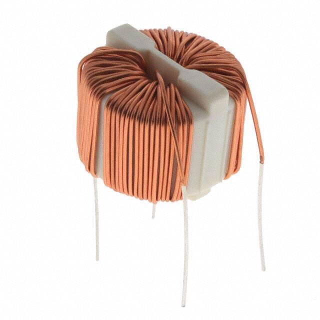

    6.2 mH @ 1 kHz 2 线路共模扼流圈 通孔 2A DCR 180 毫欧
SC-02-E620H 数据手册
AC Line Filters Common Mode SC Coils, Standard Series Overview Applications The KEMET SC coils are common mode chokes with a wide variety of characteristics. These toroidal coils are designed with our proprietary ferrite cores and are useful in various noise countermeasure fields. • Audio-visual equipment • Home appliances • Power supplies Benefits • Proprietary 5H, 7H and 10H ferrite material and equivalents • Suitable for ≥ 150 kHz range • Wide variety of sizes and specifications • Operating temperature range from −40°C to +105°C or +120°C • UL 94 V–2 or V–0 flame retardant rated cap Part Number System SCSeries Dimension Code (See Dimensions) SC Blank 22 10- 200 Rated Current (A) Inductance (mH) Minimum Thermal Class 0x = x A x0 = x0 A xx = xx A Blank E = Class E Examples: 02 = 2 A 10 = 10 A 15 = 15 A Note: With exceptions, see Table 1 for details. Note: With exceptions, see Table 1 for details. x00 = x mH xx00 = xx mH xx0 = x.xmH Example: 200 = 2 mH 1100 = 11 mH 620 = 6.2 mH Internal Control Code Blank A B H V Note: With exceptions, see Table 1 for details. Built Into Tomorrow © KEMET Electronics Corporation • One East Broward Boulevard Fort Lauderdale, FL 33301 USA • 954-766-2800 • www.kemet.com LF0005_SC • 9/25/2023 1 AC Line Filters – Common Mode SC Coils, Standard Series Magnetic Permeability of Ferrite Material In order to achieve most efficient noise reduction, it is important to select the material according to the target frequency band. Depending on its magnetic permeability, a particular ferrite material will be effective in a certain frequency band. A schematic representation of the relationship between the magnetic permeability of each material and the corresponding effective band range is shown in Figure 1. Materials with higher magnetic permeability are effective in the lower frequency range, while those with lower magnetic permeability are effective in the higher frequency range. Thus, Mn-Zn products are mainly used for reducing conduction noise, while Ni-Zn products are commonly used for radiation noise countermeasures. The effective frequency range varies depending on core shape, size and number of windings. This frequency dependence of the magnetic permeability as shown in the figure serves for reference purposes only and it should be tested on the actual device to determine its effectiveness. S18H, S15H, 10H, 7H, 5H, 1400L and 700L are KEMET’s proprietary ferrite material names. Other materials can also be available on request. Figure 1 - Relationship between the magnetic permeability of each material and its effective frequency range 20,000 Higher magnetic permeability: Higher noise suppression effect in the lower frequency range Mn-Zn Series Magnetic Permeability S18H S15H 10H 10,000 Lower magnetic permeability: Higher noise suppression effect in the higher frequency range 7H 5H Ni-Zn Series 0 10 kHz 1400L 700L 100 kHz 1 MHz 10 MHz 100 MHz 1 GHz Effective Frequency Range © KEMET Electronics Corporation • One East Broward Boulevard Fort Lauderdale, FL 33301 USA • 954-766-2800 • www.kemet.com LF0005_SC • 9/25/2023 2 AC Line Filters – Common Mode SC Coils, Standard Series Dimensions – Millimeters Figure 1 Figure 2 T OD (a) L (a) N1 N2 L (b) N2 (b) N1 H (a) (b) OD Part Name SC-02-101 SC-02-100 SC-02-200 SC-02-300 SC-02-500 SC-02-E620H SC-02-800 SC-02-090 SC-03-E900 SC-04-200 SC-04-500 SC-05-500 SC-05-503 SC-05-800 SC-05-803 SC-04-1600 SC-04-E2000 SC22-04-95H SC-05-E06H SC-05-100 SC-05-103 SC-05-200 SC-05-203 SC-05-300 SC-05-1100 SC-05-1503 SC-06-101 SC-06-E200H SC-06-900 SC-07-030V SC-07-100 SC-07-E300A SC-07-650 SC22-08-100 SC-08-100 1 Dimensions (mm) OD T H (Maximum) (Maximum) (Maximum) 23.0 23.0 23.0 27.0 27.0 27.0 34.0 26.0 23.5 25.0 29.0 34.0 34.0 34.0 34.0 34.0 34.0 30.0 25.0 25.0 25.0 32.0 32.0 32.0 34.0 34.0 25.0 25.0 34.0 25.0 25.0 34.0 35.0 30.0 35.0 13.0 18.5 18.5 20.0 20.0 23.0 14.5 20.0 19.0 21.0 23.0 23.0 23.0 23.0 18.5 22.0 22.0 24.0 23.0 24.0 20.0 19.0 23.0 - 20.0 23.0 23.0 19.0 13.0 18.5 22.0 19.0 19.0 23.0 19.0 23.0 Pin Pitch1 (Reference) L a b 15.0±2.0 15.0±2.0 15.0±2.0 15.0±2.0 15.0±2.0 15.0±2.0 15.0±2.0 15.0±2.0 15.0±2.0 15.0±2.0 15.0±2.0 15.0±2.0 15.0±2.0 15.0±2.0 15.0±2.0 15.0±2.0 15.0±2.0 4.0±1.0 5.0±1.0 15.0±2.0 15.0±2.0 15.0±2.0 15.0±2.0 15.0±2.0 15.0±2.0 15.0±2.0 8.0±2.0 8.0±2.0 15.0±2.0 15.0±2.0 15.0±2.0 4.5±1.0 15.0±2.0 5.0±2.0 15.0±2.0 6 6 6 6 6 15 7 6 5 8 10 7 20 7 22 8 18 10 15 6 15 7 22 8 6 6.5 10 10 8 10 10 22 7 14 22 11 17 17 17 17 15 20 13 15 16 19 21 20 21 21 22 18 20 15 17 15 21 21 22 21 19 19 19 22 15 19 21 21 22 21 Figure Fig. 1 Fig. 1 Fig. 1 Fig. 1 Fig. 1 Fig. 2 Fig. 1 Fig. 1 Fig. 1 Fig. 1 Fig. 1 Fig. 1 Fig. 2 Fig. 1 Fig. 2 Fig. 1 Fig. 1 Fig. 2 Fig. 2 Fig. 1 Fig. 2 Fig. 1 Fig. 2 Fig. 1 Fig. 1 Fig. 1 Fig. 2 Fig. 2 Fig. 1 Fig. 1 Fig. 1 Fig. 2 Fig. 1 Fig. 2 Fig. 2 Pin pitch listed above for reference only. Values not guaranteed. © KEMET Electronics Corporation • One East Broward Boulevard Fort Lauderdale, FL 33301 USA • 954-766-2800 • www.kemet.com LF0005_SC • 9/25/2023 3 AC Line Filters – Common Mode SC Coils, Standard Series Dimensions – Millimeters cont. Figure 1 Figure 2 T OD (a) L (a) N1 N2 L (b) N2 (b) N1 H (a) (b) OD Part Name SC22-08-170 SC-08-170H SC-08-200B SC22-08-260 SC-08-440 SC-08-700 SC-08-1000 SC-08-E1000 SC-09-1400 SC-10-100 SC-10-200 SC-10-E200H SC-10-340 SC-10-500 SC-10-1000 SC-12-300 SC-15-01H SC-15-100 SC-15-E110H SC-15-201 SC-15-200 SC-15-230 SC-15-E350 SC-15-E350H SC-18-100 SC-18-180 SC-18-290 SC-20-100 SC-20-104 SC-20-201 SC-20-300 SC-20-400 SC-30-050H SC-30-100 SC-30-E100 1 Dimensions (mm) OD T H (Maximum) (Maximum) (Maximum) 30.0 34.0 34.0 30.0 35.0 50.0 50.0 50.0 49.0 34.0 47.0 34.0 48.0 49.0 57.0 49.0 26.0 49.0 36.0 49.0 50.0 50.0 50.0 50.0 34.0 50.0 40.0 60.0 52.0 49.0 63.0 63.0 55.0 62.0 63.0 22.0 23.0 30.0 28.0 28.0 29.0 30.0 28.0 30.0 - 19.0 23.0 21.0 40.0 24.0 27.0 24.0 27.0 30.0 28.0 13.5 27.0 25.0 28.0 30.0 28.0 23.0 30.0 28.0 30.0 31.0 35.0 35.0 30.0 35.0 35.0 Pin Pitch1 (Reference) L a b 5.0±2.0 4.5±2.0 15.0±2.0 10.0±2.0 15.0±2.0 15.0±2.0 20.0±2.0 20.0±2.0 15.0±2.0 15.0±2.0 15.0±2.0 5.0±2.0 30.0±2.0 15.0±2.0 15.0±2.0 15.0±2.0 10.0±2.0 15.0±2.0 5.0±2.0 15.0±2.0 15.0±2.0 15.0±2.0 15.0±2.0 15.0±2.0 15.0±2.0 15.0±2.0 5.0±2.0 15.0±2.0 15.0±2.0 15.0±2.0 15.0±2.0 15.0±2.0 15.0±2.0 15.0±2.0 4.5±2.5 14 22 6 15 7 10 10 10 35 22 30 21 10 35 20 35 10 35 22 10 35 35 10 20 22 35 17 40 20 10 20 20 42 55 55 22 21 19 20 21 22 22 20 35 21 30 21 22 35 55 35 20 35 21 22 35 35 20 40 21 35 33 40 40 22 50 50 18 20 20 Figure Fig. 2 Fig. 2 Fig. 1 Fig. 2 Fig. 1 Fig. 1 Fig. 1 Fig. 1 Fig. 2 Fig. 2 Fig. 2 Fig. 2 Fig. 1 Fig. 2 Fig. 2 Fig. 2 Fig. 2 Fig. 2 Fig. 2 Fig. 1 Fig. 2 Fig. 2 Fig. 1 Fig. 2 Fig. 2 Fig. 2 Fig. 2 Fig. 2 Fig. 2 Fig. 1 Fig. 2 Fig. 2 Fig. 2 Fig. 2 Fig. 2 Pin pitch listed above for reference only. Values not guaranteed. © KEMET Electronics Corporation • One East Broward Boulevard Fort Lauderdale, FL 33301 USA • 954-766-2800 • www.kemet.com LF0005_SC • 9/25/2023 4 AC Line Filters – Common Mode SC Coils, Standard Series Environmental Compliance All KEMET AC line filters are RoHS Compliant. Performance Characteristics Item Performance Characteristics Rated Voltage Withstanding Voltage Insulation Resistance Rated Current Range Rated Inductance Range Inductance Measurement Condition Thermal Class 250 VAC/VDC 2,400 V (2 seconds, between lines) > 100 MΩ at 500 VDC (between lines) 2 – 30 A 0.067 – 20.3 mH minimum 1 kHz, 10 kHz, 16 kHz, and 100 kHz A (105°C) and E (120°C) −40°C to +105°C (include self temperature rise) and −40°C to +120°C (include self temperature rise) Operating Temperature Range Table 1 – Ratings & Part Number Reference Part Number Rated Inductance Current (A) (mH) Minimum DC Resistance/ Line (mΩ) Maximum Wire Thermal Temperature Rise Diameter (K) Maximum Class (mm) Weight (g) Approximate SC-02-101 SC-02-100 SC-02-200 SC-02-300 SC-02-500 SC-02-E620H SC-02-800 SC-02-090 SC-03-E900 SC-04-200 SC-04-500 SC-05-500 SC-05-503 SC-05-800 SC-05-803 2.0 2.0 2.0 2.0 2.0 2.0 2.0 2.0 3.0 4.0 4.0 4.0 4.0 4.0 4.0 1.000 4 1.000 4 2.000 4 3.000 4 5.000 4 6.200 1 8.000 4 9.400 2 9.000 2 2.000 4 5.000 2 5.000 4 5.000 4 8.000 4 8.000 4 110.0 100.0 110.0 100.0 100.0 180.0 150.0 100.0 130.0 55.0 70.0 80.0 80.0 85.0 90.0 40 40 40 40 45 40 40 40 70 50 50 50 50 60 60 0.60 0.60 0.60 0.60 0.60 0.55 0.60 0.65 0.60 0.70 0.70 0.80 0.80 0.80 0.80 A (105°C) A (105°C) A (105°C) A (105°C) A (105°C) E (120°C) A (105°C) E (120°C) E (120°C) A (105°C) A (105°C) A (105°C) A (105°C) A (105°C) A (105°C) 15.0 15.0 15.0 16.0 20.0 18.5 25.0 14.2 19.0 17.5 19.0 30.0 32.7 40.0 35.7 Part Number Rated Current (A) Inductance (mH) Minimum DC Resistance/Line (mΩ) Maximum Temperature Rise (K) Maximum Wire Diameter (mm) Thermal Class Weight (g) Approximate Inductance Measurement Condition : 1 kHz Inductance Measurement Condition : 10 kHz 3 Inductance Measurement Condition : 16 kHz 4 Inductance Measurement Condition : 100 kHz 1 2 © KEMET Electronics Corporation • One East Broward Boulevard Fort Lauderdale, FL 33301 USA • 954-766-2800 • www.kemet.com LF0005_SC • 9/25/2023 5 AC Line Filters – Common Mode SC Coils, Standard Series Table 1 – Ratings & Part Number Reference (cont.) Part Number Rated Inductance Current (A) (mH) Minimum DC Resistance/ Line (mΩ) Maximum Wire Thermal Temperature Rise Diameter (K) Maximum Class (mm) Weight (g) Approximate SC-04-1600 SC-04-E2000 SC22-04-95H SC-05-E06H SC-05-100 SC-05-103 SC-05-200 SC-05-203 SC-05-300 SC-05-1100 SC-05-1503 SC-06-101 SC-06-E200H SC-06-900 SC-07-030V SC-07-100 SC-07-E300A SC-07-650 SC22-08-100 SC-08-100 SC22-08-170 SC-08-170H SC-08-200B SC22-08-260 SC-08-440 SC-08-700 SC-08-1000 SC-08-E1000 SC-09-1400 SC-10-100 SC-10-200 SC-10-E200H SC-10-340 SC-10-500 SC-10-1000 SC-12-300 SC-15-01H SC-15-100 SC-15-E110H SC-15-201 SC-15-200 SC-15-230 SC-15-E350 SC-15-E350H SC-18-100 SC-18-180 SC-18-290 SC-20-100 SC-20-104 SC-20-201 SC-20-300 SC-20-400 SC-30-050H SC-30-100 SC-30-E100 4.0 4.0 4.3 5.0 5.0 5.0 5.0 5.0 5.0 5.0 5.0 6.0 6.0 6.0 7.0 7.0 7.0 7.0 8.0 8.0 8.0 8.0 8.0 8.0 8.0 8.0 8.0 8.0 9.0 10.0 10.0 10.0 10.0 10.0 10.0 12.0 15.0 15.0 15.0 15.0 15.0 15.0 15.0 15.0 18.0 18.0 18.0 20.0 20.0 20.0 20.0 20.0 30.0 30.0 30.0 16.000 1 20.300 2 9.450 2 0.600 2 1.000 4 1.000 4 2.000 4 2.000 4 3.000 4 11.000 2 10.500 3 1.000 4 2.000 2 9.000 1 0.360 4 0.650 4 3.000 4 6.500 1 1.000 2 1.000 4 1.700 2 1.700 2 2.000 4 2.600 1 4.400 1 7.000 1 10.000 4 10.000 4 14.000 1 1.000 4 2.000 4 2.000 2 3.400 4 5.000 4 10.000 4 3.000 4 0.067 2 1.000 4 1.100 2 2.000 4 2.000 4 2.300 4 3.500 4 3.500 4 0.700 4 1.800 1 2.900 4 1.000 4 1.000 4 2.000 2 3.000 4 4.000 1 0.500 2 1.000 4 1.000 4 85.0 150.0 80.0 17.5 50.0 50.0 70.0 70.0 55.0 55.0 100.0 27.0 27.0 60.0 14.0 14.0 45.0 40.0 20.0 25.0 20.0 20.0 70.0 30.0 25.0 40.0 70.0 70.0 53.0 20.0 28.0 20.0 32.0 25.0 35.0 18.0 2.0 12.0 16.5 12.0 12.0 13.0 20.0 20.0 20.0 11.0 25.0 8.0 8.0 10.0 13.0 13.0 3.0 6.0 6.0 55 75 86 35 40 40 40 40 55 50 55 40 40 55 30 45 70 55 50 50 50 45 40 60 50 55 50 50 65 40 40 45 50 55 50 45 25 40 100 50 45 55 80 80 50 75 115 45 50 75 50 55 40 40 60 0.80 0.80 0.75 0.85 0.80 0.80 0.80 0.80 0.80 1.00 0.90 0.90 0.90 1.00 1.10 1.10 1.00 1.10 1.20 1.20 1.20 1.20 1.20 1.00 1.20 1.30 1.20 1.20 1.30 1.30 1.30 1.30 1.40 1.50 1.50 1.60 1.40 1.80 1.30 1.80 1.80 1.80 1.60 1.60 1.70 1.90 1.40 2.30 2.00 1.90 2.30 2.30 1.80 x 2 Parallel 2.60 2.60 A (105°C) E (120°C) E (120°C) E (120°C) A (105°C) A (105°C) A (105°C) A (105°C) A (105°C) E (120°C) A (105°C) E (120°C) E (120°C) A (105°C) E (120°C) A (105°C) E (120°C) A (105°C) E (120°C) A (105°C) E (120°C) A (105°C) A (105°C) E (120°C) A (105°C) A (105°C) A (105°C) E (120°C) A (105°C) A (105°C) A (105°C) E (120°C) A (105°C) A (105°C) A (105°C) A (105°C) E (120°C) A (105°C) E (120°C) E (120°C) A (105°C) A (105°C) E (120°C) E (120°C) A (105°C) A (105°C) E (120°C) A (105°C) A (105°C) E (120°C) A (105°C) A (105°C) A (105°C) A (105°C) E (120°C) 39.8 45.0 31.8 10.3 20.0 17.3 25.0 31.2 32.8 46.7 41.0 19.3 20.1 44.0 18.9 20.0 40.0 45.3 27.3 40.5 28.2 36.3 43.1 25.7 44.2 103.6 104.5 108.7 170.1 40.0 80.0 42.5 105.7 110.1 177.3 103.8 10.0 100.0 41.5 109.3 110.0 114.4 110.5 111.3 45.2 110.4 77.5 135.0 103.3 108.5 202.0 205.0 103.0 190.0 200.0 Part Number Rated Current (A) Inductance (mH) Minimum DC Resistance/Line (mΩ) Maximum Temperature Rise (K) Maximum Wire Diameter (mm) Thermal Class Weight (g) Approximate Inductance Measurement Condition : 1 kHz Inductance Measurement Condition : 10 kHz 3 Inductance Measurement Condition : 16 kHz 4 Inductance Measurement Condition : 100 kHz 1 2 © KEMET Electronics Corporation • One East Broward Boulevard Fort Lauderdale, FL 33301 USA • 954-766-2800 • www.kemet.com LF0005_SC • 9/25/2023 6 AC Line Filters – Common Mode SC Coils, Standard Series Frequency Characteristics 1M SC-02-101 1M 10k 10k Impedance (Ω) 100k Impedance (Ω) 100k 1k 100 10 1k 100 10 1 1 1k 1M 10k 100k Frequency (Hz) 1M 10M 30M 1k SC-02-200 1M 10k 10k Impedance (Ω) 100k Impedance (Ω) 100k 1k 100 1k 10M 30M 100k 1M 10M 30M 100k 1M 10M 30M 100k 1M 10M 30M SC-02-300 100 10k 100k Frequency (Hz) 1M 10M 1k 30M SC-02-500 1M 10k 10k Impedance (Ω) 100k Impedance (Ω) 1M 1k 100k 1k 100 10k Frequency (Hz) SC-02-E620H 1k 100 10 10 1 1 1k 10k 100k Frequency (Hz) 1M 10M 1k 30M SC-02-800 1M 100k 10k 10k Impedance (Ω) 100k Impedance (Ω) 100k Frequency (Hz) 1 1 1M 10k 10 10 1M SC-02-100 1k 100 10k Frequency (Hz) SC-02-090 1k 100 10 10 1 1 1k 10k 100k Frequency (Hz) 1M 10M 30M © KEMET Electronics Corporation • One East Broward Boulevard Fort Lauderdale, FL 33301 USA • 954-766-2800 • www.kemet.com 1k 10k Frequency (Hz) LF0005_SC • 9/25/2023 7 AC Line Filters – Common Mode SC Coils, Standard Series Frequency Characteristics cont. 1M SC-03-E900 1M 10k 10k Impedance (Ω) 100k Impedance (Ω) 100k 1k 100 10 1k 100 10 1 1 1k 1M 10k 100k Frequency (Hz) 1M 10M 30M 1k SC-04-500 1M 10k 10k Impedance (Ω) 100k Impedance (Ω) 100k 1k 100 10 10M 30M 100k 1M 10M 30M 100k 1M 10M 30M 100k 1M 10M 30M SC-05-500 100 10k 100k Frequency (Hz) 1M 10M 30M 1k SC-05-503 1M 10k 10k Impedance (Ω) 100k Impedance (Ω) 1M 1k 100k 1k 100 10 10k Frequency (Hz) SC-05-800 1k 100 10 1 1 1k 10k 100k Frequency (Hz) 1M 10M 30M 1k SC-05-803 1M 100k 10k 10k Impedance (Ω) 100k Impedance (Ω) 100k Frequency (Hz) 1 1k 1M 10k 10 1 1M SC-04-200 1k 100 10 10k Frequency (Hz) SC-04-1600 1k 100 10 1 1 1k 10k 100k Frequency (Hz) 1M 10M 30M © KEMET Electronics Corporation • One East Broward Boulevard Fort Lauderdale, FL 33301 USA • 954-766-2800 • www.kemet.com 1k 10k Frequency (Hz) LF0005_SC • 9/25/2023 8 AC Line Filters – Common Mode SC Coils, Standard Series Frequency Characteristics cont. 1M SC-04-E2000 1M 10k 10k Impedance (Ω) 100k Impedance (Ω) 100k 1k 100 10 1k 100 10 1 1 1k 1M 10k 100k Frequency (Hz) 1M 10M 30M 1k SC-05-E06H 1M 10k 10k Impedance (Ω) 100k Impedance (Ω) 100k 1k 100 10 10M 30M 100k 1M 10M 30M 100k 1M 10M 30M 100k 1M 10M 30M SC-05-100 100 10k 100k Frequency (Hz) 1M 10M 30M 1k SC-05-103 1M 10k 10k Impedance (Ω) 100k Impedance (Ω) 1M 1k 100k 1k 100 10k Frequency (Hz) SC-05-200 1k 100 10 10 1 1 1k 10k 100k Frequency (Hz) 1M 10M 30M 1k SC-05-203 1M 100k 10k 10k Impedance (Ω) 100k Impedance (Ω) 100k Frequency (Hz) 1 1k 1M 10k 10 1 1M SC22-04-95H 1k 100 10k Frequency (Hz) SC-05-300 1k 100 10 10 1 1 1k 10k 100k Frequency (Hz) 1M 10M 30M © KEMET Electronics Corporation • One East Broward Boulevard Fort Lauderdale, FL 33301 USA • 954-766-2800 • www.kemet.com 1k 10k Frequency (Hz) LF0005_SC • 9/25/2023 9 AC Line Filters – Common Mode SC Coils, Standard Series Frequency Characteristics cont. 1M SC-05-1100 1M 10k 10k Impedance (Ω) 100k Impedance (Ω) 100k 1k 100 10 1k 100 10 1 1 1k 1M 10k 100k Frequency (Hz) 1M 10M 1k 30M SC-06-101 1M 10k 10k Impedance (Ω) 100k Impedance (Ω) 100k 1k 100 10 10M 30M 100k 1M 10M 30M 100k 1M 10M 30M 100k 1M 10M 30M SC-06-E200H 100 10k 100k Frequency (Hz) 1M 10M 30M 1k SC-06-900 1M 10k 10k Impedance (Ω) 100k Impedance (Ω) 1M 1k 100k 1k 100 10 10k Frequency (Hz) SC-07-030V 1k 100 10 1 1 1k 10k 100k Frequency (Hz) 1M 10M 1k 30M SC-07-100 1M 100k 10k 10k Impedance (Ω) 100k Impedance (Ω) 100k Frequency (Hz) 1 1k 1M 10k 10 1 1M SC-05-1503 1k 100 10 10k Frequency (Hz) SC-07-E300A 1k 100 10 1 1 1k 10k 100k Frequency (Hz) 1M 10M 30M © KEMET Electronics Corporation • One East Broward Boulevard Fort Lauderdale, FL 33301 USA • 954-766-2800 • www.kemet.com 1k 10k Frequency (Hz) LF0005_SC • 9/25/2023 10 AC Line Filters – Common Mode SC Coils, Standard Series Frequency Characteristics cont. 1M SC-07-650 1M 10k 10k Impedance (Ω) 100k Impedance (Ω) 100k 1k 100 1k 100 10 10 1 1 1k 1M 10k 100k Frequency (Hz) 1M 10M 1k 30M SC-08-100 1M 10k 10k Impedance (Ω) 100k Impedance (Ω) 100k 1k 100 10 10M 30M 100k 1M 10M 30M 100k 1M 10M 30M 100k 1M 10M 30M SC22-08-170 100 10k 100k Frequency (Hz) 1M 10M 30M 1k SC-08-170H 1M 10k 10k Impedance (Ω) 100k Impedance (Ω) 1M 1k 100k 1k 100 10 10k Frequency (Hz) SC-08-200B 1k 100 10 1 1 1k 10k 100k Frequency (Hz) 1M 10M 30M 1k SC22-08-260 1M 100k 10k 10k Impedance (Ω) 100k Impedance (Ω) 100k Frequency (Hz) 1 1k 1M 10k 10 1 1M SC22-08-100 1k 100 10 10k Frequency (Hz) SC-08-440 1k 100 10 1 1 1k 10k 100k Frequency (Hz) 1M 10M 30M © KEMET Electronics Corporation • One East Broward Boulevard Fort Lauderdale, FL 33301 USA • 954-766-2800 • www.kemet.com 1k 10k Frequency (Hz) LF0005_SC • 9/25/2023 11 AC Line Filters – Common Mode SC Coils, Standard Series Frequency Characteristics cont. 1M SC-08-700 1M 10k 10k Impedance (Ω) 100k Impedance (Ω) 100k 1k 100 10 1k 100 10 1 1 1k 1M 10k 100k Frequency (Hz) 1M 10M 30M 1k SC-08-E1000 1M 10k 10k Impedance (Ω) 100k Impedance (Ω) 100k 1k 100 10 10M 30M 100k 1M 10M 30M 100k 1M 10M 30M 100k 1M 10M 30M SC-09-1400 100 10k 100k Frequency (Hz) 1M 10M 1k 30M SC-10-100 1M 10k 10k Impedance (Ω) 100k Impedance (Ω) 1M 1k 100k 1k 100 10 10k Frequency (Hz) SC-10-200 1k 100 10 1 1 1k 10k 100k Frequency (Hz) 1M 10M 30M 1k SC-10-E200H 1M 100k 10k 10k Impedance (Ω) 100k Impedance (Ω) 100k Frequency (Hz) 1 1k 1M 10k 10 1 1M SC-08-1000 1k 100 10 10k Frequency (Hz) SC-10-340 1k 100 10 1 1 1k 10k 100k Frequency (Hz) 1M 10M 30M © KEMET Electronics Corporation • One East Broward Boulevard Fort Lauderdale, FL 33301 USA • 954-766-2800 • www.kemet.com 1k 10k Frequency (Hz) LF0005_SC • 9/25/2023 12 AC Line Filters – Common Mode SC Coils, Standard Series Frequency Characteristics cont. 1M SC-10-500 1M 10k 10k Impedance (Ω) 100k Impedance (Ω) 100k 1k 100 10 1k 100 10 1 1 1k 1M 10k 100k Frequency (Hz) 1M 10M 30M 1k SC-12-300 1M 10k 10k Impedance (Ω) 100k Impedance (Ω) 100k 1k 100 10 10M 30M 100k 1M 10M 30M 100k 1M 10M 30M 100k 1M 10M 30M SC-15-01H 100 10k 100k Frequency (Hz) 1M 10M 30M 1k SC-15-100 1M 10k 10k Impedance (Ω) 100k Impedance (Ω) 1M 1k 100k 1k 100 10k Frequency (Hz) SC-15-E110H 1k 100 10 10 1 1 1k 10k 100k Frequency (Hz) 1M 10M 1k 30M SC-15-201 1M 100k 10k 10k Impedance (Ω) 100k Impedance (Ω) 100k Frequency (Hz) 1 1k 1M 10k 10 1 1M SC-10-1000 1k 100 10 10k Frequency (Hz) SC-15-200 1k 100 10 1 1 1k 10k 100k Frequency (Hz) 1M 10M 30M © KEMET Electronics Corporation • One East Broward Boulevard Fort Lauderdale, FL 33301 USA • 954-766-2800 • www.kemet.com 1k 10k Frequency (Hz) LF0005_SC • 9/25/2023 13 AC Line Filters – Common Mode SC Coils, Standard Series Frequency Characteristics cont. 1M SC-15-230 1M 10k 10k Impedance (Ω) 100k Impedance (Ω) 100k 1k 100 10 1k 100 10 1 1 1k 1M 10k 100k Frequency (Hz) 1M 10M 30M 1k SC-15-E350H 1M 10k 10k Impedance (Ω) 100k Impedance (Ω) 100k 1k 100 10 10M 30M 100k 1M 10M 30M 100k 1M 10M 30M 100k 1M 10M 30M SC-18-100 100 10k 100k Frequency (Hz) 1M 10M 30M 1k SC-18-180 1M 10k 10k Impedance (Ω) 100k Impedance (Ω) 1M 1k 100k 1k 100 10 10k Frequency (Hz) SC-18-290 1k 100 10 1 1 1k 10k 100k Frequency (Hz) 1M 10M 30M 1k SC-20-100 1M 100k 10k 10k Impedance (Ω) 100k Impedance (Ω) 100k Frequency (Hz) 1 1k 1M 10k 10 1 1M SC-15-E350 1k 100 10 10k Frequency (Hz) SC-20-104 1k 100 10 1 1 1k 10k 100k Frequency (Hz) 1M 10M 30M © KEMET Electronics Corporation • One East Broward Boulevard Fort Lauderdale, FL 33301 USA • 954-766-2800 • www.kemet.com 1k 10k Frequency (Hz) LF0005_SC • 9/25/2023 14 AC Line Filters – Common Mode SC Coils, Standard Series Frequency Characteristics cont. 1M SC-20-201 1M 10k 10k Impedance (Ω) 100k Impedance (Ω) 100k 1k 100 10 1k 100 10 1 1 1k 1M 10k 100k Frequency (Hz) 1M 10M 30M 1k SC-20-400 1M 10k 10k Impedance (Ω) 100k Impedance (Ω) 100k 1k 100 100k 1M 10M 30M 100k 1M 10M 30M 100k 1M 10M 30M Frequency (Hz) SC-30-050H 1k 100 1 1 1k 10k 100k Frequency (Hz) 1M 10M 1k 30M SC-30-100 1M 100k 10k 10k Impedance (Ω) 100k Impedance (Ω) 10k 10 10 1M SC-20-300 1k 100 10k Frequency (Hz) SC-30-E100 1k 100 10 10 1 1 1k 10k 100k Frequency (Hz) 1M 10M 30M © KEMET Electronics Corporation • One East Broward Boulevard Fort Lauderdale, FL 33301 USA • 954-766-2800 • www.kemet.com 1k 10k Frequency (Hz) LF0005_SC • 9/25/2023 15 AC Line Filters – Common Mode SC Coils, Standard Series Packaging Type Packaging Type SC-02-101 SC-02-100 SC-02-200 SC-02-300 SC-02-500 SC-02-E620H SC-02-800 SC-02-090 SC-03-E900 SC-04-200 SC-04-500 SC-05-500 SC-05-503 SC-05-800 SC-05-803 SC-04-1600 SC-04-E2000 SC22-04-95H SC-05-E06H SC-05-100 SC-05-103 SC-05-200 SC-05-203 SC-05-300 SC-05-1100 SC-05-1503 SC-06-101 SC-06-E200H SC-06-900 SC-07-030V SC-07-100 SC-07-E300A SC-07-650 SC22-08-100 SC-08-100 Pieces Per Box Type 360 300 SC22-08-170 SC-08-170H SC-08-200B SC22-08-260 SC-08-440 SC-08-700 SC-08-1000 SC-08-E1000 SC-09-1400 SC-10-100 SC-10-200 SC-10-E200H SC-10-340 SC-10-500 SC-10-1000 SC-12-300 SC-15-01H SC-15-100 SC-15-E110H SC-15-201 SC-15-200 SC-15-230 SC-15-E350 SC-15-E350H SC-18-100 SC-18-180 SC-18-290 SC-20-100 SC-20-104 SC-20-201 SC-20-300 SC-20-400 SC-30-050H SC-30-100 SC-30-E100 300 500 200 360 300 200 Tray 100 200 300 500 200 120 200 500 200 300 200 250 200 Packaging Type Pieces Per Box 250 150 200 500 200 60 Tray 40 200 90 150 60 90 60 90 300 90 150 60 90 60 90 160 90 200 60 90 60 90 60 Handling Precautions Precautions for product storage AC Line Filters should be stored in normal working environments. While the chokes themselves are quite robust in other environments, solderability will be degraded by exposure to high temperatures, high humidity, corrosive atmospheres, and long term storage. KEMET recommends that maximum storage temperature not exceed 40°C and maximum storage humidity not exceed 70% relative humidity. Atmospheres should be free of chlorine and sulfur bearing compounds. Temperature fluctuations should be minimized to avoid condensation on the parts. Avoid storage near strong magnetic fields, as this might magnetize the product. For optimized solderability, AC line filters stock should be used promptly and preferably within 6 months of receipt. Product temperature rise values The values listed for temperature rise are the result of self-heating in wires when the rated current (commercial frequency) is applied. When using the product, check and evaluate the value of the core temperature rise under actual operating conditions. © KEMET Electronics Corporation • One East Broward Boulevard Fort Lauderdale, FL 33301 USA • 954-766-2800 • www.kemet.com LF0005_SC • 9/25/2023 16 AC Line Filters – Common Mode SC Coils, Standard Series KEMET Electronics Corporation Sales Offices For a complete list of our global sales offi ces, please visit www.kemet.com/sales. Disclaimer YAGEO Corporation and its affi liates do not recommend the use of commercial or automotive grade products for high reliability applications or manned space fl ight. All product specifi cations, statements, information and data (collectively, the “Information”) in this datasheet are subject to change. The customer is responsible for checking and verifying the extent to which the Information contained in this publication is applicable to an order at the time the order is placed. All Information given herein is believed to be accurate and reliable, but it is presented without guarantee, warranty, or responsibility of any kind, expressed or implied. Statements of suitability for certain applications are based on KEMET Electronics Corporation’s (“KEMET”) knowledge of typical operating conditions for such applications, but are not intended to constitute – and KEMET specifi cally disclaims – any warranty concerning suitability for a specifi c customer application or use. The Information is intended for use only by customers who have the requisite experience and capability to determine the correct products for their application. Any technical advice inferred from this Information or otherwise provided by KEMET with reference to the use of KEMET’s products is given gratis, and KEMET assumes no obligation or liability for the advice given or results obtained. Although KEMET designs and manufactures its products to the most stringent quality and safety standards, given the current state of the art, isolated component failures may still occur. Accordingly, customer applications which require a high degree of reliability or safety should employ suitable designs or other safeguards (such as installation of protective circuitry or redundancies) in order to ensure that the failure of an electrical component does not result in a risk of personal injury or property damage. Although all product–related warnings, cautions and notes must be observed, the customer should not assume that all safety measures are indicated or that other measures may not be required. When providing KEMET products and technologies contained herein to other countries, the customer must abide by the procedures and provisions stipulated in all applicable export laws and regulations, including without limitation the International Traffi c in Arms Regulations (ITAR), the US Export Administration Regulations (EAR) and the Japan Foreign Exchange and Foreign Trade Act. KEMET is a registered trademark of KEMET Electronics Corporation. © KEMET Electronics Corporation • One East Broward Boulevard Fort Lauderdale, FL 33301 USA • 954-766-2800 • www.kemet.com LF0005_SC • 9/25/2023 17
