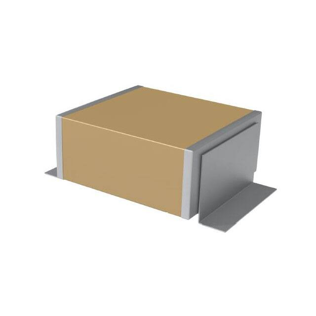

Surface Mount Multilayer Ceramic Chip Capacitors (SMD MLCCs) KPS HV, Large Case, SM Series, X7R Dielectric, 500 – 10,000 VDC (Industrial Grade) Overview KPS HV (KEMET Power Solutions, High Voltage), Large Case (≥ 1515), SM Series capacitors in X7R dielectric are designed to meet robust performance standards required in higher reliability industrial applications. Utilizing leadframe technology, SM Series devices isolate the multilayer ceramic chip component from the printed circuit board providing advanced mechanical and thermal stress performance. Isolation of the chip component also addresses concerns for audible, microphonic noise that may occur when a bias voltage is applied. Although this technology does not eliminate the potential for mechanical damage that may propagate during extreme environmental and handling conditions, it does demonstrate superior performance over non-isolating systems. Available in both formed "L" and "J" lead configurations, SM Series devices offer up to 10 mm of board flex capability and exhibit lower ESR, ESL and higher current discharge capability when compared to other dielectric solutions. Combined with the stability of an X7R dielectric, KEMET’s High Voltage SM Series devices exhibit a predictable change in capacitance with respect to time and voltage and boast a minimal change in capacitance with reference to ambient temperature. Capacitance change is limited to ±15% from −55°C to +125°C. KEMET's Industrial grade products offer additional screening options for higher reliability applications. Both Group A and Group B testing/inspection options per MIL–PRF–49467 are available for the SM Series. Benefits • −55°C to +125°C operating temperature range • Large Case Sizes (≥ 1515) • Formed “L” or “J” leadframe configurations • Group A and B screening per MIL–PRF–49467 available • Reliable and robust leadframe termination system • DC voltage ratings of 500 V, 1 KV, 2 KV, 3 KV, 4 KV, 5 KV, 7.5 KV, and 10 KV • Capacitance offerings ranging from 150 pF up to 5.6 μF Click image above for interactive 3D content Ordering Information Open PDF in Adobe Reader for full functionality SM20 B 153 K 501 B M Style/Size Dielectric Capacitance Code (pF) Capacitance Tolerance Rated Voltage (VDC) Lead Configuration1 Testing/ Inspection Option2 Two significant digits and number of zeros K = ±10% M = ±20% 501 = 500 102 = 1,000 202 = 2,000 302 = 3,000 402 = 4,000 502 = 5,000 752 = 7,500 103 = 10,000 A = Formed "L" B = Formed "J" Blank = None M = Group A per MIL–PRF–49467 SM20 SM21 SM22 SM23 SM24 SM25 SM26 SM30 SM31 SM33 SM34 SM35 SM36 B = X7R Standard lead configuration is formed "J". If the appropriate character is excluded from the ordering code, the assumed lead configuration will be formed "J". 2 Group B testing/inspection option per MIL–PRF–49467 is available upon request. Please contact KEMET for ordering details. 1 One world. One KEMET © KEMET Electronics Corporation • P.O. Box 5928 • Greenville, SC 29606 • 864-963-6300 • www.kemet.com C1033_X7R_KPS_HIVOLT_SMD • 8/18/2016 1 Surface Mount Multilayer Ceramic Chip Capacitors (SMD MLCCs) KPS HV, Large Case, SM Series, X7R Dielectric, 500 – 10,000 VDC (Industrial Grade) Dimensions – Inches (Millimeters) FORMED LEAD (L) FORMED LEAD (J) Top View Top View Profile View (L) (L) A W LL Profile View (J) T 0.030±0.010 (0.76±0.25) L Style/ Size L Length W Width SM20 SM21 SM22 SM23 SM24 SM25 SM26 SM30 SM31 0.150±0.015 (3.81±0.38) 0.200±0.020 (5.08±0.51) 0.250±0.020 (6.35±0.51) 0.350±0.030 (8.89±0.76) 0.450±0.030 (11.43±0.76) 0.550±0.030 (14.00±0.76) 0.650±0.030 (16.50±0.76) 0.300±0.030 (7.62±0.76) 0.400±0.030 (10.20±0.76) 0.150±0.015 (3.81±0.38) 0.200±0.020 (5.08±0.51) 0.200±0.020 (5.08±0.51) 0.300±0.030 (7.62±0.76) 0.400±0.030 (10.20±0.76) 0.500±0.030 (12.70±0.76) 0.600±0.030 (15.20±0.76) 0.150±0.015 (3.81±0.38) 0.200±0.020 (5.08±0.51) SM33 0.700±0.030 (17.08±0.76) SM34 SM35 SM36 0.900±0.030 (22.90±0.76) 1.100±0.030 (27.90±0.76) 1.350±0.030 (33.00±0.76) T Thickness Max. (J) A W LL L A Lead Width Max. LL Lead Length (Formed "L") 0.130 (3.30) 0.180 (4.57) 0.220 (5.59) 0.140 (3.55) 0.130 (3.30) 0.100 (2.54) 0.300±0.030 (7.62±0.76) 0.180 (4.57) 0.200 (5.08) 0.400±0.030 (10.20±0.76) 0.500±0.030 (12.70±0.76) 0.600±0.030 (15.20±0.76) 0.220 (5.59) 0.300 (7.62) 0.400 (10.2) 0.500 (12.7) 0.030±0.010 (0.76±0.25) LL Lead Length (Formed "J") 0.040±0.010 (1.02±0.25) 0.100 (2.54) 0.200 (5.08) 0.300 (7.62) 0.400 (10.20) 0.500 (12.70) T 0.100±0.020 (2.54±0.51) 0.100±0.020 (2.54±0.51) Benefits cont'd • Advanced protection against thermal and mechanical stress • Provides up to 10 mm of board flex capability • Reduces audible, microphonic noise • Low ESR and ESL • Non-polar device, minimizing installation concerns • Silver plated copper alloy leadframe termination system Applications Typical applications include switch mode power supplies (input filters, resonators, tank circuits, snubber circuits, output filters), high voltage coupling and DC blocking, voltage multiplier circuits, DC/DC converters and coupling capacitors in Ćuk converters, noise reduction (piezoelectric/mechanical), circuits with a direct battery or power source connection, critical and safety relevant circuits without (integrated) current limitation and any application that is subject to high levels of board flexure or temperature cycling. Markets include power supply, LCD fluorescent backlight ballasts, HID lighting, telecom equipment, industrial and medical equipment/control and Military. © KEMET Electronics Corporation • P.O. Box 5928 • Greenville, SC 29606 • 864-963-6300 • www.kemet.com C1033_X7R_KPS_HIVOLT_SMD • 8/18/2016 2 Surface Mount Multilayer Ceramic Chip Capacitors (SMD MLCCs) KPS HV, Large Case, SM Series, X7R Dielectric, 500 – 10,000 VDC (Industrial Grade) Qualification/Certification Industrial Grade products are subject to internal qualification. Details regarding test methods and conditions are referenced in Table 3, Performance & Reliability. Environmental Compliance RoHS Compliant with Exemption(s). Electrical Parameters/Characteristics Item Parameters/Characteristics Operating Temperature Range −55°C to +125°C Capacitance Change with Reference to +25°C and 0 VDC Applied (TCC) ±15% Aging Rate (Maximum % Capacitance Loss/Decade Hour) 3.0% Dielectric Withstanding Voltage (DWV) Dissipation Factor (DF) Maximum Limit at 25ºC Insulation Resistance (IR) Limit at 25°C 150% of rated voltage for voltage rating of ≤ 1,250 VDC 120% of rated voltage for voltage rating of > 1,250 VDC (5±1 seconds and charge/discharge not exceeding 50 mA) 2.5% 1,000 megohm microfarads or 100 GΩ (Rated voltage DC applied for 120±5 seconds at 25°C for voltage rating of ≤ 500 VDC) (500 VDC applied for 120±5 seconds at 25°C for voltage rating of > 500 VDC) Regarding aging rate: Capacitance measurements (including tolerance) are indexed to a referee time of 1,000 hours. To obtain IR limit, divide MΩ-µF value by the capacitance and compare to GΩ limit. Select the lower of the two limits. Capacitance and dissipation factor (DF) measured under the following conditions: 1 kHz ±50 Hz and 1.0 Vrms ±0.2 V if capacitance > 100 pF Note: When measuring capacitance it is important to ensure the set voltage level is held constant. The HP4284 and Agilent E4980 have a feature known as Automatic Level Control (ALC). The ALC feature should be switched to "ON." Post Environmental Limits High Temperature Life, Biased Humidity, Moisture Resistance Dielectric Rated DC Voltage Capacitance Value Dissipation Factor (Maximum %) Capacitance Shift X7R All All 3.0 ±20% © KEMET Electronics Corporation • P.O. Box 5928 • Greenville, SC 29606 • 864-963-6300 • www.kemet.com C1033_X7R_KPS_HIVOLT_SMD • 8/18/2016 3 Surface Mount Multilayer Ceramic Chip Capacitors (SMD MLCCs) KPS HV, Large Case, SM Series, X7R Dielectric, 500 – 10,000 VDC (Industrial Grade) Table 1A – Capacitance Range/Selection Waterfall SM20 – SM24 Style/Size Style/Size SM20 SM21 0.150 ± 0.015 (3.81 ± 0.38) 0.150 ± 0.015 (3.81 ± 0.38) 0.130 (3.30) 0.100 (2.54) 0.100 ± 0.020 (2.54 ± 0.51) 0.040 ± 0.010 (1.02 ± 0.25) 0.200 ± 0.020 (5.08 ± 0.51) 0.200 ± 0.020 (5.08 ± 0.51) 0.180 (4.57) 0.100 (2.54) 0.100 ± 0.020 (2.54 ± 0.51) 0.040 ± 0.010 (1.02 ± 0.25) SM22 SM23 SM24 0.350 ± 0.030 (8.89 ± 0.76) 0.300 ± 0.030 (7.62 ± 0.76) 0.220 (5.59) 0.200 (5.08) 0.100 ± 0.020 (2.54 ± 0.51) 0.100 ± 0.020 (2.54 ± 0.51) 0.450 ± 0.030 (11.43 ± 0.76) 0.400 ± 0.030 (10.20 ± 0.76) 0.220 (5.59) 0.300 (7.62) 0.100 ± 0.020 (2.54 ± 0.51) 0.100 ± 0.020 (2.54 ± 0.51) Dimensions – inches (mm) Length Width Thickness Maximum Lead Width Maximum Lead Length "L" Lead Length "J" 0.250 ± 0.020 (6.35 ± 0.51) 0.200 ± 0.020 (5.08 ± 0.51) 0.180 (4.57) 0.100 (2.54) 0.100 ± 0.020 (2.54 ± 0.51) 0.040 ± 0.010 (1.02 ± 0.25) X7R Dielectric Voltage Code Voltage DC 501 102 202 501 102 202 302 501 102 202 302 501 102 202 302 402 501 102 202 302 402 502 500 1 K 2 K 500 1 K 331 391 471 561 681 821 102 122 152 182 222 272 332 392 472 562 682 822 103 123 153 183 223 273 333 393 473 563 683 823 331 391 471 561 681 821 102 122 152 182 222 272 332 392 2K 3 K 500 1 K Capacitance 330 pF 390 pF 470 pF 560 pF 680 pF 820 pF 1,000 pF 1,200 pF 1,500 pF 1,800 pF 2,200 pF 2,700 pF 3,300 pF 3,900 pF 4,700 pF 5,600 pF 6,800 pF 8,200 pF 0.01 µF 0.012 µF 0.015 µF 0.018 µF 0.022 µF 0.027 µF 0.033 µF 0.039 µF 0.047 µF 0.056 µF 0.068 µF 0.082 µF 0.1 µF 0.12 µF 0.15 µF 0.18 µF 0.22 µF 0.27 µF 0.33 µF 0.39 µF 0.47 µF 0.56 µF 0.68 µF 0.82 µF 1.0 µF 1.2 µF 2K 3 K 500 1 K 2K 3K 4 K 500 1 K 2K 3K 4K 5K 102 122 152 182 222 272 332 392 472 562 682 822 103 123 153 183 223 273 333 102 122 152 182 222 272 332 392 472 562 682 822 103 123 153 102 122 152 182 222 272 332 392 472 562 682 102 122 152 182 222 272 332 392 472 562 682 822 103 123 153 183 223 273 333 393 473 563 683 823 104 102 122 152 182 222 272 332 392 472 562 682 822 103 123 153 183 223 273 333 102 122 152 182 222 272 332 392 472 562 682 822 103 123 102 122 152 182 222 272 332 392 472 562 682 Capacitance Code 331 391 471 561 681 821 102 122 152 182 222 272 332 392 472 562 682 822 103 123 153 183 223 821 102 122 152 182 222 272 332 392 472 562 682 822 103 123 153 183 223 273 333 393 473 563 683 823 104 124 154 184 821 102 122 152 182 222 272 332 392 472 562 682 822 103 123 153 183 223 273 333 393 473 563 683 821 102 122 152 182 222 272 332 392 472 562 682 822 103 123 821 102 122 152 182 222 272 332 392 472 681 821 102 122 152 182 222 272 332 392 472 562 682 822 103 123 153 183 223 273 333 393 473 563 683 823 104 124 154 184 224 274 681 821 102 122 152 182 222 272 332 392 472 562 682 822 103 123 153 183 223 273 333 393 473 563 683 823 104 681 821 102 122 152 182 222 272 332 392 472 562 682 822 103 123 153 681 821 102 122 152 182 222 272 332 392 472 562 102 122 152 182 222 272 332 392 472 562 682 822 103 123 153 183 223 273 333 393 473 563 683 823 104 124 154 184 224 274 334 394 474 564 102 122 152 182 222 272 332 392 472 562 682 822 103 123 153 183 223 273 333 393 473 563 683 823 104 124 154 184 224 274 © KEMET Electronics Corporation • P.O. Box 5928 • Greenville, SC 29606 • 864-963-6300 • www.kemet.com 102 122 152 182 222 272 332 392 472 562 682 822 103 123 153 183 223 273 333 393 473 563 683 823 104 124 154 184 224 274 334 394 474 564 684 824 105 125 102 122 152 182 222 272 332 392 472 562 682 822 103 123 153 183 223 273 333 393 473 563 683 823 104 124 154 184 224 274 334 394 474 Capacitance Tolerance K, M C1033_X7R_KPS_HIVOLT_SMD • 8/18/2016 4 Surface Mount Multilayer Ceramic Chip Capacitors (SMD MLCCs) KPS HV, Large Case, SM Series, X7R Dielectric, 500 – 10,000 VDC (Industrial Grade) Table 1B – Capacitance Range/Selection Waterfall SM25 – SM31 Style/Size Style/Size SM25 SM26 SM30 SM31 0.300 ± 0.030 (7.62 ± 0.76) 0.150 ± 0.015 (3.81 ± 0.38) 0.140 (3.55) 0.100 (2.54) 0.100 ± 0.020 (2.54 ± 0.51) 0.100 ± 0.020 (2.54 ± 0.51) 0.400 ± 0.030 (10.20 ± 0.76) 0.200 ± 0.020 (5.08 ± 0.51) 0.130 (3.30) 0.100 (2.54) 0.100 ± 0.020 (2.54 ± 0.51) 0.100 ± 0.020 (2.54 ± 0.51) Dimensions – inches (mm) 0.550 ± 0.030 (14.00 ± 0.76) 0.500 ± 0.030 (12.70 ± 0.76) 0.220 (5.59) 0.400 (10.20) 0.100 ± 0.020 (2.54 ± 0.51) 0.100 ± 0.020 (2.54 ± 0.51) Length Width Thickness Maximum Lead Width Maximum Lead Length "L" Lead Length "J" 0.650 ± 0.030 (16.50 ± 0.76) 0.600 ± 0.030 (15.20 ± 0.76) 0.220 (5.59) 0.500 (12.70) 0.100 ± 0.020 (2.54 ± 0.51) 0.100 ± 0.020 (2.54 ± 0.51) X7R Dielectric Voltage Code 501 102 202 302 402 502 501 102 202 302 402 502 501 102 202 302 402 501 102 202 302 402 502 Voltage DC 500 1 K 2 K 3 K 4 K 5 K 500 1 K 2 K 3 K 4 K 5 K 500 1 K 2 K 3 K 4 K 500 1 K 2 K 3 K 4 K 5 K Capacitance Capacitance Code 150 pF 180 pF 220 pF 270 pF 330 pF 390 pF 470 pF 560 pF 680 pF 820 pF 1,000 pF 1,200 pF 1,500 pF 1,800 pF 2,200 pF 2,700 pF 3,300 pF 3,900 pF 4,700 pF 5,600 pF 6,800 pF 8,200 pF 0.01 µF 0.012 µF 0.015 µF 0.018 µF 0.022 µF 0.027 µF 0.033 µF 0.039 µF 0.047 µF 0.056 µF 0.068 µF 0.082 µF 0.1 µF 0.12 µF 0.15 µF 0.18 µF 0.22 µF 0.27 µF 0.33 µF 0.39 µF 0.47 µF 0.56 µF 0.68 µF 0.82 µF 222 272 332 392 472 562 682 822 103 123 153 183 223 273 333 393 473 563 683 823 104 124 154 184 224 274 334 394 474 564 684 824 222 272 332 392 472 562 682 822 103 123 153 183 223 273 333 393 473 563 683 823 104 124 154 184 224 274 334 394 474 222 272 332 392 472 562 682 822 103 123 153 183 223 273 333 393 473 563 683 823 104 124 222 272 332 392 472 562 682 822 103 123 153 183 223 273 333 393 473 222 272 332 392 472 562 682 822 103 123 153 222 272 332 392 472 562 682 822 103 222 272 332 392 472 562 682 822 103 123 153 183 223 273 333 393 473 563 683 823 104 124 154 184 224 274 334 394 474 564 684 824 222 272 332 392 472 562 682 822 103 123 153 183 223 273 333 393 473 563 683 823 104 124 154 184 224 274 334 394 474 564 684 824 222 272 332 392 472 562 682 822 103 123 153 183 223 273 333 393 473 563 683 823 104 124 154 184 222 272 332 392 472 562 682 822 103 123 153 183 223 273 333 393 473 563 683 823 104 392 392 472 472 562 562 682 682 822 822 103 103 123 123 153 153 183 223 273 333 151 181 221 271 331 391 471 561 681 821 102 122 152 182 222 272 332 392 472 562 682 822 103 123 153 183 223 273 333 393 473 563 683 823 104 124 154 184 151 181 221 271 331 391 471 561 681 821 102 122 152 182 222 272 332 392 472 562 682 822 103 123 153 183 223 273 333 393 473 563 151 181 221 271 331 391 471 561 681 821 102 122 152 182 222 272 332 392 472 562 682 822 103 151 181 221 271 331 391 471 561 681 821 102 122 152 182 222 272 332 © KEMET Electronics Corporation • P.O. Box 5928 • Greenville, SC 29606 • 864-963-6300 • www.kemet.com 151 181 221 271 331 391 471 561 681 821 102 122 152 681 821 102 122 152 182 222 272 332 392 472 562 682 822 103 123 153 183 223 273 333 393 473 563 683 823 104 124 154 184 224 274 334 394 681 821 102 122 152 182 222 272 332 392 472 562 682 822 103 123 153 183 223 273 333 393 473 563 683 823 104 681 821 102 122 152 182 222 272 332 392 472 562 682 822 103 123 153 183 223 681 821 102 122 152 182 222 272 332 392 472 562 682 822 681 821 102 122 152 182 222 272 332 392 Capacitance Tolerance 681 821 102 122 152 K, M C1033_X7R_KPS_HIVOLT_SMD • 8/18/2016 5 Surface Mount Multilayer Ceramic Chip Capacitors (SMD MLCCs) KPS HV, Large Case, SM Series, X7R Dielectric, 500 – 10,000 VDC (Industrial Grade) Table 1B – Capacitance Range/Selection Waterfall SM25 – SM31 Style/Size cont'd Style/Size SM25 SM26 SM30 SM31 0.300 ± 0.030 (7.62 ± 0.76) 0.150 ± 0.015 (3.81 ± 0.38) 0.140 (3.55) 0.100 (2.54) 0.100 ± 0.020 (2.54 ± 0.51) 0.100 ± 0.020 (2.54 ± 0.51) 0.400 ± 0.030 (10.20 ± 0.76) 0.200 ± 0.020 (5.08 ± 0.51) 0.130 (3.30) 0.100 (2.54) 0.100 ± 0.020 (2.54 ± 0.51) 0.100 ± 0.020 (2.54 ± 0.51) Dimensions – inches (mm) 0.550 ± 0.030 (14.00 ± 0.76) 0.500 ± 0.030 (12.70 ± 0.76) 0.220 (5.59) 0.400 (10.20) 0.100 ± 0.020 (2.54 ± 0.51) 0.100 ± 0.020 (2.54 ± 0.51) Length Width Thickness Maximum Lead Width Maximum Lead Length "L" Lead Length "J" 0.650 ± 0.030 (16.50 ± 0.76) 0.600 ± 0.030 (15.20 ± 0.76) 0.220 (5.59) 0.500 (12.70) 0.100 ± 0.020 (2.54 ± 0.51) 0.100 ± 0.020 (2.54 ± 0.51) X7R Dielectric Voltage Code 501 102 202 302 402 502 501 102 202 302 402 502 501 102 202 302 402 501 102 202 302 402 502 Voltage DC 500 1 K 2 K 3 K 4 K 5 K 500 1 K 2 K 3 K 4 K 5 K 500 1 K 2 K 3 K 4 K 500 1 K 2 K 3 K 4 K 5 K Capacitance 1.0 µF 1.2 µF 1.5 µF 1.8 µF 2.2 µF 2.7 µF 2.9 µF Capacitance Code 105 125 155 185 105 125 155 185 225 275 295 Capacitance Tolerance 105 © KEMET Electronics Corporation • P.O. Box 5928 • Greenville, SC 29606 • 864-963-6300 • www.kemet.com K, M C1033_X7R_KPS_HIVOLT_SMD • 8/18/2016 6 Surface Mount Multilayer Ceramic Chip Capacitors (SMD MLCCs) KPS HV, Large Case, SM Series, X7R Dielectric, 500 – 10,000 VDC (Industrial Grade) Table 1C – Capacitance Range/Selection Waterfall SM33 – SM35 Style/Size Style/Size SM33 SM34 SM35 Dimensions – inches (mm) Thickness Maximum Lead Width Maximum Lead Length "L" Lead Length "J" 0.700 ± 0.030 (17.08 ± 0.76) 0.300 ± 0.030 (7.62 ± 0.76) 0.180 (4.57) 0.200 (5.08) 0.100 ± 0.020 (2.54 ± 0.51) 0.100 ± 0.020 (2.54 ± 0.51) Voltage Code 501 102 202 302 402 502 752 Length Width 0.900 ± 0.030 (22.90 ± 0.76) 0.400 ± 0.030 (10.20 ± 0.76) 0.220 (5.59) 0.300 (7.62) 0.100 ± 0.020 (2.54 ± 0.51) 0.100 ± 0.020 (2.54 ± 0.51) 1.100 ± 0.030 (27.90 ± 0.76) 0.500 ± 0.030 (12.70 ± 0.76) 0.220 (5.59) 0.400 (10.2) 0.100 ± 0.020 (2.54 ± 0.51) 0.100 ± 0.020 (2.54 ± 0.51) X7R Dielectric Voltage DC Capacitance 820 pF 1,000 pF 1,200 pF 1,500 pF 1,800 pF 2,200 pF 2,700 pF 3,300 pF 3,900 pF 4,700 pF 5,600 pF 6,800 pF 8,200 pF 0.01 µF 0.012 µF 0.015 µF 0.018 µF 0.022 µF 0.027 µF 0.033 µF 0.039 µF 0.047 µF 0.056 µF 0.068 µF 0.082 µF 0.1 µF 0.12 µF 0.15 µF 0.18 µF 0.22 µF 0.27 µF 0.33 µF 0.39 µF 0.47 µF 0.56 µF 0.68 µF 0.82 µF 1.0 µF 1.2 µF 1.5 µF 1.8 µF 2.2 µF 2.7 µF 2.9 µF 3.3 µF 3.9 µF 501 102 202 302 402 502 752 103 501 102 202 302 402 502 752 103 500 1 K 2 K 3 K 4 K 5 K 7.5 K 500 1 K 2 K 3 K 4 K 5 K 7.5 K 10 K 500 1 K 2 K 3 K 4 K 5 K 7.5 K 10 K Capacitance Tolerance Capacitance Code 821 102 122 152 182 222 272 332 392 472 562 682 822 103 123 153 183 223 273 333 393 473 563 683 823 104 124 154 184 224 274 334 394 474 564 684 824 105 125 155 821 102 122 152 182 222 272 332 392 472 562 682 822 103 123 153 183 223 273 333 393 473 563 683 823 104 124 154 184 224 274 334 394 474 564 684 821 102 122 152 182 222 272 332 392 472 562 682 822 103 123 153 183 223 273 333 393 473 563 683 823 821 102 122 152 182 222 272 332 392 472 562 682 822 103 123 153 183 223 273 333 393 821 102 122 152 182 222 272 332 392 472 562 682 822 103 123 821 102 122 152 182 222 272 332 392 472 562 682 821 102 122 152 182 222 272 332 392 472 102 122 152 182 222 272 332 392 472 562 682 822 103 123 153 183 223 273 333 393 473 563 683 823 104 124 154 184 224 274 334 394 474 564 684 824 105 125 155 185 225 102 122 152 182 222 272 332 392 472 562 682 822 103 123 153 183 223 273 333 393 473 563 683 823 104 124 154 184 224 274 334 394 474 564 684 824 105 102 122 152 182 222 272 332 392 472 562 682 822 103 123 153 183 223 273 333 393 473 563 683 823 104 124 154 184 224 274 102 122 152 182 222 272 332 392 472 562 682 822 103 123 153 183 223 273 333 393 473 563 683 823 102 122 152 182 222 272 332 392 472 562 682 822 103 123 153 183 223 273 333 102 122 152 182 222 272 332 392 472 562 682 822 103 123 153 183 223 102 122 152 182 222 272 332 392 472 562 682 102 122 152 182 222 272 332 392 472 562 332 392 472 562 682 822 103 123 153 183 223 273 333 393 473 563 683 823 104 124 154 184 224 274 334 394 474 564 684 824 105 125 155 185 225 275 295 335 395 © KEMET Electronics Corporation • P.O. Box 5928 • Greenville, SC 29606 • 864-963-6300 • www.kemet.com 332 392 472 562 682 822 103 123 153 183 223 273 333 393 473 563 683 823 104 124 154 184 224 274 334 394 474 564 684 824 105 125 332 392 472 562 682 822 103 123 153 183 223 273 333 393 473 563 683 823 104 124 154 184 224 274 332 392 472 562 682 822 103 123 153 183 223 273 333 393 473 563 683 823 104 332 392 472 562 682 822 103 123 153 183 223 273 333 393 473 332 392 472 562 682 822 103 123 153 183 223 273 332 392 472 562 682 822 103 102 122 152 182 222 272 332 392 472 562 682 K, M C1033_X7R_KPS_HIVOLT_SMD • 8/18/2016 7 Surface Mount Multilayer Ceramic Chip Capacitors (SMD MLCCs) KPS HV, Large Case, SM Series, X7R Dielectric, 500 – 10,000 VDC (Industrial Grade) Table 1D – Capacitance Range/Selection Waterfall SM36 Style/Size Style/Size SM36 Dimensions – inches (mm) Thickness Maximum Lead Width Maximum Lead Length "L" Lead Length "J" 1.350 ± 0.030 (33.00 ± 0.76) 0.600 ± 0.030 (15.20 ± 0.76) 0.220 (5.59) 0.500 (12.7) 0.100 ± 0.020 (2.54 ± 0.51) 0.100 ± 0.020 (2.54 ± 0.51) Voltage Code 501 102 202 302 402 502 752 103 Voltage DC 500 1 K 2 K 3 K 4 K 5 K 7.5 K 10 K Capacitance Capacitance Code Length Width X7R Dielectric 1,500 pF 1,800 pF 2,200 pF 2,700 pF 3,300 pF 3,900 pF 4,700 pF 5,600 pF 6,800 pF 8,200 pF 0.01 µF 0.012 µF 0.015 µF 0.018 µF 0.022 µF 0.027 µF 0.033 µF 0.039 µF 0.047 µF 0.056 µF 0.068 µF 0.082 µF 0.1 µF 0.12 µF 0.15 µF 0.18 µF 0.22 µF 0.27 µF 0.33 µF 0.39 µF 0.47 µF 0.56 µF 0.68 µF 0.82 µF 1.0 µF 1.2 µF 1.5 µF 1.8 µF 2.2 µF 2.7 µF 2.9 µF 3.3 µF 3.9 µF 4.7 µF 5.6 µF 472 562 682 822 103 123 153 183 223 273 333 393 473 563 683 823 104 124 154 184 224 274 334 394 474 564 684 824 105 125 155 185 225 275 295 335 395 475 565 472 562 682 822 103 123 153 183 223 273 333 393 473 563 683 823 104 124 154 184 224 274 334 394 474 564 684 824 105 125 155 185 225 472 562 682 822 103 123 153 183 223 273 333 393 473 563 683 823 104 124 154 184 224 274 334 472 562 682 822 103 123 153 183 223 273 333 393 473 563 683 823 104 124 154 472 562 682 822 103 123 153 183 223 273 333 393 473 563 683 472 562 682 822 103 123 153 183 223 273 333 472 562 682 822 103 123 153 183 223 Capacitance Tolerance 152 182 222 272 332 392 472 562 682 822 103 K, M, P, Z © KEMET Electronics Corporation • P.O. Box 5928 • Greenville, SC 29606 • 864-963-6300 • www.kemet.com C1033_X7R_KPS_HIVOLT_SMD • 8/18/2016 8 Surface Mount Multilayer Ceramic Chip Capacitors (SMD MLCCs) KPS HV, Large Case, SM Series, X7R Dielectric, 500 – 10,000 VDC (Industrial Grade) Table 2 – Chip Thickness/Packaging Quantities 1 Series Style/Size SM SM20 SM21 SM22 SM23 SM24 SM25 SM26 SM30 SM31 SM33 SM34 SM35 SM36 Tray Quantity Minimum1 Tray Quantity Maximum1 50 1 25 10 Minimum order value applies. Contact KEMET for details. Soldering Process The capacitors and assemblies outlined in this specification sheet are susceptible to thermal shock damage due to their large ceramic mass. Temperature profiles used should provide adequate temperature rise and cool-down time to prevent damage from thermal shock. In general, KEMET recommends against hand soldering for these types of large ceramic devices. Recommended Reflow Soldering Profile: Profile Feature Preheat/Soak Recommended Soldering Technique: • Solder reflow only Temperature Minimum (TSmin) 100°C Temperature Maximum (TSmax) 150°C Time (ts) from Tsmin to Tsmax) 60 – 90 seconds Ramp-up Rate (TL to TP) 2°C/seconds Liquidous Temperature (TL) 183°C Time Above Liquidous (tL) 95 seconds Peak Temperature (TP) 240°C Time within 5°C of Maximum Peak Temperature (tP) 5 seconds Ramp-down Rate (TP to TL) 2°C/seconds Time 25°C to Peak Temperature 3.5 minutes Note 1: All temperatures refer to the center of the package, measured on the package body surface that is facing up during assembly reflow. TP TL Temperature Preheating and Reflow Profile Notes: Due to differences in the coefficient of thermal expansion for the different materials of construction, it is critical to monitor and control the heating and cooling rates during the soldering process. During the reflow soldering process, the maximum recommended heating and cooling rate (dT/ dt) is 4°C/second. To ensure optimal component reliability, KEMET's recommended heating and cooling rate is 2°C/ second. After soldering, the capacitors should be air cooled to room temperature before further processing. Forced air cooling is not recommended. SnPb Assembly tP Maximum Ramp Up Rate = 3ºC/sec Maximum Ramp Down Rate = 6ºC/sec tL Tsmax Tsmin 25 ts 25ºC to Peak Time © KEMET Electronics Corporation • P.O. Box 5928 • Greenville, SC 29606 • 864-963-6300 • www.kemet.com C1033_X7R_KPS_HIVOLT_SMD • 8/18/2016 9 Surface Mount Multilayer Ceramic Chip Capacitors (SMD MLCCs) KPS HV, Large Case, SM Series, X7R Dielectric, 500 – 10,000 VDC (Industrial Grade) Table 3 – Performance & Reliability: Test Methods and Conditions Stress Reference Board Flex JIS–C–6429 Test or Inspection Method Appendix 2, Note: 2 mm (minimum) for all except 3 mm for C0G. Magnification 50 X. Conditions: a) Method B, 4 hours at 155°C, dry heat at 235°C Solderability J–STD–002 b) Method B at 215°C category 3 c) Method D, category 3 at 260°C 1,000 cycles (−55°C to +125°C). Measurement at 24 hours +/−2 hours after test conclusion. Biased Humidity Thermal Shock High Temperature Life Storage Life Vibration Resistance to Soldering Heat Terminal Strength Mechanical Shock Resistance to Solvents MIL–STD–202 Method 103 MIL–STD–202 Method 107 MIL–STD–202 Method 108 /EIA -198 MIL–STD–202 Method 108 MIL–STD–202 Method 204 MIL–STD–202 Method 210 MIL–STD–202 Method 211 MIL–STD–202 Method 213 MIL–STD–202 Method 215 Load Humidity: 1,000 hours 85°C/85% RH and 300 VDC Maximum Add 100 K ohm resistor. Measurement at 24 hours +/−2 hours after test conclusion. Low Volt Humidity: 1,000 hours 85°C/85% RH and 1.5 V. Add 100 K ohm resistor. Measurement at 24 hours +/−2 hours after test conclusion. t = 24 hours/cycle. Steps 7a and 7b not required. Unpowered. Measurement at 24 hours +/2 hours after test conclusion. −55°C/+125°C. Note: Number of cycles required – 300. Maximum transfer time – 20 seconds. D14 dwell time – 15 minutes. Air – Air. 1,000 hours at 125°C (85°C for X5R, Z5U and Y5V) with rated voltage applied. 150°C, 0 VDC, for 1,000 hours. 5 g for 20 minutes, 12 cycles each of 3 orientations. Note: Use 8 "X5" PCB 0.031" thick 7 secure points on one long side and 2 secure points at corners of opposite sides. Parts mounted within 2" from any secure point. Test from 10–2,000 Hz. Condition B. No preheat of samples. Note: single wave solder – procedure 2. Conditions A (2.3 kg or 5 lbs). Figure 1 of Method 213, Condition F. Add aqueous wash chemical, OKEM Clean or equivalent. Storage and Handling Ceramic chip capacitors should be stored in normal working environments. While the chips themselves are quite robust in other environments, solderability will be degraded by exposure to high temperatures, high humidity, corrosive atmospheres, and long term storage. In addition, packaging materials will be degraded by high temperature–reels may soften or warp and tape peel force may increase. KEMET recommends that maximum storage temperature not exceed 40ºC and maximum storage humidity not exceed 70% relative humidity. Temperature fluctuations should be minimized to avoid condensation on the parts and atmospheres should be free of chlorine and sulfur bearing compounds. For optimized solderability chip stock should be used promptly, preferably within 1.5 years of receipt. © KEMET Electronics Corporation • P.O. Box 5928 • Greenville, SC 29606 • 864-963-6300 • www.kemet.com C1033_X7R_KPS_HIVOLT_SMD • 8/18/2016 10 Surface Mount Multilayer Ceramic Chip Capacitors (SMD MLCCs) KPS HV, Large Case, SM Series, X7R Dielectric, 500 – 10,000 VDC (Industrial Grade) Construction Detailed Cross Section Dielectric Material (BaTiO3) Leadframe (Phosphor Bronze - Alloy 510, Ag plated / Ni underplate) Termination System (Solderable Ag) Dielectric Material (BaTiO3) Leadframe Attach (Ag Epoxy) Inner Electrodes (PdAg) Leadframe Leadframe Attach (Phosphor Bronze - Alloy 510, (Ag Epoxy) Ag plated / Ni underplate) Termination System (Solderable Ag) Inner Electrodes (PdAg) Product Marking Product marking is an extra-cost option. These devises will be supplied unmarked unless otherwise specified and/or requested. For more detailed information regarding marked product and how to request this option, please contact KEMET. © KEMET Electronics Corporation • P.O. Box 5928 • Greenville, SC 29606 • 864-963-6300 • www.kemet.com C1033_X7R_KPS_HIVOLT_SMD • 8/18/2016 11 Surface Mount Multilayer Ceramic Chip Capacitors (SMD MLCCs) KPS HV, Large Case, SM Series, X7R Dielectric, 500 – 10,000 VDC (Industrial Grade) KEMET Electronic Corporation Sales Offices For a complete list of our global sales offi ces, please visit www.kemet.com/sales. Disclaimer All product specifi cations, statements, information and data (collectively, the “Information”) in this datasheet are subject to change. The customer is responsible for checking and verifying the extent to which the Information contained in this publication is applicable to an order at the time the order is placed. All Information given herein is believed to be accurate and reliable, but it is presented without guarantee, warranty, or responsibility of any kind, expressed or implied. Statements of suitability for certain applications are based on KEMET Electronics Corporation’s (“KEMET”) knowledge of typical operating conditions for such applications, but are not intended to constitute – and KEMET specifi cally disclaims – any warranty concerning suitability for a specifi c customer application or use. The Information is intended for use only by customers who have the requisite experience and capability to determine the correct products for their application. Any technical advice inferred from this Information or otherwise provided by KEMET with reference to the use of KEMET’s products is given gratis, and KEMET assumes no obligation or liability for the advice given or results obtained. Although KEMET designs and manufactures its products to the most stringent quality and safety standards, given the current state of the art, isolated component failures may still occur. Accordingly, customer applications which require a high degree of reliability or safety should employ suitable designs or other safeguards (such as installation of protective circuitry or redundancies) in order to ensure that the failure of an electrical component does not result in a risk of personal injury or property damage. Although all product–related warnings, cautions and notes must be observed, the customer should not assume that all safety measures are indicted or that other measures may not be required. KEMET is a registered trademark of KEMET Electronics Corporation. © KEMET Electronics Corporation • P.O. Box 5928 • Greenville, SC 29606 • 864-963-6300 • www.kemet.com C1033_X7R_KPS_HIVOLT_SMD • 8/18/2016 12
