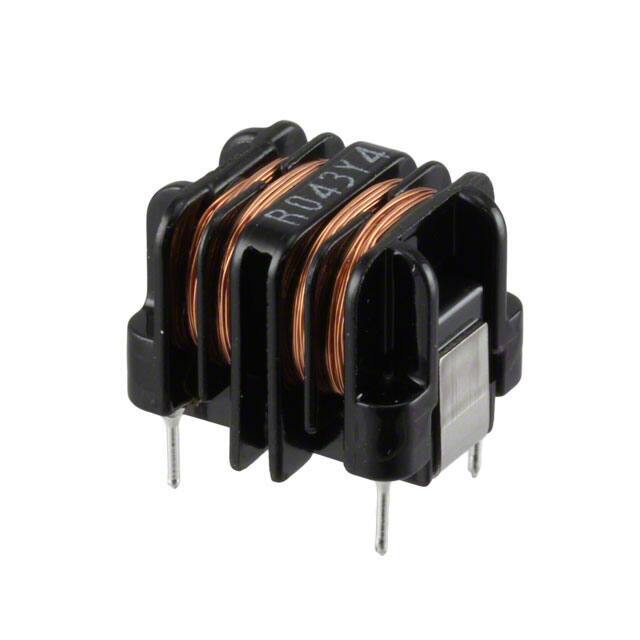

SU10VFC-R04250 数据手册
AC Line Filters Common Mode SU Coils, 10VFC-R Series Overview Applications The KEMET SU coils are common mode chokes with a wide variety of characteristics. These gear type coils are designed with our proprietary ferrite UU cores and are useful in various noise countermeasure fields. • Audio-visual equipment • Office automation equipment • Digital appliances • Power supplies Benefits • Proprietary 10H ferrite material and equivalents • Suitable for ≥ 150 kHz range • Wide variety of sizes and specifications • Operating temperature range from −25°C to +120°C • UL 94 V–0 flame retardant rated bobbin Part Number System SU 10 VFC- R 03 370 Series Core Size Code Core Orientation Core Type Rated Current (A) Inductance (mH) Minimum SU 10 VFC = Vertical Blank = Standard R = High permeability 0x = 0.x A xx = x.x A xx0 = xx mH 0xx = x.x mH Examples: 03 = 0.3 A 15 = 1.5 A Examples: 370 = 37 mH 025 = 2.5 mH One world. One KEMET © KEMET Electronics Corporation • KEMET Tower • One East Broward Boulevard Fort Lauderdale, FL 33301 USA • 954-766-2800 • www.kemet.com LF0018_SU10VFC-R • 1/7/2020 1 AC Line Filters – Common Mode SU Coils, 10VFC-R Series Magnetic Permeability of Ferrite Material In order to achieve most efficient noise reduction, it is important to select the material according to the target frequency band. Depending on its magnetic permeability, a particular ferrite material will be effective in a certain frequency band. A schematic representation of the relationship between the magnetic permeability of each material and the corresponding effective band range is shown in Figure 1. Materials with higher magnetic permeability are effective in the lower frequency range, while those with lower magnetic permeability are effective in the higher frequency range. Thus, Mn-Zn products are mainly used for reducing conduction noise, while Ni-Zn products are commonly used for radiation noise countermeasures. The effective frequency range varies depending on core shape, size and number of windings. This frequency dependence of the magnetic permeability as shown in the figure serves for reference purposes only and it should be tested on the actual device to determine its effectiveness. S18H, S15H, 10H, 7H, 5H, 1400L and 700L are KEMET’s proprietary ferrite material names. Other materials can also be available on request. Figure 1 - Relationship between the magnetic permeability of each material and its effective frequency range 20,000 Higher magnetic permeability: Higher noise suppression effect in the lower frequency range Mn-Zn Series Magnetic Permeability S18H S15H 10H 10,000 Lower magnetic permeability: Higher noise suppression effect in the higher frequency range 7H 5H Ni-Zn Series 0 10 kHz 1400L 700L 100 kHz 1 MHz 10 MHz 100 MHz 1 GHz Effective Frequency Range © KEMET Electronics Corporation • KEMET Tower • One East Broward Boulevard Fort Lauderdale, FL 33301 USA • 954-766-2800 • www.kemet.com LF0018_SU10VFC-R • 1/7/2020 2 AC Line Filters – Common Mode SU Coils, 10VFC-R Series Dimensions – Millimeters Marking 18.0 Maximum 15.5 Maximum 13±0.5 3.5±0.7 N1 N2 10 15.0 Maximum 13 ø0.70 10±0.5 Environmental Compliance All KEMET AC line filters are RoHS Compliant. Performance Characteristics Item Rated Voltage Withstanding Voltage Insulation Resistance Rated Current Range Rated Inductance Range Inductance Measurement Condition Thermal Class Operating Temperature Range Performance Characteristics 250 VAC 2,400 VAC (2 seconds, between lines) > 100 MΩ at 500 VDC (between lines) 0.3 – 2.0 A 1 – 37 mH minimum 1 kHz E (120°C) −25°C to +120°C (include self temperature rise) © KEMET Electronics Corporation • KEMET Tower • One East Broward Boulevard Fort Lauderdale, FL 33301 USA • 954-766-2800 • www.kemet.com LF0018_SU10VFC-R • 1/7/2020 3 AC Line Filters – Common Mode SU Coils, 10VFC-R Series Table 1 – Ratings & Part Number Reference Part Number Rated Current (A) Inductance (mH) Minimum DC Resistance/ Line (Ω) Maximum Temperature Rise (K) Maximum Marking Weight (g) Approximate SU10VFC-R03370 SU10VFC-R04250 SU10VFC-R05140 SU10VFC-R07088 SU10VFC-R10045 SU10VFC-R13025 SU10VFC-R15019 SU10VFC-R17016 SU10VFC-R20010 0.3 0.4 0.5 0.7 1.0 1.3 1.5 1.7 2.0 37.0 25.0 14.0 8.8 4.5 2.5 1.9 1.6 1.0 4.20 2.80 1.60 1.10 0.55 0.30 0.24 0.21 0.15 45 45 45 50 50 50 50 55 55 R03 Lot No. R04 Lot No. R05 Lot No. R07 Lot No. R10 Lot No. R13 Lot No. R15 Lot No. R17 Lot No. R20 Lot No. 6.5 6.5 6.4 6.3 6.4 6.6 6.5 6.2 6.2 Frequency Characteristics 1M SU10VFC-R03370 1M 10k 10k Impedance (Ω) 100k Impedance (Ω) 100k 1k 100 10 1k 100 10 1 1 1k 1M 10k 100k Frequency (Hz) 1M 10M 30M 1k SU10VFC-R05140 1M 10k 10k Impedance (Ω) 100k Impedance (Ω) 100k 1k 100 10 100k Frequency (Hz) 1M 10M 30M 1M 10M 30M 1M 10M 30M SU10VFC-R07088 1k 100 1 1k 10k 100k Frequency (Hz) 1M 10M 30M 1k SU10VFC-R10045 1M 100k 10k 10k Impedance (Ω) 100k Impedance (Ω) 10k 10 1 1M SU10VFC-R04250 1k 100 10k 100k Frequency (Hz) SU10VFC-R13025 1k 100 10 10 1 1 1k 10k 100k Frequency (Hz) 1M 10M 30M © KEMET Electronics Corporation • KEMET Tower • One East Broward Boulevard Fort Lauderdale, FL 33301 USA • 954-766-2800 • www.kemet.com 1k 10k 100k Frequency (Hz) LF0018_SU10VFC-R • 1/7/2020 4 Impedance (Ω Impedance (Ω 10k 1k 100 10 1 10k 100k Frequency (Hz) 1M 1k 100 10 AC Line Filters – Common Mode SU Coils, 10VFC-R Series 1k 10k 1 10M 30M 1k 10k Frequency Characteristics cont. 1M SU10VFC-R10045 1M 10k 10k Impedance (Ω) 100k Impedance (Ω) 100k 1k 100 1k 30M 1M 10M 30M 1M 10M 30M SU10VFC-R13025 1k 100 10k 100k Frequency (Hz) 1M 10M 1k 30M SU10VFC-R15019 1M 100k 10k 10k Impedance (Ω) 100k Impedance (Ω) 10M 1 1 1k 100 10 10k 100k Frequency (Hz) SU10VFC-R17016 1k 100 10 1 1 1k 1M 1M 10 10 1M 100k Frequency (Hz) 10k 100k Frequency (Hz) 1M 10M 30M 1M 10M 30M 1k 10k 100k Frequency (Hz) SU10VFC-R20010 Impedance (Ω) 100k 10k 1k 100 10 1 1k 10k 100k Frequency (Hz) © KEMET Electronics Corporation • KEMET Tower • One East Broward Boulevard Fort Lauderdale, FL 33301 USA • 954-766-2800 • www.kemet.com LF0018_SU10VFC-R • 1/7/2020 5 AC Line Filters – Common Mode SU Coils, 10VFC-R Series Packaging Type Packaging Type Pieces Per Box SU10VFC-R Tray 700 Handling Precautions Precautions for product storage AC Line Filters should be stored in normal working environments. While the chokes themselves are quite robust in other environments, solderability will be degraded by exposure to high temperatures, high humidity, corrosive atmospheres, and long term storage. KEMET recommends that maximum storage temperature not exceed 40°C and maximum storage humidity not exceed 70% relative humidity. Atmospheres should be free of chlorine and sulfur bearing compounds. Temperature fluctuations should be minimized to avoid condensation on the parts. Avoid storage near strong magnetic fields, as this might magnetize the product. For optimized solderability, AC line filters stock should be used promptly and preferably within 6 months of receipt. Product temperature rise values The values listed for temperature rise are the result of self-heating in wires when the rated current (commercial frequency) is applied. When using the product, check and evaluate the value of the core temperature rise under actual operating conditions. © KEMET Electronics Corporation • KEMET Tower • One East Broward Boulevard Fort Lauderdale, FL 33301 USA • 954-766-2800 • www.kemet.com LF0018_SU10VFC-R • 1/7/2020 6 AC Line Filters – Common Mode SU Coils, 10VFC-R Series KEMET Electronics Corporation Sales Offices For a complete list of our global sales offi ces, please visit www.kemet.com/sales. Disclaimer All product specifi cations, statements, information and data (collectively, the “Information”) in this datasheet are subject to change. The customer is responsible for checking and verifying the extent to which the Information contained in this publication is applicable to an order at the time the order is placed. All Information given herein is believed to be accurate and reliable, but it is presented without guarantee, warranty, or responsibility of any kind, expressed or implied. Statements of suitability for certain applications are based on KEMET Electronics Corporation’s (“KEMET”) knowledge of typical operating conditions for such applications, but are not intended to constitute – and KEMET specifi cally disclaims – any warranty concerning suitability for a specifi c customer application or use. The Information is intended for use only by customers who have the requisite experience and capability to determine the correct products for their application. Any technical advice inferred from this Information or otherwise provided by KEMET with reference to the use of KEMET’s products is given gratis, and KEMET assumes no obligation or liability for the advice given or results obtained. Although KEMET designs and manufactures its products to the most stringent quality and safety standards, given the current state of the art, isolated component failures may still occur. Accordingly, customer applications which require a high degree of reliability or safety should employ suitable designs or other safeguards (such as installation of protective circuitry or redundancies) in order to ensure that the failure of an electrical component does not result in a risk of personal injury or property damage. Although all product–related warnings, cautions and notes must be observed, the customer should not assume that all safety measures are indicted or that other measures may not be required. When providing KEMET products and technologies contained herein to other countries, the customer must abide by the procedures and provisions stipulated in all applicable export laws and regulations, including without limitation the International Traffi c in Arms Regulations (ITAR), the US Export Administration Regulations (EAR) and the Japan Foreign Exchange and Foreign Trade Act. KEMET is a registered trademark of KEMET Electronics Corporation. © KEMET Electronics Corporation • KEMET Tower • One East Broward Boulevard Fort Lauderdale, FL 33301 USA • 954-766-2800 • www.kemet.com LF0018_SU10VFC-R • 1/7/2020 7
