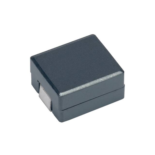

    固定电感器 Nonstandard 68nH ±10% 53A 0.31mΩ
TPI078060L068N 数据手册
SMD Inductors Large-Current Power Inductors TPI Overview Applications The KEMET TPI ferrite core inductors are designed for a very low core loss. Its flat wire, “one turn through the construction” design, enables high efficiency at large currents. The core material is ideal for high switching frequency applications. • Hard-switching topology for DC/DC conversion • Soft-switching topology for AC resonant conversion • Point of loads (POL) • Servers and storage • Supercomputers • Various decentralized power supplies The TPI series offers two solutions. One set of parts are DC optimized inductors for hard SW topology, 12 V power distribution. The other set comprises AC optimized inductors for soft SW topology, 48 V power distribution. These AC optimized inductors were developed for STC (Switched Tank Convertor) technology. Benefits • One turn coil ferrite • Operating temperature up to +125°C • High switching frequency • Low core loss • Low DCR • High current • Low self-heating • AC optimized inductor reduce close to 50% the total loss compared to conventional inductor due to optimized structure and material designed for STC technology Part Number System TPI 128080 L 180 N Series Size Code Inductor Inductance Code nH Version TPI 077050 078060 111065 118082 128080 xxx = xxx nH N = Standard Built Into Tomorrow © KEMET Electronics Corporation • KEMET Tower • One East Broward Boulevard Fort Lauderdale, FL 33301 USA • 954-766-2800 • www.kemet.com L9010_TPI • 7/6/2021 1 SMD Inductors Large-Current Power Inductors TPI Performance Characteristics Item Performance Characteristics Operating Temperature Rated Inductance Range Inductance Tolerance Rated DC Resistance DC Resistance Tolerance Rated Current –40°C to +125°C (including self-temperature rise) 47 – 230 nH at 100 kHz, 1 mA ±10% (except ±20% for TPI077050L105N) 0.29 – 0.32 mΩ ±5% (except ±9.5% for TPI077050L105N and ±10.0% for TPI078060L***N) 36 – 53 A Table 1 – Ratings & Part Number Reference – DC Optimized TPI Inductors Inductance Tolerance TPI077050L105N 105 ±20% 0.32 ±9.5% 36 TPI118082L150N 150 ±10% 0.29 ±5.0% 50 Part Number DC Resistance (mΩ) Rated Current (A) Inductance (nH) at 100 kHz, 1 mA Irms1 (Ref.) Isat2 (Ref.) 25°C 85°C 125°C 60 51 44 93 79 67 57 TPI118082L180N 180 ±10% 0.29 ±5.0% 50 79 67 TPI111065L210N 210 ±10% 0.29 ±5.0% 50 54 46 38 TPI128080L180N 180 ±10% 0.29 ±5.0% 50 78 68 54 TPI128080L210N 210 ±10% 0.29 ±5.0% 50 70 60 52 TPI128080L230N 230 ±10% 0.29 ±5.0% 50 64 56 50 T = 40 K rise at rated current Inductance drop 20% at rated current All electrical characteristics data is referenced to 25°C. 1 2 Table 2 – Ratings & Part Number Reference – AC Optimized TPI Inductors Rated Current (A) Part Number Inductance (nH) at 100 kHz, 1 mA Inductance Tolerance DC Resistance (mΩ) 25°C 85°C TPI078060L047N 47 ±10% 0.31 ±10.0% 53 90 75 67 TPI078060L056N 56 ±10% 0.31 ±10.0% 53 81 67 58 TPI078060L068N 68 ±10% 0.31 ±10.0% 53 69 58 50 TPI078060L082N 82 ±10% 0.31 ±10.0% 53 54 46 40 Irms1 (Ref.) Isat2 (Ref.) 125°C T = 40 K rise at rated current Inductance drop 20% at rated current All electrical characteristics data is referenced to 25°C. 1 2 © KEMET Electronics Corporation • KEMET Tower • One East Broward Boulevard Fort Lauderdale, FL 33301 USA • 954-766-2800 • www.kemet.com L9010_TPI • 7/6/2021 2 SMD Inductors Large-Current Power Inductors TPI DC-Superposed Characteristics 300 TPI077050L105N 25°C 100 125°C 200 150 100 50 0 20 40 IDC (A) 60 TPI078060L056N 25°C 85°C 125°C 40 20 0 20 40 60 IDC (A) 80 TPI078060L082N 25°C 85°C Inductance (nH) Inductance (nH) 40 20 100 25°C 85°C 125°C 20 0 20 40 60 IDC (A) 80 100 TPI118082L150N 25°C 85°C 125°C 200 150 100 50 0 20 40 60 80 0 100 TPI118082L180N 25°C 85°C 300 125°C 200 150 100 0 20 40 60 IDC (A) 80 100 120 TPI111065L210N 25°C 250 Inductance (nH) 250 Inductance (nH) 80 40 IDC (A) 85°C 125°C 200 150 100 50 50 0 40 60 IDC (A) TPI078060L068N 250 60 300 20 60 300 125°C 0 80 0 100 80 0 125°C 20 100 60 100 85°C 40 80 80 0 25°C 60 0 0 Inductance (nH) Inductance (nH) 100 TPI078060L047N 80 Inductance (nH) Inductance (nH) 250 85°C 0 0 20 40 60 IDC (A) 80 100 120 © KEMET Electronics Corporation • KEMET Tower • One East Broward Boulevard Fort Lauderdale, FL 33301 USA • 954-766-2800 • www.kemet.com 0 20 40 IDC (A) 60 80 L9010_TPI • 7/6/2021 3 SMD Inductors Large-Current Power Inductors TPI DC-Superposed Characteristics cont. 300 TPI128080L180N 25°C 200 150 100 300 0 25°C 250 85°C 125°C 200 150 100 20 40 60 IDC (A) 80 100 0 0 20 40 IDC (A) 60 80 100 TPI128080L230N 25°C 250 Inductance (nH) TPI128080L210N 50 50 0 300 125°C Inductance (nH) Inductance (nH) 250 85°C 85°C 125°C 200 150 100 50 0 0 20 40 60 IDC (A) 80 100 © KEMET Electronics Corporation • KEMET Tower • One East Broward Boulevard Fort Lauderdale, FL 33301 USA • 954-766-2800 • www.kemet.com L9010_TPI • 7/6/2021 4 SMD Inductors Large-Current Power Inductors TPI Dimensions Case Size Dimensions (mm) (1.5) 2.8 (1.5) 2.8 2.8 5.0 maximum TPI077050 3.5 2.5 ±0.1 7.0 maximum 7.0 maximum Land Pattern (mm) 8.0 maximum 7.0 maximum (1.5) (1.5) 6.0 maximum TPI078060 5.0 4 ±0.25 2.5 ±0.1 3.5 11.2 maximum (2.2) (2.2) 8.2 maximum 4.5 11.6 maximum (2.0) 4.5 5.8 6.5 maximum 4.5 8.0 maximum 2.3 ±0.1 3.3 (2.2) (2.2) 8.0 maximum 12.0 maximum 5.5 3.5 ±0.1 (2.0) TPI128080 3.5 3.5 10.0 maximum TPI111065 2.5 3.0 8.0 maximum TPI118082 3.0 © KEMET Electronics Corporation • KEMET Tower • One East Broward Boulevard Fort Lauderdale, FL 33301 USA • 954-766-2800 • www.kemet.com 3.5 6.3 3.5 L9010_TPI • 7/6/2021 5 SMD Inductors Large-Current Power Inductors TPI Taping Specification Dimensions of Indented Square Hole Plastic Tape P0 øD0 P2 E1 W F T P1 Reel Dimensions 1,000 TPI078060 D T TPI118082 1,000 TPI111065 500 TPI128080 400 400 F E1 P1 P2 P0 øD0 T ±0.10 1.75 ±0.10 1.75 E ±0.101 1.75 ±0.10 1.75 ±0.10 1.75 ±0.10 12.00 ±0.10 12.00 ±0.10 16.00 ±0.10 16.00 ±0.10 16.00 ±0.10 2.00 ±0.10 2.00 ±0.10 2.00 ±0.10 2.00 ±0.10 2.00 ±0.10 4.00 ±0.10 4.00 ±0.10 4.00 ±0.10 4.00 ±0.10 4.00 ±0.05 1.55 ±0.05 1.55 ±0.05 1.55 ±0.05 1.55 ±0.05 1.55 ±0.05 0.40 ±0.05 0.40 ±0.05 0.40 ±0.05 0.40 ±0.05 0.40 W TPI077050 Dimensions of Indented W W1 Tolerance ±0.30 ±0.10 Nominal 16.00 7.50 Square Plastic Tape ToleranceHole ±0.30 ±0.10 Nominal 16.00 7.50 øD0 P0 Tolerance P ±0.30 ±0.10 2 Nominal 24.00 11.50 Tolerance ±0.30 ±0.10 Nominal 24.00 11.50 Tolerance ±0.30 ±0.10 W Nominal 24.00 11.502 F C Dimensions (mm) Reel Quantity A B Case SizeE P1 Reel Specifications Reel Dimensions E C W1 A B D W2 Dimensions (mm) Case Size TPI077050 TPI078060 TPI118082 TPI111065 TPI128080 Tolerance Nominal Tolerance Nominal Tolerance Nominal Tolerance Nominal Tolerance Nominal A B C D E ±2.0 ø330 ±2.0 ø380 ±2.0 ø330 ±2.0 ø330 ±2.0 ø330 ±1.0 ø100 ±1.0 ø80 ±1.0 ø100 ±1.0 ø100 ±1.0 ø100 ±0.2 ø13.2 ±0.2 ø13.0 ±0.2 ø13.2 ±0.2 ø13.2 ±0.2 ø13.2 ±0.2 ø21.5 ±0.2 ø21.0 ±0.2 ø21.5 ±0.2 ø21.5 ±0.2 ø21.5 ±0.3 2.0 ±0.3 2.3 ±0.3 2.3 ±0.3 2.0 ±0.3 2.0 © KEMET Electronics Corporation • KEMET Tower • One East Broward Boulevard Fort Lauderdale, FL 33301 USA • 954-766-2800 • www.kemet.com W1 W2 16.5 20.9 17.5 21.5 24.5 28.9 24.5 28.9 24.5 28.9 L9010_TPI • 7/6/2021 6 SMD Inductors Large-Current Power Inductors TPI Soldering Process Recommended Reflow Soldering Profile Reference ICP/JEDEC J-STD-020E Pb-Free Assembly Preheat/Soak Temperature minimum (TSmin) Temperature maximum (TSmax) Time (ts) from Tsmin to Tsmax 150°C 200°C 60 – 120 seconds Ramp-up rate (TL to TP) 3°C/second maximum Liquidous Temperature (TL) 217°C Time Above Liquidous (tL) 60 – 150 seconds Peak Temperature (TP) 245°C for TPI1xxxxx 250°C for TPI077050 and TPI078060 Time within 5°C of Maximum Peak temperature (tP) 30 seconds maximum Ramp-down Rate (TP to TL) 6°C/second maximum Time 25°C to Peak Temperature 8 minutes maximum TP TL Temperature Profile Feature tP Maximum Ramp-up Rate = 3°C/second Maximum Ramp-down Rate = 6°C/second tL Tsmax Tsmin 25 ts 25°C to Peak Time Handling Precautions Inductors should be stored in normal working environments. While the inductors themselves are quite robust in other environments, solderability will be degraded by exposure to high temperatures, high humidity, corrosive atmospheres, and long term storage. KEMET recommends that maximum storage temperature not exceed 40°C and maximum storage humidity not exceed 70% relative humidity. Atmospheres should be free of chlorine and sulfur bearing compounds. Temperature fluctuations should be minimized to avoid condensation on the parts. For optimized solderability, inductors’ stock should be used promptly, preferably within six months of receipt. © KEMET Electronics Corporation • KEMET Tower • One East Broward Boulevard Fort Lauderdale, FL 33301 USA • 954-766-2800 • www.kemet.com L9010_TPI • 7/6/2021 7 SMD Inductors Large-Current Power Inductors TPI KEMET Electronics Corporation Sales Offices For a complete list of our global sales offices, please visit www.kemet.com/sales. Disclaimer All product specifications, statements, information and data (collectively, the “Information”) in this datasheet are subject to change. The customer is responsible for checking and verifying the extent to which the Information contained in this publication is applicable to an order at the time the order is placed. All Information given herein is believed to be accurate and reliable, but it is presented without guarantee, warranty, or responsibility of any kind, expressed or implied. Statements of suitability for certain applications are based on KEMET Electronics Corporation’s (“KEMET”) knowledge of typical operating conditions for such applications, but are not intended to constitute – and KEMET specifically disclaims – any warranty concerning suitability for a specific customer application or use. The Information is intended for use only by customers who have the requisite experience and capability to determine the correct products for their application. Any technical advice inferred from this Information or otherwise provided by KEMET with reference to the use of KEMET’s products is given gratis, and KEMET assumes no obligation or liability for the advice given or results obtained. Although KEMET designs and manufactures its products to the most stringent quality and safety standards, given the current state of the art, isolated component failures may still occur. Accordingly, customer applications which require a high degree of reliability or safety should employ suitable designs or other safeguards (such as installation of protective circuitry or redundancies) in order to ensure that the failure of an electrical component does not result in a risk of personal injury or property damage. Although all product–related warnings, cautions and notes must be observed, the customer should not assume that all safety measures are indicted or that other measures may not be required. When providing KEMET products and technologies contained herein to other countries, the customer must abide by the procedures and provisions stipulated in all applicable export laws and regulations, including without limitation the International Traffic in Arms Regulations (ITAR), the US Export Administration Regulations (EAR) and the Japan Foreign Exchange and Foreign Trade Act. KEMET is a registered trademark of KEMET Electronics Corporation. © KEMET Electronics Corporation • KEMET Tower • One East Broward Boulevard Fort Lauderdale, FL 33301 USA • 954-766-2800 • www.kemet.com L9010_TPI • 7/6/2021 8
