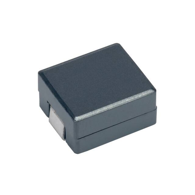

    SMD,8x7mm
    固定电感器 Nonstandard 82nH ±10% 53A 341mΩ
TPI078060L082N 数据手册
1/3 2018/6/21 Technical Data Sheet TOKIN Corporation RoHS-2 compliant Parts name TPI078060L047N TPI078060L056N TPI078060L068N TPI078060L082N Halogen Free Inductance [nH] 47±10% 56±10% 68±10% 82±10% DCR [mΩ] 0.31±10% 0.31±10% 0.31±10% 0.31±10% ISAT1 [A] ISAT2 [A] ISAT3 [A] 90 81 69 54 83 74 63 51 73 64 55 43 General Specifications ISAT1 : Peak current for approximately 20% rolloff at +25℃ ISAT2 : ISAT3 : IRMS : IRMS [A] 53 53 53 53 Electrical Requirement Note OCL : at 100kHz, 0.1Vrms, 0A, at 25℃ Peak current for approximately 20% rolloff at +60℃ Peak current for approximately 20% rolloff at +100℃ DC current for an approximate temperature rise of 40℃ without core loss. DCR : at 20℃ DCR inspection position Environmental data Operating temperature range : -40℃ to +125℃ (ambient plus self-temperature rise) Model: TPI078060L047N 60 40 20 Reference data 100℃ 80 60 40 20 0 0 0 20 40 60 DC_Current [A] 80 100 Model: TPI078060L082N 25℃ 100 25℃ 100 60℃ Reference data 100℃ 80 60 40 20 0 0 20 40 60 DC_Current [A] 80 100 0 20 40 60 DC_Current [A] 80 100 60℃ Reference data 100℃ Reference data Model: TPI078060 Series 60 50 80 60 ⊿T [℃] Inductance [nH] 60℃ Inductance [nH] 80 Model: TPI078060L068N 25℃ 100 Inductance [nH] Inductance [nH] Reference data 60℃ 100℃ 25℃ 100 Model: TPI078060L056N 40 20 40 30 20 10 0 0 0 20 40 60 DC_Current [A] 80 100 0 10 20 30 40 DC_Current [A] 50 60 Land Pattern unit: mm 2/3 Appendix 1 Temperature → Recommended Reflow Soldering Profile Time → Table 1 Pb-Free Process classification temperature (TC) Package Thickness 2000  Temperature min. (TS min) 150°C 2.5mm 250°C 245°C 245°C Ramp up rate (TS max to TP) 3°C/ second max. Liquidous temperature (TL) 217°C Time (tL) maintained above TL 60-150 seconds Peak package body temperature (TP max) Table 1 Time (tP max) within 5 °C of the specified 30 seconds classification temperature (TC) Ramp-down rate (TP to TS max) Time 25°C to Peak Temperature 6°C/ second max. 8 minutes max. *1 The TPI078060-Series shape becomes 「package thickness >2.5mm」 「volume
