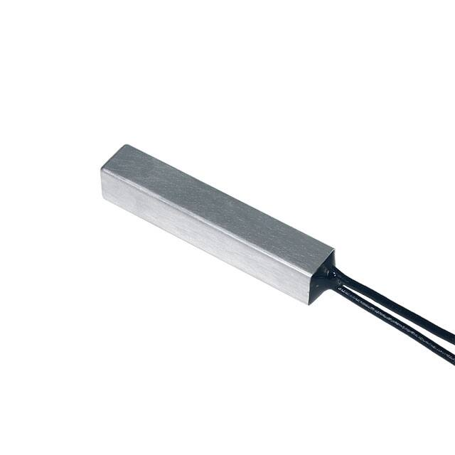

Thermal Sensors TRS Thermal Reed Switch Overview Applications The TRS Thermal Reed Switch is a highly reliable, precise temperature-sensitive switch ideal for energy conservation. Typical applications include temperature detection and overheat monitoring of electric appliances, heat-retention heater control for rice cookers, defrost for air conditioners and vending machines, roll heater temperature control for copying machines, radiator water temperature detection for automotive electric fan control. Its unique proprietary design features a magnet and a temperature-sensing soft ferromagnetic substance called Thermorite®. The material’s magnetic flux density decreases as the temperature increases turning it into a paramagnetic substance at the Curie temperature. These products have also been attested by the International Relay Association. Benefits • High reliability for on/off operations • High-speed response • Long operational life • Excellent environmental durability • Extremely simple circuit design • Compact, light and easy to handle • Dust, explosion and corrosion-proof • Wide range of operating temperatures available from −10°C to +130°C • Excellent temperature accuracy of ±2.5°C • UL and CSA approved for TRS5***BLRU 100V • UL approved for TRS5***BLRVU 200V • RoHS/REACH compliant Axial Type Wire Harness Type Case Type Molded Type Built Into Tomorrow © KEMET Electronics Corporation • KEMET Tower • One East Broward Boulevard Fort Lauderdale, FL 33301 USA • 954-766-2800 • www.kemet.com SE0201_TRS • 11/2/2021 1 Thermal Sensors – TRS Thermal Reed Switch Ordering Information M- TRS Shape 3- Maximum Series Opening/Closing Power (W) Blank M= Mold TRS 1 = 10.0 W 3 = 35.0 W 5 = 60.5 W 50 M CR 00 V U Operating Temperature (°C) Contact Type Shape Classification Lead Type Rated Voltage (VDC) Approvals B = Break M = Make Blank = Molded axial CR = C shape fixing bar LR = L shape fixing bar SR = S shape M10 = −10°C 0 = 0°C 5 = 5°C 10 = 10°C 15 = 15°C 20 = 20°C 25 = 25°C 30 = 30°C 35 = 35°C 40 = 40°C 45 = 45°C 50 = 50°C 55 = 55°C 60 = 60°C 65 = 65°C 70 = 70°C 75 = 75°C 80 = 80°C 85 = 85°C 90 = 90°C 95 = 95°C 100 = 100°C 105 = 105°C 110 = 110°C 115 = 115°C 120 = 120°C 125 = 125°C 130 = 130°C Blank 00 = Wire harness 01 = Lead terminal 01E =Lead terminal (S shape only) Blank = 100 V V = 200 V Blank = No approvals U = UL and CSA approved for 100 V and UL approved for 200 V Structures and Principles of Operation Thermal Reed Switches (TRSTM) are temperature-sensing switches composed of a magnet and a temperaturesensing soft ferromagnetic substance called ThermoriteTM. This material's saturation magnetic flux density decreases as the temperature increases, and itof turns into a paramagnetic substance at the Curie temperature. Structures and Principles Operation Thermal Reed Switches (TRS) are temperature-sensing switches composed of a magnet and a temperature-sensing soft ferromagnetic substance called Thermorite. This material’s saturation magnetic flux density decreases as the temperature Temperature sensing ferrite(Thermorite Ⓡ) increases, and it turns into a paramagnetic substance at its Curie temperature. ◆ Our self-developed Themorite is temperature sensing ferrite utilizing Curie-temperature, where ferrites lose its magnetic property. Thermorite properties Thermorite changes its magnetic property rapidly at Curie-temperature. of Thermorite as temperature sensing material.rapidly at its Curie temperature, providing quick response times. ◆ Features • Thermorite changes its magnetic property (1) Curie-temperature do not vary as time advances, because it depends on compounding ratio. • The Curie temperature of Thermorite does not vary with time, as it is based on a compounding ratio. (2) Arbitrary shape available as ceramics. Thermorite is stable againstgas. moisture and hazardous gas. (3) • Stable against moist or hazardous Thermal property of Thermorite Permeability - temperature TC=60 TC=90 Permeability TC=120 4000 3000 TC=150 2000 1000 0 20 40 60 80 100 120 140 160 3500 Saturation magnetic flux density TC=30 5000 0 Saturation magnetic flux density ‒ temperature (1kHz-0.01Oe) 6000 3000 2500 2000 TC=150 TC=90 1500 TC=60 1000 TC=120 TC=30 500 0 0 20 40 Temperature (℃) 60 80 100 120 140 160 Temperature(℃) TC=Curie temperature Encasing Structure of reed switch ◆ Reed switch is contact switch comprised of a pair of Fe-Ni alloy reeds encased in glass tube with inactive gas. The reeds are switched on or off Inactive gas by magnetic field of permanent magnet or magnet coil. ◆ Long lifetime, High environmental resistance because of protected contact by glass encasing. N ◆ Reeds in glass tube become magnetized with S magnetic field, and then two reeds contact and © KEMET Electronics Corporation • KEMET Tower • One East Broward Boulevard connect each other (switch on). And then magnetic Fort Lauderdale, FL 33301 USA • 954-766-2800 • www.kemet.com field disappears, the reeds separate and disconnect (switch off). Glass tube Contact Fe-Ni alloy reed S N N S SE0201_TRS • 11/2/2021 2 TC=150 2000 1000 Thermal Sensors – TRS Thermal Reed Switch 0 0 20 40 60 80 100 120 140 160 Saturation magneti Permeabi 3000 2000 TC=60 1000 TC=120 TC=30 500 0 0 20 40 Temperature(℃) 60 80 100 120 140 160 Temperature(℃) Structures and PrinciplesTC=Curie of Operation cont. temperature Reed switch structure • The reed switch is a contact switch comprised Structure of reed switch of a pair of Fe-Ni alloy reeds encased in a glass tube switch with inactive Thecomprised reeds areofswitched is contactgas. switch a pair of ◆ Reed reeds encasedmagnet in glass or tube on or off by the magneticFe-Ni field alloy of a permanent magnet coil. with inactive gas. The reeds are switched on or off • The reeds in the glass tube become magnetized from the magnetic by magnetic field of permanent magnet or magnet field, allowing the two reeds coil.to make contact and connect (switch on). Long lifetime, resistance When the magnetic field the High reedsenvironmental separate and disconnect ◆disappears, because of protected contact by glass encasing. (switch off). ◆ Reeds in glass tube become magnetized with • The glass encasement ofmagnetic the reedsfield, ensures high environmental and then two reeds contact and resistance and a long operational life. connect each other (switch on). And then magnetic TC=150 TC=90 1500 Encasing Glass tube Inactive gas Contact S N S Fe-Ni alloy reed N N S field disappears, the reeds separate and disconnect (switch off). TRS principle: Break (B) type TRS principle : Break (B) type TRS principle : Break (B) type ( ■:Permanent magnet ■:Thermorite® ■:Reed switch contact area ) ( ■:Permanent magnet ■:Thermorite® ■:Reed switch contact area ) Reset temperature Action temperature Reset temperature Action temperature Low temperature Low temperature Thermal magnet = paramagnet Thermal magnet = paramagnet N N S S S S N N S S N N S S N N S S N N S S N N S S N N NEC TOKIN Sensors Vol.14 5 S S N N S N specifications ●All in this catalog and production products S N S status of N S are subject to change without notice. Prior to the purchase, please contact NEC TOKIN for updated product data. S N Srequest for a specification sheet N S N data S prior to the purchase. ●Please for detailed product ●Before using the product in this catalog, please read "Precautions" and other safety precautions listed in the printed version catalog. N N <Magnetic Field of Contact Part> <Magnetic Field of Contact Part> Magnetic Flux Forming => Reed switch ON Magnetic Flux Forming => Reed switch ON S S High temperature High temperature Thermal magnet = NO magnetic Thermal magnet = NO magnetic N N S S <Magnetic Field of Contact Part> <Magnetic Field of Contact Part> Magnetic Flux ≒0 => Reed switch OFF Magnetic Flux ≒0 => Reed switch OFF 2015.3.31 0000SENVOL14E1503H1 N N Switch ON Switch ON Switch OFF Switch OFF TRS principle: Make (M) type TRS principle : Make (M) type TRS principle : Make (M) type ( ■:Permanent magnet ■:Thermorite® ■:Gapspacer(SP) ■:Reed switch contact area ) ( ■:Permanent magnet ■:Thermorite® ■:Gapspacer(SP) ■:Reed switch contact area ) Reset temperature Action temperature Reset temperature Action temperature Low temperature Low temperature High temperature High temperature Thermal magnet = paramagnet Thermal magnet = paramagnet Thermal magnet = NO magnetic Thermal magnet = NO magnetic N N S S N N S S S S S S N N N N S S N N S S S S N N N N S SP N S SP N S SP N S SP N S S S S N N N N <Magnetic Field of Contact Part> <Magnetic Field of Contact Part> Magnetic Flux ≒0 => Reed switch OFF Magnetic Flux ≒0 => Reed switch OFF S S N N S S S S N N N N S S <Magnetic Field of Contact Part> <Magnetic Field of Contact Part> N N S S N N Switch OFF Switch OFF N N S S Switch ON Switch ON 6 NEC TOKIN Sensors Vol.14 6 NEC TOKIN Sensors Vol.14 © KEMET Electronics Corporation • KEMET Tower • One East Broward Boulevard Fort Lauderdale, FL 33301 USA • 954-766-2800 • www.kemet.com ●All specifications in this catalog and production status of products are subject to change without notice. Prior to the purchase, please contact NEC TOKIN for updated product data. ●All specifications catalog and production status of products are to subject to change without notice. Prior to the purchase, please contact NEC TOKIN for updated product data. ●Please request forinathis specification sheet for detailed product data prior the purchase. ●Please request a specification sheet for detailed data prior the purchase. ●Before using theforproduct in this catalog, please readproduct "Precautions" andtoother safety precautions listed in the printed version catalog. ●Before using the product in this catalog, please read "Precautions" and other safety precautions listed in the printed version catalog. 2015.3.31 0000SENVOL14E1503H1 2015.3.31 0000SENVOL14E1503H1 SE0201_TRS • 11/2/2021 3 External magnetic field Thermal Sensors – TRS Thermal Reed Switch TRS/OHD installation direction in external magnetic field External Magnetic Field Magnetic field emitting equipment such as motors, coils External magnetic fieldequipment Magnetic field from TRS/OHD installationin direction in external magnetic TRS installation external magnetic field field Magnetic field emitting equipment such as motors, coils Magnetic field from equipment Wrong direction Correct direction N N S S Wrong direction Correct direction N N S S S N N S S S N Magnet inside TRS is perpendicular to the external field → Less influence N Magnet inside TRS is parallel to the external field → Greater Influence Magnet inside TRS is parallel to the external field → Greater Influence Magnet inside TRS is perpendicular to the external field → Less influence Ferromagnetic material influence Operation temperature variation (°C) Ferromagnetic material influence 3 2 Ferromagnetic material influence 1 -2 -3 -4 -5 Operation temperature variation (°C) 0 -1 3 BType 2 MType 1 TRS 0 -1 -2 0 BType 2 4 -3 6 8 10 12 Gap distance_d(mm) -4 -5 14 d MType Soft iron (thickness 3.3mm) 16 TRS Note; Above figures are for reference only and are not guarantee d values.d 0 2 4 6 8 10 12 Gap distance_d(mm) 14 16 Soft iron (thickness 3.3mm) TM Before Using Thermal Reed Switch (TRS ) Note; Above figures are for reference only and are not guarantee d values. • Please ask for a copy of specification and check the contents thoroughly before the actual use. • Please contact us before deciding your specifications. • Do not use in close proximity to strongly magnetized parts. TM Before Thermal Reed Switch (TRS ) • Do not useUsing if dropped or strongly shocked. • Please forgreater a copyload of specifi • Do NOT useask with thancation specifiand ed. check the contents thoroughly before the actual use. W h•ePlease n i nstalcontact l i ng thesus e sbefore wi tchedeciding s i n ci rcuiyour ts prospecifi ne to cations. produci ng surge vol tage ( i nducti ve l oad) or rush current • Do not usemotors), in closean proximity to strongly magnetized parts. (in lamps and appropriate switch type should be used, or a contact point protection circuit added. • A vo•iDo d stnot ress use ( espifecdropped i al l y torsor i onstrongly ) i n case shocked. of addi ti onal processi ng. NOT use with than specifi ed. • Each• Do reed switch has agreater specificload resonance frequency. Please contact us when an oscillation is added. W hen i nstal l i ng these swi tches i n ci rcui ts prone to produci ng surge vol tage ( i nducti ve l oad) or rush current (in lamps and motors), an appropriate switch type should be used, or a contact point protection circuit added. • A voi d stress ( especi al l y torsi on) i n case of addi ti onal processi ng. NEC TOKIN Sensors Vol.14  7 • Each reed switch has a specific resonance frequency. Please contact us when an oscillation is added. cifications in this catalog and production status ofopr request for a specification sheet for detailed product d using the product in this catalog, please read "Precau t ducts are subject to change without notice. Prior to the purch a ata prior to the purchase . ions" and other safety precautions listed in the printed versi o © KEMET Electronics Corporation • KEMET Tower • One East Broward Boulevard NECNEC TOKIN Vol.14  7 .data se, please contact TOKINSensors for updated product n catalog. All specifications in this catalog and production status ofopr ducts are subject to change without notice. Prior to the purch a Fort FL 33301 USAproduct • 954-766-2800 Please request for aLauderdale, specification sheet for detailed d ata prior •towww.kemet.com the purchase . Before using the product in this catalog, please read "Precau t ions" and other safety precautions listed in the printed versi o 2015.3.31 0000SENVOL14E1503H 1SE0201_TRS • 11/2/2021 se, please contact NEC TOKIN for updated product .data n catalog. 4 Thermal Sensors – TRS Thermal Reed Switch Dimensions – Millimeters Part Number Dimensions - Millimeters TRS5-***BLR00 TRS5-***BLR00V TRS1-***MLR00V TRS3-***MLR00 TRS5-***BLRU TRS5-***BLRVU © KEMET Electronics Corporation • KEMET Tower • One East Broward Boulevard Fort Lauderdale, FL 33301 USA • 954-766-2800 • www.kemet.com SE0201_TRS • 11/2/2021 5 Thermal Sensors – TRS Thermal Reed Switch Dimensions – Millimeters cont. Part Number Dimensions - Millimeters TRS1-***MCR01V TRS3-***MCR01 TRS5-***BCR01 TRS5-***BCR01V TRS5-***BCR00 TRS5-***BCR00V TRS1-***MCR00V TRS3-***MCR00 © KEMET Electronics Corporation • KEMET Tower • One East Broward Boulevard Fort Lauderdale, FL 33301 USA • 954-766-2800 • www.kemet.com SE0201_TRS • 11/2/2021 6 Thermal Sensors – TRS Thermal Reed Switch Dimensions – Millimeters cont. Part Number Dimensions - Millimeters TRS1-***MSR01EV TRS3-***MSR01E TRS5-***BSR01E TRS5-***BSR01EV M-TRS5-***B Environmental Compliance All KEMET Thermal Sensors are RoHS compliant. © KEMET Electronics Corporation • KEMET Tower • One East Broward Boulevard Fort Lauderdale, FL 33301 USA • 954-766-2800 • www.kemet.com SE0201_TRS • 11/2/2021 7 Thermal Sensors – TRS Thermal Reed Switch Approvals Certification Body File Number Part Type UL E67648 TRS5-***BLRU TRS5-***BLRVU CSA LR50414 TRS5-***BLRU Performance Characteristics Item Operations Condition Performance Characteristics All types TRS5-***BCR00, TRS5-***BLR00, TRS5-***BSR01E, TRS5-***BLRU and TRS5-***BCR01 TRS3-***MCR00, TRS3-***MLR00, TRS3-***MSR01E and TRS3-***MCR01 TRS5-***BCR00V, TRS5-***BLR00V, TRS5-***BSR01EV and TRS5-***BCR01V TRS3-***MCR00V, TRS3-***MLR00V, TRS3-***MSR01EV and TRS1-***MCR01V 100,000 times 110 VAC – 200 Ω (purely resistive load) 110 VAC – 346 Ω (purely resistive load) 240 VAC – 1,143 Ω (purely resistive load) 200 VAC – 4,445 Ω (purely resistive load) TRS5-***BLRVU 240 VAC – 952 Ω (purely resistive load) M-TRS5-***B 100 VAC – 200 Ω (purely resistive load) Judgement All types 1) No stick 2) Contact resistance be within 500 mΩ Dip Washing TRS5-***BCR01, TRS3-***MCR01, TRS5-***BCR01V, TRS1-***MCR01V and M-TRS5-***B Using isopropyl alcohol at normal temperature for 90 seconds Lead Wire Material Lead Wire Size Lead Wire Color TRS5-***BCR00, TRS5-***BLR00, TRS3-***MCR00, TRS3-***MLR00, TRS5-***BCR00V, TRS5-***BLR00V, TRS3-***MCR00V, TRS3-***MLR00V, TRS5-***BLRU and TRS5-***BLRVU TRS5-***BSR01E, TRS3-***MSR01E, TRS5-***BSR01EV and TRS3-***MSR01EV TRS5-***BCR00, TRS5-***BLR00, TRS3-***MCR00, TRS3-***MLR00, TRS5-***BCR00V, TRS5-***BLR00V, TRS3-***MCR00V, TRS3-***MLR00V, TRS5-***BLRU and TRS5-***BLRVU TRS5-***BSR01E, TRS3-***MSR01E, TRS5-***BSR01EV and TRS3-***MSR01EV TRS5-***BCR00, TRS5-***BLR00, TRS3-***MCR00, TRS3-***MLR00, TRS5-***BCR00V, TRS5-***BLR00V, TRS3-***MCR00V and TRS3-***MLR00V TRS5-***BSR01E, TRS3-***MSR01E, TRS5-***BSR01EV and TRS3-***MSR01EV TRS5-***BLRU and TRS5-***BLRVU © KEMET Electronics Corporation • KEMET Tower • One East Broward Boulevard Fort Lauderdale, FL 33301 USA • 954-766-2800 • www.kemet.com Silicone rubber glass braided wire Vinyl chloride wire 0.5 mm2 0.3 mm2 Red and white Black White SE0201_TRS • 11/2/2021 8 Thermal Sensors – TRS Thermal Reed Switch Insulation & Temperature Characteristics Shape Type Insulation Withstand Voltage1 Minimum Insulation Resistance1 Operating Temperature Range Switching Temperature Range −20°C to +130°C 0°C to +130°C Switching Temperature Precision2 Differential Temperature3 ±2.5°C 10°C Maximum" CR00 CR01 LR00 LRU 1,500 VAC/1 minute or 1,800 VAC/1 second 500 VDC to 100 MΩ SR01E −20°C to +100°C −10°C to +100°C 1,000 VAC/1 minute or −20°C to +150°C −10°C to +130°C 1,200 VAC/1 second 1 Between wire harness and mounting resin surface. 2 Switching temperature precision does not include measurement error. 3 The differential temperature is also referred to as the hysteresis temperature on thermal sensors. M-TRS Table 1 – Ratings & Part Number Reference Contact Type Maximum Opening/ Closing Voltage (V) Maximum Opening/ Closing Current (A) Maximum Opening/ Closing Power (W) Minimum Opening/ Closing Current Maximum Contact Resistance (mΩ) Weight (g) Approval 10°C Make 220 AC 0.045 AC 10.0 AC 1 mA/5 VDC 150 8.1 - Part Number Switching Temperature (°C) Maximum Differential Temperature (°C) TRS1-0MCR00V 0°C ±2.5°C TRS1-10MCR00V 10°C ±2.5°C 10°C Make 220 AC 0.045 AC 10.0 AC 1 mA/5 VDC 150 8.1 - TRS1-20MCR00V 20°C ±2.5°C 10°C Make 220 AC 0.045 AC 10.0 AC 1 mA/5 VDC 150 8.1 - TRS1-30MCR00V 30°C ±2.5°C 10°C Make 220 AC 0.045 AC 10.0 AC 1 mA/5 VDC 150 8.1 - TRS1-40MCR00V 40°C ±2.5°C 10°C Make 220 AC 0.045 AC 10.0 AC 1 mA/5 VDC 150 8.1 - TRS1-50MCR00V 50°C ±2.5°C 10°C Make 220 AC 0.045 AC 10.0 AC 1 mA/5 VDC 150 8.1 - TRS1-60MCR00V 60°C ±2.5°C 10°C Make 220 AC 0.045 AC 10.0 AC 1 mA/5 VDC 150 8.1 - TRS1-70MCR00V 70°C ±2.5°C 10°C Make 220 AC 0.045 AC 10.0 AC 1 mA/5 VDC 150 8.1 - TRS1-80MCR00V 80°C ±2.5°C 10°C Make 220 AC 0.045 AC 10.0 AC 1 mA/5 VDC 150 8.1 - TRS1-90MCR00V 90°C ±2.5°C 10°C Make 220 AC 0.045 AC 10.0 AC 1 mA/5 VDC 150 8.1 - TRS1-100MCR00V 100°C ±2.5°C 10°C Make 220 AC 0.045 AC 10.0 AC 1 mA/5 VDC 150 8.1 - TRS1-110MCR00V 110°C ±2.5°C 10°C Make 220 AC 0.045 AC 10.0 AC 1 mA/5 VDC 150 8.1 - TRS1-120MCR00V 120°C ±2.5°C 10°C Make 220 AC 0.045 AC 10.0 AC 1 mA/5 VDC 150 8.1 - TRS1-0MCR01V 0°C ±2.5°C 10°C Make 220 AC 0.045 AC 10.0 AC 1 mA/5 VDC 150 3.4 - TRS1-10MCR01V 10°C ±2.5°C 10°C Make 220 AC 0.045 AC 10.0 AC 1 mA/5 VDC 150 3.4 - TRS1-20MCR01V 20°C ±2.5°C 10°C Make 220 AC 0.045 AC 10.0 AC 1 mA/5 VDC 150 3.4 - TRS1-30MCR01V 30°C ±2.5°C 10°C Make 220 AC 0.045 AC 10.0 AC 1 mA/5 VDC 150 3.4 - TRS1-40MCR01V 40°C ±2.5°C 10°C Make 220 AC 0.045 AC 10.0 AC 1 mA/5 VDC 150 3.4 - TRS1-50MCR01V 50°C ±2.5°C 10°C Make 220 AC 0.045 AC 10.0 AC 1 mA/5 VDC 150 3.4 - TRS1-60MCR01V 60°C ±2.5°C 10°C Make 220 AC 0.045 AC 10.0 AC 1 mA/5 VDC 150 3.4 - TRS1-70MCR01V 70°C ±2.5°C 10°C Make 220 AC 0.045 AC 10.0 AC 1 mA/5 VDC 150 3.4 - © KEMET Electronics Corporation • KEMET Tower • One East Broward Boulevard Fort Lauderdale, FL 33301 USA • 954-766-2800 • www.kemet.com SE0201_TRS • 11/2/2021 9 Thermal Sensors – TRS Thermal Reed Switch Table 1 – Ratings & Part Number Reference cont. Contact Type Maximum Opening/ Closing Voltage (V) Maximum Opening/ Closing Current (A) Maximum Opening/ Closing Power (W) Minimum Opening/ Closing Current Maximum Contact Resistance (mΩ) Weight (g) Approval 10°C Make 220 AC 0.045 AC 10.0 AC 1 mA/5 VDC 150 3.4 - 10°C Make 220 AC 0.045 AC 10.0 AC 1 mA/5 VDC 150 3.4 - 100°C ±2.5°C 10°C Make 220 AC 0.045 AC 10.0 AC 1 mA/5 VDC 150 3.4 - Part Number Switching Temperature (°C) Maximum Differential Temperature (°C) TRS1-80MCR01V 80°C ±2.5°C TRS1-90MCR01V 90°C ±2.5°C TRS1-100MCR01V TRS1-110MCR01V 110°C ±2.5°C 10°C Make 220 AC 0.045 AC 10.0 AC 1 mA/5 VDC 150 3.4 - TRS1-120MCR01V 120°C ±2.5°C 10°C Make 220 AC 0.045 AC 10.0 AC 1 mA/5 VDC 150 3.4 - TRS1-0MLR00V 0°C ±2.5°C 10°C Make 220 AC 0.045 AC 10.0 AC 1 mA/5 VDC 150 8.5 - TRS1-10MLR00V 10°C ±2.5°C 10°C Make 220 AC 0.045 AC 10.0 AC 1 mA/5 VDC 150 8.5 - TRS1-20MLR00V 20°C ±2.5°C 10°C Make 220 AC 0.045 AC 10.0 AC 1 mA/5 VDC 150 8.5 - TRS1-30MLR00V 30°C ±2.5°C 10°C Make 220 AC 0.045 AC 10.0 AC 1 mA/5 VDC 150 8.5 - TRS1-40MLR00V 40°C ±2.5°C 10°C Make 220 AC 0.045 AC 10.0 AC 1 mA/5 VDC 150 8.5 - TRS1-50MLR00V 50°C ±2.5°C 10°C Make 220 AC 0.045 AC 10.0 AC 1 mA/5 VDC 150 8.5 - TRS1-60MLR00V 60°C ±2.5°C 10°C Make 220 AC 0.045 AC 10.0 AC 1 mA/5 VDC 150 8.5 - TRS1-70MLR00V 70°C ±2.5°C 10°C Make 220 AC 0.045 AC 10.0 AC 1 mA/5 VDC 150 8.5 - TRS1-80MLR00V 80°C ±2.5°C 10°C Make 220 AC 0.045 AC 10.0 AC 1 mA/5 VDC 150 8.5 - TRS1-90MLR00V 90°C ±2.5°C 10°C Make 220 AC 0.045 AC 10.0 AC 1 mA/5 VDC 150 8.5 - TRS1-100MLR00V 100°C ±2.5°C 10°C Make 220 AC 0.045 AC 10.0 AC 1 mA/5 VDC 150 8.5 - TRS1-110MLR00V 110°C ±2.5°C 10°C Make 220 AC 0.045 AC 10.0 AC 1 mA/5 VDC 150 8.5 - TRS1-120MLR00V 120°C ±2.5°C 10°C Make 220 AC 0.045 AC 10.0 AC 1 mA/5 VDC 150 8.5 - TRS1-130MLR00V 130°C ±2.5°C 10°C Make 220 AC 0.045 AC 10.0 AC 1 mA/5 VDC 150 8.5 - TRS1-M10MSR01EV -10°C ±2.5°C 10°C Make 220 AC 0.045 AC 10.0 AC 1 mA/5 VDC 300 7.2 - TRS1-0MSR01EV 0°C ±2.5°C 10°C Make 220 AC 0.045 AC 10.0 AC 1 mA/5 VDC 300 7.2 - TRS1-10MSR01EV 10°C ±2.5°C 10°C Make 220 AC 0.045 AC 10.0 AC 1 mA/5 VDC 300 7.2 - TRS1-20MSR01EV 20°C ±2.5°C 10°C Make 220 AC 0.045 AC 10.0 AC 1 mA/5 VDC 300 7.2 - TRS1-30MSR01EV 30°C ±2.5°C 10°C Make 220 AC 0.045 AC 10.0 AC 1 mA/5 VDC 300 7.2 - TRS1-40MSR01EV 40°C ±2.5°C 10°C Make 220 AC 0.045 AC 10.0 AC 1 mA/5 VDC 300 7.2 - TRS1-50MSR01EV 50°C ±2.5°C 10°C Make 220 AC 0.045 AC 10.0 AC 1 mA/5 VDC 300 7.2 - TRS1-60MSR01EV 60°C ±2.5°C 10°C Make 220 AC 0.045 AC 10.0 AC 1 mA/5 VDC 300 7.2 - TRS1-70MSR01EV 70°C ±2.5°C 10°C Make 220 AC 0.045 AC 10.0 AC 1 mA/5 VDC 300 7.2 - TRS1-80MSR01EV 80°C ±2.5°C 10°C Make 220 AC 0.045 AC 10.0 AC 1 mA/5 VDC 300 7.2 - TRS1-90MSR01EV 90°C ±2.5°C 10°C Make 220 AC 0.045 AC 10.0 AC 1 mA/5 VDC 300 7.2 - TRS1-100MSR01EV 100°C ±2.5°C 10°C Make 220 AC 0.045 AC 10.0 AC 1 mA/5 VDC 300 7.2 - TRS3-0MCR00 0°C ±2.5°C 10°C Make 140 AC/200 DC 0.500 AC/DC 35.0 AC/10.0 DC 1 mA/5 VDC 150 8.1 - TRS3-10MCR00 10°C ±2.5°C 10°C Make 140 AC/200 DC 0.500 AC/DC 35.0 AC/10.0 DC 1 mA/5 VDC 150 8.1 - TRS3-20MCR00 20°C ±2.5°C 10°C Make 140 AC/200 DC 0.500 AC/DC 35.0 AC/10.0 DC 1 mA/5 VDC 150 8.1 - TRS3-30MCR00 30°C ±2.5°C 10°C Make 140 AC/200 DC 0.500 AC/DC 35.0 AC/10.0 DC 1 mA/5 VDC 150 8.1 - TRS3-40MCR00 40°C ±2.5°C 10°C Make 140 AC/200 DC 0.500 AC/DC 35.0 AC/10.0 DC 1 mA/5 VDC 150 8.1 - TRS3-50MCR00 50°C ±2.5°C 10°C Make 140 AC/200 DC 0.500 AC/DC 35.0 AC/10.0 DC 1 mA/5 VDC 150 8.1 - TRS3-60MCR00 60°C ±2.5°C 10°C Make 140 AC/200 DC 0.500 AC/DC 35.0 AC/10.0 DC 1 mA/5 VDC 150 8.1 - TRS3-70MCR00 70°C ±2.5°C 10°C Make 140 AC/200 DC 0.500 AC/DC 35.0 AC/10.0 DC 1 mA/5 VDC 150 8.1 - TRS3-80MCR00 80°C ±2.5°C 10°C Make 140 AC/200 DC 0.500 AC/DC 35.0 AC/10.0 DC 1 mA/5 VDC 150 8.1 - TRS3-90MCR00 90°C ±2.5°C 10°C Make 140 AC/200 DC 0.500 AC/DC 35.0 AC/10.0 DC 1 mA/5 VDC 150 8.1 - © KEMET Electronics Corporation • KEMET Tower • One East Broward Boulevard Fort Lauderdale, FL 33301 USA • 954-766-2800 • www.kemet.com SE0201_TRS • 11/2/2021 10 Thermal Sensors – TRS Thermal Reed Switch Table 1 – Ratings & Part Number Reference cont. Contact Type Maximum Opening/ Closing Voltage (V) Maximum Opening/ Closing Current (A) Maximum Opening/ Closing Power (W) Minimum Opening/ Closing Current Maximum Contact Resistance (mΩ) Weight (g) Approval 10°C Make 140 AC/200 DC 0.500 AC/DC 35.0 AC/10.0 DC 1 mA/5 VDC 150 8.1 - 10°C Make 140 AC/200 DC 0.500 AC/DC 35.0 AC/10.0 DC 1 mA/5 VDC 150 8.1 - 10°C Make 140 AC/200 DC 0.500 AC/DC 35.0 AC/10.0 DC 1 mA/5 VDC 150 8.1 - Part Number Switching Temperature (°C) Maximum Differential Temperature (°C) TRS3-100MCR00 100°C ±2.5°C TRS3-110MCR00 110°C ±2.5°C TRS3-120MCR00 120°C ±2.5°C TRS3-0MCR01 0°C ±2.5°C 10°C Make 140 AC/200 DC 0.500 AC/DC 35.0 AC/10.0 DC 1 mA/5 VDC 150 3.4 - TRS3-10MCR01 10°C ±2.5°C 10°C Make 140 AC/200 DC 0.500 AC/DC 35.0 AC/10.0 DC 1 mA/5 VDC 150 3.4 - TRS3-20MCR01 20°C ±2.5°C 10°C Make 140 AC/200 DC 0.500 AC/DC 35.0 AC/10.0 DC 1 mA/5 VDC 150 3.4 - TRS3-30MCR01 30°C ±2.5°C 10°C Make 140 AC/200 DC 0.500 AC/DC 35.0 AC/10.0 DC 1 mA/5 VDC 150 3.4 - TRS3-40MCR01 40°C ±2.5°C 10°C Make 140 AC/200 DC 0.500 AC/DC 35.0 AC/10.0 DC 1 mA/5 VDC 150 3.4 - TRS3-50MCR01 50°C ±2.5°C 10°C Make 140 AC/200 DC 0.500 AC/DC 35.0 AC/10.0 DC 1 mA/5 VDC 150 3.4 TRS3-60MCR01 60°C ±2.5°C 10°C Make 140 AC/200 DC 0.500 AC/DC 35.0 AC/10.0 DC 1 mA/5 VDC 150 3.4 - TRS3-70MCR01 70°C ±2.5°C 10°C Make 140 AC/200 DC 0.500 AC/DC 35.0 AC/10.0 DC 1 mA/5 VDC 150 3.4 - TRS3-80MCR01 80°C ±2.5°C 10°C Make 140 AC/200 DC 0.500 AC/DC 35.0 AC/10.0 DC 1 mA/5 VDC 150 3.4 - TRS3-90MCR01 90°C ±2.5°C 10°C Make 140 AC/200 DC 0.500 AC/DC 35.0 AC/10.0 DC 1 mA/5 VDC 150 3.4 - TRS3-100MCR01 100°C ±2.5°C 10°C Make 140 AC/200 DC 0.500 AC/DC 35.0 AC/10.0 DC 1 mA/5 VDC 150 3.4 - TRS3-110MCR01 110°C ±2.5°C 10°C Make 140 AC/200 DC 0.500 AC/DC 35.0 AC/10.0 DC 1 mA/5 VDC 150 3.4 - TRS3-120MCR01 120°C ±2.5°C 10°C Make 140 AC/200 DC 0.500 AC/DC 35.0 AC/10.0 DC 1 mA/5 VDC 150 3.4 - TRS3-0MLR00 0°C ±2.5°C 10°C Make 140 AC/200 DC 0.500 AC/DC 35.0 AC/10.0 DC 1 mA/5 VDC 150 8.5 - TRS3-10MLR00 10°C ±2.5°C 10°C Make 140 AC/200 DC 0.500 AC/DC 35.0 AC/10.0 DC 1 mA/5 VDC 150 8.5 - TRS3-20MLR00 20°C ±2.5°C 10°C Make 140 AC/200 DC 0.500 AC/DC 35.0 AC/10.0 DC 1 mA/5 VDC 150 8.5 - TRS3-30MLR00 30°C ±2.5°C 10°C Make 140 AC/200 DC 0.500 AC/DC 35.0 AC/10.0 DC 1 mA/5 VDC 150 8.5 TRS3-40MLR00 40°C ±2.5°C 10°C Make 140 AC/200 DC 0.500 AC/DC 35.0 AC/10.0 DC 1 mA/5 VDC 150 8.5 - TRS3-50MLR00 50°C ±2.5°C 10°C Make 140 AC/200 DC 0.500 AC/DC 35.0 AC/10.0 DC 1 mA/5 VDC 150 8.5 - TRS3-60MLR00 60°C ±2.5°C 10°C Make 140 AC/200 DC 0.500 AC/DC 35.0 AC/10.0 DC 1 mA/5 VDC 150 8.5 - TRS3-70MLR00 70°C ±2.5°C 10°C Make 140 AC/200 DC 0.500 AC/DC 35.0 AC/10.0 DC 1 mA/5 VDC 150 8.5 - TRS3-80MLR00 80°C ±2.5°C 10°C Make 140 AC/200 DC 0.500 AC/DC 35.0 AC/10.0 DC 1 mA/5 VDC 150 8.5 - TRS3-90MLR00 90°C ±2.5°C 10°C Make 140 AC/200 DC 0.500 AC/DC 35.0 AC/10.0 DC 1 mA/5 VDC 150 8.5 - TRS3-100MLR00 100°C ±2.5°C 10°C Make 140 AC/200 DC 0.500 AC/DC 35.0 AC/10.0 DC 1 mA/5 VDC 150 8.5 - TRS3-110MLR00 110°C ±2.5°C 10°C Make 140 AC/200 DC 0.500 AC/DC 35.0 AC/10.0 DC 1 mA/5 VDC 150 8.5 TRS3-120MLR00 120°C ±2.5°C 10°C Make 140 AC/200 DC 0.500 AC/DC 35.0 AC/10.0 DC 1 mA/5 VDC 150 8.5 - TRS3-130MLR00 130°C ±2.5°C 10°C Make 140 AC/200 DC 0.500 AC/DC 35.0 AC/10.0 DC 1 mA/5 VDC 150 8.5 - TRS3-M10MSR01E -10°C ±2.5°C 10°C Make 140 AC/200 DC 0.500 AC/DC 35.0 AC/10.0 DC 1 mA/5 VDC 300 7.2 - TRS3-0MSR01E 0°C ±2.5°C 10°C Make 140 AC/200 DC 0.500 AC/DC 35.0 AC/10.0 DC 1 mA/5 VDC 300 7.2 - TRS3-10MSR01E 10°C ±2.5°C 10°C Make 140 AC/200 DC 0.500 AC/DC 35.0 AC/10.0 DC 1 mA/5 VDC 300 7.2 - TRS3-20MSR01E 20°C ±2.5°C 10°C Make 140 AC/200 DC 0.500 AC/DC 35.0 AC/10.0 DC 1 mA/5 VDC 300 7.2 - TRS3-30MSR01E 30°C ±2.5°C 10°C Make 140 AC/200 DC 0.500 AC/DC 35.0 AC/10.0 DC 1 mA/5 VDC 300 7.2 - TRS3-40MSR01E 40°C ±2.5°C 10°C Make 140 AC/200 DC 0.500 AC/DC 35.0 AC/10.0 DC 1 mA/5 VDC 300 7.2 - TRS3-50MSR01E 50°C ±2.5°C 10°C Make 140 AC/200 DC 0.500 AC/DC 35.0 AC/10.0 DC 1 mA/5 VDC 300 7.2 - TRS3-60MSR01E 60°C ±2.5°C 10°C Make 140 AC/200 DC 0.500 AC/DC 35.0 AC/10.0 DC 1 mA/5 VDC 300 7.2 - TRS3-70MSR01E 70°C ±2.5°C 10°C Make 140 AC/200 DC 0.500 AC/DC 35.0 AC/10.0 DC 1 mA/5 VDC 300 7.2 - TRS3-80MSR01E 80°C ±2.5°C 10°C Make 140 AC/200 DC 0.500 AC/DC 35.0 AC/10.0 DC 1 mA/5 VDC 300 7.2 - TRS3-90MSR01E 90°C ±2.5°C 10°C Make 140 AC/200 DC 0.500 AC/DC 35.0 AC/10.0 DC 1 mA/5 VDC 300 7.2 - © KEMET Electronics Corporation • KEMET Tower • One East Broward Boulevard Fort Lauderdale, FL 33301 USA • 954-766-2800 • www.kemet.com SE0201_TRS • 11/2/2021 11 Thermal Sensors – TRS Thermal Reed Switch Table 1 – Ratings & Part Number Reference cont. Part Number Switching Temperature (°C) Maximum Differential Temperature (°C) TRS3-100MSR01E 100°C ±2.5°C 10°C TRS5-0BCR00 0°C ±2.5°C 10°C TRS5-10BCR00 10°C ±2.5°C 10°C Maximum Opening/ Closing Voltage (V) Maximum Opening/ Closing Current (A) Make 140 AC/200 DC Break 140 AC/200 DC Break Contact Type Maximum Opening/ Closing Power (W) Minimum Opening/ Closing Current Maximum Contact Resistance (mΩ) 0.500 AC/DC 35.0 AC/10.0 DC 1 mA/5 VDC 0.550 AC/DC 60.5 AC/10.0 DC 1 mA/5 VDC 140 AC/200 DC 0.550 AC/DC 60.5 AC/10.0 DC Weight (g) Approval 300 7.2 - 150 6.8 - 1 mA/5 VDC 150 6.8 - TRS5-20BCR00 20°C ±2.5°C 10°C Break 140 AC/200 DC 0.550 AC/DC 60.5 AC/10.0 DC 1 mA/5 VDC 150 6.8 - TRS5-30BCR00 30°C ±2.5°C 10°C Break 140 AC/200 DC 0.550 AC/DC 60.5 AC/10.0 DC 1 mA/5 VDC 150 6.8 - TRS5-40BCR00 40°C ±2.5°C 10°C Break 140 AC/200 DC 0.550 AC/DC 60.5 AC/10.0 DC 1 mA/5 VDC 150 6.8 - TRS5-50BCR00 50°C ±2.5°C 10°C Break 140 AC/200 DC 0.550 AC/DC 60.5 AC/10.0 DC 1 mA/5 VDC 150 6.8 - TRS5-60BCR00 60°C ±2.5°C 10°C Break 140 AC/200 DC 0.550 AC/DC 60.5 AC/10.0 DC 1 mA/5 VDC 150 6.8 - TRS5-70BCR00 70°C ±2.5°C 10°C Break 140 AC/200 DC 0.550 AC/DC 60.5 AC/10.0 DC 1 mA/5 VDC 150 6.8 TRS5-80BCR00 80°C ±2.5°C 10°C Break 140 AC/200 DC 0.550 AC/DC 60.5 AC/10.0 DC 1 mA/5 VDC 150 6.8 - TRS5-90BCR00 90°C ±2.5°C 10°C Break 140 AC/200 DC 0.550 AC/DC 60.5 AC/10.0 DC 1 mA/5 VDC 150 6.8 - TRS5-100BCR00 100°C ±2.5°C 10°C Break 140 AC/200 DC 0.550 AC/DC 60.5 AC/10.0 DC 1 mA/5 VDC 150 6.8 - TRS5-110BCR00 110°C ±2.5°C 10°C Break 140 AC/200 DC 0.550 AC/DC 60.5 AC/10.0 DC 1 mA/5 VDC 150 6.8 - TRS5-120BCR00 120°C ±2.5°C 10°C Break 140 AC/200 DC 0.550 AC/DC 60.5 AC/10.0 DC 1 mA/5 VDC 150 6.8 - TRS5-0BCR00V 0°C ±2.5°C 10°C Break 264 AC 0.275 AC 60.5 AC 1 mA/5 VDC 150 6.8 - TRS5-10BCR00V 10°C ±2.5°C 10°C Break 264 AC 0.275 AC 60.5 AC 1 mA/5 VDC 150 6.8 - TRS5-20BCR00V 20°C ±2.5°C 10°C Break 264 AC 0.275 AC 60.5 AC 1 mA/5 VDC 150 6.8 - TRS5-30BCR00V 30°C ±2.5°C 10°C Break 264 AC 0.275 AC 60.5 AC 1 mA/5 VDC 150 6.8 - TRS5-40BCR00V 40°C ±2.5°C 10°C Break 264 AC 0.275 AC 60.5 AC 1 mA/5 VDC 150 6.8 - TRS5-50BCR00V 50°C ±2.5°C 10°C Break 264 AC 0.275 AC 60.5 AC 1 mA/5 VDC 150 6.8 - TRS5-60BCR00V 60°C ±2.5°C 10°C Break 264 AC 0.275 AC 60.5 AC 1 mA/5 VDC 150 6.8 - TRS5-70BCR00V 70°C ±2.5°C 10°C Break 264 AC 0.275 AC 60.5 AC 1 mA/5 VDC 150 6.8 - TRS5-80BCR00V 80°C ±2.5°C 10°C Break 264 AC 0.275 AC 60.5 AC 1 mA/5 VDC 150 6.8 - TRS5-90BCR00V 90°C ±2.5°C 10°C Break 264 AC 0.275 AC 60.5 AC 1 mA/5 VDC 150 6.8 - TRS5-100BCR00V 100°C ±2.5°C 10°C Break 264 AC 0.275 AC 60.5 AC 1 mA/5 VDC 150 6.8 - TRS5-110BCR00V 110°C ±2.5°C 10°C Break 264 AC 0.275 AC 60.5 AC 1 mA/5 VDC 150 6.8 - TRS5-120BCR00V 120°C ±2.5°C 10°C Break 264 AC 0.275 AC 60.5 AC 1 mA/5 VDC 150 6.8 - TRS5-0BCR01 0°C ±2.5°C 10°C Break 140 AC/200 DC 0.550 AC/DC 60.5 AC/10.0 DC 1 mA/5 VDC 150 3.1 - TRS5-10BCR01 10°C ±2.5°C 10°C Break 140 AC/200 DC 0.550 AC/DC 60.5 AC/10.0 DC 1 mA/5 VDC 150 3.1 - TRS5-20BCR01 20°C ±2.5°C 10°C Break 140 AC/200 DC 0.550 AC/DC 60.5 AC/10.0 DC 1 mA/5 VDC 150 3.1 - TRS5-30BCR01 30°C ±2.5°C 10°C Break 140 AC/200 DC 0.550 AC/DC 60.5 AC/10.0 DC 1 mA/5 VDC 150 3.1 - TRS5-40BCR01 40°C ±2.5°C 10°C Break 140 AC/200 DC 0.550 AC/DC 60.5 AC/10.0 DC 1 mA/5 VDC 150 3.1 - TRS5-50BCR01 50°C ±2.5°C 10°C Break 140 AC/200 DC 0.550 AC/DC 60.5 AC/10.0 DC 1 mA/5 VDC 150 3.1 - TRS5-60BCR01 60°C ±2.5°C 10°C Break 140 AC/200 DC 0.550 AC/DC 60.5 AC/10.0 DC 1 mA/5 VDC 150 3.1 - TRS5-70BCR01 70°C ±2.5°C 10°C Break 140 AC/200 DC 0.550 AC/DC 60.5 AC/10.0 DC 1 mA/5 VDC 150 3.1 - TRS5-80BCR01 80°C ±2.5°C 10°C Break 140 AC/200 DC 0.550 AC/DC 60.5 AC/10.0 DC 1 mA/5 VDC 150 3.1 - TRS5-90BCR01 90°C ±2.5°C 10°C Break 140 AC/200 DC 0.550 AC/DC 60.5 AC/10.0 DC 1 mA/5 VDC 150 3.1 - TRS5-100BCR01 100°C ±2.5°C 10°C Break 140 AC/200 DC 0.550 AC/DC 60.5 AC/10.0 DC 1 mA/5 VDC 150 3.1 - TRS5-110BCR01 110°C ±2.5°C 10°C Break 140 AC/200 DC 0.550 AC/DC 60.5 AC/10.0 DC 1 mA/5 VDC 150 3.1 - TRS5-120BCR01 120°C ±2.5°C 10°C Break 140 AC/200 DC 0.550 AC/DC 60.5 AC/10.0 DC 1 mA/5 VDC 150 3.1 - TRS5-0BCR01V 0°C ±2.5°C 10°C Break 264 AC 0.275 AC 60.5 AC 1 mA/5 VDC 150 3.1 - © KEMET Electronics Corporation • KEMET Tower • One East Broward Boulevard Fort Lauderdale, FL 33301 USA • 954-766-2800 • www.kemet.com SE0201_TRS • 11/2/2021 12 Thermal Sensors – TRS Thermal Reed Switch Table 1 – Ratings & Part Number Reference cont. Part Number Switching Temperature (°C) Maximum Differential Temperature (°C) Contact Type Maximum Opening/ Closing Voltage (V) Maximum Opening/ Closing Current (A) Maximum Opening/ Closing Power (W) Minimum Opening/ Closing Current Maximum Contact Resistance (mΩ) Weight (g) Approval TRS5-10BCR01V 10°C ±2.5°C 10°C Break 264 AC 0.275 AC 60.5 AC 1 mA/5 VDC 150 3.1 - TRS5-20BCR01V 20°C ±2.5°C 10°C Break 264 AC 0.275 AC 60.5 AC 1 mA/5 VDC 150 3.1 - TRS5-30BCR01V 30°C ±2.5°C 10°C Break 264 AC 0.275 AC 60.5 AC 1 mA/5 VDC 150 3.1 - TRS5-40BCR01V 40°C ±2.5°C 10°C Break 264 AC 0.275 AC 60.5 AC 1 mA/5 VDC 150 3.1 - TRS5-50BCR01V 50°C ±2.5°C 10°C Break 264 AC 0.275 AC 60.5 AC 1 mA/5 VDC 150 3.1 - TRS5-60BCR01V 60°C ±2.5°C 10°C Break 264 AC 0.275 AC 60.5 AC 1 mA/5 VDC 150 3.1 - TRS5-70BCR01V 70°C ±2.5°C 10°C Break 264 AC 0.275 AC 60.5 AC 1 mA/5 VDC 150 3.1 - TRS5-80BCR01V 80°C ±2.5°C 10°C Break 264 AC 0.275 AC 60.5 AC 1 mA/5 VDC 150 3.1 - TRS5-90BCR01V 90°C ±2.5°C 10°C Break 264 AC 0.275 AC 60.5 AC 1 mA/5 VDC 150 3.1 - TRS5-100BCR01V 100°C ±2.5°C 10°C Break 264 AC 0.275 AC 60.5 AC 1 mA/5 VDC 150 3.1 - TRS5-110BCR01V 110°C ±2.5°C 10°C Break 264 AC 0.275 AC 60.5 AC 1 mA/5 VDC 150 3.1 - TRS5-120BCR01V 120°C ±2.5°C 10°C Break 264 AC 0.275 AC 60.5 AC 1 mA/5 VDC 150 3.1 - TRS5-0BLR00 0°C ±2.5°C 10°C Break 140 AC/200 DC 0.550 AC/DC 60.5 AC/10.0 DC 1 mA/5 VDC 150 7.3 - TRS5-10BLR00 10°C ±2.5°C 10°C Break 140 AC/200 DC 0.550 AC/DC 60.5 AC/10.0 DC 1 mA/5 VDC 150 7.3 - TRS5-20BLR00 20°C ±2.5°C 10°C Break 140 AC/200 DC 0.550 AC/DC 60.5 AC/10.0 DC 1 mA/5 VDC 150 7.3 - TRS5-30BLR00 30°C ±2.5°C 10°C Break 140 AC/200 DC 0.550 AC/DC 60.5 AC/10.0 DC 1 mA/5 VDC 150 7.3 - TRS5-40BLR00 40°C ±2.5°C 10°C Break 140 AC/200 DC 0.550 AC/DC 60.5 AC/10.0 DC 1 mA/5 VDC 150 7.3 - TRS5-50BLR00 50°C ±2.5°C 10°C Break 140 AC/200 DC 0.550 AC/DC 60.5 AC/10.0 DC 1 mA/5 VDC 150 7.3 - TRS5-60BLR00 60°C ±2.5°C 10°C Break 140 AC/200 DC 0.550 AC/DC 60.5 AC/10.0 DC 1 mA/5 VDC 150 7.3 - TRS5-70BLR00 70°C ±2.5°C 10°C Break 140 AC/200 DC 0.550 AC/DC 60.5 AC/10.0 DC 1 mA/5 VDC 150 7.3 - TRS5-80BLR00 80°C ±2.5°C 10°C Break 140 AC/200 DC 0.550 AC/DC 60.5 AC/10.0 DC 1 mA/5 VDC 150 7.3 - TRS5-90BLR00 90°C ±2.5°C 10°C Break 140 AC/200 DC 0.550 AC/DC 60.5 AC/10.0 DC 1 mA/5 VDC 150 7.3 - TRS5-100BLR00 100°C ±2.5°C 10°C Break 140 AC/200 DC 0.550 AC/DC 60.5 AC/10.0 DC 1 mA/5 VDC 150 7.3 - TRS5-110BLR00 110°C ±2.5°C 10°C Break 140 AC/200 DC 0.550 AC/DC 60.5 AC/10.0 DC 1 mA/5 VDC 150 7.3 - TRS5-120BLR00 120°C ±2.5°C 10°C Break 140 AC/200 DC 0.550 AC/DC 60.5 AC/10.0 DC 1 mA/5 VDC 150 7.3 - TRS5-130BLR00 130°C ±2.5°C 10°C Break 140 AC/200 DC 0.550 AC/DC 60.5 AC/10.0 DC 1 mA/5 VDC 150 7.3 - TRS5-0BLR00V 0°C ±2.5°C 10°C Break 264 AC 0.275 AC 60.5 AC 1 mA/5 VDC 150 7.3 - TRS5-10BLR00V 10°C ±2.5°C 10°C Break 264 AC 0.275 AC 60.5 AC 1 mA/5 VDC 150 7.3 - TRS5-20BLR00V 20°C ±2.5°C 10°C Break 264 AC 0.275 AC 60.5 AC 1 mA/5 VDC 150 7.3 - TRS5-30BLR00V 30°C ±2.5°C 10°C Break 264 AC 0.275 AC 60.5 AC 1 mA/5 VDC 150 7.3 - TRS5-40BLR00V 40°C ±2.5°C 10°C Break 264 AC 0.275 AC 60.5 AC 1 mA/5 VDC 150 7.3 - TRS5-50BLR00V 50°C ±2.5°C 10°C Break 264 AC 0.275 AC 60.5 AC 1 mA/5 VDC 150 7.3 - TRS5-60BLR00V 60°C ±2.5°C 10°C Break 264 AC 0.275 AC 60.5 AC 1 mA/5 VDC 150 7.3 - TRS5-70BLR00V 70°C ±2.5°C 10°C Break 264 AC 0.275 AC 60.5 AC 1 mA/5 VDC 150 7.3 - TRS5-80BLR00V 80°C ±2.5°C 10°C Break 264 AC 0.275 AC 60.5 AC 1 mA/5 VDC 150 7.3 - TRS5-90BLR00V 90°C ±2.5°C 10°C Break 264 AC 0.275 AC 60.5 AC 1 mA/5 VDC 150 7.3 - TRS5-100BLR00V 100°C ±2.5°C 10°C Break 264 AC 0.275 AC 60.5 AC 1 mA/5 VDC 150 7.3 - TRS5-110BLR00V 110°C ±2.5°C 10°C Break 264 AC 0.275 AC 60.5 AC 1 mA/5 VDC 150 7.3 - TRS5-120BLR00V 120°C ±2.5°C 10°C Break 264 AC 0.275 AC 60.5 AC 1 mA/5 VDC 150 7.3 - TRS5-130BLR00V 130°C ±2.5°C 10°C Break 264 AC 0.275 AC 60.5 AC 1 mA/5 VDC 150 7.3 - TRS5-0BLRU 0°C ±2.5°C 10°C Break 140 AC 0.500 AC 50.0 AC 1 mA/5 VDC 150 8.5 UL & CSA © KEMET Electronics Corporation • KEMET Tower • One East Broward Boulevard Fort Lauderdale, FL 33301 USA • 954-766-2800 • www.kemet.com SE0201_TRS • 11/2/2021 13 Thermal Sensors – TRS Thermal Reed Switch Table 1 – Ratings & Part Number Reference cont. Part Number Switching Temperature (°C) Maximum Differential Temperature (°C) Contact Type Maximum Opening/ Closing Voltage (V) Maximum Opening/ Closing Current (A) Maximum Opening/ Closing Power (W) Minimum Opening/ Closing Current Maximum Contact Resistance (mΩ) Weight (g) Approval TRS5-5BLRU 5°C ±2.5°C 10°C Break 140 AC 0.500 AC 50.0 AC 1 mA/5 VDC 150 8.5 UL & CSA TRS5-10BLRU 10°C ±2.5°C 10°C Break 140 AC 0.500 AC 50.0 AC 1 mA/5 VDC 150 8.5 UL & CSA TRS5-15BLRU 15°C ±2.5°C 10°C Break 140 AC 0.500 AC 50.0 AC 1 mA/5 VDC 150 8.5 UL & CSA TRS5-20BLRU 20°C ±2.5°C 10°C Break 140 AC 0.500 AC 50.0 AC 1 mA/5 VDC 150 8.5 UL & CSA TRS5-25BLRU 25°C ±2.5°C 10°C Break 140 AC 0.500 AC 50.0 AC 1 mA/5 VDC 150 8.5 UL & CSA TRS5-30BLRU 30°C ±2.5°C 10°C Break 140 AC 0.500 AC 50.0 AC 1 mA/5 VDC 150 8.5 UL & CSA TRS5-35BLRU 35°C ±2.5°C 10°C Break 140 AC 0.500 AC 50.0 AC 1 mA/5 VDC 150 8.5 UL & CSA TRS5-40BLRU 40°C ±2.5°C 10°C Break 140 AC 0.500 AC 50.0 AC 1 mA/5 VDC 150 8.5 UL & CSA TRS5-45BLRU 45°C ±2.5°C 10°C Break 140 AC 0.500 AC 50.0 AC 1 mA/5 VDC 150 8.5 UL & CSA TRS5-50BLRU 50°C ±2.5°C 10°C Break 140 AC 0.500 AC 50.0 AC 1 mA/5 VDC 150 8.5 UL & CSA TRS5-55BLRU 55°C ±2.5°C 10°C Break 140 AC 0.500 AC 50.0 AC 1 mA/5 VDC 150 8.5 UL & CSA TRS5-60BLRU 60°C ±2.5°C 10°C Break 140 AC 0.500 AC 50.0 AC 1 mA/5 VDC 150 8.5 UL & CSA TRS5-65BLRU 65°C ±2.5°C 10°C Break 140 AC 0.500 AC 50.0 AC 1 mA/5 VDC 150 8.5 UL & CSA TRS5-70BLRU 70°C ±2.5°C 10°C Break 140 AC 0.500 AC 50.0 AC 1 mA/5 VDC 150 8.5 UL & CSA TRS5-75BLRU 75°C ±2.5°C 10°C Break 140 AC 0.500 AC 50.0 AC 1 mA/5 VDC 150 8.5 UL & CSA TRS5-80BLRU 80°C ±2.5°C 10°C Break 140 AC 0.500 AC 50.0 AC 1 mA/5 VDC 150 8.5 UL & CSA TRS5-85BLRU 85°C ±2.5°C 10°C Break 140 AC 0.500 AC 50.0 AC 1 mA/5 VDC 150 8.5 UL & CSA TRS5-90BLRU 90°C ±2.5°C 10°C Break 140 AC 0.500 AC 50.0 AC 1 mA/5 VDC 150 8.5 UL & CSA TRS5-95BLRU 95°C ±2.5°C 10°C Break 140 AC 0.500 AC 50.0 AC 1 mA/5 VDC 150 8.5 UL & CSA TRS5-100BLRU 100°C ±2.5°C 10°C Break 140 AC 0.500 AC 50.0 AC 1 mA/5 VDC 150 8.5 UL & CSA TRS5-0BLRVU 0°C ±2.5°C 10°C Break 264 AC 0.275 AC 60.5 AC 1 mA/5 VDC 150 8.5 UL TRS5-5BLRVU 5°C ±2.5°C 10°C Break 264 AC 0.275 AC 60.5 AC 1 mA/5 VDC 150 8.5 UL TRS5-10BLRVU 10°C ±2.5°C 10°C Break 264 AC 0.275 AC 60.5 AC 1 mA/5 VDC 150 8.5 UL TRS5-15BLRVU 15°C ±2.5°C 10°C Break 264 AC 0.275 AC 60.5 AC 1 mA/5 VDC 150 8.5 UL TRS5-20BLRVU 20°C ±2.5°C 10°C Break 264 AC 0.275 AC 60.5 AC 1 mA/5 VDC 150 8.5 UL TRS5-25BLRVU 25°C ±2.5°C 10°C Break 264 AC 0.275 AC 60.5 AC 1 mA/5 VDC 150 8.5 UL TRS5-30BLRVU 30°C ±2.5°C 10°C Break 264 AC 0.275 AC 60.5 AC 1 mA/5 VDC 150 8.5 UL TRS5-35BLRVU 35°C ±2.5°C 10°C Break 264 AC 0.275 AC 60.5 AC 1 mA/5 VDC 150 8.5 UL TRS5-40BLRVU 40°C ±2.5°C 10°C Break 264 AC 0.275 AC 60.5 AC 1 mA/5 VDC 150 8.5 UL TRS5-45BLRVU 45°C ±2.5°C 10°C Break 264 AC 0.275 AC 60.5 AC 1 mA/5 VDC 150 8.5 UL TRS5-50BLRVU 50°C ±2.5°C 10°C Break 264 AC 0.275 AC 60.5 AC 1 mA/5 VDC 150 8.5 UL TRS5-55BLRVU 55°C ±2.5°C 10°C Break 264 AC 0.275 AC 60.5 AC 1 mA/5 VDC 150 8.5 UL TRS5-60BLRVU 60°C ±2.5°C 10°C Break 264 AC 0.275 AC 60.5 AC 1 mA/5 VDC 150 8.5 UL TRS5-65BLRVU 65°C ±2.5°C 10°C Break 264 AC 0.275 AC 60.5 AC 1 mA/5 VDC 150 8.5 UL TRS5-70BLRVU 70°C ±2.5°C 10°C Break 264 AC 0.275 AC 60.5 AC 1 mA/5 VDC 150 8.5 UL TRS5-75BLRVU 75°C ±2.5°C 10°C Break 264 AC 0.275 AC 60.5 AC 1 mA/5 VDC 150 8.5 UL TRS5-80BLRVU 80°C ±2.5°C 10°C Break 264 AC 0.275 AC 60.5 AC 1 mA/5 VDC 150 8.5 UL TRS5-85BLRVU 85°C ±2.5°C 10°C Break 264 AC 0.275 AC 60.5 AC 1 mA/5 VDC 150 8.5 UL TRS5-90BLRVU 90°C ±2.5°C 10°C Break 264 AC 0.275 AC 60.5 AC 1 mA/5 VDC 150 8.5 UL TRS5-95BLRVU 95°C ±2.5°C 10°C Break 264 AC 0.275 AC 60.5 AC 1 mA/5 VDC 150 8.5 UL TRS5-100BLRVU 100°C ±2.5°C 10°C Break 264 AC 0.275 AC 60.5 AC 1 mA/5 VDC 150 8.5 UL © KEMET Electronics Corporation • KEMET Tower • One East Broward Boulevard Fort Lauderdale, FL 33301 USA • 954-766-2800 • www.kemet.com SE0201_TRS • 11/2/2021 14 Thermal Sensors – TRS Thermal Reed Switch Table 1 – Ratings & Part Number Reference cont. Maximum Differential Temperature (°C) Contact Type Maximum Opening/ Closing Voltage (V) Maximum Opening/ Closing Current (A) Maximum Opening/ Closing Power (W) Minimum Opening/ Closing Current Maximum Contact Resistance (mΩ) Part Number Switching Temperature (°C) TRS5-M10BSR01E -10°C ±2.5°C 10°C Break 140 AC/200 DC 0.550 AC/DC 60.5 AC/10.0 DC 1 mA/5 VDC 300 6.6 - TRS5-0BSR01E 0°C ±2.5°C 10°C Break 140 AC/200 DC 0.550 AC/DC 60.5 AC/10.0 DC 1 mA/5 VDC 300 6.6 - TRS5-10BSR01E 10°C ±2.5°C 10°C Break 140 AC/200 DC 0.550 AC/DC 60.5 AC/10.0 DC 1 mA/5 VDC 300 6.6 - Weight (g) Approval TRS5-20BSR01E 20°C ±2.5°C 10°C Break 140 AC/200 DC 0.550 AC/DC 60.5 AC/10.0 DC 1 mA/5 VDC 300 6.6 - TRS5-30BSR01E 30°C ±2.5°C 10°C Break 140 AC/200 DC 0.550 AC/DC 60.5 AC/10.0 DC 1 mA/5 VDC 300 6.6 - TRS5-40BSR01E 40°C ±2.5°C 10°C Break 140 AC/200 DC 0.550 AC/DC 60.5 AC/10.0 DC 1 mA/5 VDC 300 6.6 - TRS5-50BSR01E 50°C ±2.5°C 10°C Break 140 AC/200 DC 0.550 AC/DC 60.5 AC/10.0 DC 1 mA/5 VDC 300 6.6 - TRS5-60BSR01E 60°C ±2.5°C 10°C Break 140 AC/200 DC 0.550 AC/DC 60.5 AC/10.0 DC 1 mA/5 VDC 300 6.6 - TRS5-70BSR01E 70°C ±2.5°C 10°C Break 140 AC/200 DC 0.550 AC/DC 60.5 AC/10.0 DC 1 mA/5 VDC 300 6.6 - TRS5-80BSR01E 80°C ±2.5°C 10°C Break 140 AC/200 DC 0.550 AC/DC 60.5 AC/10.0 DC 1 mA/5 VDC 300 6.6 - TRS5-90BSR01E 90°C ±2.5°C 10°C Break 140 AC/200 DC 0.550 AC/DC 60.5 AC/10.0 DC 1 mA/5 VDC 300 6.6 - TRS5-100BSR01E 100°C ±2.5°C 10°C Break 140 AC/200 DC 0.550 AC/DC 60.5 AC/10.0 DC 1 mA/5 VDC 300 6.6 - TRS5-M10BSR01EV -10°C ±2.5°C 10°C Break 264 AC 0.275 AC 60.5 AC 1 mA/5 VDC 300 6.6 - TRS5-0BSR01EV 0°C ±2.5°C 10°C Break 264 AC 0.275 AC 60.5 AC 1 mA/5 VDC 300 6.6 - TRS5-10BSR01EV 10°C ±2.5°C 10°C Break 264 AC 0.275 AC 60.5 AC 1 mA/5 VDC 300 6.6 - TRS5-20BSR01EV 20°C ±2.5°C 10°C Break 264 AC 0.275 AC 60.5 AC 1 mA/5 VDC 300 6.6 - TRS5-30BSR01EV 30°C ±2.5°C 10°C Break 264 AC 0.275 AC 60.5 AC 1 mA/5 VDC 300 6.6 - TRS5-40BSR01EV 40°C ±2.5°C 10°C Break 264 AC 0.275 AC 60.5 AC 1 mA/5 VDC 300 6.6 - TRS5-50BSR01EV 50°C ±2.5°C 10°C Break 264 AC 0.275 AC 60.5 AC 1 mA/5 VDC 300 6.6 - TRS5-60BSR01EV 60°C ±2.5°C 10°C Break 264 AC 0.275 AC 60.5 AC 1 mA/5 VDC 300 6.6 - TRS5-70BSR01EV 70°C ±2.5°C 10°C Break 264 AC 0.275 AC 60.5 AC 1 mA/5 VDC 300 6.6 - TRS5-80BSR01EV 80°C ±2.5°C 10°C Break 264 AC 0.275 AC 60.5 AC 1 mA/5 VDC 300 6.6 - TRS5-90BSR01EV 90°C ±2.5°C 10°C Break 264 AC 0.275 AC 60.5 AC 1 mA/5 VDC 300 6.6 - TRS5-100BSR01EV 100°C ±2.5°C 10°C Break 264 AC 0.275 AC 60.5 AC 1 mA/5 VDC 300 6.6 - M-TRS5-M10B -10°C ±2.5°C 10°C Break 140 AC/200 DC 0.550 AC/DC 60.5 AC/10.0 DC 1 mA/5 VDC 150 4.1 - M-TRS5-0B 0°C ±2.5°C 10°C Break 140 AC/200 DC 0.550 AC/DC 60.5 AC/10.0 DC 1 mA/5 VDC 150 4.1 - M-TRS5-10B 10°C ±2.5°C 10°C Break 140 AC/200 DC 0.550 AC/DC 60.5 AC/10.0 DC 1 mA/5 VDC 150 4.1 - M-TRS5-20B 20°C ±2.5°C 10°C Break 140 AC/200 DC 0.550 AC/DC 60.5 AC/10.0 DC 1 mA/5 VDC 150 4.1 - M-TRS5-30B 30°C ±2.5°C 10°C Break 140 AC/200 DC 0.550 AC/DC 60.5 AC/10.0 DC 1 mA/5 VDC 150 4.1 - M-TRS5-40B 40°C ±2.5°C 10°C Break 140 AC/200 DC 0.550 AC/DC 60.5 AC/10.0 DC 1 mA/5 VDC 150 4.1 - M-TRS5-50B 50°C ±2.5°C 10°C Break 140 AC/200 DC 0.550 AC/DC 60.5 AC/10.0 DC 1 mA/5 VDC 150 4.1 - M-TRS5-60B 60°C ±2.5°C 10°C Break 140 AC/200 DC 0.550 AC/DC 60.5 AC/10.0 DC 1 mA/5 VDC 150 4.1 - M-TRS5-70B 70°C ±2.5°C 10°C Break 140 AC/200 DC 0.550 AC/DC 60.5 AC/10.0 DC 1 mA/5 VDC 150 4.1 - M-TRS5-80B 80°C ±2.5°C 10°C Break 140 AC/200 DC 0.550 AC/DC 60.5 AC/10.0 DC 1 mA/5 VDC 150 4.1 - M-TRS5-90B 90°C ±2.5°C 10°C Break 140 AC/200 DC 0.550 AC/DC 60.5 AC/10.0 DC 1 mA/5 VDC 150 4.1 - M-TRS5-100B 100°C ±2.5°C 10°C Break 140 AC/200 DC 0.550 AC/DC 60.5 AC/10.0 DC 1 mA/5 VDC 150 4.1 - M-TRS5-110B 110°C ±2.5°C 10°C Break 140 AC/200 DC 0.550 AC/DC 60.5 AC/10.0 DC 1 mA/5 VDC 150 4.1 - M-TRS5-120B 120°C ±2.5°C 10°C Break 140 AC/200 DC 0.550 AC/DC 60.5 AC/10.0 DC 1 mA/5 VDC 150 4.1 - M-TRS5-130B 130°C ±2.5°C 10°C Break 140 AC/200 DC 0.550 AC/DC 60.5 AC/10.0 DC 1 mA/5 VDC 150 4.1 - © KEMET Electronics Corporation • KEMET Tower • One East Broward Boulevard Fort Lauderdale, FL 33301 USA • 954-766-2800 • www.kemet.com SE0201_TRS • 11/2/2021 15 Thermal Sensors – TRS Thermal Reed Switch Table 2 – Ratings & Part Number Reference Part Type Packaging Type LR00 CR00 LRU LRVU SR01E CR01 M-TRS Pieces per Tray Pieces per Box 500 Rubber Band Tray 50 600 25 30 50 500 600 1,000 Soldering TRS1-***MCR01V, TRS3-***MCR01, TRS5-***BCR01 and TRS5-***BCR01V Flow Soldering Iron Soldering Preheating Temperature Preheating Time Heating Temperature Heating Time Temperature of Tip Worktime 100 – 150°C Within 60 seconds 260°C 10 ±1 seconds 350°C or lower Within 5 seconds Preheating Temperature Preheating Time Heating Temperature Heating Time Temperature of Tip Worktime 100 – 150°C Within 60 seconds 260°C 10 ±1 seconds 320°C or lower Within 4 seconds M-TRS5-***B Flow Soldering Iron Soldering © KEMET Electronics Corporation • KEMET Tower • One East Broward Boulevard Fort Lauderdale, FL 33301 USA • 954-766-2800 • www.kemet.com SE0201_TRS • 11/2/2021 16 Thermal Sensors – TRS Thermal Reed Switch Marking CR01 LR00 LOT CODE LOT CODE SR01E LOT CODE Lot Code 12345 (1) 1-3 digits M10 = –10°C 65 = 65°C 100 = 100°C (2) 1 digit B = Break M = Make Month of the Year (3) 1 digit 1 = January 9 = September X = October Y = November Z = December Last Digit of the Year (4) 1 digit 0 = xxx0 1 = xxx1 9 = xxx9 (5) 0-1 digit Blank = 100 V V = 200 V Operating Temperature Contact Type Voltage © KEMET Electronics Corporation • KEMET Tower • One East Broward Boulevard Fort Lauderdale, FL 33301 USA • 954-766-2800 • www.kemet.com SE0201_TRS • 11/2/2021 17 Thermal Sensors – TRS Thermal Reed Switch Marking cont. LRU & LRVU LOT CODE Lot Code 1234556 (1) 1-3 digits 0 = 0°C 65 = 65°C 100 = 100°C (2) 1 digit B = Break (3) 0-1 digit Blank = 100 V (LRU) G = 200 V (LRVU) Month of the Year (4) 1 digit 1 = January 9 = September X = October Y = November Z = December 2 Last Digits of the Year (5) 2 digits 10 = xx10 11 = xx11 19 = xx19 Factory ID (6) 1 digit 5 = Japan Operating Temperature Contact Type Contact Power © KEMET Electronics Corporation • KEMET Tower • One East Broward Boulevard Fort Lauderdale, FL 33301 USA • 954-766-2800 • www.kemet.com SE0201_TRS • 11/2/2021 18 Thermal Sensors – TRS Thermal Reed Switch Marking cont. M-TRS LOT CODE Lot Code 1–2345 (1) 1 digit Last Digit of Part Number (2) 1-3 digits M10 = –10°C 60 = 60°C 100 = 100°C (3) 1 digit B = Break Month of the Year (4) 1 digit 1 = January 9 = September X = October Y = November Z = December Last Digit of the Year (5) 1 digit 0 = xxx0 1 = xxx1 9 = xxx9 Model Operating Temperature Contact Type Handling Precautions Precautions to be taken when using Thermal Reed Switches (Please read these precautions before using our products) • Do NOT use in close proximity to strong magnetic parts. • Do NOT use product under mechanical weight load. • Do NOT use if dropped or severely shocked. • Do NOT use with a greater load than specified. • Avoid stress (especially torsion) in case of additional processing. • Thermal Reed Switches have a specific resonance frequency. Please contact a KEMET representative if an oscillation is added. © KEMET Electronics Corporation • KEMET Tower • One East Broward Boulevard Fort Lauderdale, FL 33301 USA • 954-766-2800 • www.kemet.com SE0201_TRS • 11/2/2021 19 Thermal Sensors – TRS Thermal Reed Switch KEMET Electronics Corporation Sales Offices For a complete list of our global sales offices, please visit www.kemet.com/sales. Disclaimer All product specifications, statements, information and data (collectively, the “Information”) in this datasheet are subject to change. The customer is responsible for checking and verifying the extent to which the Information contained in this publication is applicable to an order at the time the order is placed. All Information given herein is believed to be accurate and reliable, but it is presented without guarantee, warranty, or responsibility of any kind, expressed or implied. Statements of suitability for certain applications are based on KEMET Electronics Corporation’s (“KEMET”) knowledge of typical operating conditions for such applications, but are not intended to constitute – and KEMET specifically disclaims – any warranty concerning suitability for a specific customer application or use. The Information is intended for use only by customers who have the requisite experience and capability to determine the correct products for their application. Any technical advice inferred from this Information or otherwise provided by KEMET with reference to the use of KEMET’s products is given gratis, and KEMET assumes no obligation or liability for the advice given or results obtained. Although KEMET designs and manufactures its products to the most stringent quality and safety standards, given the current state of the art, isolated component failures may still occur. Accordingly, customer applications which require a high degree of reliability or safety should employ suitable designs or other safeguards (such as installation of protective circuitry or redundancies) in order to ensure that the failure of an electrical component does not result in a risk of personal injury or property damage. Although all product–related warnings, cautions and notes must be observed, the customer should not assume that all safety measures are indicted or that other measures may not be required. When providing KEMET products and technologies contained herein to other countries, the customer must abide by the procedures and provisions stipulated in all applicable export laws and regulations, including without limitation the International Traffic in Arms Regulations (ITAR), the US Export Administration Regulations (EAR) and the Japan Foreign Exchange and Foreign Trade Act. © KEMET Electronics Corporation • KEMET Tower • One East Broward Boulevard Fort Lauderdale, FL 33301 USA • 954-766-2800 • www.kemet.com SE0201_TRS • 11/2/2021 20

物料型号: - 型号包括TRS5-BLR00、TRS5-BLR00V、TRS1-MLR00V、TRS3-MLR00、TRS5-BLRU、TRS5-BLRVU等。
器件简介: - TRS热敏继电器(Thermal Reed Switch)是一种高可靠性的温度敏感开关,适用于节能领域。其专有设计包括一个磁铁和一个名为Thermorite的温度感应软磁材料。Thermorite材料的磁通密度随着温度的升高而降低,在居里温度(Curie temperature)时变成顺磁性物质。
引脚分配: - 文档中未明确提供引脚分配信息,但提到了继电器的开关接触是由封装在玻璃管中的Fe-Ni合金簧片组成,通过永久磁铁或磁线圈的磁场进行开关操作。
参数特性: - 工作温度范围从-10°C到+130°C。 - 高速响应。 - 长工作寿命。 - 优异的温度精度±2.5°C。 - 出色的环境耐久性。 - 某些型号具有UL和CSA认证。 - 简单的电路设计。 - 符合RoHS/REACH标准。
功能详解: - TRS热敏继电器利用Thermorite材料在居里温度附近的磁性质快速变化来实现温度检测和控制。当温度达到设定值时,Thermorite材料的磁通密度降低,导致簧片接触并闭合(开关接通)。当磁场消失时,簧片分离并断开(开关断开)。
应用信息: - 典型应用包括家电的温度检测和过热监控、电饭煲的保温加热器控制、空调和自动售货机的除霜、复印机的卷加热器温度控制、汽车电动风扇控制的散热器水温检测等。
