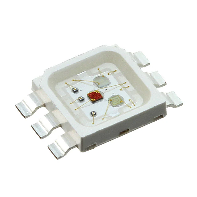

AAAF5051-05
5.0 x 5.0 mm Full-Color Surface Mount LED Lamp
DESCRIPTIONS
The Blue source color devices are made with InGaN
on Sapphire-substrate Light Emitting Diode
The Reddish-Orange source color devices are made
with AlGalnP on Si-substrate Light Emitting Diode
The Green source color devices are made with InGaN
Electrostatic discharge and power surge could
damage the LEDs
It is recommended to use a wrist band or
anti-electrostatic glove when handling the LEDs
All devices, equipments and machineries must be
electrically grounded
tia
l
PACKAGE DIMENSIONS
Suitable for all SMD assembly and solder process
Available on tape and reel
White SMD package, silicone resin
Package: 500 pcs / reel
Moisture sensitivity level: 3
Halogen-free
RoHS compliant
