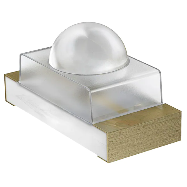

APTD1608SURCK
1.6 x 0.8 mm SMD Chip LED Lamp
