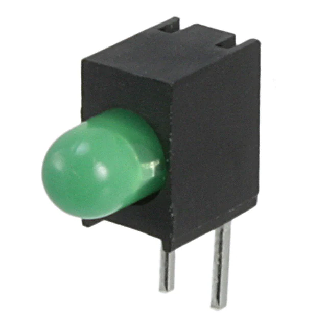

WP1384AD/GD
3.4mm Single-Level Circuit Board Indicator
DESCRIPTION
PACKAGE DIMENSIONS
The Green source color devices are made with
Gallium Phosphide Green Light Emitting Diode
FEATURES
Ideal for card edge status indication
High reliability-life measured in years
Housing UL rating: 94V-0
Housing material: Type 66 nylon
RoHS compliant
APPLICATIONS
Status indicator
Illuminator
Signage applications
Decorative and entertainment lighting
Commercial and residential architectural lighting
