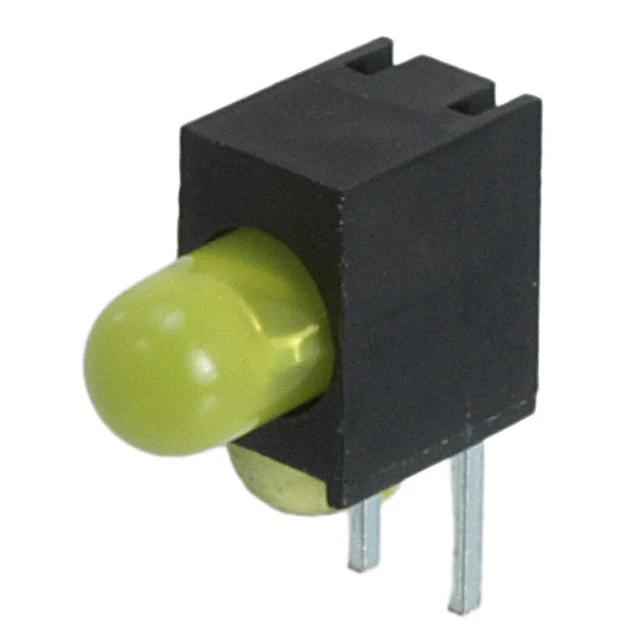

WP1384AD/YD
3.4mm Single-Level Circuit Board Indicator
DESCRIPTION
PACKAGE DIMENSIONS
The Yellow source color devices are made with
Gallium Arsenide Phosphide on Gallium Phosphide
Yellow Light Emitting Diode
FEATURES
Ideal for card edge status indication
High reliability-life measured in years
Housing UL rating: 94V-0
Housing material: Type 66 nylon
RoHS compliant
