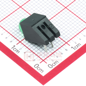

T-1 3/4 (5mm) RIGHT ANGLE LED INDICATOR Part Number: WP1503CB/YD Yellow Features LOW POWER CONSUMPTION. VERSATILE MOUNTING ON P.C. BOARD OR PANEL. T-1 3/4 DIAMETER FLANGELESS PACKAGE. RELIABLE AND RUGGED. UL RATING : 94V-0. HOUSING MATERIAL: TYPE 66 NYLON. RoHS COMPLIANT. Description The Yellow source color devices are made with Gallium Arsenide Phosphide on Gallium Phosphide Yellow Light Emitting Diode. Package Dimensions Notes: 1. All dimensions are in millimeters (inches). 2. Tolerance is ±0.25(0.01") unless otherwise noted. 3. Lead spacing is measured where the leads emerge from the package. 4. Specifications are subject to change without notice. SPEC NO: DSAF2064 APPROVED: WYNEC REV NO: V.2 CHECKED: Allen Liu DATE: MAY/22/2007 DRAWN: Y.L.LI PAGE: 1 OF 4 ERP: 1102000636 Selection Guide Part No. Dice Lens Type Iv (mcd) [2] @ 10mA Min. WP1503CB/YD Yellow (GaAsP/GaP) YELLOW DIFFUSED 5 Typ. 20 Viewing Angle [1] 2θ1/2 60 ° Notes: 1. θ1/2 is the angle from optical centerline where the luminous intensity is 1/2 the optical centerline value. 2. Luminous intensity/ luminous Flux: +/-15%. Electrical / Optical Characteristics at TA=25°C Symbol λpeak λD [1] Δλ1/2 C VF [2] IR Parameter Peak Wavelength Dominant Wavelength Spectral Line Half-width Capacitance Forward Voltage Reverse Current Device Yellow Yellow Yellow Yellow Yellow Yellow Typ. 590 588 35 20 2.1 2.5 10 Max. Units nm nm nm pF V uA Test Conditions IF=20mA IF=20mA IF=20mA VF=0V;f=1MHz IF=20mA V R = 5V Notes: 1.Wavelength: +/-1nm. 2. Forward Voltage: +/-0.1V. Absolute Maximum Ratings at TA=25°C Parameter Power dissipation DC Forward Current Peak Forward Current [1] Reverse Voltage Operating/Storage Temperature Lead Solder Temperature [2] Lead Solder Temperature [3] Notes: 1. 1/10 Duty Cycle, 0.1ms Pulse Width. 2. 2mm below package base. 3. 5mm below package base. Yellow 75 30 140 5 -40°C To +85°C 260°C For 3 Seconds 260°C For 5 Seconds Units mW mA mA V SPEC NO: DSAF2064 APPROVED: WYNEC REV NO: V.2 CHECKED: Allen Liu DATE: MAY/22/2007 DRAWN: Y.L.LI PAGE: 2 OF 4 ERP: 1102000636 Yellow WP1503CB/YD SPEC NO: DSAF2064 APPROVED: WYNEC REV NO: V.2 CHECKED: Allen Liu DATE: MAY/22/2007 DRAWN: Y.L.LI PAGE: 3 OF 4 ERP: 1102000636 PACKING & LABEL SPECIFICATIONS WP1503CB/YD SPEC NO: DSAF2064 APPROVED: WYNEC REV NO: V.2 CHECKED: Allen Liu DATE: MAY/22/2007 DRAWN: Y.L.LI PAGE: 4 OF 4 ERP: 1102000636
