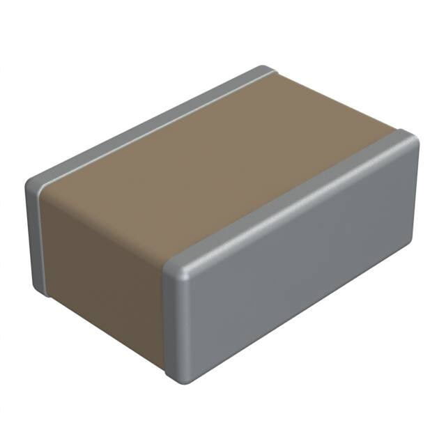

    贴片电容(MLCC) 1825 6.8nF ±1% 200V C0G(NP0)
1825J2000682FCT 数据手册
MLCC Surface Mount MLC Capacitors Standard MLCC Ranges Electrical Details A range of dc rated multi-layer chip capacitors from 0.47pF to 22µF and in case sizes 0603 to 8060 in C0G/NP0 and X7R dielectrics. Suitable for all general purpose and high reliability applications where package size and reliability are important. All are manufactured using Syfer’s unique wet process and incorporate precious metal electrodes. Capacitance Range 0.47pF to 22µF Temperature Coefficient of Capacitance (TCC) C0G/NP0 0 ± 30ppm/˚C X7R ±15% from -55˚C to +125˚C Cr > 50pF ≤0.0015 C0G/NP0 Dissipation Factor Cr ≤ 50pF = 0.0015(15÷Cr+0.7) X7R ≤ 0.025 Insulation Resistance (IR) 100G or 1000secs (whichever is the less) Dielectric Withstand Voltage (DWV) Voltage applied for 5 ±1 seconds, 50mA charging current maximum Ageing Rate C0G/NP0 Zero X7R
