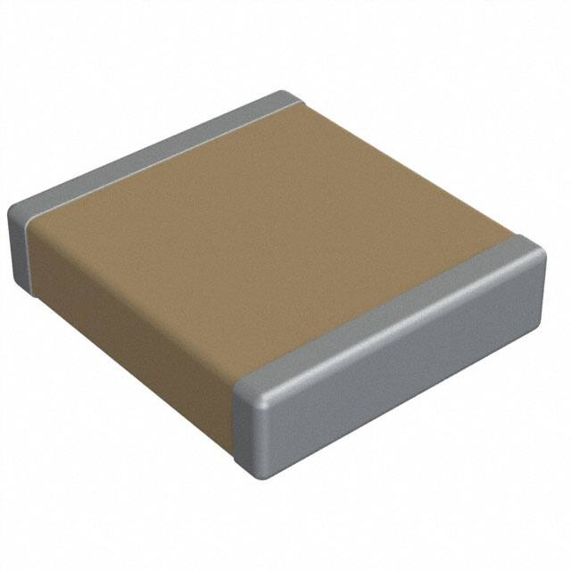

StackiCap™ Capacitors - X7R The StackiCap™ range offers a significant reduction in ‘PCB real estate’ for an equivalent capacitance value when board space is at a premium. For example, a standard 150nF chip in a 8060 case size is now available in a much smaller 3640 case size. Knowles’s unique patented* construction and FlexiCap™ termination material make the StackiCap™ range suitable for applications including: power supplies, lighting, aerospace electronics and high voltage applications where a large amount of capacitance is required. Further developments are on-going, please contact the Sales Office for details of the full range. * StackiCap™ technology is protected by international patents (pending) EP2847776, WO2013186172A1, US20150146343A1 and CN104471660A. Maximum capacitance Up to 5.6µF Insulation resistance Time Constant (RxCr) (whichever is the least - 500s or 500MΩ) Maximum voltage Up to 2kV Maximum capacitance values - StackiCap™ Capacitors Chip Size 1812 2220 3640 200/250V 1.0µF 2.2µF 5.6µF 500V 470nF 1.2µF 2.7µF 630V 330nF 1.0µF 2.2µF 1kV 180nF 470nF 1.0µF 1.2kV 100nF 220nF 470nF 1.5kV 56nF 150nF 330nF 2kV 33nF 100nF 150nF = AEC-Q200 Ordering information - StackiCap™ Capacitors 1812 Chip size 1812 2220 3640 Y Termination 500 0474 K J T WS2 Voltage Capacitance in picofarads (pF) Capacitance tolerance Dielectric Packaging Suffix code First digit is 0. Second and third digits are significant figures of capacitance code in picofarads (pF). Fourth digit is number of zeros J = ±5% K = ±10% M = ±20% J = X7R (BME) T = 178mm (7”) reel WS2 E = X7R (2R1) AEC-Q200 R = 330mm (13”) reel Y = FlexiCap™ 200/250 = 200/250V termination base with nickel 500 = 500V barrier (100% matte tin plating). 630 = 630V 1K0 = 1kV RoHS compliant. Lead free. 1K2 = 1.2kV H = FlexiCap™ 1K5 = 1.5kV Termination base with nickel 2K0 = 2kV barrier (Tin/lead plating with minimum 10% lead). Not RoHS compliant. eg. 0474 = 470nF Values are E12 series B = Bulk pack tubs or trays X = X7R Reeled quantities - StackiCap™ Capacitors 1812 S = X7R (BME) AEC-Q200 2220 3640 178mm (7”) Reel 500 500 - 330mm (13”) Reel 2,000 2,000 500 StackiCap Note: Parts in this range may be defined as dual-use under export control legislation as such may be subject to export licence restrictions. Please refer to page 12 for more information on the dual-use regulations and contact the Sales Office for further information on specific part numbers. Should be ordered as Syfer parts. www.knowlescapacitors.com
