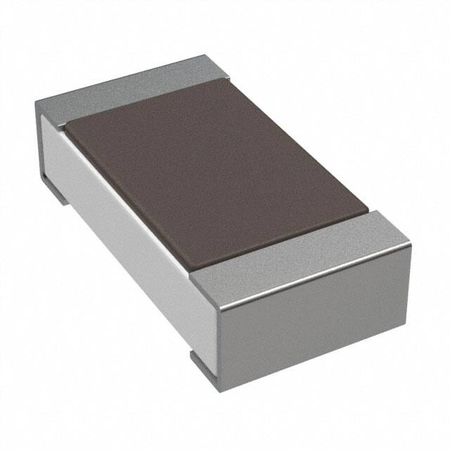

    电阻器 750KΩ ±2% 1/8W ±200ppm/℃ 0402
SG73P1ETTP754G 数据手册
anti-surge endured pulse power thick film chip resistor EU features • Superior to RK73B/RK73H series in pulse withstanding voltage and high power • Down to ±0.5% tolerance • Products with lead-free terminations meet EU RoHS requirements. EU RoHS regulation is not intended for Pb-glass contained in electrode, resistor element and glass. • AEC-Q200 tested Type (Inch Size Code) L c c W Sn Plating Ni Plating t d Protective Coating Resistive Inner Film Electrode Ceramic Substrate 80 % Rated Power 100 80 % Rated Power 100 60 40 .02±.002 .006±.004 (0.5±0.05) (0.15±0.1) +.004 -.002 +0.1 (1.0-0.05 ) +.002 .02±.002 .006±.004 .010 -.004 .014±.002 (0.5±0.05) (0.15±0.1) (0.25 +0.05) (0.35±0.05) -0.1 SG73P1E (0402) SG73P1EW (0402) .039 60 SG73P2A (0805) .079±.008 .049±.004 (2.0±0.2) (1.25±0.1) SG73P2B (1206) .063±.008 (1.6±0.2) .126±.008 (3.2±0.2) 1J/0.2W (135°C) 40 0 -60 -40 -20 -55 0 60 80 100 120 70 Ambient Temperature (°C) 20 40 140 160 155 For resistors operated at an ambient temperature of 70°C or above, a power rating shall be derated in accordance with the derating curve. ordering information .012 (0.3 .016 (0.4 .102±.008 (2.6±0.2) +.008 -.004 +0.2 ) -0.1 .012 +.008 -.004 +0.2 ) -0.1 .016 (0.3 (0.4 +.008 -.004 +0.2 ) -0.1 .02±.004 (0.5±0.1) .024±.004 (0.6±0.1) +.008 -.004 +0.2 ) -0.1 100 2E1/1W (95°C) 2A/0.5W (100°C) 1E/0.2W, 2B/0.75W (105°C) 2E/0.75W (110°C) 1J/0.33W (125°C) 80 60 40 20 20 20 .014±.002 (0.35±0.05) .063±.008 .031±.004 .012±.004 .012±.004 .018±.004 (1.6±0.2) (0.8±0.1) (0.3±0.1) (0.3±0.1) (0.45±0.1) 1E/0.125W (125°C) 1EW/0.25W (125°C) 2A/0.25W (125°C) 2B/0.33W (125°C) 2E/0.5W (125°C) 1 .010 SG73P1J (0603) SG73P2E SG73P2E1 (1210) Derating Curve t +.002 -.004 +0.05) (0.25 -0.1 +.004 -.002 +0.1) (1.0-0.05 .039 % Rated Power dimensions and construction Dimensions inches (mm) W c d L 0 -60 -40 -20 -55 0 40 60 140 160 100 120 125 135 155 Terminal Part Temperature (°C) 20 80 0 -60 -40 -20 -55 0 20 40 60 80 100 120 140 160 95 105 110 125 155 Terminal Part Temperature (°C) For resistors operated at a terminal part temperature of described for each size or above, a power rating shall be derated in accordance with the derating curve. Please refer to “Introduction of the derating curve based on the terminal part temperature” in the beginning of our catalog before use. If you want to use the rated power of *2, *3, please use the derating curve based on the terminal part temperature on the right hand side. SG73P 2B T TD 102 K Type Size Termination Material Packaging Nominal Resistance Tolerance SG73P 1E 1EW 1J 2A 2B 2E 2E1 T: Sn TP: 0402, 0603, 0805: 7" 2mm pitch punch paper TD: 0603, 0805, 1206, 1210: 7" 4mm pitch punched paper TE: 0805, 1206, 1210: 7" 4mm embossed plastic For further information on packaging, please refer to Appendix A ±0.5%, ±1%: 3 significant figures + 1 multiplier “R” indicates decimal on value
