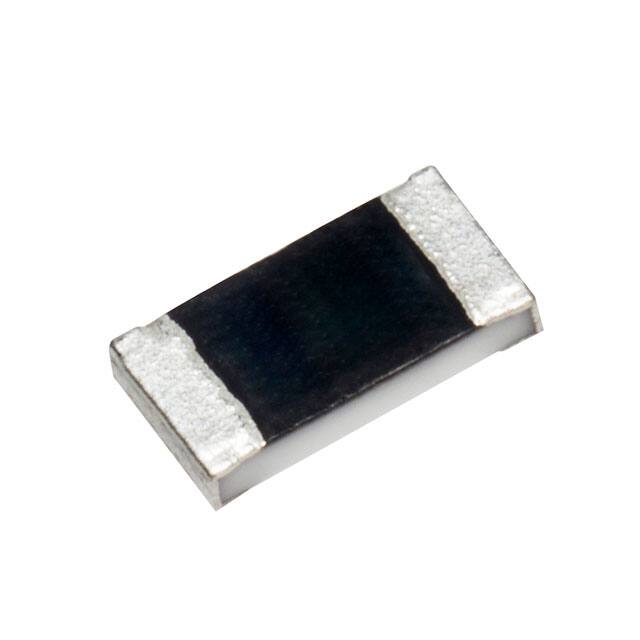

    贴片电阻 1210 560mΩ ±1% 1/2W ±100ppm/℃
SR732ERTTDR560F 数据手册
resistors SR73-RT low resistance flat chip resistors (anti sulfuration) EU features • Excellent anti-sulfuration characteristic due to using high sulfuration-proof inner top electrode material • Current detecting resistors for power supply, motor circuits, etc • High reliability and performance with resistance tolerance ±1.0, T.C.R. ±100×10-6/K • Suitable for both reflow and flow solderings • Products with lead free termination meet EU RoHS requirements. EU RoHS regulation is not intended for Pb-glass contained in electrode, resistor element and glass. • AEC-Q200 Tested Type (Inch Size Code) dimensions and construction 1E (0402) Resistance Range (Ω) 1 - 10 Dimensions inches (mm) W c d L .039 +.004 -.002 +0.1) (1.0 -0.05 .020 .008±.004 (0.2±0.1) .063±.008 (1.6±0.2) .031 +.006 -.004 +0.15 -0.1 ) (0.35 +0.15 -0.1 ) +0.2) (0.35 -0.1 .014±.004 (0.35±0.1) .014±.004 (0.35±0.1) .014 L c 0.1 - 0.43 c 1J (0603) 0.47 - 10 W (0.8 +.006 -.004 .049±.004 (1.25±0.1) .016±.008 (0.4±0.2) 0.47 - 10 Ni Plating t .079±.008 (2.0±0.2) 2A (0805) .010±.004 .014±.002 (0.25±0.1) (0.35±0.05) .014 +.008 -.004 +0.2 (0.4 -0.1 ) .012 +.008 -.004 (0.3 +0.2 -0.1 ) .02 d Protective Coating Resistive Inner Film Electrode 0.1 - 0.43 2B (1206) Ceramic Substrate .126±.008 (3.2±0.2) .063±.008 (1.6±0.2) .02±.012 (0.5±0.3) .126±.008 (3.2±0.2) .102±.008 (2.6±0.2) .02±.012 (0.5±0.3) 0.47 - 10 0.1 - 0.39 2E (1210) 0.43 - 10 Derating Curve .018±.004 (0.45±0.1) +.008 -.004 (0.5 +0.2 -0.1 ) +.008 -.004 +0.2 (0.4 -0.1 ) .02 +.008 -.004 (0.5 +0.2 ) -0.1 .016 +.008 -.004 (0.4 +0.2 -0.1 ) .016 .02±.004 (0.5±0.1) .024±.004 (0.6±0.1) .024±.004 (0.6±0.1) SR73 2A (0.5W), SR73 2B (0.5W), SR73 2E (0.66W) For resistors operated at an ambient temperature of 70°C or above, a power rating shall be derated in accordance with the derating curve. ordering information SR73 2B Type Size 1E: 0.166W 1J: 0.2W 2A: 0.33W, 0.5W 2B: 0.33W, 0.5W 2E: 0.5W, 0.66W RT Termination Material RT: Sn Anti-Sulfur For resistors operated at a terminal part temperature of described for each size or above, a power rating shall be derated in accordance with the derating curve. Please refer to “Introduction of the derating curve based on the terminal part temperature” in the beginning of our catalog before use. TD Packaging TD: 7" 4mm pitch punch paper TP: 0402 only, 7" 2mm pitch paper TPL: 0402 only, 2mm pitch paper For further information on packaging, please refer to Appendix A R10 Nominal Resistance ±2%, ±5%: 2 significant figures + 1 multiplier “R” indicates decimal on values
SR732ERTTDR560F
物料型号:KON SR73-RT
器件简介:SR73-RT是一种低电阻扁平芯片电阻器(抗硫化),具有出色的抗硫化特性,这归功于其高抗硫化的内部顶级电极材料。
引脚分配:文档中没有提供具体的引脚分配信息,但提到了适用于回流焊和波峰焊的产品,且无铅端子符合欧盟RoHS要求。
参数特性: - 电阻公差:±1.0% - 温度系数:±100×10^-6/K - 功率额定值:不同尺寸的电阻有不同的功率额定值,例如1E(0402)为0.166W,2A(0805)为0.33W和0.5W等。
功能详解:SR73-RT适用于电源、电机电路等的电流检测电阻器,具有高可靠性和性能。
应用信息:适用于电源、电机电路的电流检测,以及需要高可靠性和性能的应用场合。
封装信息:提供了不同尺寸的封装信息,例如0402、0603、0805、1206和1210,每个尺寸都有详细的尺寸数据和公差。
