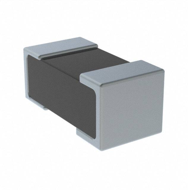

UR73D1ETTPR100F 数据手册
UR73 current sensing chip resistor EU features current sense • • • • Very low resistance, high precision reliability Utilization of thick film Low T.C.R. achieved (±100 ppm/°C) Products with lead-free terminations meet EU RoHS requirements. EU RoHS regulation is not intended for Pb-glass contained in electrode, resistor element and glass. dimensions and construction UR73 L a a Resistance Range (Ω) D1E (0402) 24m ~ 100m D1J (0603) .022±.004 +.005 10m ~ 27m .063±.008 .031 -.004 .02±.004 .014±.004 (0.55±0.1) 30m ~ 100m (1.6±0.2) (0.8 +0.15) (0.5±0.1) (0.35±0.1) .014±.004 -0.1 (0.35±0.1) D2A (0805) .024±.008 10m ~ 16m .079±.008 .049±.008 .022±.004 .016±.008 (0.6±0.2) 18m ~ 30m (2.0±0.2) (1.25±0.2) (0.55±0.1) (0.4±0.2) .02±.008 (0.5±0.2) 2A (0805) 33m ~ 100m .079±.008 .049±.008 .02±.004 .016±.008 D2B (1206) .039±.008 10m ~ 16m .126±.008 .063±.008 .024±.004 .020±.008 (1.0±0.2) 18m ~ 27m (3.2±0.2) (1.6±0.2) (0.6±0.1) (0.5±0.2) .031±.008 (0.8±0.2) 2B (1206) 30m ~ 100m .126±.008 .063±.008 .024±.004 .020±.012 D2H (2010) .063±.012 10m ~ 30m .197±.008 .098±.008 .026±.004 .026±.012 (1.6±0.3) 33m ~ 100m (5.0±0.2) (2.5±0.2) (0.65±0.1) (0.65±0.3) .026±.012 (0.65±0.3) D3A (2512) .079±.012 10m ~ 30m .248±.008 .122±.008 .024±.004 .031±.012 (2.0±0.3) 33m ~ 100m (6.3±0.2) (3.1±0.2) (0.6±0.1) (0.8±0.3) .031±.012 (0.8±0.3) W Ni Plating h Protective Coating b Resistive Inner Film Electrode Ceramic Substrate UR73D L a a W Sn Plating Ni Plating h Resistive Film Ceramic Protective Substrate Coating b 80 % Rated Power 100 80 % Rated Power 100 60 40 20 60 D1J/0.25W (80°C) 2B/0.5W, D2B/0.5W (85°C) D2A/0.33W, D2H/0.75W (90°C) D3A/1W (95°C) 2A/0.33W (100°C) 40 20 0 -60 -40 -55 -20 0 20 40 60 80 70 Ambient Temperature (°C) 100 120 140 125 For resistors operated at an ambient temperature of 70°C or above, a power rating shall be derated in accordance with the above derating curve. 0 -60 -40 -20 -55 0 20 40 60 80 100 120 140 85 90 95 125 Terminal Part Temperature (°C) L b .020 +.004 .039 +.004 -.002 -.002 +0.1 ) (1.0 -0.05 .016±.002 .010±.004 .012±.004 +0.1 ) (0.4±0.05) (0.25±0.1) (0.3±0.1) (0.5 -0.05 (2.0±0.2) (1.25±0.2) (0.55±0.1) (0.4±0.2) Inner Electrode Derating Curve Dimensions inches (mm) W h a Size Code (3.2±0.2) (1.6±0.2) (0.6±0.1) (0.5±0.3) .012 +.008 -.004 (0.3 +0.2 -0.1 ) .016 +.008 -.004 (0.4 +0.2 -0.1 ) For resistors operated at a terminal part temperature of described for each size or above, a power rating shall be derated in accordance with the derating curve. Please refer to “Introduction of the derating curve based on the terminal part temperature” in the beginning of our catalog prior use. ordering information UR73 Type UR73 UR73D 2A T Power Rating 1E: 0.125W 1J: 0.25W 2A: 0.33W 2B: 0.5W 2H: 0.75W 3A: 1W Termination Material T: Sn For further information on packaging, please refer to Appendix A. TD Packaging TP: 2mm pitch punch paper (1E) TD: 7" punched paper tape (1J, 2A, 2B) TE: 7" embossed plastic (2H, 3A) R100 Nominal Resistance “R” indicates decimal on values = 100mΩ Ex: R100 = 100mΩ “L” indicates decimal on values
UR73D1ETTPR100F
物料型号:UR73
器件简介:UR73是一款电流感应芯片电阻,具有极低的电阻值和高精确度可靠性,使用厚膜技术制造,并且具有低温度系数(±100 ppm/°C)。
引脚分配:文档中没有提供具体的引脚分配信息。
参数特性: - 尺寸代码:D1E (0402), D1J (0603), D2A (0805), D2B (1206), D2H (2010), D3A (2512) - 电阻范围:24mΩ至100mΩ - 额定功率:1/8W (0.125W) 至 1W (1W) - 温度系数:最高±100 ppm/°C - 工作温度范围:-55°C至+125°C
功能详解:UR73电流感应芯片电阻适用于需要精确电流检测的应用场合,例如电源管理、电机驱动等。
应用信息:适用于电流检测,特别是在电源管理、电机驱动等领域。
封装信息:提供多种尺寸的封装,包括0402、0603、0805、1206、2010和2512,以适应不同的应用需求。
