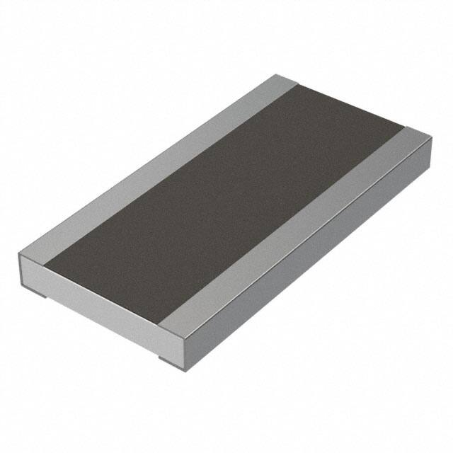

wide terminal type flat chip resistors EU features • Wide-side termination (reverse-geometry) type flat chip resistor • High reliability and performance with T.C.R. ±100 x 10-6/K, resistance tolerance ±0.5% • Products with lead-free terminations meet EU RoHS requirements. EU RoHS regulation is not intended for Pb-glass contained in electrode, resistor element and glass. • AEC-Q200 Tested Dimensions inches (mm) W c d Type dimensions and construction L c L 1E (0204) 1J (0306) 2A (0508) .020±.002 (0.5±0.05) .031±.004 (0.8±0.1) .049±.006 (1.25±0.15) .039±.002 (1.0±0.05) .063±.004 (1.6±0.1) .079±.006 (2.0±0.15) .006±.002 (0.15±0.05) .006±.004 (0.15±0.1) .012±.008 (0.3±0.2) .006±.002 (0.15±0.05) .008±.004 (0.2±0.1) .014±.008 (0.35±0.2) 2B (0612) 2H (1020) 2J (1218) 3A (1225) .063±.006 (1.6±0.15) .098±.006 (2.5±0.15) .122±.006 (3.1±0.15) .122±.006 (3.1±0.15) .126±.008 (3.2±0.2) .197±.006 (5.0±0.15) .181±.006 (4.6±0.15) .252±.006 (6.3±0.15) .012±.008 (0.3±0.2) .016±.008 (0.4±0.2) .016±.008 (0.4±0.2) .018±.008 (0.45±0.2) .018±.006 (0.45±0.15) c W Solder Plating Ni Plating t d Inner Resistive Electrode Film t (Inch Size Code) Protective Coating Ceramic Substrate Derating Curve .014±.002 (0.35±0.05) .018±.004 (0.45±0.1) .022±.004 (0.55±0.1) .024±.004 (0.6±0.1) .030±.006 (0.75±0.15) WK73R2B (1W), WK73R3A (2W) 100 100 80 80 100 60 40 1E, 1J, 2A, 2B, 2H, 3A (125°C) 60 40 20 20 0 -60 -40 -20 -55 80 % Rated Power % Rated Power % Rated Power 2J (100°C) 0 80 100 120 140 160 155 70 Ambient Temperature (°C) 20 40 60 For resistors operated at an ambient temperature of 70°C or above, a power rating shall be derated in accordance with the above derating curve. ordering information WK73R 2J Type Size WK73R 1E: 0.33W 1J: 0.5W 2A: 0.75W, 1W 2B: 0.75W, 1W 2H: 1W 2J: 1W 3A: 1.5W, 2W T Termination Material T: Sn 2B, 3A (115°C) 60 40 20 0 -60 -40 -20 -55 80 100 120 140 160 125 155 Terminal Part Temperature (°C) 0 20 40 60 0 -60 -40 -20 -55 0 20 40 60 80 100 120 140 160 115 155 Terminal Part Temperature (°C) For resistors operated terminal temperature of described for each size or above, a power rating shall be derated in accordance with the derating curve above. Please refer to “Introduction of the derating curve based on the terminal part temperature” in the beginning of our catalog before use. If you want to use at rated power (*1), use derating curves based on the terminal part temperature on the right side graph. TE Packaging TP: 0204: 7" 2mm pitch punched paper TD: 0306, 0508, 0612: 7" 4mm pitch punched paper TE: 1020, 1218, 1225: 7" embossed plastic For further information on packaging, please refer to Appendix A 33L0 Nominal Resistance ±1%: 3 significant figures + 1 multiplier “R” indicates decimal on value
