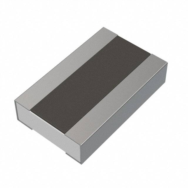

WK73S wide terminal type flat chip resistors EU features current sense • Wide-side termination (reverse-geometry) type flat chip resistor • High reliability and performance with T.C.R. ±100 x 10-6/K, resistance tolerance ±0.5% • Products with lead-free terminations meet EU RoHS requirements. EU RoHS regulation is not intended for Pb-glass contained in electrode, resistor element and glass. • AEC-Q200 Tested dimensions and construction Type L c (Inch Size Code) c W Solder Plating Ni Plating t Inner Resistive Electrode Film d Protective Coating Ceramic Substrate Dimensions inches (mm) W c d L .049±.006 .079±.006 .012±.008 .014±.008 .022±.004 (1.25±0.15) (2.0±0.15) (0.3±0.2) (0.35±0.2) (0.55±0.1) 2B (0612) .063±.006 .126±.008 .012±.008 .018±.006 (1.6±0.15) (3.2±0.2) (0.3±0.2) (0.45±0.15) 2H (1020) .098±.006 .197±.006 .016±.008 (2.5±0.15) (5.0±0.15) (0.4±0.2) 2J (1218) .122±.006 .181±.006 .016±.008 .030±.006 (3.1±0.15) (4.6±0.15) (0.4±0.2) (0.75±0.15) 3A (1225) .122±.006 .252±.006 .018±.008 (3.1±0.15) (6.3±0.15) (0.45±0.2) Derating Curve 60 40 100 2J (100°C) 60 80 % Rated Power 80 % Rated Power 80 % Rated Power 100 2A, 2B, 2H, 3A (125°C) 40 20 20 0 80 100 120 140 160 155 70 Ambient Temperature (°C) 20 40 60 For resistors operated at an ambient temperature of 70°C or above, a power rating shall be derated in accordance with the above derating curve. ordering information WK73S 2J Type Size WK73S 2A: 1W 2B: 0.75W, 1W 2H: 1W 2J: 1W 3A: 1.5W, 2W T Termination Material T: Sn 2H2, 3A3 (95°C) 60 2B, 3A (115°C) 40 20 0 -60 -40 -20 -55 80 100 120 140 160 125 155 Terminal Part Temperature (°C) 0 20 40 60 0 -60 -40 -20 -55 20 40 60 80 100 120 140 160 95 115 155 Terminal Part Temperature (°C) 0 For resistors operated terminal temperature of described for each size or above, a power rating shall be derated in accordance with the derating curve above. Please refer to “Introduction of the derating curve based on the terminal part temperature” in the beginning of our catalog before use. If you want to use at rated power (*1), use derating curves based on the terminal part temperature on the right side graph. TE Packaging TD: 0508, 0612: 7" 4mm pitch punched paper TE: 1020, 1218, 1225: 7" embossed plastic For further information on packaging, please refer to Appendix A 33L0 F Nominal Resistance ±1%: 3 significant figures + 1 multiplier “R” indicates decimal on value

物料型号:WK73S系列
器件简介:这些是宽端面终止类型的平芯片电阻,具有高可靠性和性能,温度系数(T.C.R.)为±100 x 10^-6/K,电阻公差为±0.5%。
引脚分配:文档中没有明确提供引脚分配信息,但提到了不同尺寸代码的电阻,例如2A (0508)、2B (0612)等。
参数特性:包括尺寸、公差、功率额定值、工作温度范围等。例如,2A尺寸的电阻功率额定值为1W,2B为0.75W和1W。
功能详解:文档提供了电阻的降额曲线,说明了在不同环境温度和终端部件温度下功率的降额情况。
应用信息:这些电阻适用于电流检测等应用。
封装信息:提供了不同尺寸的详细尺寸信息,包括长度、宽度、端头直径等。
订购信息:提供了订购时需要的型号、尺寸、电阻值、公差、端头材料和包装等信息。
环境应用性能特性:包括电阻、温度系数、过载、耐焊热性、弯曲测试、快速温度变化、湿度抵抗、70°C耐久性和高温暴露等测试方法和要求。
