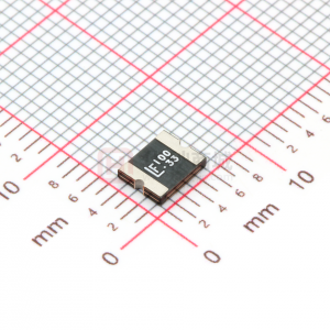

    2016L100 - POLYFUSE® Resettable PTCs - Littelfuse
2016L100 数据手册
POLYFUSE® Resettable PTCs Surface Mount > 2016L Series 2016L Series Description The 2016L Series device provides surface mount overcurrent protection for low voltage (≤60V) applications where resettable protection is desired. Features lead-free currents Agency Approvals AGENCY AGENCY FILE NUMBER E183209 R50119118 Applications equipment protection protection (IEEE 802.3 af) control module protection Electrical Characteristics Pd max. (W) 1.40 1.40 1.40 1.40 1.40 1.40 Maximum Time To Trip Current (A) 1.50 2.50 8.00 8.00 8.00 8.00 Time (Sec.) 3.00 5.00 0.50 0.50 1.00 3.00 R min (Ω) 0.500 0.200 0.100 0.100 0.070 0.048 Resistance R typ (Ω) 1.400 0.700 0.250 0.250 0.130 0.070 R 1max (Ω) 2.300 1.000 0.400 0.400 0.180 0.100 X X X X X X X X X X X X Part Number Marking I hold (A) 0.30 0.55 1.10 1.10 1.50 2.00 I trip (A) 0.60 1.10 2.20 2.20 3.00 4.20 V max (Vdc) 60 60 15 33 15 6 I max (A) 20 20 40 40 40 40 Agency Approvals 2016L030 2016L050 2016L100 2016L100/33 2016L150 2016L200 LF030 LF050 LF100 LF100-33 LF150 LF200 I hold = Hold current: maximum current device will pass without tripping in 20°C still air. I trip = Trip current: minimum current at which the device will trip in 20°C still air. V max = Maximum voltage device can withstand without damage at rated current (I max) I max = Maximum fault current device can withstand without damage at rated voltage (Vmax) P d = Power dissipated from device when in the tripped state at 20°C still air. R min = Minimum resistance of device in initial (un-soldered) state. R typ = Typical resistance of device in initial (un-soldered) state. R 1max = Maximum resistance of device at 20°C measured one hour after tripping or reflow soldering of 260°C for 20 sec. Caution: Operation beyond the specified rating may result in damage and possible arcing and flame. ©2008 Littelfuse, Inc. Specifications are subject to change without notice. Please refer to www.littelfuse.com/series/2016L.html for current information. Revised: October 24, 2008 2016L Series 2016L Series POLYFUSE® Resettable PTCs Surface Mount > 2016L Series Temperature Rerating Ambient Operation Temperature -40°C Part Number 2016L030 2016L050 2016L100 2016L100/33 2016L150 2016L200 0.45 0.93 1.66 1.66 2.26 2.80 0.40 0.80 1.47 1.47 2.00 2.50 0.35 0.65 1.29 1.29 1.76 2.19 0.30 0.50 1.10 1.10 1.50 2.00 -20°C 0°C 23°C 40°C Hold Current (A) 0.25 0.38 0.91 0.91 1.24 1.84 0.23 0.32 0.83 0.83 1.13 1.74 0.20 0.25 0.73 0.73 1.00 1.50 0.18 0.19 0.64 0.64 0.87 1.34 0.14 0.09 0.50 0.50 0.68 1.14 50°C 60°C 70°C 85°C Average Time Current Curves 0.16A 0.30A 1.00A/33v 1.00A 1.50A 2.00A Temperature Rerating Curve 170% 150% Percentage of Rated Current B A 100000 2016L 130% 110% 90% 70% 10000 Line/Part Number: 50% 30% A 2106L030 2106L050 2106L100 -30 -20 -10 B 2106L100\33 2016L150 2016L200 0 10 20 30 40 Temperature (°C) 50 60 70 A B 1000 Time in Seconds 100 10% -40 80 85 10 1 0.1 0.01 0.1 1 10 100 Current in Amperes The average time current curves and Temperature Rerating curve performance is affected by a number or variables, and these curves provided as guidance only. Customer must verify the performance in their application. 2016L Series Revised: October 24, 2008 ©2008 Littelfuse, Inc. Specifications are subject to change without notice. Please refer to www.littelfuse.com/series/2016L.html for current information. POLYFUSE® Resettable PTCs Surface Mount > 2016L Series Soldering Parameters Condition Peak Temp/ Duration Time Time above liquids (TAL) 220°C Preheat 120°C~ 180°C Storage Condition oven, N2 environment for lead–free Reflow 260°C / 10 Sec 60 Sec ~ 100 Sec Temperature (°C) 260 220 Soldering Cooling 50 Sec ~ 150 Sec 0°C~35°C, < 70%RH = Preheating 180 120 0 50 to 150 60 to 100 Time(s) 120 Physical Specifications Solder-Plated Copper (Solder Material: Matte Tin(Sn)) Meets EIA Specification RS186-9E, ANSI/ J-STD-002 Category 3. Environmental Specifications Operating/Storage Temperature Maximum Device Surface Temperature in Tripped State Passive Aging Humidity Aging Terminal Material Lead Solderability -40°C to +85°C 125°C +85°C, 1000 hours -/+5% typical resistance change +85°C, 85%,R.H.,1000 hours -/+5% typical resistance change MIL–STD–202, Method 107G +85°C/-40°C 20 times -30% typical resistance change MIL–STD–202, Method 215 No change MIL–STD–883C, Method 2007 .1, Condition A No change Level 2, J–STD–020C Thermal Shock Solvent Resistance Vibration Moisture Sensitivity Level ©2008 Littelfuse, Inc. Specifications are subject to change without notice. Please refer to www.littelfuse.com/series/2016L.html for current information. Revised: October 24, 2008 2016L Series 2016L Series solvents. Note: If reflow temperatures exceed the recommended profile, devices may not meet the performance requirements. POLYFUSE® Resettable PTCs Surface Mount > 2016L Series Dimensions (mm) MARKING CODE VARIES WITH AMPERAGE AND VOLTAGE RATING SEE ELECTRICAL CHARACTERISTICS CHART SHOWN ARE: - 1.1A/15V RATING (LEFT) - 1.1A/33V RATING (RIGHT) A C Top View 100 100 D B 100 -33 Side View Bottom View Pad Layout E 3.40 mm (.133”) 4.60 mm (.181”) 1.50 mm (.059”) A Part Number 2016L030 2016L050 2016L100 2016L100/33 2016L150 2016L200 Inches 0.19 0.19 0.19 0.19 0.19 0.19 0.21 0.21 0.21 0.21 0.21 0.21 mm 4.72 4.72 4.72 4.72 4.72 4.72 5.44 5.44 5.44 5.44 5.44 5.44 Inches 0.15 0.15 0.15 0.15 0.15 0.15 0.17 0.17 0.17 0.17 0.17 0.17 B mm 3.7 3.7 3.7 3.7 3.7 3.7 4.43 4.43 4.43 4.43 4.43 4.43 Inches 0.03 0.05 0.02 0.03 0.03 0.02 0.05 0.08 0.03 0.05 0.06 0.03 C mm 0.75 1.2 0.5 0.75 0.75 0.5 1.25 2 0.75 1.25 1.55 0.75 D Inches mm Min. 0.30 0.30 0.30 0.30 0.30 0.30 0.01 0.01 0.01 0.01 0.01 0.01 Inches 0.01 0.01 0.01 0.01 0.01 0.01 0.03 0.03 0.03 0.03 0.03 0.03 E mm 0.25 0.25 0.25 0.25 0.25 0.25 0.65 0.65 0.65 0.65 0.65 0.65 Min Max. Min. Max. Min. Max. Min. Max. Min. Max. Min. Max. Min. Max. Min. Max. Min. Part Ordering Number System 2016 L 100 /33 D R PACKAGING STYLE R: Tape & Reel SERIES QUANTITY CODE: D=1500 M=1000 P=2000 /XX: SPECIAL VOLTAGE RATING (NOT APPLICABLE TO ALL PARTS) I HOLD CURRENT CODE (SEE TABLE BELOW) L: LITTELFUSE SURFACE MOUNT PPTC SIZE Packaging Part Number 2016L030 2016L050 2016L100 2016L100/33 2016L150 2016L200 Ordering Number 2016L030DR 2016L050MR 2016L100PR 2016L100/33DR 2016L150DR 2016L200PR I hold (A) 0.30 0.55 1.10 1.10 1.50 2.00 I hold Code 030 050 110 110 150 200 /33 Voltage Option Packaging Option Tape and Reel Tape and Reel Tape and Reel Tape and Reel Tape and Reel Tape and Reel Quantity 1500 1000 2000 1500 1500 2000 Quantity & Packaging Codes DR MR PR DR DR PR 2016L Series Revised: October 24, 2008 ©2008 Littelfuse, Inc. Specifications are subject to change without notice. Please refer to www.littelfuse.com/series/2016L.html for current information. POLYFUSE® Resettable PTCs Surface Mount > 2016L Series Tape and Reel Specifications TAPE SPECIFICATIONS: EIA-481-1 (mm) 2016L100 2016L200 W F E1 D0 D1 P0 P1 P2 A0 B0 T KO Leader Min. Trailer Min. 12.0+/- 0.30 5.50+/- 0.05 1.75+/- 0.10 1.55+/- 0.05 1.50 (MIN) 4.0+/- 0.10 8.0+/- 0.10 2.0+/- 0.05 4.40+/- 0.10 5.50+/- 0.10 0.25+/- 0.10 0.80+/- 0.10 390 160 2016L030 2016L100/33 2016L150 12.0+/- 0.30 5.50+/- 0.05 1.75+/- 0.10 1.55+/- 0.05 1.50 (MIN) 4.0+/- 0.10 8.0+/- 0.10 2.0+/- 0.05 4.48+/- 0.10 5.40+/- 0.10 0.25+/- 0.10 1.36+/- 0.10 390 160 2016L050 12.0+/- 0.30 5.50+/- 0.05 1.75+/- 0.10 1.55+/- 0.05 1.50 (MIN) 4.0+/- 0.10 8.0+/- 0.10 2.0+/- 0.05 4.45+/- 0.10 5.48+/- 0.10 0.25+/- 0.10 1.86+/- 0.10 390 160 REEL DIMENSIONS: EIA-481-1 (mm) H W D F C H1 W1 W2 W3 W4 12.0+/- 0.05 9.0+/- 0.5 Ø 60+0.5 Ø13.0+/- 0.2 Ø178+/- 1.0 11+/- 0.5 2.2+/- 0.5 3.0+0.5 4.0+0.5 5.5+0.5 Tape and Reel Diagram H P1 P0 D0 P2 E1 W4 W3 D F W W2 C T D2 F W1 W A0 K0 B0 H1 ©2008 Littelfuse, Inc. Specifications are subject to change without notice. Please refer to www.littelfuse.com/series/2016L.html for current information. Revised: October 24, 2008 2016L Series 2016L Series
