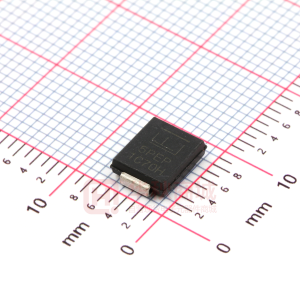

5.0SMDJ12A
5.0SMDJ12A
    LITTELFUSE
    5.0SMDJ12A - Transient Voltage Suppression Diodes - Littelfuse
5.0SMDJ12A 数据手册
Transient Voltage Suppression Diodes Surface Mount – 5000W > 5.0SMDJ series RoHS 5.0SMDJ Series Description The 5.0SMDJ series is designed specifically to protect sensitive electronic equipment from voltage transients induced by lightning and other transient voltage events. Features typically less than 1.0ps from 0V to BV min applications to optimize board space capability resistance less than 5μA R above 22V soldering guaranteed: 260°C/40 seconds at terminals Underwriters Laboratory Flammability 94V-O Agency Approvals AGENCY AGENCY FILE NUMBER E230531 temperature coefficient ΔVBR = 0.1% x VBR@25°C x ΔT Maximum Ratings and Thermal Characteristics (TA=25OC unless otherwise noted) Parameter Peak Pulse Power Dissipation at TA=25OC by 10x1000μs waveform (Fig.1)(Note 1), (Note 2) Power Dissipation on infinite heat sink at TA=50OC Peak Forward Surge Current, 8.3ms Single Half Sine Wave (Note 3) Maximum Instantaneous Forward Voltage at 100A for Unidirectional only Operating Junction and Storage Temperature Range Typical Thermal Resistance Junction to Lead Typical Thermal Resistance Junction to Ambient Symbol PPPM PM(AV) IFSM VF TJ , TSTG RuJL RuJA Value 5000 6.5 300 5.0 -65 to 150 15 75 Unit W W A V °C °C/W °C/W junction capability at 10×1000μs waveform, repetition rate (duty cycles):0.01% Applications TVS devices are ideal for the protection of I/O Interfaces, VCC bus and other vulnerable circuits used in Telecom, Computer, Industrial and Consumer electronic applications. Notes: 1. Non-repetitive current pulse , per Fig. 3 and derated above TA = 25OC per Fig. 2. 2. Mounted on copper pad area of 0.31x0.31” (8.0 x 8.0mm) to each terminal. 3. Measured on 8.3ms single half sine wave or equivalent square wave for unidirectional device only,duty cycle=4 per minute maximum. ©2009 Littelfuse, Inc. Specifications are subject to change without notice. Please refer to http://www.Littelfuse.com/series/5.0SMDJ.html for current information. 59 Revision: January 09, 2009 5.0SMDJ Series 5.0SMDJ Series Transient Voltage Suppression Diodes Surface Mount – 5000W > 5.0SMDJ series Electrical Characteristics Part Number (Uni) 5.0SMDJ12A 5.0SMDJ13A 5.0SMDJ14A 5.0SMDJ15A 5.0SMDJ16A 5.0SMDJ17A 5.0SMDJ18A 5.0SMDJ20A 5.0SMDJ22A 5.0SMDJ24A 5.0SMDJ26A 5.0SMDJ28A 5.0SMDJ30A 5.0SMDJ33A 5.0SMDJ36A 5.0SMDJ40A 5.0SMDJ43A 5.0SMDJ45A 5.0SMDJ48A 5.0SMDJ51A 5.0SMDJ54A 5.0SMDJ58A 5.0SMDJ60A 5.0SMDJ64A 5.0SMDJ70A 5.0SMDJ75A 5.0SMDJ78A 5.0SMDJ85A 5.0SMDJ90A 5.0SMDJ100A 5.0SMDJ110A 5.0SMDJ120A 5.0SMDJ130A 5.0SMDJ150A 5.0SMDJ160A 5.0SMDJ170A Part Number (Bi) 5.0SMDJ12CA 5.0SMDJ13CA 5.0SMDJ14CA 5.0SMDJ15CA 5.0SMDJ16CA 5.0SMDJ17CA 5.0SMDJ18CA 5.0SMDJ20CA 5.0SMDJ22CA 5.0SMDJ24CA 5.0SMDJ26CA 5.0SMDJ28CA 5.0SMDJ30CA 5.0SMDJ33CA 5.0SMDJ36CA 5.0SMDJ40CA 5.0SMDJ43CA 5.0SMDJ45CA - Marking UNI 5PEP 5PEQ 5PER 5PES 5PET 5PEU 5PEV 5PEW 5PEX 5PEZ 5PFE 5PFG 5PFK 5PFM 5PFP 5PFR 5PFT 5PFV 5PFX 5PFZ 5RGE 5PGG 5PGK 5PGM 5PGP 5PGR 5PGT 5PGV 5PGX 5PGZ 5PHE 5PHG 5PHK 5PHM 5PHP 5PHR BI 5BEP 5BEQ 5BER 5BES 5BET 5BEU 5BEV 5BEW 5BEX 5BEZ 5BFE 5BFG 5BFK 5BFM 5BFP 5BFR 5BFT 5BFV - Reverse Stand off Voltage VR (Volts) 12.0 13.0 14.0 15.0 16.0 17 .0 18.0 20.0 22.0 24.0 26.0 28.0 30.0 33.0 36.0 40.0 43.0 45.0 48.0 51.0 54.0 58.0 60.0 64.0 70.0 75.0 78.0 85.0 90.0 100.0 110.0 120.0 130.0 150.0 160.0 170.0 Breakdown Voltage VBR (Volts) @ IT MIN 13.30 14.40 15.60 16.70 17 .80 18.90 20.00 22.20 24.40 26.70 28.90 31.10 33.30 36.70 40.00 44.40 47 .80 50.00 53.30 56.70 60.00 64.40 66.70 71.10 77 .80 83.30 86.70 94.40 100.00 111.00 122.00 133.00 144.00 167 .00 178.00 189.00 MAX 14.70 15.90 17 .20 18.50 19.70 20.90 22.10 24.50 26.90 29.50 31.90 34.40 36.80 40.60 44.20 49.10 52.80 55.30 58.90 62.70 66.30 71.20 73.70 78.60 86.00 92.10 95.80 104.00 111.00 123.00 135.00 147 .00 159.00 185.00 197 .00 209.00 Test Current IT (mA) 10 10 10 1 1 1 1 1 1 1 1 1 1 1 1 1 1 1 1 1 1 1 1 1 1 1 1 1 1 1 1 1 1 1 1 1 Maximum Maximum Maximum Agency Clamping Peak Reverse Approval Voltage VC Pulse Leakage IR @ Ipp Current Ipp @ VR (V) (A) (μA) 19.9 21.5 23.2 24.4 26.0 27 .6 29.2 32.4 35.5 38.9 42.1 45.4 48.4 53.3 58.1 64.5 69.4 72.7 77 .4 82.4 87 .1 93.6 96.8 103.0 113.0 121.0 126.0 137 .0 146.0 162.0 177 .0 193.0 209.0 243.0 259.0 275.0 252.00 233.00 216.00 205.00 193.00 181.00 172.00 155.00 141.00 129.00 119.00 110.00 103.00 93.90 86.10 77 .60 72.10 68.80 64.70 60.70 57 .50 53.50 51.70 48.60 44.30 41.40 39.70 36.50 34.30 30.90 28.30 26.00 24.00 20.60 19.30 18.20 800 500 200 100 50 20 10 5 5 5 5 5 5 5 5 5 5 5 5 5 5 5 5 5 5 5 5 5 5 5 5 5 5 5 5 5 X X X X X X X X X X X X X X X X X X X X X X X X X X X X X X X X X X X X For Bidirectional type having VR of 20 volts and less,the IR limit is double. 5.0SMDJ Series 60 Revision: January 09, 2009 ©2009 Littelfuse, Inc. Specifications are subject to change without notice. Please refer to http://www.Littelfuse.com/series/5.0SSMDJ.html for current information. Transient Voltage Suppression Diodes Surface Mount – 5000W > 5.0SMDJ series Ratings and Characteristic Curves (T =25°C unless otherwise noted) A 1000 100 Peak Pulse Power (PPP) or Current (IPP) Derating in Percentage % PPPM-Peak Pulse Power (KW) 80 100 60 10 40 1 0.31x0.31" (8.0x8.0mm) 20 0.1 Copper Pad Area 0 0.000001 0.00001 0.0001 0.001 0.0000001 0 25 50 75 100 125 150 175 td-Pulse Width (Sec.) TA-Ambient temperature (ºC) Figure 3 - Pulse Waveform 150 IPPM- Peak Pulse Current, % IRSM tr=10μsec Peak Value IPPM TJ=25°C Pulse Width(td) is defined as the point where the peak current decays to 50% of IPPM Figure 4 - Typical Junction Capacitance 100000 10000 Bi-directional V= OV 100 Uni-directional V= OV Half Value IPPM IPPM 2 Cj (pF) 1000 Uni-directional @ VR () 10/1000μsec. Waveform as defined by R.E.A 100 Bi-directional @ VR 50 10 td 0 0 1.0 2.0 t-Time (ms) 3.0 4.0 1 1.0 10.0 100.0 1000.0 VBR - Reverse Breakdown Voltage (V) Figure 5 - Steady State Power Derating Curve Figure 6 - Maximum Non-Repetitive Peak Forward Surge Current Uni-Directional Only 350 IFSM - Peak Forward Surge Current (A) 300 250 200 150 100 50 0 6.5 6 5.5 5 4.5 4 3.5 3 2.5 2 1.5 1 0.5 0 0 25 50 75 100 125 150 175 TA-Ambient Temperature (ºC) PM(AV), Steady State Power Dissipation (W) 1 10 Number of Cycles at 60 Hz 100 ©2009 Littelfuse, Inc. Specifications are subject to change without notice. Please refer to http://www.Littelfuse.com/series/5.0SMDJ.html for current information. 61 Revision: January 09, 2009 5.0SMDJ Series 5.0SMDJ Series Figure 1 - Peak Pulse Power Rating Curve Figure 2 - Pulse Derating Curve Transient Voltage Suppression Diodes Surface Mount – 5000W > 5.0SMDJ series Soldering Parameters Reflow Condition TP tp Ramp-up Critical Zone TL to TP - Temperature Min (Ts(min)) Pre Heat - Temperature Max (Ts(max)) - Time (min to max) (ts) Average ramp up rate (Liquidus Temp (TL) to peak TS(max) to TL - Ramp-up Rate Reflow - Temperature (TL) (Liquidus) - Time (min to max) (ts) 150°C 200°C Temperature (T) TL Ts(max) tL 3°C/second max 3°C/second max 217°C 260 +0/-5 Ramp-down Ts(min) ts Preheat 25˚C t 25˚C to Peak Time (t) Peak Temperature (TP) Time within 5°C of actual peak Temperature (tp) Ramp-down Rate Time 25°C to peak Temperature (TP) Do not exceed °C 6°C/second max 8 minutes Max. 280°C Physical Specifications Weight Case Polarity Terminal 0.007 ounce, 0.21 grams JEDEC DO214AB. Molded plastic body over glass passivated junction Color band denotes positive end (cathode) except Bidirectional. Matte Tin-plated leads, Solderable per JESD22-B102D Environmental Specifications Temperature Cycle Pressure Cooker High Temp. Storage HTRB Thermal Shock JESD22-A104 JESD 22-A102 JESD22-A103 JESD22-A108 JESD22-A106 Dimensions DO-214AB (SMC J-Bend) Cathode Band Dimensions A Inches Min 0.114 0.260 0.220 0.079 0.030 0.305 0.006 0.129 0.094 0.094 Max 0.126 0.280 0.245 0.103 0.060 0.008 0.320 0.012 0.165 - Millimeters Min 2.900 6.600 5.590 2.060 0.760 7 .750 0.152 3.300 2.400 2.400 Max 3.200 7 .110 6.220 2.620 1.520 0.203 8.130 0.305 4.200 - A C B C D E B H D F E J F G H I J K L G K L I 5.0SMDJ Series 62 Revision: January 09, 2009 ©2009 Littelfuse, Inc. Specifications are subject to change without notice. Please refer to http://www.Littelfuse.com/series/5.0SSMDJ.html for current information. Transient Voltage Suppression Diodes Surface Mount – 5000W > 5.0SMDJ series Part Numbering System 5.0SMDJ XXX C A Part Marking System Cathode Band 5% VOLTAGE TOLERANCE BI-DIRECTIONAL VOLTAGE SERIES F Littelfuse Logo Marking Code Packaging Part number 5.0SMDJxxxXX Component Package DO-214AB Quantity 3000 Packaging Option Packaging Specification EIA STD RS-481 ©2009 Littelfuse, Inc. Specifications are subject to change without notice. Please refer to http://www.Littelfuse.com/series/5.0SMDJ.html for current information. 63 Revision: January 09, 2009 5.0SMDJ Series 5.0SMDJ Series XXXX
