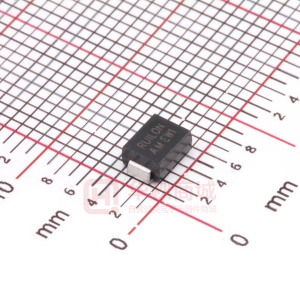

Silicon Avalanche Diodes 600W Surface Mount Transient Voltage Suppressors SMBJ Series Protect sensitive electronics against voltage transients induced by inductive load switching and lightning. Ideal for the protection of I/O interfaces, Vcc bus and other integrated circuits. ® 6 SILICON DIODE ARRAYS FEATURES • Stand-off Voltage Range 5.0 to 170 Volts • Uni-directional and Bi-directional • Glass passivated junction • Jedec package designed to meet SM assembly needs • Low head inductance • 100% surge tested • UL recognised MAXIMUM RATING • Peak Pulse Power (Ppk) 600 Watts (10 x 1000µs)@25°C (see diagram on page 3 for wave form) • 1.5 watt steady state • Response time: 1 x 10-12 secs (theoretical) • Forward surge rating: 100A, 8.3 ms single half sine-wave (Uni-directional only) • Operating & storage temp.: -55°C to +150°C 2.0 3.30/ 3.94 MECHANICAL CHARACTERISTICS • Case: DO-214AA moulded plastic over glass passivated junction UL94V(O) (Thermoset) Epoxy • Terminals: Solder plated solderable per MIL-STD-750 Method 2026 • Solderable leads: 230°C for 10 seconds. • Marking: cathode band (positive terminal, uni-directional devices only), device code, logo Agency Approvals: Recognized under the Components Program of Underwriters Laboratories. Agency File Numbers: E128662 ORDERING INFORMATION SMBJ CA Voltage Bi-Directional 5% Voltage Tolerance 2.26 2.16 2.74 2.16 Solder Pads All dimensions in mm w w w. l i t t e l f u s e . c o m 267 Silicon Avalanche Diodes 600W Surface Mount Transient Voltage Supressors SMBJ Series ® 10000 1000 Cj (pf) 100 @ Stand-off Voltage 10 1 10 100 1000 Device Stand-off Voltage - Volts Figure 1 - Capacitance 100kw 20kw 5kw Pp (kw) 2kw 500w 100w 1µs 10µs 100µs 1ms 10ms Pulse Time (tp) Figure 2 - Peak Pulse Power vs. Pulse Time 268 w w w. l i t t e l f u s e . c o m Silicon Avalanche Diodes 600W Surface Mount Transient Voltage Supressors SMBJ Series ELECTRICAL SPECIFICATION @ Tamb 25°C Part Number Uni-Polar Device Code Uni-Polar Part Number Bi-Polar Device Code Bi-Polar ‘C’ or ‘CA’ Version AD AE AF AG AH AK AL AM AN AP AQ AR AS AT AU AV AW AX AY AZ BD BE BF BG BH BK BL BM BN BP BQ BR Reverse Stand Off Voltage VR (Volts) 5.0 5.0 6.0 6.0 6.5 6.5 7.0 7.0 7.5 7.5 8.0 8.0 8.5 8.5 9.0 9.0 10.0 10.0 11.0 11.0 12.0 12.0 13.0 13.0 14.0 14.0 15.0 15.0 16.0 16.0 17.0 17.0 Breakdown Voltage VBR (Volts) @ IT MIN 6.40 6.40 6.67 6.67 7.22 7.22 7.78 7.78 8.33 8.33 8.89 8.89 9.44 9.44 10.00 10.00 11.10 11.10 12.20 12.20 13.30 13.30 14.40 14.40 15.60 15.60 16.70 16.70 17.80 17.80 18.90 18.90 MAX N/A N/A N/A N/A N/A N/A N/A N/A N/A N/A N/A N/A N/A N/A N/A N/A N/A N/A N/A N/A N/A N/A N/A N/A N/A N/A N/A N/A N/A N/A N/A N/A (mA) 10 10 10 10 10 10 10 10 1 1 1 1 1 1 1 1 1 1 1 1 1 1 1 1 1 1 1 1 1 1 1 1 Maximum Reverse Leakage IR @ VR (µA) 800.0 800.0 800.0 800.0 500.0 500.0 200.0 200.0 100.0 100.0 50.0 50.0 20.0 20.0 10.0 10.0 5.0 5.0 5.0 5.0 5.0 5.0 5.0 5.0 5.0 5.0 5.0 5.0 5.0 5.0 5.0 5.0 Maximum Clamping Voltage VC @ IPP (Volts) 9.6 9.2 11.4 10.3 12.3 11.2 13.3 12.0 14.3 12.9 15.0 13.6 15.9 14.4 16.9 15.4 18.8 17.0 20.1 18.2 22.0 19.9 23.8 21.5 25.8 23.2 26.9 24.4 28.8 26.0 30.5 27.6 Maximum Peak Pulse Current ® 6 IPP (A) 62.5 65.2 52.6 58.3 48.7 53.6 45.1 50.0 42.0 46.5 40.0 44.1 37.7 41.7 35.5 39.0 31.9 35.3 29.9 33.0 27.3 30.2 25.2 27.9 23.3 25.8 22.3 24.0 20.8 23.1 19.7 21.0 SMBJ5.0* SMBJ5.0A* SMBJ6.0* SMBJ6.0A* SMBJ6.5 SMBJ6.5A SMBJ7.0 SMBJ7.0A SMBJ7.5 SMBJ7.5A SMBJ8.0 SMBJ8.0A SMBJ8.5* SMBJ8.5A* SMBJ9.0 SMBJ9.0A SMBJ10 SMBJ10A SMBJ11 SMBJ11A SMBJ12* SMBJ12A* SMBJ13 SMBJ13A SMBJ14 SMBJ14A SMBJ15* SMBJ15A* SMBJ16 SMBJ16A SMBJ17 SMBJ17A KD KE KF KG KH KK KL KM KN KP KQ KR KS KT KU KV KW KX KY KZ LD LE LF LG LH LK LL LM LN LP LQ LR SMBJ5.0C* SMBJ5.0CA* SMBJ6.0C* SMBJ6.0CA* SMBJ6.5C SMBJ6.5CA SMBJ7.0C SMBJ7.0CA SMBJ7.5C* SMBJ7.5CA* SMBJ8.0C SMBJ8.0CA SMBJ8.5C* SMBJ8.5CA* SMBJ9.0C SMBJ9.0CA SMBJ10C SMBJ10CA SMBJ11C SMBJ11CA SMBJ12C* SMBJ12CA* SMBJ13C* SMBJ13CA* SMBJ14C SMBJ14CA SMBJ15C* SMBJ15CA* SMBJ16C SMBJ16CA SMBJ17C SMBJ17CA Note: Non ‘A’ devices have higher clamping voltage. Add suffix ‘C’ to denote bi-polar devices. VBR max not quoted. 1. For Bi-directional devices having VR of 10 volts and below, the IR limit is doubled. 2. For Uni-directional devices VF = 3.5 Volts max at IF = 50A, 300 µS square wave pulse. * Preferred voltages. w w w. l i t t e l f u s e . c o m 269 SILICON DIODE ARRAYS Silicon Avalanche Diodes 600W Surface Mount Transient Voltage Supressors SMBJ Series ELECTRICAL SPECIFICATION @ Tamb 25°C Part Number Uni-Polar Device Code Uni-Polar Part Number Bi-Polar Device Code Bi-Polar ‘C’ or ‘CA’ Version BS BT BU BV BW BX BY BZ CD CE CF CG CH CK CL ® Reverse Stand Off Voltage VR (Volts) 18.0 18.0 20.0 20.0 22.0 22.0 24.0 24.0 26.0 26.0 28.0 28.0 30.0 30.0 33.0 Breakdown Voltage VBR (Volts) @ IT MIN 20.00 20.00 22.20 22.20 24.40 24.40 26.70 26.70 28.90 28.90 31.10 31.10 33.30 33.30 36.70 MAX N/A N/A N/A N/A N/A N/A N/A N/A N/A N/A N/A N/A N/A N/A N/A (mA) 1 1 1 1 1 1 1 1 1 1 1 1 1 1 1 Maximum Reverse Leakage IR @ VR (µA) 5.0 5.0 5.0 5.0 5.0 5.0 5.0 5.0 5.0 5.0 5.0 5.0 5.0 5.0 5.0 Maximum Clamping Voltage VC @ IPP (Volts) 32.2 29.2 35.8 32.4 39.4 35.5 43.0 38.9 46.6 42.1 50.0 45.4 53.5 46.6 59.0 Maximum Peak Pulse Current IPP (A) 18.6 20.5 16.7 18.5 15.2 16.9 14.0 15.4 12.4 14.2 12.0 13.2 11.2 12.4 10.2 SMBJ18* SMBJ18A* SMBJ20 SMBJ20A SMBJ22 SMBJ22A SMBJ24 SMBJ24A SMBJ26* SMBJ26A* SMBJ28 SMBJ28A SMBJ30 SMBJ30A SMBJ33* SMBJ33A* SMBJ36* SMBJ36A SMBJ40 SMBJ40A SMBJ43 SMBJ43A SMBJ45 SMBJ45A SMBJ48 SMBJ48A SMBJ51 SMBJ51A SMBJ54 SMBJ54A SMBJ58 LS LT LU LV LW LX LY LZ MD ME MF MG MH MK ML SMBJ18C SMBJ18CA SMBJ20C SMBJ20CA SMBJ22C* SMBJ22CA* SMBJ24C* SMBJ24CA* SMBJ26C SMBJ26CA SMBJ28C SMBJ28CA SMBJ30C SMBJ30CA SMBJ33C MM MN MP MQ MR MS MT MU MV MW MX MY MZ ND NE NF SMBJ33CA SMBJ36C* SMBJ36CA* SMBJ40C SMBJ40CA SMBJ43C SMBJ43CA SMBJ45C SMBJ45CA SMBJ48C SMBJ48CA SMBJ51C* SMBJ51CA* SMBJ54C SMBJ54CA SMBJ58C CM CN CP CQ CR CS CT CU CV CW CX CY CZ DD DE DF 33.0 36.0 36.0 40.0 40.0 43.0 43.0 45.0 45.0 48.0 48.0 51.0 51.0 54.0 54.0 58.0 36.70 40.00 40.00 44.40 44.40 47.80 47.80 50.00 50.00 53.30 53.30 56.70 56.70 60.00 60.00 64.40 N/A N/A N/A N/A N/A N/A N/A N/A N/A N/A N/A N/A N/A N/A N/A N/A 1.0 1.0 1.0 1.0 1.0 1.0 1.0 1.0 1.0 1.0 1.0 1.0 1.0 1.0 1.0 1.0 5.0 5.0 5.0 5.0 5.0 5.0 5.0 5.0 5.0 5.0 5.0 5.0 5.0 5.0 5.0 5.0 53.3 64.3 58.1 71.4 64.5 76.7 69.4 80.3 72.7 85.5 77.4 91.1 82.4 96.3 87.1 103.0 11.3 9.3 10.3 8.4 9.3 7.8 8.6 7.5 8.3 7.0 7.7 6.6 7.3 6.2 6.9 5.8 Note: Non ‘A’ devices have higher clamping voltage. Add suffix ‘C’ to denote bi-polar devices. VBR max not quoted. 1. For Bi-directional devices having VR of 10 volts and below, the IR limit is doubled. 2. For Uni-directional devices VF = 3.5 Volts max at IF = 50A, 300 µS square wave pulse. * Preferred voltages. 270 w w w. l i t t e l f u s e . c o m Silicon Avalanche Diodes 600W Surface Mount Transient Voltage Supressors SMBJ Series ELECTRICAL SPECIFICATION @ Tamb 25°C Part Number Uni-Polar Device Code Uni-Polar Part Number Bi-Polar Device Code Bi-Polar ‘C’ or ‘CA’ Version Reverse Stand Off Voltage VR (Volts) Breakdown Voltage VBR (Volts) @ IT MIN MAX (mA) Maximum Reverse Leakage IR @ VR (µA) Maximum Clamping Voltage VC @ IPP (Volts) Maximum Peak Pulse Current ® 6 SILICON DIODE ARRAYS 271 IPP (A) SMBJ58A SMBJ60 SMBJ60A SMBJ64 SMBJ64A SMBJ70 SMBJ70A SMBJ75 SMBJ75A SMBJ78 SMBJ78A SMBJ85 SMBJ85A SMBJ90 SMBJ90A SMBJ100 SMBJ100A SMBJ110 SMBJ110A SMBJ120 SMBJ120A SMBJ130 SMBJ130A SMBJ150* SMBJ150A* SMBJ160 SMBJ160A SMBJ170 SMBJ170A SMBJ188A NG NH NK NL NM NN NP NQ NR NS NT NU NV NW NX NY NZ PD PE PF PG PH PK PL PM PN PP PQ PR PS SMBJ58CA SMBJ60C SMBJ60CA SMBJ64C SMBJ64CA SMBJ70C SMBJ70CA SMBJ75C SMBJ75CA SMBJ78C SMBJ78CA SMBJ85C SMBJ85CA SMBJ90C SMBJ90CA SMBJ100C SMBJ100CA SMBJ110C SMBJ110CA SMBJ120C SMBJ120CA SMBJ130C SMBJ130CA SMBJ150C SMBJ150CA SMBJ160C SMBJ160CA SMBJ170C* SMBJ170CA SMBJ188CA DG DH DK DL DM DN DP DQ DR DS DT DU DV DW DX DY DZ ED EE EF EG EH EK EL EM EN EP EQ ER ES 58.0 60.0 60.0 64.0 64.0 70.0 70.0 75.0 75.0 78.0 78.0 85.0 85.0 90.0 90.0 100.0 100.0 110.0 110.0 120.0 120.0 130.0 130.0 150.0 150.0 160.0 160.0 170.0 170.0 188.0 64.40 66.70 66.70 71.10 71.10 77.80 77.80 83.30 83.30 86.70 86.70 94.40 94.40 100.00 100.00 111.00 111.00 122.00 122.00 133.00 133.00 144.00 144.00 167.00 167.00 178.00 178.00 189.00 189.00 209.00 N/A N/A N/A N/A N/A N/A N/A N/A N/A N/A N/A N/A N/A N/A N/A N/A N/A N/A N/A N/A N/A N/A N/A N/A N/A N/A N/A N/A N/A N/A 1.0 1.0 1.0 1.0 1.0 1.0 1.0 1.0 1.0 1.0 1.0 1.0 1.0 1.0 1.0 1.0 1.0 1.0 1.0 1.0 1.0 1.0 1.0 1.0 1.0 1.0 1.0 1.0 1.0 1.0 5.0 5.0 5.0 5.0 5.0 5.0 5.0 5.0 5.0 5.0 5.0 5.0 5.0 5.0 5.0 5.0 5.0 5.0 5.0 5.0 5.0 5.0 5.0 5.0 5.0 5.0 5.0 5.0 5.0 5.0 93.6 107.0 96.8 114.0 103.0 125.0 113.0 134.0 121.0 139.0 126.0 151.0 137.0 160.0 146.0 179.0 162.0 196.0 177.0 214.0 193.0 231.0 209.0 268.0 243.0 287.0 259.0 304.0 275.0 328.0 6.4 5.6 6.2 5.3 5.8 4.8 5.3 4.5 4.9 4.3 4.7 3.9 4.4 3.8 4.1 3.4 3.7 3.0 3.4 2.8 3.1 2.6 2.9 2.2 2.5 2.1 2.3 2.0 2.2 2.0 Note: Non ‘A’ devices have higher clamping voltage. Add suffix ‘C’ to denote bi-polar devices. VBR max not quoted. 1. For Bi-directional devices having VR of 10 volts and below, the IR limit is doubled. 2. For Uni-directional devices VF = 3.5 Volts max at IF = 50A, 300 µS square wave pulse. * Preferred voltages. w w w. l i t t e l f u s e . c o m
