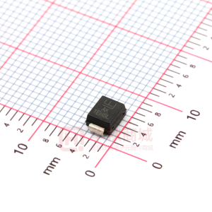

Silicon Avalanche Diodes 600W Surface Mount Transient Voltage Supressors SMBJ Series FEATURES • For surface mounted applications in order to optimize ® board space • Low profile package • Built-in strain relief • Glass passivated junction • Low inductance • Excellent clamping capability • Repetition Rate (duty cycle): 0.01% • Fast response time: typically less than 1.0ps from 0 Volts to BV for unidirectional types • Typical IR less than 1 mA above 10V • High Temperature soldering: 250˚C/10 seconds at terminals • Plastic packages has Underwriters Laboratory Flammability 94V-O MAXIMUM RATINGS @25˚C AMBIENT TEMPERATURE AND CHARACTERISTICS (unless otherwise noted) PARAMETER Peak pulse power Dissipation on 10/1000µs waveform (note 1,2, FIG.1) Peak pulse current of on 10\1000µs waveform (note 1, FIG.3) Peak forward Surge Current, 8.3ms Single Half SIne Wave Superimposed on Rated Load, (JEDEC Method) (note 2.3) Operating junction and Storage Temperature Range SYMBOL PPPM VALUE Min 600 UNIT Watts MECHANICAL CHARACTERISTICS • Case:JEDEC DO214AA. Molded plastic over glass passivated junction • Terminal: Solder plated, solderable per MIL-STD-750 Method 2026 • Polarity. Color band denotes positive end(cathode) except IPPM SEE TABLE 1 Amps Bidirectional • Standard Packaging: 12mm tape(EIA STF RS-481) • Weight: 0.003 ounce, 0.093 gram IPSM 100 Amps DEVICES FOR BIPOLAR APPLICATIONS For Bidirectional use C or CA Suffix for types SMBJ5.0 thru types SMBJ110(e.g. SMBJ5.OC, SMBJ170CA) Electrical characteristics apply in both directions Tj, TsTG -55 to +150 -55 to +150 °C Note 1. Non-repetitive current pulse, per Fig.3 and derated above TA= 25˚C per Fig.2 Note 2. Mounted on 5.0mm2(0.03mm thick) Copper Pads to each terminal Note 3. 8.3 ms single half sine-wave, or equivalent square wave, Duty cycle= 4 pulses per minute w w w. l i t t e l f u s e . c o m 1 Silicon Avalanche Diodes 600W Surface Mount Transient Voltage Supressors SMBJ Series ELECTRICAL SPECIFICATION @ Tamb 25°C Part Number (Uni) Part Number (Bi) Device Marking Code Reverse Stand off Voltage VR (Volts) 5.0 6.0 6.5 7.0 7.5 8.0 8.5 9.0 10.0 11.0 12.0 13.0 14.0 15.0 16.0 17.0 18.0 20.0 22.0 24.0 26.0 28.0 30.0 33.0 36.0 40.0 43.0 45.0 48.0 51.0 54.0 58.0 60.0 64.0 70.0 75.0 78.0 85.0 90.0 100.0 110.0 120.0 130.0 150.0 160.0 170.0 180.0 200.0 220.0 250.0 300.0 350.0 400.0 440.0 Breakdown Voltage VBR (Volts) @ IT MIN MAX 6.40 7.00 6.67 7.37 7.22 7.98 7.78 8.60 8.33 9.21 8.89 9.83 9.44 10.40 10.00 11.10 11.10 12.30 12.20 13.50 13.30 14.70 14.40 15.90 15.60 17.20 16.70 18.50 17.80 19.70 18.90 20.90 20.00 22.10 22.20 24.50 24.40 26.90 26.70 29.50 28.90 31.90 31.10 34.40 33.30 36.80 36.70 40.60 40.00 44.20 44.40 49.10 47.80 52.80 50.00 55.30 53.30 58.90 56.70 62.70 60.00 66.30 64.40 71.20 66.70 73.70 71.10 78.60 77.80 86.00 83.30 92.10 86.70 95.80 94.40 104.00 100.00 111.00 111.00 123.00 122.00 135.00 133.00 147.00 144.00 159.00 167.00 185.00 178.00 197.00 189.00 209.00 201.00 222.00 224.00 247.00 246.00 272.00 279.00 309.00 335.00 371.00 391.00 432.00 447.00 494.00 492.00 543.00 Test Current IT (mA) Maximum Clamping Voltage VC @ IPP (Volts) 9.2 10.3 11.2 12.0 12.9 13.6 14.4 15.4 17.0 18.2 19.9 21.5 23.2 24.4 26.0 27.6 29.2 32.4 35.5 38.9 42.1 45.4 48.4 53.3 58.1 64.5 69.4 72.7 77.4 82.4 87.1 93.6 96.8 103.0 113.0 121.0 126.0 137.0 146.0 162.0 177.0 193.0 209.0 243.0 259.0 275.0 292.0 324.0 356.0 405.0 486.0 567.0 648.0 713.0 Maximum Peak Pulse Current IPP (A) 65.3 58.3 53.6 50.0 46.6 44.2 41.7 39.0 35.3 33.0 30.2 28.0 25.9 24.6 23.1 21.8 20.6 18.6 16.9 15.5 14.3 13.3 12.4 11.3 10.4 9.3 8.7 8.3 7.8 7.3 6.9 6.5 6.2 5.9 5.3 5.0 4.8 4.4 4.1 3.7 3.4 3.1 2.9 2.5 2.3 2.2 2.1 1.9 1.7 1.5 1.3 1.1 0.9 0.9 Maximum Reverse Leakage IR @ VR (µA) 800 800 500 200 100 50 20 10 5 5 5 5 5 5 5 5 5 5 5 5 5 5 5 5 5 5 5 5 5 5 5 5 5 5 5 5 5 5 5 5 5 5 5 5 5 5 5 5 5 5 5 5 5 5 ® UNI SMBJ5.0A SMBJ6.0A SMBJ6.5A SMBJ7.0A SMBJ7.5A SMBJ8.0A SMBJ8.5A SMBJ9.0A SMBJ10A SMBJ11A SMBJ12A SMBJ13A SMBJ14A SMBJ15A SMBJ16A SMBJ17A SMBJ18A SMBJ20A SMBJ22A SMBJ24A SMBJ26A SMBJ28A SMBJ30A SMBJ33A SMBJ36A SMBJ40A SMBJ43A SMBJ45A SMBJ48A SMBJ51A SMBJ54A SMBJ58A SMBJ60A SMBJ64A SMBJ70A SMBJ75A SMBJ78A SMBJ85A SMBJ90A SMBJ100A SMBJ110A SMBJ120A SMBJ130A SMBJ150A SMBJ160A SMBJ170A SMBJ180A SMBJ200A SMBJ220A SMBJ250A SMBJ300A SMBJ350A SMBJ400A SMBJ440A SMBJ5.0CA SMBJ6.0CA SMBJ6.5CA SMBJ7.0CA SMBJ7.5CA SMBJ8.0CA SMBJ8.5CA SMBJ9.0CA SMBJ10CA SMBJ11CA SMBJ12CA SMBJ13CA SMBJ14CA SMBJ15CA SMBJ16CA SMBJ17CA SMBJ18CA SMBJ20CA SMBJ22CA SMBJ24CA SMBJ26CA SMBJ28CA SMBJ30CA SMBJ33CA SMBJ36CA SMBJ40CA SMBJ43CA SMBJ45CA SMBJ48CA SMBJ51CA SMBJ54CA SMBJ58CA SMBJ60CA SMBJ64CA SMBJ70CA SMBJ75CA SMBJ78CA SMBJ85CA SMBJ90CA SMBJ100CA SMBJ110CA SMBJ120CA SMBJ130CA SMBJ150CA SMBJ160CA SMBJ170CA SMBJ180CA SMBJ200CA SMBJ220CA SMBJ250CA SMBJ300CA SMBJ350CA SMBJ400CA SMBJ440CA KE KG KK KM KP KR KT KV KX KZ LE LG LK LM LP LR LT LV LX LZ ME MG MK MM MP MR MT MV MX MZ NE NG NK NM NP NR NT NV NX NZ PE PG PK PM PP PR PT PV PX PZ QE QG QK QM BI AE AG AK AM AP AR AT AV AX AZ BE BG BK BM BP BR BT BV BX BZ CE CG CK CM CP CR CT CV CX CZ DE DG DK DM DP DR DT DV DX DZ EE EG EK EM EP ER ET EV EX EZ FE FG FK FM 10 10 10 10 1 1 1 1 1 1 1 1 1 1 1 1 1 1 1 1 1 1 1 1 1 1 1 1 1 1 1 1 1 1 1 1 1 1 1 1 1 1 1 1 1 1 1 1 1 1 1 1 1 1 For bidirectional type having Vrwm of 10 volts and less, the IR limit is double. For parts without A , the VBR is + 10% 2 w w w. l i t t e l f u s e . c o m Silicon Avalanche Diodes 600W Surface Mount Transient Voltage Supressors SMBJ Series Ratings and Characteristic Curves TA=25˚C unless otherwise noted Fig. 1 Peak Pulse Power Rating Peak Pulse Power (PPP) or Current (IPP) Derating in Percentage, % ® 100 PPPM- Peak Pulse Power (KW) 100 Fig. 2 Pulse Derating Curve 75 10 50 1 0.2x0.2"(5.0x5.0mm) Copper Pad Areas 25 0.1 0.1µs 1.0µs 10µs 100µs 0 0 25 50 75 100 125 150 175 200 TA- Ambient Temperature (˚C) 1.0ms 10ms td- Pulse Width (sec.) Fig. 3 Pulse Waveform 150 IPPM- Peak Pulse Current, % I RSM tr=10µsec Peak Value IPPM Half Value IPPM 2 TJ=25˚C Pulse Width(td) is defined as the point where the peak current decays to 50% of IPPM Fig. 4- Typical Junction Capacitance 6000 CJ-Junction Capacitance (pF) Measured at Zero Bias 100 1000 50 100 10/1000µsec. Waveform as defined by R.E.A VR, Measured at Stand-Off Voltage, VWM TJ=25˚C f=1.0MHZ Vsig=50mVp-p td 0 0 10 1.0 2.0 3.0 4.0 1.0 Uni-Directional Bi-Directional 10 100 200 VWM-Reverse Stand-Off Voltage (V) Fig. 5- Typ. Transient Thermal Impedance 100 IPSM-Peak Forward Surge Current (A) Transient Thermal Impedance (˚C/W) Fig. 6- Maximum Non-Repetitive Peak Forward Surge Current 200 8.3 Single Half Sine-Wave (JEDEC Method) Undirectional Only 100 10 1.0 0.1 0.001 0.01 0.1 1 10 100 1000 10 1 10 Number of Cycles at 60Hz 100 tp- Pulse Duration(sec) w w w. l i t t e l f u s e . c o m 3 Silicon Avalanche Diodes 600W Surface Mount Transient Voltage Supressors SMBJ Series Package Outline Dimensions and Pad Layout ® DO-214AA (SMB J-Bend) Cathode Band 2.16 2.74 2.16 0.086 (2.20) 0.077 (1.95) 0.155 (3.94) 0.130 (3.30) 2.26 Solder Pads 0.180 (4.57) 0.160 (4.06) 0.012 (0.305) 0.006 (0.152) All dimensions in mm 0.096 (2.44) 0.084 (2.13) 0.008 (0.203) MAX 0.060 (1.52) 0.030 (0.76) 0.220 (5.59) 0.205 (5.21) Dimensions in inches and (millimeters) 4 w w w. l i t t e l f u s e . c o m
