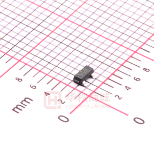

TVS Diode Arrays Surface Mount TVS Avalanche Diode Array SP0502BA, SP0503BA, SP0504BA, SP0505BA, SP0506BA The surface mount family of arrays are designed to suppress ESD and other transient overvoltage events. These arrays are used to meet the International Electrotechnical Compatibility (IEC transient immunity standards IEC 61000-4-2 for Electrostatic Discharge Requirements). The series are used to help protect sensitive digital or analog input circuits on data, signal, or control lines with voltage levels up to 5VDC. The monolithic silicon arrays are comprised of specially designed structures for transient voltage suppression(TVS). The size and shape of these structures have be tailored for transient protection. The low capacitance and clamp voltage are ideal for high speed signal line protection. Ordering Information Part Number SP0502BAHT SP0503BAHT SP0504BAHT SP0505BAHT SP0504BAAT SP0506BAAT SP0502BAJT SP0504BAJT SP0505BAJT CH 2 3 4 5 4 6 2 4 5 Package Type SOT23 SOT143 SOT23-5 SOT23-6 TSSOP-8 MSOP-8 SC70-3 SC70-5 SC70-6 Quantity Per Reel 3000 3000 3000 3000 4000 4000 3000 3000 3000 Features • An Array of 2, 3, 4, 5 or 6 TVS Avalanche Diodes in a ultra small SC70, SOT-23, SOT-143, MSOP or TSSOP packages • ESD Capability Standards IEC 61000-4-2, Direct Discharge . . . . . . . . . 20kV (Level 4) IEC 61000-4-2, Air Discharge . . . . . . . . . . . 30kV (Level 4) MIL STD 883 3015.7 . . . . . . . . . . . . . . . . . . . . . . . . . . 30kV • Input Protection for Applications Up to 5VDC • Fast Response Time . . . . . . . . . . . . . . . . . . . . . . . . . . . < 1ns • Low Input Capacitance . . . . . . . . . . . . . . . . . . . . 30pF Typical • Operating Temperature Range. . . . . . . . . . . . . -40°C to 85°C Pinout SP0502BAHT SP0502BAJT 1 1 SP0503BAHT 4 SP0504BAHT SP0504BAJT 1 5 Applications • • • • • • • Mobile phone handsets Personal Digital Assistants (PDA) Portable handheld equipment (Laptop, Palmtop computers) Computer port, keyboard (USB1.1) Digital still cameras Digital video cameras MP3 players 3 2 2 2 3 3 4 SP0505BAHT SP0505BAJT 1 6 SP0504BAAT 8 7 6 5 SP0506BAAT 8 7 6 5 2 5 3 4 1 2 3 4 1 2 3 4 220 w w w. l i t t e l f u s e . c o m TVS Diode Arrays Surface Mount TVS Avalanche Diode Array SP0502BA, SP0503BA, SP0504BA, SP0505BA, SP0506BA Electrical Specifications TA = -25°C, Unless Otherwise Specified PARAMETER Reverse Standoff Voltage Reverse Standoff Leakage Current Signal Clamp Voltage Positive Negative Clamp Voltage during ESD MIL-STD-883 Method 3015 (HBM) test 8kV 8kV ESD Test Level (1) IEC-61000-2, Contact discharge MIL-STD-883 Method 3015 (HBM) Capacitance Turn on/off Time Temperature Range Operating Storage Diode Dynamic Resistance Forward Conduction Reverse Conduction 1.0 1.4 Ω Ω -40 -65 85 150 °C °C 2.5V @ 1Mhz 20 30 30
