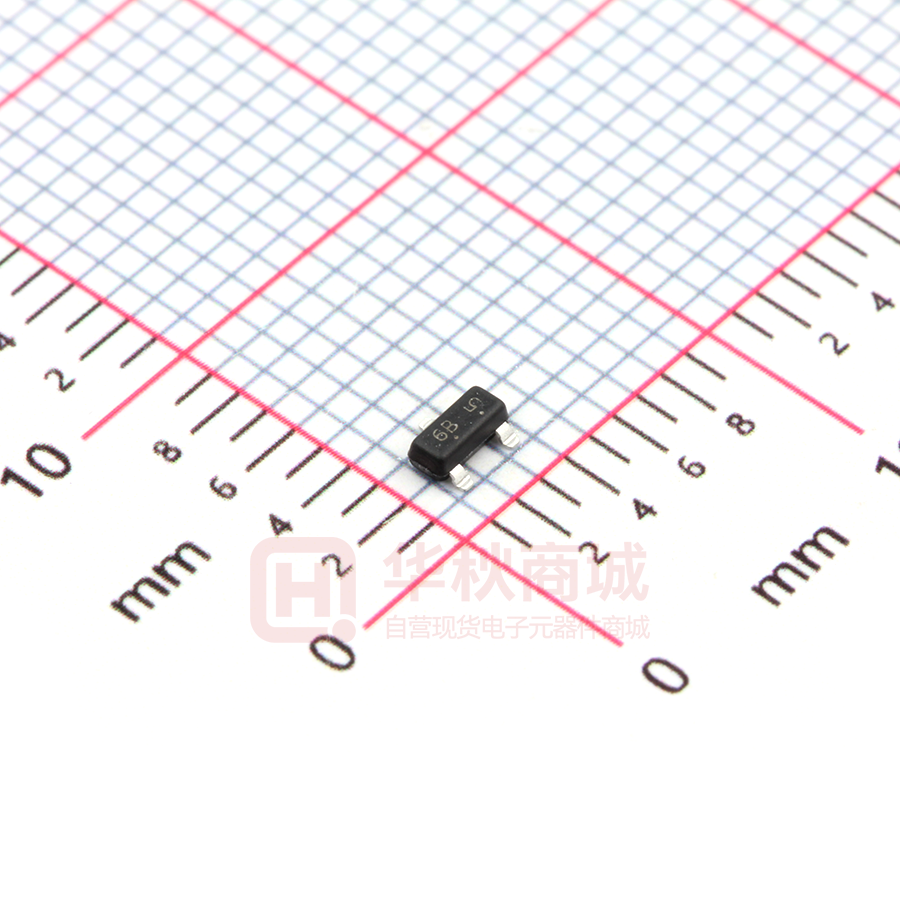

LBC817-25LT1G
LBC817-25LT1G
    LRC(乐山无线电)
    SOT-23
    500mA 45V NPN
LBC817-25LT1G 数据手册
LESHAN RADIO COMPANY, LTD. General Purpose Transistors NPN Silicon LBC817-16LT1G LBC817-25LT1G LBC817-40LT1G • We declare that the material of product compliance with RoHS requirements. 3 MAXIMUM RATINGS Rating Symbol Value Unit Collector–Emitter Voltage V CEO 45 V Collector–Base Voltage V CBO 50 V Emitter–Base Voltage V EBO 5.0 V IC 500 mAdc Collector Current — Continuous 1 2 SOT–23 THERMAL CHARACTERISTICS Characteristic 3 COLLECTOR Symbol Total Device Dissipation FR– 5 Board, (1) TA = 25°C Derate above 25°C Thermal Resistance, Junction to Ambient Total Device Dissipation Alumina Substrate, (2) TA = 25°C Derate above 25°C Thermal Resistance, Junction to Ambient Junction and Storage Temperature Max Unit 225 1.8 556 mW mW/°C °C/W 300 2.4 417 –55 to +150 mW mW/°C °C/W °C PD R θJA PD R θJA T J , T stg 1 BASE 2 EMITTER DEVICE MARKING LBC817–16LT1G = 6A; LBC817–25LT1G = 6B; LBC817–40LT1G = 6C ELECTRICAL CHARACTERISTICS (TA = 25°C unless otherwise noted.) Characteristic Symbol Min Typ Max Unit V (BR)CEO 45 — — V V (BR)CES 50 — — V V 5.0 — — V (VCB = 20 V) — — 100 nA (VCB = 20 V, TA = 150°C) — — 5.0 µA OFF CHARACTERISTICS Collector–Emitter Breakdown Voltage (IC = 10 mA) Collector–Emitter Breakdown Voltage (VEB = 0, IC = 10 µA) Emitter–Base Breakdown Voltage (I E = 1.0 µA) Collector Cutoff Current (BR)EBO I CBO 1. FR–5 = 1.0 x 0.75 x 0.062 in. 2. Alumina = 0.4 x 0.3 x 0.024 in. 99.5% alumina. Rev.O 1/10 LESHAN RADIO COMPANY, LTD. LBC817-16LT1G LBC817-25LT1G LBC817-40LT1G ELECTRICAL CHARACTERISTICS (TA = 25°C unless otherwise noted) (Continued) Characteristic Symbol Min Typ Max Unit ON CHARACTERISTICS DC Current Gain (I C= 100 mA, V CE = 1.0 V) h FE LBC817–16 LBC817–25 LBC817–40 100 160 250 40 (I C = 500 mA, V CE = 1.0 V) Collector–Emitter Saturation Voltage (I C = 500 mA, I B = 50 mA) Base–Emitter On Voltage — — — — 250 400 600 — V CE(sat) — — 0.7 V V BE(on) — — 1.2 V fT 100 — — MHz C obo — 10 — pF ( I C = 500 mA, V CE = 1.0 V) SMALL–SIGNAL CHARACTERISTICS Current–Gain — Bandwidth Product ( I C = 10 mA, V CE = 5.0 V dc, f = 100 MHz) Output Capacitance (V CB = 10 V, f = 1.0 MHz) ORDERING INFORMATION Device LBC817-16LT1G Marking Shipping 6A 3000/Tape&Reel LBC817-16LT3G 6A 10000/Tape&Reel LBC817-25LT1G 6B 3000/Tape&Reel LBC817-25LT3G 6B 10000/Tape&Reel LBC817-40LT1G 6C 3000/Tape&Reel LBC817-40LT3G 6C 10000/Tape&Reel Rev.O 2/10 LESHAN RADIO COMPANY, LTD. LBC817-16LT1G LBC817-25LT1G LBC817-40LT1G TYPICAL CHARACTERISTICS − LBC817−16LT1G 1 300 hFE, DC CURRENT GAIN 150°C 200 25°C −55°C 100 0 VCE(sat), COLLECTOR−EMITTER SATURATION VOLTAGE (V) VCE = 1 V 0.001 0.01 0.1 0.001 0.01 0.1 1 IC, COLLECTOR CURRENT (A) Figure 1. DC Current Gain vs. Collector Current Figure 2. Collector Emitter Saturation Voltage vs. Collector Current VBE(on), BASE−EMITTER VOLTAGE (V) VBE(sat), BASE−EMITTER SATURATION VOLTAGE (V) −55°C 0.1 IC, COLLECTOR CURRENT (A) −55°C IC/IB = 10 0.9 25°C 0.8 150°C 0.7 0.6 0.5 0.4 0.3 0.2 150°C 25°C 0.01 1 1.1 1.0 IC/IB = 10 0.0001 0.001 0.01 0.1 1 1.2 1.1 VCE = 5 V 1.0 −55°C 0.9 0.8 25°C 0.7 0.6 150°C 0.5 0.4 0.3 0.2 0.0001 0.001 0.01 0.1 IC, COLLECTOR CURRENT (A) IC, COLLECTOR CURRENT (A) Figure 3. Base Emitter Saturation Voltage vs. Collector Current Figure 4. Base Emitter Voltage vs. Collector Current Rev.O 3/10 1 LESHAN RADIO COMPANY, LTD. LBC817-16LT1G LBC817-25LT1G LBC817-40LT1G θV, TEMPERATURE COEFFICIENTS (mV/ °C) 1.0 TJ = 25°C 0.8 0.6 0.4 IC = 10 mA 100 mA 300 mA 500 mA 0.2 0 0.01 0.1 1 IB, BASE CURRENT (mA) 10 +1 qVC for VCE(sat) 0 -1 qVB for VBE -2 100 1 Figure 5. Saturation Region 10 100 IC, COLLECTOR CURRENT (mA) Figure 6. Temperature Coefficients 100 C, CAPACITANCE (pF) VCE , COLLECTOR-EMITTER VOLTAGE (VOLTS) TYPICAL CHARACTERISTICS − LBC817−16LT1G Cib 10 Cob 1 0.1 10 1 VR, REVERSE VOLTAGE (VOLTS) 100 Figure 7. Capacitances Rev.O 4/10 1000 LESHAN RADIO COMPANY, LTD. LBC817-16LT1G LBC817-25LT1G LBC817-40LT1G TYPICAL CHARACTERISTICS − LBC817-25LT1G 1 500 hFE, DC CURRENT GAIN 150°C VCE(sat), COLLECTOR−EMITTER SATURATION VOLTAGE (V) VCE = 1 V 400 300 25°C 200 −55°C 100 0 0.001 0.01 0.001 0.01 0.1 1 Figure 8. DC Current Gain vs. Collector Current Figure 9. Collector Emitter Saturation Voltage vs. Collector Current VBE(on), BASE−EMITTER VOLTAGE (V) −55°C IC/IB = 10 25°C 0.8 150°C 0.7 0.6 0.5 0.4 0.3 0.0001 0.001 0.01 0.1 1 1.2 1.1 VCE = 5 V 1.0 0.9 −55°C 0.8 25°C 0.7 0.6 0.5 150°C 0.4 0.3 0.2 0.0001 0.001 0.01 0.1 IC, COLLECTOR CURRENT (A) IC, COLLECTOR CURRENT (A) Figure 10. Base Emitter Saturation Voltage vs. Collector Current Figure 11. Base Emitter Voltage vs. Collector Current 1000 fT, CURRENT−GAIN−BANDWIDTH PRODUCT (MHz) VBE(sat), BASE−EMITTER SATURATION VOLTAGE (V) −55°C IC, COLLECTOR CURRENT (A) 0.9 0.2 0.1 IC, COLLECTOR CURRENT (A) 1.1 1.0 150°C 25°C 0.01 1 0.1 IC/IB = 10 VCE = 1 V TA = 25°C 100 10 0.1 1 10 100 1000 IC, COLLECTOR CURRENT (mA) Figure 12. Current Gain Bandwidth Product vs. Collector Current Rev.O 5/10 1 LESHAN RADIO COMPANY, LTD. LBC817-16LT1G LBC817-25LT1G LBC817-40LT1G θV, TEMPERATURE COEFFICIENTS (mV/ °C) 1.0 TJ = 25°C 0.8 0.6 0.4 IC = 10 mA 100 mA 300 mA 500 mA 0.2 0 0.01 0.1 1 IB, BASE CURRENT (mA) 10 +1 qVC for VCE(sat) 0 -1 qVB for VBE -2 100 1 Figure 13. Saturation Region 10 100 IC, COLLECTOR CURRENT (mA) 1000 Figure 14. Temperature Coefficients 100 C, CAPACITANCE (pF) VCE , COLLECTOR-EMITTER VOLTAGE (VOLTS) TYPICAL CHARACTERISTICS − LBC817-25LT1G Cib 10 Cob 1 0.1 10 1 VR, REVERSE VOLTAGE (VOLTS) 100 Figure 15. Capacitances Rev.O 6/10 LESHAN RADIO COMPANY, LTD. LBC817-16LT1G LBC817-25LT1G LBC817-40LT1G TYPICAL CHARACTERISTICS − LBC817-40LT1G 1 700 150°C VCE(sat), COLLECTOR−EMITTER SATURATION VOLTAGE (V) hFE, DC CURRENT GAIN 600 VCE = 1 V 500 25°C 400 300 −55°C 200 100 0 0.001 0.01 0.01 0.001 0.01 0.1 1 Figure 16. DC Current Gain vs. Collector Current Figure 17. Collector Emitter Saturation Voltage vs. Collector Current VBE(on), BASE−EMITTER VOLTAGE (V) −55°C IC/IB = 10 0.8 25°C 0.7 0.6 150°C 0.5 0.4 0.3 0.0001 0.001 0.01 0.1 1 1.2 1.1 VCE = 5 V 1.0 0.9 −55°C 0.8 25°C 0.7 0.6 0.5 150°C 0.4 0.3 0.2 0.0001 0.001 0.01 0.1 IC, COLLECTOR CURRENT (A) IC, COLLECTOR CURRENT (A) Figure 18. Base Emitter Saturation Voltage vs. Collector Current Figure 19. Base Emitter Voltage vs. Collector Current 1000 fT, CURRENT−GAIN−BANDWIDTH PRODUCT (MHz) VBE(sat), BASE−EMITTER SATURATION VOLTAGE (V) −55°C IC, COLLECTOR CURRENT (A) 0.9 0.2 25°C 0.1 IC, COLLECTOR CURRENT (A) 1.1 1.0 150°C 0.001 1 0.1 IC/IB = 10 VCE = 1 V TA = 25°C 100 10 0.1 1 10 100 1000 IC, COLLECTOR CURRENT (mA) Figure 20. Current Gain Bandwidth Product vs. Collector Current Rev.O 7/10 1 LESHAN RADIO COMPANY, LTD. LBC817-16LT1G LBC817-25LT1G LBC817-40LT1G θV, TEMPERATURE COEFFICIENTS (mV/ °C) 1.0 TJ = 25°C 0.8 0.6 0.4 IC = 10 mA 100 mA 300 mA 500 mA 0.2 0 0.01 0.1 1 IB, BASE CURRENT (mA) 10 +1 qVC for VCE(sat) 0 -1 qVB for VBE -2 1 100 Figure 21. Saturation Region 10 100 IC, COLLECTOR CURRENT (mA) Figure 22. Temperature Coefficients 100 C, CAPACITANCE (pF) VCE , COLLECTOR-EMITTER VOLTAGE (VOLTS) TYPICAL CHARACTERISTICS − LBC817-40LT1G Cib 10 Cob 1 0.1 1 10 VR, REVERSE VOLTAGE (VOLTS) 100 Figure 23. Capacitances Rev.O 8/10 1000 LESHAN RADIO COMPANY, LTD. LBC817-16LT1G LBC817-25LT1G LBC817-40LT1G TYPICAL CHARACTERISTICS − LBC817-16LT1G LBC817-25LT1G LBC817-40LT1G 1 1 ms 10 ms 100 ms 1s Thermal Limit IC (A) 0.1 0.01 Single Pulse Test @ TA = 25°C 0.001 0.01 0.1 1 VCE (Vdc) 10 100 Figure 24. Safe Operating Area Rev.O 9/10 LESHAN RADIO COMPANY, LTD. LBC817-16LT1G LBC817-25LT1G LBC817-40LT1G SOT-23 NOTES: A 1. DIMENSIONING AND TOLERANCING PER ANSI Y14.5M, 1982. 2. CONTROLLING DIMENSION: INCH. L 3 1 V 2 B S DIM G A B C D G H J K L S V C D H K J INCHES MIN MAX 0.1102 0.1197 0.0472 0.0551 0.0350 0.0440 0.0150 0.0200 0.0701 0.0807 0.0005 0.0040 0.0034 0.0070 0.0140 0.0285 0.0350 0.0401 0.0830 0.1039 0.0177 0.0236 MILLIMETERS MIN MAX 2.80 3.04 1.20 1.40 0.89 1.11 0.37 0.50 1.78 2.04 0.013 0.100 0.085 0.177 0.35 0.69 0.89 1.02 2.10 2.64 0.45 0.60 PIN 1. BASE 2. EMITTER 3. COLLECTOR 0.037 0.95 0.037 0.95 0.079 2.0 0.035 0.9 0.031 0.8 inches mm Rev.O 10/10
