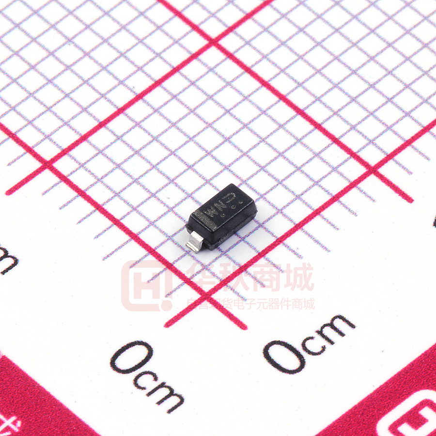

    乐山无线电 SOD−123 Pd: 500mW Zzk: 250Ω
LBZT52C22T1G 数据手册
LESHAN RADIO COMPANY, LTD. LBZT52C2V4T1G Series S-LBZT52C2V4T1G Series Surface Mount Zener Diodes Features: *500mw Power Dissipation *Ideal for Surface Mountted Application *Zener Breakdown Voltage Range 2.4V to 51V *We declare that the material of product compliant with RoHS and Halogen Free. *S- Prefix for Automotive and Other Applications Requiring Unique Site and Control Change Requirements; AEC-Q101 Qualified and PPAP Capable. 1 2 SOD-123 Equivalent Circuit Diagram Mechanical Data: 1 *Case : SOD-123 Molded plastic *Terminals: Solderable per MIL-STD-202, Method 208 *Polarity: Cathode Indicated by Polarity Band *Marking: Marking Code (See Table on Page 2) *Weigh: 0.01grams(approx) Cathode Maximum Ratings and Electrical Characteristics Characteristics Thermal Resistance Junction to Ambient Air (TA=25 C Unless Otherwise Noted) Value Unit PD 500 0 mW 305 C/W VF 0.9 V T J ,T STG -55 to +150 C R Forward Voltage @ IF=10mA Junction and Storage Temperature Range Anode Symbol Total Power Dissipation on FR-5 Board (1) (1) 2 JA NOTES: 2 - - - - 1. Device mounted on ceramic PCB; 7.6mm 9.4mm 0.87mm with pad areas 25mm Ratings and Characteristic curves , P D ,POWER DISSIPATION(W) 0.6 0.5 0.4 0.3 0.2 0.1 0 0 25 50 75 100 125 150 TA,AMBIENT TEMPERATURE( C) FIG. 1 Power Disspation vs Ambient temperaute O Rev.A 1/4 LESHAN RADIO COMPANY, LTD. LBZT52C2V4T1G Series,S-LBZT52C2V4T1G Series Electrical Characteristics ( TA =25 C unless otherwise noted, VF =0.9V Max@ IF =10mA) Maximum Zener Impedanc e (3) Zener Voltage R ange (1) Devic e Device Marking (2) V Z @ I ZT @ I ZT Nom(v) Min(V ) Max(V ) Z ZT @ I ZT Z ZK @ I ZK mA Maximum R evers e C urrent Izk IR @VR Typical Temperature Coefficient @ I ZT mV / C T es t C urrent I ZT C mA uA V Min Max mA 5 5 5 5 5 100 100 95 95 90 90 90 80 60 40 600 600 600 600 600 600 600 500 480 400 1.0 1.0 1.0 1.0 1.0 1.0 1.0 1.0 1.0 1.0 50 20 10 5.0 5.0 3.0 3.0 3.0 2.0 1.0 1.0 1.0 1.0 1.0 1.0 1.0 1.0 2.0 2.0 2.0 -3.5 -3.5 -3.5 -3.5 -3.5 -3.5 -3.5 -3.5 -2.7 -2.0 0 0 0 0 0 0 0 0.2 1.2 2.5 5 5 5 5 5 5 5 5 5 5 6.6 7.2 7.9 8.7 9.6 5 5 5 5 5 10 15 15 15 15 150 80 80 80 100 1.0 1.0 1.0 1.0 1.0 3.0 2.0 1.0 0.7 0.5 4.0 4.0 5.0 5.0 6.0 0.4 1.2 2.5 3.2 3.8 3.7 4.5 5.3 6.2 7.0 5 5 5 5 5 9.4 10.4 11.4 12.4 13.8 10.6 11.6 12.7 14.1 15.8 5 5 5 5 5 150 150 150 170 200 1.0 1.0 1.0 1.0 1.0 0.2 0.1 0.1 0.1 0.1 7.0 8.0 8.0 8.0 10.5 4.5 5.4 6.0 7.0 9.2 8.0 9.0 10.0 11.0 13.0 5 5 5 5 5 15.3 16.8 18.8 20.8 22.8 25.1 28.0 31.0 34.0 37.0 17.1 19.1 21.2 23.3 25.6 28.9 32 35 38 41 5 5 5 5 5 2 2 2 2 2 20 20 25 30 30 40 45 55 55 70 80 80 80 90 130 200 225 225 250 250 300 300 325 350 350 1.0 1.0 1.0 1.0 1.0 0.5 0.5 0.5 0.5 0.5 0.1 0.1 0.1 0.1 0.1 0.1 0.1 0.1 0.1 0.1 11.2 12.6 14.0 15.4 16.8 18.9 21.0 23.1 25.2 27.3 10.4 12.4 14.4 16.4 18.4 21.4 24.4 27.4 30.4 33.4 14.0 16.0 18.0 20.0 22.0 25.3 29.4 33.4 37.4 41.2 5 5 5 5 5 2 2 2 2 2 40.0 44.0 48.0 46 50 54 2 2 2 100 100 100 700 750 750 1.0 1.0 1.0 0.1 0.1 0.1 32 35 38 10.0 10.0 10.0 12.0 12.0 12.0 5 5 5 LBZT 52C 2V 4 T 1G LBZT 52C 2V 7 T 1G LBZT 52C 3V 0 T 1G LBZT 52C 3V 3 T 1G LBZT 52C 3V 6 T 1G WX W1 W2 W3 W4 2.4 2.7 3.0 3.3 3.6 2.2 2.5 2.8 3.1 3.4 2.6 2.9 3.2 3.5 3.8 5 5 5 5 5 LBZT 52C 3V 9 T 1G LBZT 52C 4V 3 T 1G LBZT 52C 4V 7 T 1G LBZT 52C 5V 1 T 1G LBZT 52C 5V 6 T 1G W5 W6 W7 W8 W9 3.9 4.3 4.7 5.1 5.6 3.7 4.0 4.4 4.8 5.2 4.1 4.6 5.0 5.4 6.0 LBZT 52C 6V 2 T 1G LBZT 52C 6V 8 T 1G LBZT 52C 7V 5 T 1G LBZT 52C 8V 2 T 1G LBZT 52C 9V 1 T 1G LBZT 52C 10 T 1G LBZT 52C 11 T1G LBZT 52C 12 T 1G LBZT 52C 13 T 1G LBZT 52C 15 T 1G WA WB WC WD WE 6.2 6.8 7.5 8.2 9.1 5.8 6.4 7.0 7.7 8.5 WF WG WH WI WJ 10 11 12 13 15 LBZT 52C 16 T 1G LBZT 52C 18 T 1G LBZT 52C 20 T 1G LBZT 52C 22 T 1G LBZT 52C 24 T 1G WK WL WM WN WO 16 18 20 22 24 LBZT 52C 27 T 1G LBZT 52C 30 T 1G LBZT 52C 33 T 1G LBZT 52C 36 T 1G LBZT 52C 39 T 1G LBZT 52C 43 T 1G LBZT 52C 47 T 1G LBZT 52C 51 T 1G WP WQ WR WS WT WU WV WW 27 30 33 36 39 43 47 51 Note: 1. Tested with pulses, period = 5ms, pulse width = 300us. 2. When provided, otherwise, parts are provided with date code only, and type number identifications appears on reel only. 3. f=1KHz. Rev.A 2/4 LESHAN RADIO COMPANY, LTD. LBZT52C2V4T1G Series , S-LBZT52C2V4T1G Series 22 20 18 16 15 13 12 11 10 8.2 9.1 7.5 6.8 6.2 5.1 100m 5.6 ELECTRICAL CHARACTERISTIC CURVES (Ta=25qC) 4.7 10m 100µ 10µ 1µ 0 5 4.3 3.3 3.0 2.4 2.7 10n 2.2 100n 2.0 ZENER CURRENT : IZ (A) 1m 10 15 20 25 30 35 40 ZENER VOLTAGE : VZ (V) Fig.1 Zener voltage characteristics Rev.A 3/4 LESHAN RADIO COMPANY, LTD. LBZT52C2V4T1G Series,S-LBZT52C2V4T1G Series SOD−123 D ÂÂÂÂ ÂÂÂÂ ÂÂÂÂ NOTES: 1. DIMENSIONING AND TOLERANCING PER ANSI Y14.5M, 1982. 2. CONTROLLING DIMENSION: INCH. A A1 1 HE DIM A A1 b c D E HE L E b MIN 0.037 0.000 0.020 −−− 0.055 0.100 0.140 0.010 INCHES NOM 0.046 0.002 0.024 −−− 0.063 0.106 0.145 −−− MAX 0.053 0.004 0.028 0.006 0.071 0.112 0.152 −−− STYLE 1: PIN 1. CATHODE 2. ANODE L 2 MILLIMETERS MIN NOM MAX 0.94 1.17 1.35 0.00 0.05 0.10 0.51 0.61 0.71 −−− −−− 0.15 1.40 1.60 1.80 2.54 2.69 2.84 3.56 3.68 3.86 −−− −−− 0.25 C SOLDERING FOOTPRINT* ÉÉÉ ÉÉÉ ÉÉÉ 0.91 0.036 2.36 0.093 4.19 0.165 ÉÉÉ ÉÉÉ ÉÉÉ SCALE 10:1 1.22 0.048 mm Ǔ ǒinches Rev.A 4/4
