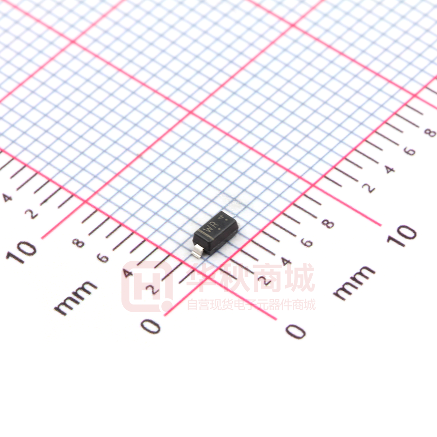

    乐山无线电 SOD−123 Pd: 500mW Zzk: 325Ω
LBZT52C33T1G 数据手册
LESHAN RADIO COMPANY, LTD. LBZT52C2V4T1G Series S-LBZT52C2V4T1G Series Surface Mount Zener Diodes Features: *500mw Power Dissipation *Ideal for Surface Mountted Application *Zener Breakdown Voltage Range 2.4V to 51V *We declare that the material of product compliant with RoHS and Halogen Free. *S- Prefix for Automotive and Other Applications Requiring Unique Site and Control Change Requirements; AEC-Q101 Qualified and PPAP Capable. 1 2 SOD-123 Equivalent Circuit Diagram Mechanical Data: 1 *Case : SOD-123 Molded plastic *Terminals: Solderable per MIL-STD-202, Method 208 *Polarity: Cathode Indicated by Polarity Band *Marking: Marking Code (See Table on Page 2) *Weigh: 0.01grams(approx) Cathode Maximum Ratings and Electrical Characteristics Characteristics Thermal Resistance Junction to Ambient Air (TA=25 C Unless Otherwise Noted) Value Unit PD 500 0 mW 305 C/W VF 0.9 V T J ,T STG -55 to +150 C R Forward Voltage @ IF=10mA Junction and Storage Temperature Range Anode Symbol Total Power Dissipation on FR-5 Board (1) (1) 2 JA NOTES: 2 - - - - 1. Device mounted on ceramic PCB; 7.6mm 9.4mm 0.87mm with pad areas 25mm Ratings and Characteristic curves , P D ,POWER DISSIPATION(W) 0.6 0.5 0.4 0.3 0.2 0.1 0 0 25 50 75 100 125 150 TA,AMBIENT TEMPERATURE( C) FIG. 1 Power Disspation vs Ambient temperaute O Rev.A 1/4 LESHAN RADIO COMPANY, LTD. LBZT52C2V4T1G Series,S-LBZT52C2V4T1G Series Electrical Characteristics ( TA =25 C unless otherwise noted, VF =0.9V Max@ IF =10mA) Maximum Zener Impedanc e (3) Zener Voltage R ange (1) Devic e Device Marking (2) V Z @ I ZT @ I ZT Nom(v) Min(V ) Max(V ) Z ZT @ I ZT Z ZK @ I ZK mA Maximum R evers e C urrent Izk IR @VR Typical Temperature Coefficient @ I ZT mV / C T es t C urrent I ZT C mA uA V Min Max mA 5 5 5 5 5 100 100 95 95 90 90 90 80 60 40 600 600 600 600 600 600 600 500 480 400 1.0 1.0 1.0 1.0 1.0 1.0 1.0 1.0 1.0 1.0 50 20 10 5.0 5.0 3.0 3.0 3.0 2.0 1.0 1.0 1.0 1.0 1.0 1.0 1.0 1.0 2.0 2.0 2.0 -3.5 -3.5 -3.5 -3.5 -3.5 -3.5 -3.5 -3.5 -2.7 -2.0 0 0 0 0 0 0 0 0.2 1.2 2.5 5 5 5 5 5 5 5 5 5 5 6.6 7.2 7.9 8.7 9.6 5 5 5 5 5 10 15 15 15 15 150 80 80 80 100 1.0 1.0 1.0 1.0 1.0 3.0 2.0 1.0 0.7 0.5 4.0 4.0 5.0 5.0 6.0 0.4 1.2 2.5 3.2 3.8 3.7 4.5 5.3 6.2 7.0 5 5 5 5 5 9.4 10.4 11.4 12.4 13.8 10.6 11.6 12.7 14.1 15.8 5 5 5 5 5 150 150 150 170 200 1.0 1.0 1.0 1.0 1.0 0.2 0.1 0.1 0.1 0.1 7.0 8.0 8.0 8.0 10.5 4.5 5.4 6.0 7.0 9.2 8.0 9.0 10.0 11.0 13.0 5 5 5 5 5 15.3 16.8 18.8 20.8 22.8 25.1 28.0 31.0 34.0 37.0 17.1 19.1 21.2 23.3 25.6 28.9 32 35 38 41 5 5 5 5 5 2 2 2 2 2 20 20 25 30 30 40 45 55 55 70 80 80 80 90 130 200 225 225 250 250 300 300 325 350 350 1.0 1.0 1.0 1.0 1.0 0.5 0.5 0.5 0.5 0.5 0.1 0.1 0.1 0.1 0.1 0.1 0.1 0.1 0.1 0.1 11.2 12.6 14.0 15.4 16.8 18.9 21.0 23.1 25.2 27.3 10.4 12.4 14.4 16.4 18.4 21.4 24.4 27.4 30.4 33.4 14.0 16.0 18.0 20.0 22.0 25.3 29.4 33.4 37.4 41.2 5 5 5 5 5 2 2 2 2 2 40.0 44.0 48.0 46 50 54 2 2 2 100 100 100 700 750 750 1.0 1.0 1.0 0.1 0.1 0.1 32 35 38 10.0 10.0 10.0 12.0 12.0 12.0 5 5 5 LBZT 52C 2V 4 T 1G LBZT 52C 2V 7 T 1G LBZT 52C 3V 0 T 1G LBZT 52C 3V 3 T 1G LBZT 52C 3V 6 T 1G WX W1 W2 W3 W4 2.4 2.7 3.0 3.3 3.6 2.2 2.5 2.8 3.1 3.4 2.6 2.9 3.2 3.5 3.8 5 5 5 5 5 LBZT 52C 3V 9 T 1G LBZT 52C 4V 3 T 1G LBZT 52C 4V 7 T 1G LBZT 52C 5V 1 T 1G LBZT 52C 5V 6 T 1G W5 W6 W7 W8 W9 3.9 4.3 4.7 5.1 5.6 3.7 4.0 4.4 4.8 5.2 4.1 4.6 5.0 5.4 6.0 LBZT 52C 6V 2 T 1G LBZT 52C 6V 8 T 1G LBZT 52C 7V 5 T 1G LBZT 52C 8V 2 T 1G LBZT 52C 9V 1 T 1G LBZT 52C 10 T 1G LBZT 52C 11 T1G LBZT 52C 12 T 1G LBZT 52C 13 T 1G LBZT 52C 15 T 1G WA WB WC WD WE 6.2 6.8 7.5 8.2 9.1 5.8 6.4 7.0 7.7 8.5 WF WG WH WI WJ 10 11 12 13 15 LBZT 52C 16 T 1G LBZT 52C 18 T 1G LBZT 52C 20 T 1G LBZT 52C 22 T 1G LBZT 52C 24 T 1G WK WL WM WN WO 16 18 20 22 24 LBZT 52C 27 T 1G LBZT 52C 30 T 1G LBZT 52C 33 T 1G LBZT 52C 36 T 1G LBZT 52C 39 T 1G LBZT 52C 43 T 1G LBZT 52C 47 T 1G LBZT 52C 51 T 1G WP WQ WR WS WT WU WV WW 27 30 33 36 39 43 47 51 Note: 1. Tested with pulses, period = 5ms, pulse width = 300us. 2. When provided, otherwise, parts are provided with date code only, and type number identifications appears on reel only. 3. f=1KHz. Rev.A 2/4 LESHAN RADIO COMPANY, LTD. LBZT52C2V4T1G Series , S-LBZT52C2V4T1G Series 22 20 18 16 15 13 12 11 10 8.2 9.1 7.5 6.8 6.2 5.1 100m 5.6 ELECTRICAL CHARACTERISTIC CURVES (Ta=25qC) 4.7 10m 100µ 10µ 1µ 0 5 4.3 3.3 3.0 2.4 2.7 10n 2.2 100n 2.0 ZENER CURRENT : IZ (A) 1m 10 15 20 25 30 35 40 ZENER VOLTAGE : VZ (V) Fig.1 Zener voltage characteristics Rev.A 3/4 LESHAN RADIO COMPANY, LTD. LBZT52C2V4T1G Series,S-LBZT52C2V4T1G Series SOD−123 D ÂÂÂÂ ÂÂÂÂ ÂÂÂÂ NOTES: 1. DIMENSIONING AND TOLERANCING PER ANSI Y14.5M, 1982. 2. CONTROLLING DIMENSION: INCH. A A1 1 HE DIM A A1 b c D E HE L E b MIN 0.037 0.000 0.020 −−− 0.055 0.100 0.140 0.010 INCHES NOM 0.046 0.002 0.024 −−− 0.063 0.106 0.145 −−− MAX 0.053 0.004 0.028 0.006 0.071 0.112 0.152 −−− STYLE 1: PIN 1. CATHODE 2. ANODE L 2 MILLIMETERS MIN NOM MAX 0.94 1.17 1.35 0.00 0.05 0.10 0.51 0.61 0.71 −−− −−− 0.15 1.40 1.60 1.80 2.54 2.69 2.84 3.56 3.68 3.86 −−− −−− 0.25 C SOLDERING FOOTPRINT* ÉÉÉ ÉÉÉ ÉÉÉ 0.91 0.036 2.36 0.093 4.19 0.165 ÉÉÉ ÉÉÉ ÉÉÉ SCALE 10:1 1.22 0.048 mm Ǔ ǒinches Rev.A 4/4
LBZT52C33T1G
物料型号:LBZT52C2V4T1G系列和S-LBZT52C2V4T1G系列
器件简介: - 功率耗散:500mW - 适用于表面安装 - Zener击穿电压范围:2.4V至51V - 符合RoHS和无卤要求 - S-前缀用于汽车和其他需要独特现场和控制变更要求的应用;AEC-Q101合格和PPAP能力
引脚分配: - 封装类型:SOD-123模塑塑料 - 极性:通过极性带指示阴极 - 标记:标记代码(见第2页表格)
参数特性: - 总功率耗散在FR-5板上:500mW - 热阻从结到环境空气:305°CW - 正向电压@IF=10mA:0.9V - 结和存储温度范围:-55至+150℃
功能详解: - 提供了详细的电气特性表,包括Zener电压范围、最大Zener阻抗、最大反向电流、典型温度系数等。
应用信息: - 适用于需要Zener二极管的电路,如稳压、过压保护等。
封装信息: - 封装类型:SOD-123 - 机械数据:包括尺寸、重量等。
