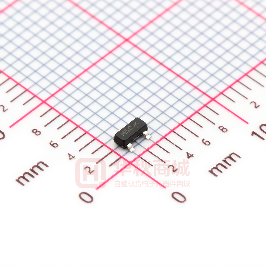

LMBD7000LT1G
LMBD7000LT1G
    LRC(乐山无线电)
    SOT-23
    开关二极管 二极管配置 1对串联式 正向压降(Vf)1.1V 直流反向耐压(Vr)100V
LMBD7000LT1G 数据手册
LESHAN RADIO COMPANY, LTD. Dual Switching Diode LMBD7000LT1G FEATURE z We declare that the material of product compliance with RoHS requirements. 3 ORDERING INFORMATION Device Package LMBD7000LT1G Shipping SOT–23 3000/Tape & Reel LMBD7000LT3G SOT–23 10000/Tape & Reel 1 2 SOT– 23 MAXIMUM RATINGS(EACH DIODE) Rating Reverse Voltage Forward Current Peak Forward Surge Current Symbol VR IF I FM(surge) Value 100 200 500 Unit Vdc mAdc mAdc THERMAL CHARACTERISTICS Characteristic Total Device Dissipation FR– 5 Board (1) T A = 25°C Derate above 25°C Thermal Resistance, Junction to Ambient Total Device Dissipation Alumina Substrate, (2) T A = 25°C Derate above 25°C Thermal Resistance, Junction to Ambient Junction and Storage Temperature 2 CATHODE 1 Symbol PD Max 225 Unit mW ANODE R θ JA P D 1.8 556 300 mW/°C °C/W mW R θ JA T J , T stg 2.4 417 –55 to +150 mW/°C °C/W °C 3 CATHODE/ANODE DEVICEMARKING LMBD7000LT1G = M5C ELECTRICAL CHARACTERISTICS (T A = 25°C unless otherwise noted)(EACH DIODE) Characteristic Symbol Min Max Unit V (BR) 100 — Vdc IR I R2 I R3 VF — — — 1.0 3.0 100 0.55 0.67 0.75 0.7 0.82 1.1 t rr — 4.0 ns C — 1.5 pF OFFCHARACTERISTICS Reverse Breakdown Voltage (I (BR) = 100 µAdc) µ Adc Reverse Voltage Leakage Current (V R = 50 Vdc) (V R = 100 Vdc) (V R = 50 Vdc,125°C) Forward Voltage (I F = 1.0 mAdc) (I F = 10 mAdc) (I F = 100 mAdc) Reverse Recovery Time (I F = I R = 10 mAdc) (Figure 1) Capacitance(VR=0V) 1. FR–5 = 1.0 x 0.75 x 0.062 in. 2. Alumina = 0.4 x 0.3 x 0.024 in. 99.5% alumina. Vdc Rev.O 1/3 LESHAN RADIO COMPANY, LTD. LMBD7000LT1G +10 V 2.0 k 820 Ω 100 µH IF 0.1 µF tp tr 0.1µF IF t t 10% t rr 90% DUT 50 Ω INPUT SAMPLING OSCILLOSCOPE 50 Ω OUTPUT PULSE GENERATOR i IR INPUT SIGNAL V R(REC) = 1.0 mA OUTPUT PULSE (I F = I R = 10 mA; MEASURED at i R(REC) = 1.0 mA) R Notes: 1. A 2.0 kΩ variable resistor adjusted for a Forward Current (I F ) of 10mA. Notes: 2. Input pulse is adjusted so I R(peak) is equal to 10mA. Notes: 3. t p » t rr Figure 1. Recovery Time Equivalent Test Circuit CURVES APPLICABLE TO EACH CATHODE 10 I R, REVERSE CURRENT ( µA) T A = 85°C T A= –40°C 10 T A = 25°C 1.0 T A =150°C T A =125°C 1.0 T A =85°C 0.1 T A =55°C 0.01 T A =25°C 0.001 0.1 0.2 0.4 0.6 0.8 1.0 0 1.2 10 20 30 40 V F , FORWARD VOLTAGE (VOLTS) V R , REVERSE VOLTAGE (VOLTS) Figure 2. Forward Voltage Figure 3. Leakage Current 0.68 C D , DIODE CAPACITANCE (pF) I F , FORWARD CURRENT (mA) 100 0.64 0.60 0.56 0.52 0 2.0 4.0 6.0 8.0 V R , REVERSE VOLTAGE (VOLTS) Figure 4. Capacitance Rev.O 2/3 50 LESHAN RADIO COMPANY, LTD. LMBD7000LT1G SOT-23 NOTES: A 1. DIMENSIONING AND TOLERANCING PER ANSI Y14.5M, 1982. 2. CONTROLLING DIMENSION: INCH. L 3 1 V 2 B S DIM G A B C D G H J K L S V C D H K J INCHES MIN MAX 0.1102 0.1197 0.0472 0.0551 0.0350 0.0440 0.0150 0.0200 0.0701 0.0807 0.0005 0.0040 0.0034 0.0070 0.0140 0.0285 0.0350 0.0401 0.0830 0.1039 0.0177 0.0236 MILLIMETERS MIN MAX 2.80 3.04 1.20 1.40 0.89 1.11 0.37 0.50 1.78 2.04 0.013 0.100 0.085 0.177 0.35 0.69 0.89 1.02 2.10 2.64 0.45 0.60 PIN 1. ANODE 2. CATHODE 3. CATHODE/ANODE 0.037 0.95 0.037 0.95 0.079 2.0 0.035 0.9 0.031 0.8 inches mm Rev.O 3/3
