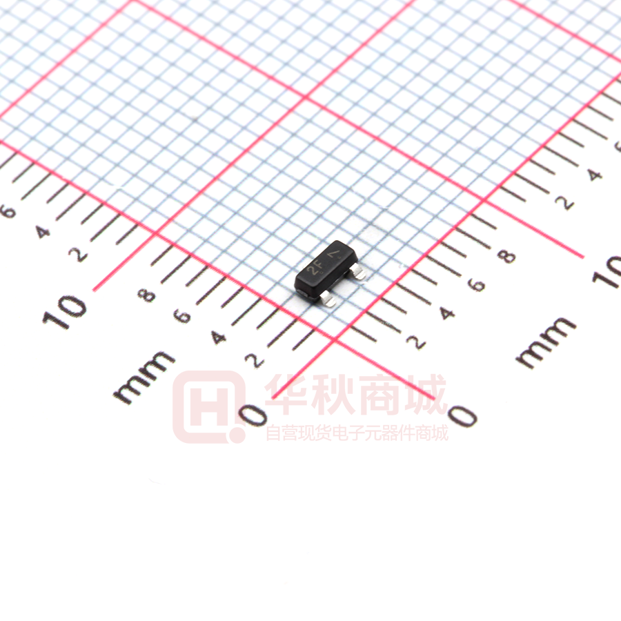

    通用三极管 Pd:225mW Vceo:60V Ic:600mA PNP Vceo=-60V,Ic=-600mA
LMBT2907ALT1G 数据手册
LESHAN RADIO COMPANY, LTD. General Purpose Transistor PNP Silicon • We declare that the material of product compliance with RoHS requirements. • S- Prefix for Automotive and Other Applications Requiring Unique Site and Control Change Requirements; AEC-Q101 Qualified and PPAP Capable. LMBT2907LT1G LMBT2907ALT1G S-LMBT2907LT1G S-LMBT2907ALT1G 3 ORDERING INFORMATION Device 1 Shipping Marking 2 LMBT2907LT1G,S-LMBT2907LT1G M2B 3000/Tape & Reel LMBT2907LT3G,S-LMBT2907LT3G M2B 10000/Tape & Reel LMBT2907ALT1G,S-LMBT2907ALT1G 2F 3000/Tape & Reel LMBT2907ALT3G,S-LMBT2907ALT3G 2F 10000/Tape & Reel Symbol Value 2907 2907A V CEO Collector–Base Voltage V CBO –60 Vdc Emitter–Base Voltage V EBO –5.0 Vdc –600 mAdc I C –40 –60 Unit Collector–Emitter Voltage Collector Current — Continuous 3 COLLECTOR 1 BASE MAXIMUM RATINGS Rating SOT–23 Vdc 2 EMITTER THERMAL CHARACTERISTICS Characteristic Total Device Dissipation FR– 5 Board, (1) TA = 25°C Derate above 25°C Thermal Resistance, Junction to Ambient Total Device Dissipation Alumina Substrate, (2) TA = 25°C Derate above 25°C Thermal Resistance, Junction to Ambient Junction and Storage Temperature Symbol Max Unit PD 225 mW RθJA PD 1.8 556 300 RθJA TJ , Tstg 2.4 417 –55 to +150 mW/°C °C/W mW mW/°C °C/W °C Stresses exceeding Maximum Ratings may damage the device. Maximum Ratings are stress ratings only. Functional operation above the Recommended Operating Conditions is not implied. Extended exposure to stresses above the Recommended Operating Conditions may affect device reliability. 1. FR−5 = 1.0  0.75  0.062 in. 2. Alumina = 0.4  0.3  0.024 in. 99.5% alumina. Rev.A 1/7 LESHAN RADIO COMPANY, LTD. LMBT2907LT1G S-LMBT2907LT1G LMBT2907ALT1G S-LMBT2907ALT1G ELECTRICAL CHARACTERISTICS (TA = 25°C unless otherwise noted.) Characteristic Symbol Min Max –40 –60 –60 –5.0 — — — — — –50 — — –0.020 –0.010 — — — –20 –10 –50 35 75 50 100 75 100 –– 100 30 50 –– –– –– –– –– –– –– 300 –– –– –– –– –0.4 –1.6 –– –– –1.3 –2.6 Unit OFF CHARACTERISTICS Collector–Emitter Breakdown Voltage(3) V LMBT2907 LMBT2907A Collector–Emitter Breakdown Voltage(I C = –10 µAdc, I E = 0) Emitter–Base Breakdown Voltage(I E = –10 µAdc, I C = 0) Collector Cutoff Current( V CB = –30Vdc, I BE(OFF) = –0.5Vdc) Collector Cutoff Current ( V CB = –50Vdc, I E = 0) LMBT2907 LMBT2907A ( V CB = –50Vdc, I E = 0, T A =125°C ) V (BR)CBO V (BR)EBO I CEX I CBO LMBT2907 LMBT2907A Base Current( V CE = –30Vdc, V EB(off)= –0.5Vdc ) Vdc (BR)CEO (I C = –10 mAdc, I B = 0) IB Vdc Vdc nAdc µAdc nAdc ON CHARACTERISTICS DC Current Gain (I C = –0.1mAdc, V CE = –10 Vdc) (I C =–1.0mAdc, V CE = –10 Vdc) (I C = –10 mAdc, V CE = –10Vdc) (I C = –150mAdc, V CE =–10 Vdc)(3) (I C = –500mAdc, V CE =–10 Vdc)(3) h FE LMBT2907 LMBT2907A LMBT2907 LMBT2907A LMBT2907 LMBT2907A LMBT2907 LMBT2907A LMBT2907 LMBT2907A Collector–Emitter Saturation Voltage(3) (I C = –150mAdc, I B = –15 mAdc) (I C = –500 mAdc, I B = –50 mAdc) Base–Emitter Saturation Voltage(3) (I C = –150mAdc, I B = –15 mAdc) (I C = –500mAdc, I B = –50 mAdc) V CE(sat) Vdc V BE(sat) Vdc 3. Pulse Test: Pulse Width < 300 µs, Duty Cycle < 2.0%. Rev.A 2/7 LESHAN RADIO COMPANY, LTD. LMBT2907LT1G S-LMBT2907LT1G LMBT2907ALT1G S-LMBT2907ALT1G ELECTRICAL CHARACTERISTICS (T A = 25°C unless otherwise noted) (Continued) Characteristic Symbol Min Max Unit 200 –– MHz –– 8.0 pF –– 30 pF — — — — 45 10 40 60 — — 225 280 SMALL–SIGNAL CHARACTERISTICS Current–Gain — Bandwidth Product(3),(4) (I C = –50mAdc, V CE= –20Vdc, f = 100MHz) Output Capacitance (V CB = –10 Vdc, I E = 0, f = 1.0 MHz) f T C obo Input Capacitance C ibo (V EB = –2.0Vdc, I C = 0, f = 1.0 MHz) SWITCHING CHARACTERISTICS Turn–On Time Delay Time Rise Time Fall Time Storage Time Turn–Off Time (V CC = –30 Vdc, I C = –150 mAdc, I B1 = –15 mAdc) t on td tr (V CC = –6.0 Vdc, I C = –150 mAdc,I B1 = I B2 = 15 mAdc) tf ts t off ns ns 4. f T is defined as the frequency at which |h f e | extrapolates to unity. TYPICAL CHARACTERISTICS INPUT INPUT Z o = 50 Ω Z O= 50 Ω PRF = 150 PPS –30 V PRF = 150 PPS RISE TIME
