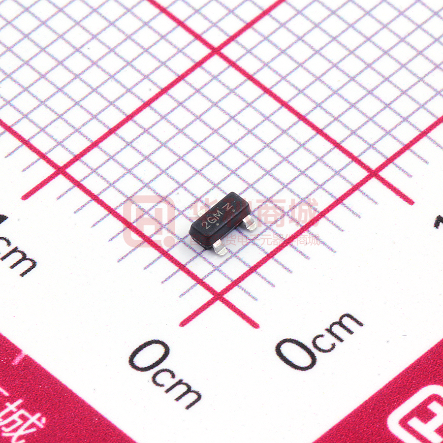

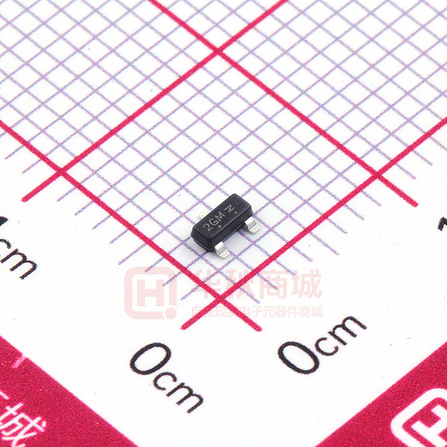

LMBTA56LT1G
LMBTA56LT1G
    LRC(乐山无线电)
    SOT-23
    驱动晶体管PNP硅 100nA 80V 225mW 100@100mA,1V 500mA 50MHz 250mV@100mA,10mA PNP -55℃~+150℃@(Tj) SOT-23
LMBTA56LT1G 数据手册
LESHAN RADIO COMPANY, LTD. Driver Transistors PNP Silicon LMBTA56LT1G S-LMBTA56LT1G ●FEATURES 1) We declare that the material of product compliant with RoHS requirements and Halogen Free. 2) S- Prefix for Automotive and Other Applications Requiring Unique Site and Control Change Requirements; AEC-Q101 Qualified and PPAP Capable. 3 1 2 ●DEVICE MARKING AND ORDERING INFORMATION Device LMBTA56LT1G LMBTA56LT3G SOT–23 Shipping 3000/Tape&Reel 10000/Tape&Reel Marking 2GM 2GM 3 COLLECTOR 1 BASE ●MAXIMUM RATINGS(Ta = 25℃) 2 EMITTER Parameter Collector–Emitter Voltage Collector–Base Voltage Emitter–Base Voltage Collector Current — Continuous Symbol VCEO VCBO VEBO IC Limits -80 -80 -4.0 -500 Limits 225 Unit mW 1.8 °C/W RθJA 556 °C/W PD 300 mW 2.4 °C/W RθJA 417 °C/W TJ, Tstg –55 to +150 °C ●THERMAL CHARACTERISTICS Parameter Symbol Total Power Dissipation FR-5 Board,(Note 1.)@Ta = 25°C Derate above 25°C Thermal Resistance – Junction-to-Ambient PD Total Power Dissipation Alumina Substrate,(Note 2.)@Ta = 25°C Derate above 25°C Thermal Resistance, Junction-to-Ambient Junction and Storage Temperature Range Unit Vdc Vdc Vdc mAdc 1. FR–5 = 1.0 x 0.75 x 0.062 in. 2. Alumina = 0.4 x 0.3 x 0.024 in. 99.5% alumina. July , 2015 Rev .A 1/5 LESHAN RADIO COMPANY, LTD. LMBTA56LT1G,S-LMBTA56LT1G ●ELECTRICAL CHARACTERISTICS (Ta= 25℃) Characteristic Symbol Collector–Emitter Breakdown Voltage(Note 3.) VBR(CEO) (IC = - 1 mAdc, I B = 0) Emitter–Base Breakdown Voltage VBR(EBO) (I E = -100 μAdc, I C = 0) Collector Cutoff Current ICES (V CE = - 60 Vdc, I E = 0) Collector Cutoff Current ICBO (V CB = - 80 Vdc, I E = 0) DC Current Gain hFE (I C = -10 mAdc, V CE = -1 Vdc) (I C = -100 mAdc, V CE = -1 Vdc) Collector–Emitter Saturation Voltage VCE(sat) (I C = -100mAdc, I B = -10 mAdc) Base–Emitter On Voltage VBE(on) (I C = -100mAdc, V CE = -1 mAdc) Current–Gain — Bandwidth Product(Note 4.) fT (I C = -100mAdc, V CE= -1Vdc, f = 100MHz) Min. Typ. Max. -80 – – -4 – – – – -0.1 – – -0.1 100 100 – – – – – – -0.25 – – -1.20 50 – – Unit V V μA μA V V MHz 3. Pulse Test: Pulse Width ≦300 μs, Duty Cycle≦2.0%. 4. fT is defined as the frequency at which |hf e | extrapolates to unity. TURN−ON TIME 5.0 ms +40 V 100 VCC +VBB +40 V RL 100 RL OUTPUT +10 V tr = 3.0 ns OUTPUT RB Vin 0 TURN−OFF TIME VCC −1.0 V Vin * CS t 6.0 pF 5.0 mF RB * CS t 6.0 pF 5.0 mF 100 100 5.0 ms tr = 3.0 ns *Total Shunt Capacitance of Test Jig and Connectors For PNP Test Circuits, Reverse All Voltage Polarities Fig. 1 Switching Time Test Circuits July , 2015 Rev .A 2/5 LESHAN RADIO COMPANY, LTD. LMBTA56LT1G,S-LMBTA56LT1G ELRCTRICAL CHARACTERISTICS CURVES 1000 100 VCE=-1V f=1MHz 90 70 60 HFE Capacitance (pF) 80 50 100 40 30 20 10 10 0.0005 0 0.1 1 10 100 0.005 0.5 IC (A) VR (V) Cibo 0.05 -55℃ Cobo FIG. 2 Capacitance 25℃ 125℃ FIG.3 DC Current Gain 1 1.2 1.1 IC/IB=10 IC/IB=10 1.0 VBEsat (V) VCEsat (V) 0.9 0.1 0.8 0.7 0.6 0.5 0.4 0.3 0.01 0.001 0.01 0.1 1 0.2 0.0001 0.001 IC (A) -55℃ 25℃ 150℃ FIG.4 Collector Emitter Saturation Voltage vs. Collector Current July , 2015 0.01 0.1 1 IC (A) -55℃ 25℃ 150℃ FIG.5 Base Emitter Saturation Voltage vs. Collector Current Rev .A 3/5 LESHAN RADIO COMPANY, LTD. LMBTA56LT1G,S-LMBTA56LT1G ELRCTRICAL CHARACTERISTICS CURVES 1.2 1.0 1.1 VCE=1V 1.0 0.8 0.6 VBEon (V) VCE (V) 0.9 0.4 0.8 0.7 0.6 0.5 0.4 0.2 0.3 0.0 5.0E-05 5.0E-04 5.0E-03 5.0E-02 0.2 0.0001 0.001 IC=50mA IC=250mA IC=500mA FIG.6 Collector Saturation Region July , 2015 0.1 1 IC (A) IB (A) IC=10mA 0.01 IC=100mA -55℃ 25℃ 150℃ FIG.7 Base Emitter Voltage vs. Collector Current Rev .A 4/5 LESHAN RADIO COMPANY, LTD. Figure 7. Current−Gain Bandwidth Product LMBTA56LT1G,S-LMBTA56LT1G SOT-23 NOTES: 1. DIMENSIONING AND TOLERANCING PER ANSI Y14.5M,1982 2. CONTROLLING DIMENSION: INCH. A L 3 1 V 2 A B C D G H J G C D MIN 0.1102 0.0472 0.0350 0.0150 0.0701 0.0005 INCHES MAX 0.1197 0.0551 0.0440 0.0200 0.0807 0.0040 0.0034 0.0140 0.0350 0.0830 0.0177 0.0070 0.0285 0.0401 0.1039 0.0236 DIM B S H K J K L S V MILLIMETERS MIN MAX 2.80 3.04 1.20 1.40 0.89 1.11 0.37 0.50 1.78 2.04 0.013 0.100 0.085 0.35 0.89 2.10 0.45 0.177 0.69 1.02 2.64 0.60 0.037 0.95 0.037 0.95 0.079 2.0 0.035 0.9 0.031 0.8 July , 2015 inches mm Rev .A 5/5
