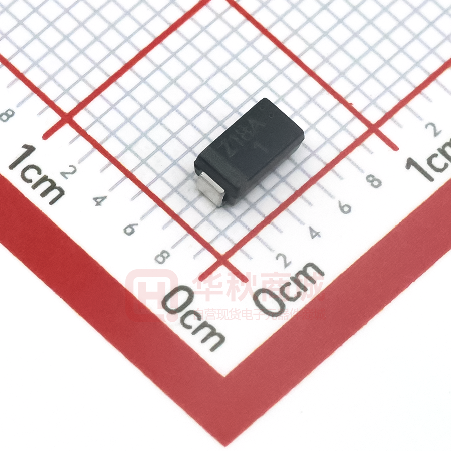

SZA***A Series
GLASS PASSIVATED JUNCTION Zener voltage regulator diodes
1.0 Watt Steady State
Feature
* 1W SMA
* Zener voltage regulator diodes
* Plastic package has Underwriters Laboratory
Flammability Classification 94V-0
* We declare that the material of product
compliance with RoHS requirements.
* Guarding for over voltage protection
* High temperature soldering guaranteed:
260°C/10 seconds at terminals
Mechanical Data
Case: JEDEC DO-214AC molded plastic
Terminals: Axial leads, solderable per
MIL-STD-202, Method 208
Polarity: Color band denoted cathode except Bipolar
Mounting Position: Any
Weight: 0.0023 ounce, 0.065 gram
compliance with ROHS requirements
