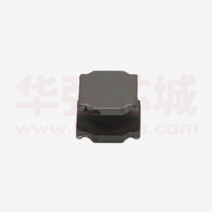

CSM1-10 Low Cost High IP3 Mixer for Cellular Applications Features • • • • • • LO & RF 10 TO 1500 MHz IF 1 TO 500 MHz LO DRIVE +10 dBm (NOMINAL) SURFACE MOUNT HIGH INTERCEPT +19dBm (TYP.) +260°C REFLOW COMPATIBLE Rev. V3 Product Image Description The CSM1-10 is a double balanced mixer, designed for use in the high volume wireless applications. The design utilizes Schottky ring quad diodes and broadband baluns to attain excellent performance. Ordering Information Part Number CSM1-10 Package Surface Mount Electrical Specifications: Z0 = 50Ω Lo = +10 dBm (Downconverter application only) Typical Parameter Test Conditions Units +25ºC SSB Conversion Loss(max) SSB Noise Figure L - R Isolation (min) L - I Isolation (min) R - I Isolation (min) 1 dB Conversion Comp Input IP3 R-Port VSWR L-Port VSWR I-Port VSWR 1 ADVANCED: Data Sheets contain information regarding a product M/A-COM Technology Solutions • North America Tel: 800.366.2266 • Europe Tel: +353.21.244.6400 is considering for development. Performance is based on target specifications, simulated results, • India Tel: +91.80.4155721 • China Tel: +86.21.2407.1588 and/or prototype measurements. Commitment to develop is not guaranteed. Visit www.macomtech.com for additional data sheets and product information. PRELIMINARY: Data Sheets contain information regarding a product M/A-COM Technology Solutions has under development. Performance is based on engineering tests. Specifications are typical. Mechanical outline has been fixed. Engineering samples and/or test data may be available. M/A-COM Technology Solutions Inc. and its affiliates reserve the right to make Commitment to produce in volume is not guaranteed. changes to the product(s) or information contained herein without notice. Guaranteed -40º to +85ºC 7.5 8.5 fR = 10 to 1000 MHz, fL = 10 to 1000 MHz, fI = 1 to 500 MHz fR = 1000 to 1500 MHz, fL = 1000 to 1500 MHz, fI = 1 to 500 MHz dB dB dB 6.5 7.5 7.0 8.0 Within 1 dB of conversion loss 40 30 27 +6 +19 1.50:1 1.75:1 1.50:1 35 25 33 23 fL = 10 to 1500 MHz fL = 10 to 1500 MHz fR = 10 to 1500 MHz fL = +10 dBm fL = 10 to 1500 MHz, fI = 1 to 500 MHz, fR = 10 to 1500 MHz fR = 10 to 1500 MHz fL = 10 to 1500 MHz fI = 10 to 500 MHz dB dB dB dBm dBm CSM1-10 Low Cost High IP3 Mixer for Cellular Applications Typical Performance Curves Rev. V3 2 ADVANCED: Data Sheets contain information regarding a product M/A-COM Technology Solutions • North America Tel: 800.366.2266 • Europe Tel: +353.21.244.6400 is considering for development. Performance is based on target specifications, simulated results, • India Tel: +91.80.4155721 • China Tel: +86.21.2407.1588 and/or prototype measurements. Commitment to develop is not guaranteed. Visit www.macomtech.com for additional data sheets and product information. PRELIMINARY: Data Sheets contain information regarding a product M/A-COM Technology Solutions has under development. Performance is based on engineering tests. Specifications are typical. Mechanical outline has been fixed. Engineering samples and/or test data may be available. M/A-COM Technology Solutions Inc. and its affiliates reserve the right to make Commitment to produce in volume is not guaranteed. changes to the product(s) or information contained herein without notice. CSM1-10 Low Cost High IP3 Mixer for Cellular Applications Outline Drawing: Surface Mount * Rev. V3 Weight: 2 grams (0.07 oz.) max ∗ Dimensions are inches (millimeters) ±0.015 (0.38) unless otherwise specified. Absolute Maximum Ratings Parameter Operating Temperature Storage Temperature Peak Input Power Peak Input Current Absolute Maximum -54ºC to +85ºC -65ºC to +100ºC +20 dBm max @ -25ºC +17 dBm max @ +85ºC 50 mA DC 3 ADVANCED: Data Sheets contain information regarding a product M/A-COM Technology Solutions • North America Tel: 800.366.2266 • Europe Tel: +353.21.244.6400 is considering for development. Performance is based on target specifications, simulated results, • India Tel: +91.80.4155721 • China Tel: +86.21.2407.1588 and/or prototype measurements. Commitment to develop is not guaranteed. Visit www.macomtech.com for additional data sheets and product information. PRELIMINARY: Data Sheets contain information regarding a product M/A-COM Technology Solutions has under development. Performance is based on engineering tests. Specifications are typical. Mechanical outline has been fixed. Engineering samples and/or test data may be available. M/A-COM Technology Solutions Inc. and its affiliates reserve the right to make Commitment to produce in volume is not guaranteed. changes to the product(s) or information contained herein without notice.
