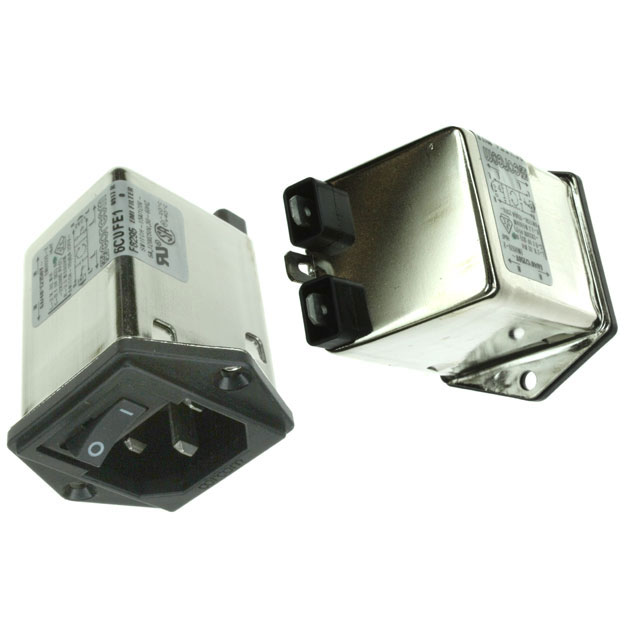

Corcom Product Guide Compact 1U Height Switched Power Entry Module Catalog: 1654001 Issue Date: 06.2011 CU Series UL Recognized CSA Certified VDE Approved* 6CUFS1 15CUE1 CU Series • Designed for popular 1U (1 ¾”) height rack mounted equipment • Two function power entry module combining a SPST switch and an IEC 60320-1 inlet • Snap–in, flange and flush mounting • Reduce OEM wiring time with optional pre–connected line and switch terminals Specifications Maximum leakage current each Line to Ground: Filtered Unfiltered @ 120 VAC 60 Hz: @250 VAC 50 Hz: Hipot rating (one minute): Line to Ground: Line to Line: Operating Voltage: Operating Frequency: Rated Current: Switch: Terminal Push–on Force: .25 mA .40 mA 2 A 5 A 2250 VDC 1450 VDC 120/250 VAC 50/60 Hz 1 to 15A* 50A inrush capable SPST 15 lb. / 67N (max.) Ordering Information 15 CU 10 B S 1 Output Styles 1 – .187 [4.8] spade terminals Mounting Styles E – Flange Mount (Horizontal) F – Flush Mount (Filtered only) S – Snap–in Filter Type or Terminal Option F – General purpose B – No filter, includes pre–connected terminals Omit if none Side Snap–in Option Non-filtered versions only Available Part Numbers 1CUFE1 3CUFE1 6CUFE1 10CUFE1 15CUFE1 Filtered Versions 1CUFF1 3CUFF1 6CUFF1 10CUFF1 15CUFF1 Non–filtered Versions 1CUFS1 3CUFS1 6CUFS1 10CUFS1 15CUFS1 Standard Terminals Pre-connected Terminals 10 – Side snaps 1.0mm max. panel 15 – Side snaps 1.5mm max. panel Omit for none or standard configuration CU Series Current Rating 1, 3, 6, 10 or 15A 134 15CUE1 15CUS1 15CU10S1 15CU15S1 15CUBE1 15CUBS1 15CU10BS1 15CU15BS1 *15A versions are tested by Underwriters Laboratories to US and Canadian requirements and are VDE approved at 10A, 250VAC Dimensions are in inches and millimeters unless otherwise specified. Values in italics are metric equivalents. Dimensions are shown for reference purposes only. Specifications subject to change. For email, phone or live chat, please go to te.com/help corcom.com Corcom Product Guide Compact 1U Height Switched Power Entry Module Catalog: 1654001 Issue Date: 06.2011 (continued) CU Series Electrical Schematic LINE LOAD CUFS1 C Case Styles CUFE1 A      B     C CUE1 F A             3 Power Inlet Filters & Power Entry Modules C F A B B CUFF1 C            CUS1 F A B C A             B         135 Dimensions are in inches and millimeters unless otherwise specified. Values in italics are metric equivalents. Dimensions are shown for reference purposes only. Specifications subject to change. For email, phone or live chat, please go to te.com/help corcom.com Corcom Product Guide Compact 1U Height Switched Power Entry Module Catalog: 1654001 Issue Date: 06.2011 (continued) CU Series Case Styles (continued) CU10S1 & CU15S1 Case Dimensions Part No. CUFE1 A  B  C  C CUFF1 CUFS1 A B          CUBE1 Pre-Connected Terminals CUE1, CUBE1 CUS1, CUBS1 10CUS1, 10CUBS1 15CUS1, 15CUBS1                                             D                 E                 F           Recommended Panel Cutout F R. Max D CUBS1 Pre-Connected Terminals E                  CU10BS1 & CU15BS1 Pre-Connected Terminals   Accessories GA400: NEMA 5-15P to IEC 60320-1 C-13 line cord 136 Dimensions are in inches and millimeters unless otherwise specified. Values in italics are metric equivalents. Dimensions are shown for reference purposes only. Specifications subject to change. For email, phone or live chat, please go to te.com/help corcom.com Corcom Product Guide Compact 1U Height Switched Power Entry Module Catalog: 1654001 Issue Date: 06.2011 (continued) CU Series Performance Data Typical Insertion Loss Measured in closed 50 Ohm system 1CUF db 100 90 80 70 60 50 40 30 20 10 0 0.01 0.1 1 10 30 Frequency in MHz 3CUF db 100 90 80 70 60 50 40 30 20 10 0 0.01 0.1 1 10 30 Frequency in MHz 6CUF db 100 90 80 70 60 50 40 30 20 10 0 0.01 0.1 1 10 30 Frequency in MHz 10CUF db 100 90 80 70 60 50 40 30 20 10 0 0.01 0.1 1 10 30 Frequency in MHz 15CUF db 100 90 80 70 60 50 40 30 20 10 0 0.01 0.1 1 10 30 Frequency in MHz 3 Common Mode / Asymmetrical (L-G) Differential Mode / Symmetrical (L-L) Power Inlet Filters & Power Entry Modules Minimum Insertion Loss Measured in closed 50 Ohm system Common Mode / Asymmetrical (Line to Ground)                                                      Differential Mode / Symmetrical (Line to Line)                                                      137 Dimensions are in inches and millimeters unless otherwise specified. Values in italics are metric equivalents. Dimensions are shown for reference purposes only. Specifications subject to change. For email, phone or live chat, please go to te.com/help corcom.com
