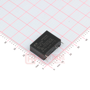

    PCJ-112D3M - Miniature PCB Relay - Tyco Electronics
PCJ-112D3M 数据手册
General Purpose Relays Miniature PCB Relay PCJ I I I I I I 1 pole 3 / 5 A, 1 NO contact Sensitive coil 200 mW 8 mm creepage / clearance Version for 105°C WG version: Product in accordance to IEC60335-1 RoHS compliant (Directive 2002/95/EC) as per product date code 0424 Applications Domestic appliances F0276-A Approvals V REG.-Nr.of122301 ÜG Urequest E58304 Technical data approved types on Contact data Contact configuration Contact set Type of interruption Rated current Rated voltage / max.switching voltage AC Maximum breaking capacity AC Contact material Mechanical endurance Rated frequency of operation with / without load 1 NO single contact micro disconnection 3A 5 A (WG-version) 250/400 VAC 750 VA 1250 VA AgNi 6 10x10 cycles 30 / 300 min-1 Contact ratings Type Load AgNi 3 A, 250 VAC, 90°C AgNi 5 A, 250 VAC, 85°C, EN61810-1 AgNi 3 A, 250 VAC, 105°C, EN61810-1 AgNi 2 A, 250 VAC, cosϕ=0.6, 85°C, WG-version, EN61810-1 AgNi 5 A (1.5 A), 250 VAC, 85°C, WG-version, EN60730 Cycles 1x105 1x105 1x105 1x105 1x105 Coil data Rated coil voltage range DC coil Coil power DC coil Operative range Coil insulation system according UL1446 3...24 VDC typ. 200 mW 2 A F Coil versions, DC-coil Coil Rated Operate Release Coil Rated coil code voltage voltage voltage resistance power VDC VDC VDC Ohm mW 03 3 2.25 0.15 45+10% 200 05 5 3.75 0.25 125+10% 200 06 6 4.5 0.3 180+10% 200 09 9 6.75 0.45 405+10% 200 12 12 9 0.6 720+10% 200 24 24 18 1.2 2880+10% 200 All figures are given for coil without preenergization, at ambient temperature +23°C Other coil voltages on request 1 Datasheet Rev. FC1 Issued 2006/03 www.tycoelectronics.com www.schrackrelays.com Dimensions are in mm unless otherwise specified and are shown for reference purposes only. Product specification according to IEC 61810-1. Product data, technical parameters, test conditions and processing information only to be used together with the 'Definitions' at schrackrelays.com in the ‘Schrack’ section. Specifications subject to change. General Purpose Relays Miniature PCB Relay PCJ (Continued) Insulation Dielectric strength coil-contact circuit open contact circuit Clearance / creepage coil-contact circuit Material group of insulation parts Insulation to IEC 60664-1 Type of insulation coil-contact circuit open contact circuit Rated insulation voltage Pollution degree Rated voltage system Overvoltage category 4000 Vrms 750 Vrms W 8 / 8 mm W IIIa reinforced functional 250 V 3 230/400 V III PCB layout / terminal assignment Bottom view on solder pins S=511-AA Other data RoHS - Directive 2002/95/EC compliant as per product date code 0424 Flammability class according to UL94 V-0 For WG version: GWFI to IEC 60695-2-12 850°C (WG version) GWT to IEC 60695-2-13 750°C (WG version) Ambient temperature range -40...+90 (105) °C Operate- / release time 10 / 4 ms Vibration resistance (function) NO / NC contact >10 g Shock resistance (function) NO / NC contact >10 g Shock resistance (destruction) >100 g Category of protection RTII - flux proof / RTIII - wash tight Resistance to soldering heat flux-proof version 270°C / 10 s wash-tight version 260°C / 5 s Relay weight 4g Packaging unit 100 pcs S0511-AB Dimensions S0512-B Product key PCJ-1 D 3 M - Type Version 1 single contact Coil Coil code: please refer to coil versions table Coil power D standard 200 mW Contact material 3 AgNi Contact configuration M 1 NO contact Enclosure Blank flux proof H wash tight Version Blank standard version, 3 A, class A WG Product in accordance with IEC 60335-1 (domestic appliances), 5 A version only, flux proof, class F Other types on request Product key PCJ-105D3M PCJ-109D3M PCJ-112D3M PCJ-124D3M PCJ-105D3MH PCJ-109D3MH PCJ-112D3MH PCJ-124D3MH PCJ-105D3M-WG PCJ-109D3M-WG PCJ-112D3M-WG PCJ-124D3M-WG Version flux proof Contacts 1 NO contact 3A Contact material AgNi Class A wash tight flux proof 1 NO contact 5A AgNi Class F WG version Coil 5 VDC 9 VDC 12 VDC 24 VDC 5 VDC 9 VDC 12 VDC 24 VDC 5 VDC 9 VDC 12 VDC 24 VDC Part number 0-1721081-2 0-1721081-4 0-1721081-5 0-1721081-7 0-1721081-9 1-1721081-1 1-1721081-2 1-1721081-4 0-1721547-2 0-1721547-4 0-1721547-5 0-1721547-7 2 Datasheet Rev. FC1 Issued 2006/03 www.tycoelectronics.com www.schrackrelays.com Dimensions are in mm unless otherwise specified and are shown for reference purposes only. Product specification according to IEC 61810-1. Product data, technical parameters, test conditions and processing information only to be used together with the 'Definitions' at schrackrelays.com in the ‘Schrack’ section. Specifications subject to change.
