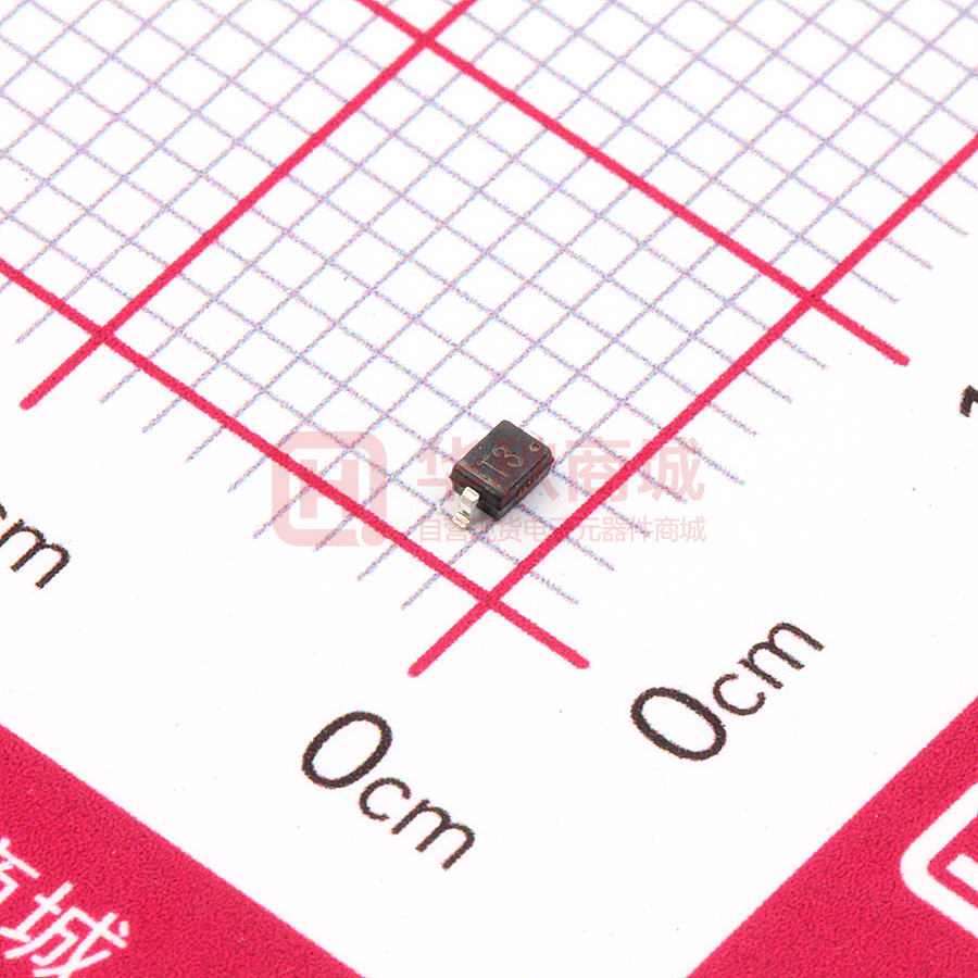

    开关二极管(小信号)VR=200V IR=100nA Io=200mA SOD323
BAV21WS-TP 数据手册
BAV19WS,BAV20WS,BAV21WS Features • • • • • • • Silicon Epitaxial Planar Diodes For General Purpose This Diode is Also Available in Other Case Halogen Free Available Upon Request By Adding Suffix "-HF" Moisture Sensitivity Level 1 Epoxy Meets UL 94 V-0 Flammability Rating Lead Free Finish/RoHS Compliant ("P" Suffix Designates RoHS Compliant. See Ordering Information) 250mW Small Signal Diodes 120 to 250 Volts Maximum Ratings • • • Operating Junction Temperature Range: -65°C to +150°C Storage Temperature Range: -65°C to +150°C Thermal Resistance:500°C/W Junction to Ambient MCC Part Number Device Marking Maximum Recurrent Peak Reverse Voltage SOD-323 Maximum Continuous RMS Reverse Voltage Voltage BAV19WS A8 120V 71V 100V BAV20WS T2 200V 106V 150V BAV21WS T3 250V 141V 200V A B C E Cathode Mark H Peak Forward Current IFM 400mA Note1 Average Rectified Output Current Io 200mA Note1 Peak Forward Surge Current IFSM 2.5A 0.5A Repetitive Peak Forward Curren IFRM 625mA f>50Hz, Ta=25°C(1) Power Dissipation Ptot 250mW Ta=25°C(1) D J G t=1µs t=1s DIM A B C D E G H J DIMENSIONS INCHES MM MIN MAX MIN MAX 0.090 0.107 2.30 2.70 0.063 0.071 1.60 1.80 0.045 0.053 1.15 1.35 0.031 0.045 0.80 1.15 0.010 0.016 0.25 0.40 0.004 0.018 0.10 0.45 0.004 0.010 0.10 0.25 ----- 0.006 ----- 0.15 NOTE Notes: 1. Valid Provided that Terminals are Kept at Ambient Temperature Suggested Solder Pad Layout 1.88mm 0.69mm 0.56mm Rev.3-2-02242020 1/4 MCCSEMI.COM BAV19WS,BAV20WS,BAV21WS Electrical Characteristics @ 25°C (Unless Otherwise Specified) Parameter Symbol Forward Voltage VF Dynamic Forward Resistance rf IF=10mA IR VR=100V VR=150V VR=200V VR=100V, TJ=100°C VR=150V, TJ=100°C VR=200V, TJ=100°C Junction Capacitance CJ VR = 0V, f = 1MHz Reverse Recovery Time trr IF=IR=30mA, Irr=0.1*IR,RL=100Ω Reverse Current BAV19WS BAV20WS BAV21WS BAV19WS BAV20WS BAV21WS Conditions Min. Typ. Max. Units IF=100mA 1 V IF=200mA 1.25 V 5 Ω 100 100 100 15 15 15 1.5 nA nA nA μA μA μA pF 50 ns * Pulse Test: Pulse Width 300 μsec, Duty Cycle 2% Rev.3-2-02242020 2/4 MCCSEMI.COM BAV19WS,BAV20WS,BAV21WS Curve Characteristics Fig. 2 - Typical Reverse Leakage Characteristics Fig. 1 - Typical Instantaneous Forward Characteristics 1000 100 Instantaneous Reverse Leakage Current (nA) Instantaneous Forward Current (mA) 1000 TA=100°C TA=25°C 10 1 0.2 0.4 0.6 0.8 1.0 1.2 TA=100°C 100 1 1.4 TA=25°C 10 0 Instantaneous Forward Voltage (V) 20 Fig. 3 - Power Derating Curve 80 100 Fig. 4 - Current Derating Curve 0.25 Average Forward Current (A) 250 Power Dissipation (mW) 60 Percent of Rated Peak Reverse Voltage (%) 300 200 150 100 50 0 40 0 25 50 75 100 125 150 0.20 0.15 0.10 0.05 0.00 0 25 50 75 100 125 150 Ambient Temperature (°C) Ambient Temperature (°C) Fig. 5 - Capacitance Characteristics Capacitance Between Terminals (pF) 4 TA=25°C f=1MHz 3 2 1 0 0 5 10 15 20 25 30 Reverse Voltage (V) Rev.3-2-02242020 3/4 MCCSEMI.COM BAV19WS,BAV20WS,BAV21WS Ordering Information Device Packing Part Number-TP Tape&Reel: 3Kpcs/Reel Note : Adding "-HF" Suffix For Halogen Free, eg. Part Number-TP-HF ***IMPORTANT NOTICE*** Micro Commercial Components Corp. reserves the right to make changes without further notice to any product herein to make corrections, modifications , enhancements , improvements , or other changes . Micro Commercial Components Corp . does not assume any liability arising out of the application or use of any product described herein; neither does it convey any license under its patent rights ,nor the rights of others . The user of products in such applications shall assume all risks of such use and will agree to hold Micro Commercial Components Corp . and all the companies whose products are represented on our website, harmless against all damages. ***LIFE SUPPORT*** MCC's products are not authorized for use as critical components in life support devices or systems without the express written approval of Micro Commercial Components Corporation. ***CUSTOMER AWARENESS*** Counterfeiting of semiconductor parts is a growing problem in the industry. Micro Commercial Components (MCC) is taking strong measures to protect ourselves and our customers from the proliferation of counterfeit parts. MCC strongly encourages customers to purchase MCC parts either directly from MCC or from Authorized MCC Distributors who are listed by country on our web page cited below. Products customers buy either from MCC directly or from Authorized MCC Distributors are genuine parts, have full traceability, meet MCC's quality standards for handling and storage. MCC will not provide any warranty coverage or other assistance for parts bought from Unauthorized Sources. MCC is committed to combat this global problem and encourage our customers to do their part in stopping this practice by buying direct or from authorized distributors. Rev.3-2-02242020 4/4 MCCSEMI.COM
