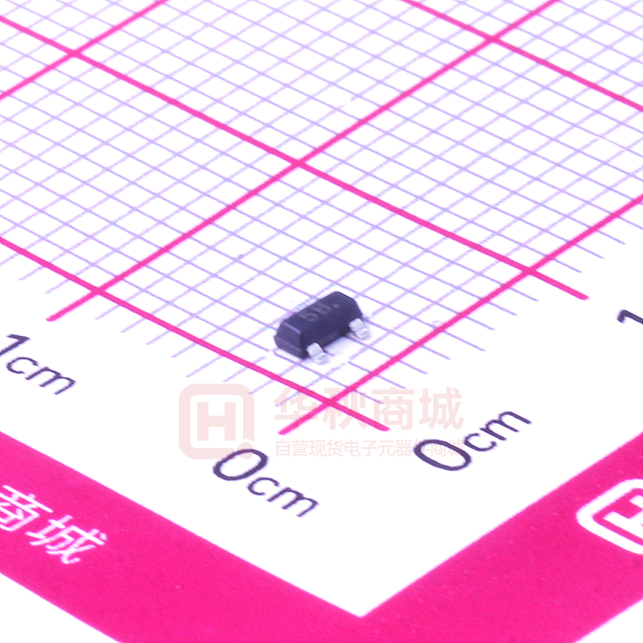

    通用三极管 PNP Ic=500mA Vceo=45V hfe=250~600 P=300mW SOT23
BC807-40-TP 数据手册
BC807-16 THRU BC807-40 Features • • • Halogen free available upon request by adding suffix "-HF" Moisture Sensitivity Level 1 Epoxy Meets UL 94 V-0 Flammability Rating • Lead Free Finish/RoHS Compliant ("P" Suffix Designates RoHS Compliant. See Ordering Information) PNP Small Signal Transistor 300mW Maximum Ratings • • • SOT-23 Operating Junction Temperature Range: -55℃ to +150℃ Storage Temperature Range: -55℃ to +150℃ Thermal Resistance: 403℃/W Junction to Ambient Parameter Collector-Base Voltage Collector-Emitter Voltage Emitter-Base Voltage Collector Current Peak Collector Current Collector Power Dissipation Rating -50 -45 -5 -500 -1000 Unit V V V mA mA PC 300 mW C E D Symbol VCBO VCEO VEBO IC ICM Internal Structure B A Marking: BC807-16: 5A BC807-25: 5B BC807-40: 5C C F B E H G J L K DIMENSIONS INCHES MM DIM MIN MAX MIN MAX A 0.110 0.120 2.80 3.04 B 0.083 0.104 2.10 2.64 C 0.047 0.055 1.20 1.40 0.034 0.041 0.85 1.05 D E 0.067 0.083 1.70 2.10 F 0.018 0.024 0.45 0.60 G 0.0004 0.006 0.01 0.15 H 0.035 0.043 0.90 1.10 J 0.003 0.007 0.08 0.18 K 0.014 0.020 0.35 0.51 L 0.007 0.020 0.20 0.50 NOTE Suggested Solder Pad Layout 0.031 0.800 0.035 0.900 0.079 2.000 0.037 0.950 Rev.3-1-01012019 1/4 inches mm 0.037 0.950 MCCSEMI.COM BC807-16 THRU BC807-40 Electrical Characteristics @ 25°C Unless Otherwise Specified Parameter Collector-Base Breakdown Voltage Symbol V(BR)CBO Min -50 Typ Max Units Conditions IC=-10µA, IE=0 V Collector-Emitter Breakdown Voltage V(BR)CEO -45 V IC=-10mA, IB=0 Emitter-Base Breakdown Voltage V(BR)EBO -5 V IE=-1µA, IC=0 Collector Cutoff Current ICBO -0.1 μA VCB=-45V, IE=0 Collector Cutoff Current ICEO -0.2 μA VCB=-40V, IE=0 Emitter-Base Cutoff Current IEBO -0.1 μA VEB=-4V, IC=0 DC Current Gain hFE1 100 hFE2 40 VCE=-1V, IC=-100mA 600 VCE=-1V, IC=-500mA Collector-Emitter Saturation Voltage VCE(sat) -0.7 V IC=-500mA, IB=-50mA Base-Emitter Saturation Voltage VBE(sat) -1.2 V IC=-500mA, IB=-50mA fT Transition Frequency MHz VCE=-5V, IC=-10mA, f=100MHz 100 CLASSIFICATION OF hFE (1) Rank Range Rev.3-1-01012019 BC807-16 BC807-25 100-250 160-400 2/4 BC807-40 250-600 MCCSEMI.COM BC807-16 THRU BC807-40 Curve Characteristics Fig. 1 - Static Characteristics Fig. 2 - DC Current Gain Characteristics 500 -1mA COMMON EMITTER TA=25°C -0.9mA -240 -0.8mA -200 -0.7mA -0.6mA -160 -0.5mA -120 -0.4mA -0.3mA -80 -0.2mA -40 400 300 TA=25°C 200 100 IB= -0.1mA 0 -2 0 -6 -4 -8 -10 -12 -14 0 -16 -10 -1 Fig. 3 - Collector-Emitter Saturation Voltage Characteristics -400 β=10 -300 -200 TA=100°C -100 TA=25°C 0 -0.1 -1 -100 -10 -1.2 β=10 -1.0 TA=25°C -0.8 -0.6 TA=100°C -0.4 -0.2 -0.1 -500 -100 -500 Fig. 6 - Power Derating Curve 400 Power Dissipation (mW) Common Emitter VCE=-1V -100 TA=100°C -10 TA=25°C -1 300 200 100 0 -0.4 -0.5 -0.6 -0.7 -0.8 -0.9 0 -1.0 25 50 75 100 125 150 Ambient Temperature (°C) Base-Emitter Voltage (V) Rev.3-1-01012019 -10 -1 Collector Current (mA) Fig. 5 - Base-Emitter Voltage Characteristics -0.1 -0.3 -500 Fig. 4 - Base-Emitter Saturation Voltage Characteristics Collector Current (mA) -1000 -100 Collector Current (mA) Base-Emitter Saturation Voltage (V) Collector-Emitter Saturation Voltage (mV) Collector-Emitter Voltage (V) Collcetor Current (mA) Common Emitter VCE=-1V TA=100°C DC Current Gain Collector Current (mA) -280 3/4 MCCSEMI.COM BC807-16 THRU BC807-40 Ordering Information Device Packing Part Number-TP Tape&Reel: 3Kpcs/Reel Note : Adding "-HF" Suffix For Halogen Free, eg. Part Number-TP-HF ***IMPORTANT NOTICE*** Micro Commercial Components Corp. reserves the right to make changes without further notice to any product herein to make corrections, modifications , enhancements , improvements , or other changes . Micro Commercial Components Corp . does not assume any liability arising out of the application or use of any product described herein; neither does it convey any license under its patent rights ,nor the rights of others . The user of products in such applications shall assume all risks of such use and will agree to hold Micro Commercial Components Corp . and all the companies whose products are represented on our website, harmless against all damages. ***LIFE SUPPORT*** MCC's products are not authorized for use as critical components in life support devices or systems without the express written approval of Micro Commercial Components Corporation. ***CUSTOMER AWARENESS*** Counterfeiting of semiconductor parts is a growing problem in the industry. Micro Commercial Components (MCC) is taking strong measures to protect ourselves and our customers from the proliferation of counterfeit parts. MCC strongly encourages customers to purchase MCC parts either directly from MCC or from Authorized MCC Distributors who are listed by country on our web page cited below. Products customers buy either from MCC directly or from Authorized MCC Distributors are genuine parts, have full traceability, meet MCC's quality standards for handling and storage. MCC will not provide any warranty coverage or other assistance for parts bought from Unauthorized Sources. MCC is committed to combat this global problem and encourage our customers to do their part in stopping this practice by buying direct or from authorized distributors. Rev.3-1-01012019 4/4 MCCSEMI.COM
