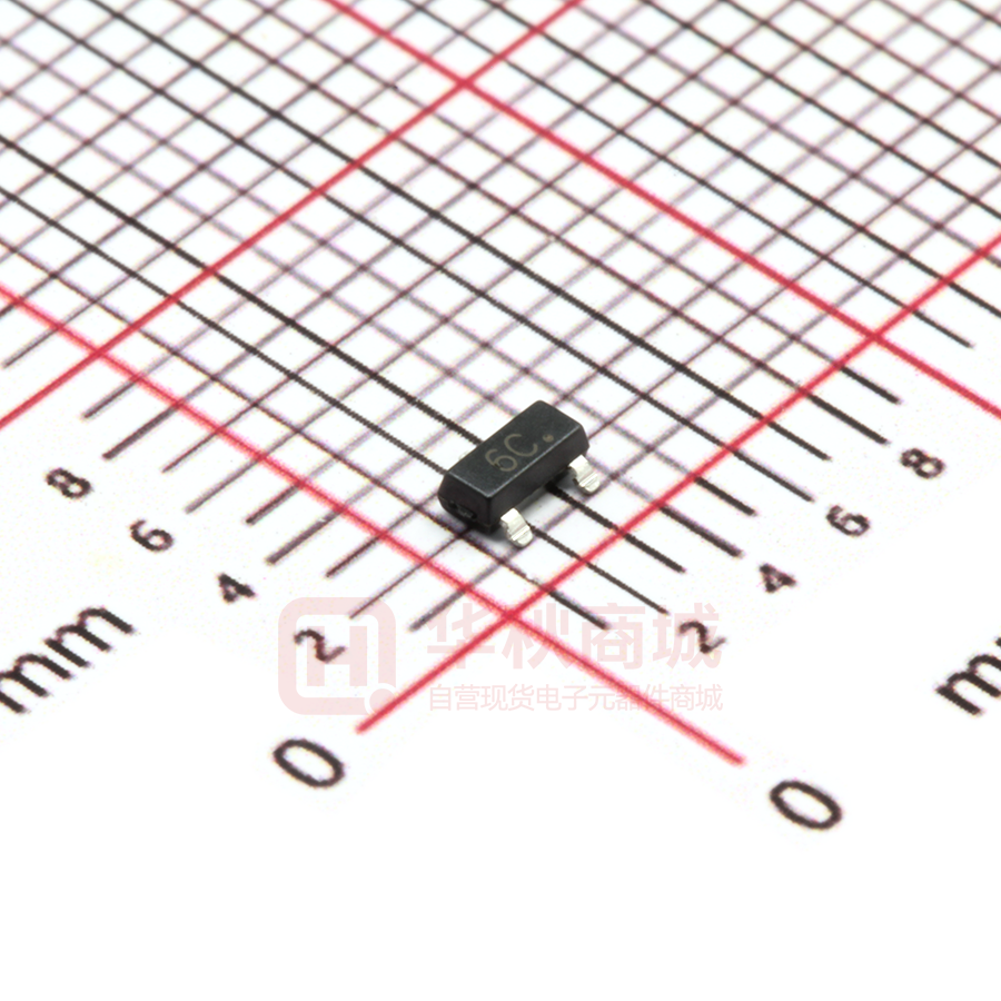

    NPN小信号晶体管 VCEO=45V VEBO=5V IC=500mA SOT23
BC817-40-TP 数据手册
MCC TM Micro Commercial Components BC817-16 THRU BC817-40   omponents 20736 Marilla Street Chatsworth    !"# $ %    !"# Features • • • • • • • • NPN Small Halogen free available upon request by adding suffix "-HF" Lead Free Finish/RoHS Compliant ("P" Suffix designates RoHS Compliant. See ordering information) Epoxy meets UL 94 V-0 flammability rating Moisure Sensitivity Level 1 Ideally Suited for Automatic Insertion 150 C Junction Temperature For Switching and AF Amplifier Applications Epitaxial Planar Die Construction Signal Transistor 310mW SOT-23 Mechanical Data • Case: SOT-23, Molded Plastic • Terminals: Solderable per MIL-STD-202, Method 208 • Polarity: See Diagram • Weight: 0.008 grams ( approx.) • Marking: A D C BC817-16 C B 6A BC817-25 6B BC817-40 6C E B F E H G Maximum Ratings @ 25oC Unless Otherwise Specified J K Charateristic Symbol Value VCEO 45 Collector-Emitter Voltage Emitter-Base Voltage Collector Current Peak Collector Current Peak Emitter Current o Power Dissipation@T s=50 C(Note1) Operating & Storage Temperature Unit VEBO 5 V I C 500 mA ICM 1000 mA IEM 1000 mA Pd 300 mW Tj, TSTG -55~150 DIMENSIONS V DIM A B C D E F G H J K INCHES MIN MAX .110 .120 .083 .104 .047 .055 .035 .041 .070 .081 .018 .024 .0005 .0039 .035 .044 .003 .007 .015 .020 MM MIN 2.80 2.10 1.20 .89 1.78 .45 .013 .89 .085 .37 MAX 3.04 2.64 1.40 1.03 2.05 .60 .100 1.12 .180 .51 NOTE Suggested Solder Pad Layout o C .031 .800 Note: 1. Device mounted on Ceramic Substrate 0.7mm X 2.5cm2 area .035 .900 .079 2.000 inches mm .037 .950 .037 .950 www.mccsemi.com Revision: C 1 of 4 2013/06/04 MCC BC817-16 thru BC817-40 TM Micro Commercial Components Electrical Characteristics @25°C unless otherwise specified Parameter Symbol Test conditions Min Typ Max Unit Collector-base breakdown voltage VCBO IC= 10μA, IE=0 50 V Collector-emitter breakdown voltage VCEO IC= 10mA, IB=0 45 V Emitter-base breakdown voltage VEBO IE= 1μA, IC=0 5 V Collector cut-off current ICBO VCB= 45 V , IE=0 0.1 μA Emitter cut-off current IEBO VEB= 4V, IC=0 0.1 μA hFE(1) VCE= 1V, IC= 100mA 100 hFE(2) VCE= 1V, IC= 500mA 40 DC current gain 600 Collector-emitter saturation voltage VCE(sat) IC= 500mA, IB= 50mA 0.7 V Base-emitter saturation voltage VBE(sat) IC= 500mA, IB= 50mA 1.2 V 1.2 V Base-emitter voltage VBE VCE= 1 V, IC= 500mA Collecter capactiance Cob VCB=10V ,f=1MHz Transition frequency fT VCE= 5 V, IC= 10mA f=100MHz 10 pF 100 MHz CLASSIFICATION OF hFE (1) Rank BC817-16 BC817-25 BC817-40 Range 100-250 160-400 250-600 400 Pd, POWER DISSIPATION (mW) See Note 1 300 200 100 0 0 100 50 150 TJA , Junction to Ambient Air (°C) 200 ° www.mccsemi.com Revision: C 2 of 4 2013/06/04 MCC BC817-16 thru BC817-40 Micro Commercial Components www.mccsemi.com Revision: C 3 of 4 2013/06/04 TM MCC TM Micro Commercial Components Ordering Information : Device Packing Tape&Reel;3Kpcs/Reel Part Number-TP Note : Adding "-HF" suffix for halogen free, eg. Part Number-TP-HF ***IMPORTANT NOTICE*** Micro Commercial Components Corp. reserves the right to make changes without further notice to any product herein to make corrections, modifications , enhancements , improvements , or other changes . Micro Commercial Components Corp . does not assume any liability arising out of the application or use of any product described herein; neither does it convey any license under its patent rights ,nor the rights of others . The user of products in such applications shall assume all risks of such use and will agree to hold Micro Commercial Components Corp . and all the companies whose products are represented on our website, harmless against all damages. ***LIFE SUPPORT*** MCC's products are not authorized for use as critical components in life support devices or systems without the express written approval of Micro Commercial Components Corporation. ***CUSTOMER AWARENESS*** Counterfeiting of semiconductor parts is a growing problem in the industry. Micro Commercial Components (MCC) is taking strong measures to protect ourselves and our customers from the proliferation of counterfeit parts. MCC strongly encourages customers to purchase MCC parts either directly from MCC or from Authorized MCC Distributors who are listed by country on our web page cited below. Products customers buy either from MCC directly or from Authorized MCC Distributors are genuine parts, have full traceability, meet MCC's quality standards for handling and storage. MCC will not provide any warranty coverage or other assistance for parts bought from Unauthorized Sources. MCC is committed to combat this global problem and encourage our customers to do their part in stopping this practice by buying direct or from authorized distributors. www.mccsemi.com Revision: C 4 of 4 2013/06/04 3
