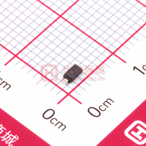

MCC Features l l l l   omponents 21201 Itasca Street Chatsworth    !"# $ %    !"# BZT52C2V4 THRU BZT52C39 410 mW Zener Diodes 2.4 to 39 Volts Planar Die construction 410mW Power Dissipation Zener Voltages from 2.4V - 39V Ideally Suited for Automated Assembly Processes Mechanical Data l l l l l Case: SOD-123 Molded Plastic SOD123 A B C E Terminals: Solderable per MIL-STD-202, Method 208 Approx. Weight: 0.008 gram Mounting Position: Any Storage & Operating Junction Temperature: -55 C to +150 C o o Maximum Ratings @ 25oC Unless Otherwise Specified Zener Current IF 1 00 mA Maximum Forward VF 1.2 V Voltage Power Dissipation P(AV) 410 mWatt (No te s A) Peak Forward S urge IFSM 2 .0 Amps Current (Not e s B) NOTES: A. Mounted on 5.0mm2(.013mm thick) land areas. B. Measured on 8.3ms, single half sine-wave or equivalent square wave, duty cycle = 4 pulses per minute maximum. H D J G DIM A B C D E G H J DIMENSIONS INCHES MM MIN MAX MIN MAX .140 .152 3.55 3.85 .100 .112 2.55 2.85 .055 .071 1.40 1.80 - ---.053 ----1.35 .012 .031 0.30 .78 .006 ----0.15 ----- ---.01 ----.25 - ---.006 ----.15 NOTE SUGGESTED SOLDER PAD LAYOUT 0.093" 0.048” 0.036” www.mccsemi.com MCC BZT52C2V4 thru BZT52C39 Electrical Characteristics @ 25oC Unless Otherwise Specified MCC PART NUMBER NORMAL ZENER VOLTAGE Vz@ Izt TEST CURRENT Izt MAXIMUM ZENER IMPEDANCE ‘B’ SUFFIX ONLY Zzt @ Izt Zzk @ Izk=1.0mA MAXIMUM REVERSE LEAKAGE CURRENT Ir @ Vr Max. Zener Current Izm @ TA Marking VOLTS mA OHMS OHMS nA VOLTS mA BZT52C2V4 BZT52C2V7 BZT52C3 BZT52C3V3 BZT52C3V6 BZT52C3V9 BZT52C4V3 BZT52C4V7 BZT52C5V1 BZT52C5V6 BZT52C6V2 BZT52C6V8 BZT52C7V5 BZT52C8V2 BZT52C9V1 BZT52C10 BZT52C11 BZT52C12 BZT52C13 BZT52C15 BZT52C16 BZT52C18 BZT52C20 BZT52C22 BZT52C24 BZT52C27 BZT52C30 BZT52C33 BZT52C36 BZT52C39 W1 W2 W3 W4 W5 W6 W7 W8 W9 WA WB WC WD WE WF WG WH WI WK WL WM WN WO WP WR WS WT WU WW WX 2.4 2.7 3.0 3.3 3.6 3.9 4.3 4.7 5.1 5.6 6.2 6.8 7.5 8.2 9.1 10 11 12 13 15 16 18 20 22 24 27 30 33 36 39 5 5 5 5 5 5 5 5 5 5 5 5 5 5 5 5 5 5 5 5 5 5 5 5 5 5 5 5 5 5 85 83 95 95 95 95 95 78 60 40 10 8.0 7.0 7.0 10 15 20 20 25 30 40 50 50 55 80 80 80 80 90 90 600 500 500 500 500 500 500 500 480 400 200 150 50 50 50 70 70 90 110 110 170 170 220 220 220 250 250 250 250 300 100000 75000 50000 25000 15000 10000 5000 5000 100 100 100 100 100 100 100 100 100 100 100 100 100 100 100 100 100 100 100 100 100 100 1.0 1.0 1.0 1.0 1.0 1.0 1.0 1.0 0.8 1.0 2.0 3.0 5.0 6.0 7.0 7.5 8.5 9.0 10 11 12 14 15 17 18 20 22.5 25 27 29 134 118 109 100 92 84 76 67 59 54 49 44 40 36 33 30 28 25 23 20 18 17 16 13 12 10 9 9 8 NOTE: 1.Tolerance and Type Number Designation. The type numbers listed have a standard tolerance on the nominal zener voltage of ±5%. 2. Specials Available Include: A. Nominal zener voltages between the voltages shown and tighter voltage tolerances. B. Matched sets. 3. Zener Voltage (VZ) Measurement. Guarantees the zener voltage when measured at 90 seconds while maintaining the lead temperature (TL) at 30OC, from the diode body. 4. Zener Impedance (ZZ) Derivation. The zener impedance is derived from the 60 cycle ac voltage, which results when an AC current having an rms value equal to 10% of the dc zener current (IZT or IZK) is superimposed on IZT or IZK. 5. Surge Current (IR) Non-Repetitive. The rating listed in the electrical characteristics table is maximum peak, non-repetitive, reverse surge current of 1/2 square wave or equivalent sine wave pulse of 1/120 second duration superimposed on the test current, IZT, per JEDEC registration; however, actual device capability is as described in Figure 5. www.mccsemi.com BZT52C2V4 thru BZT52C39 MCC 100 8 7 TEMPERATURE COEFFICIENT,mV / oC) 6 5 4 3 2 1 0 -1 -2 -3 2 3 4 5 6 7 8 9 10 11 12 TEMPERATURE COEFFICIENT,mV / oC) 10 1 10 100 NOMINAL ZENER VOLTAGE, Volts NOMINAL ZENER VOLTAGE, Volts TYPICAL REVERSE CURRENT STEADY STATE POWER DERATING 1000 DYNAMIC IMPEDANCE, W IZ = 1 mA FORWARD CURRENT, mA TJ=25 C IZ(AC)=0.1IZ(DC) F=1 kHZ O 1000 100 5 mA 20 mA 100 10 10 150OC 75 C O 25OC 5OC 1 1 10 NORMAL ZENER VOLTAGE, Volts 100 1 0.4 0.5 0.6 0.7 0.8 0.9 1.0 1.1 1.2 FORWARD VOLTAGE, Volts EFFECT OF ZENER VOLTAGE ON ZENER IMPEDANCE TYPICAL FORWARD VOLTAGE 1000 1.2 1.0 0.8 0.6 0.4 0.2 0 CAPACITANCE, pF 0 V BIAS 1 V BIAS 100 BIAS AT 50% OF VZ NOM 10 TA=25oC POWER DISSIPATION, Watts PD V.S. TA 1 25 50 75 100 125 150 155 1 10 100 TEMPERATURE (oC) NOMINAL ZENER VOLTAGE, Volts STEADY STATE POWER DERATING TYPICAL CAPACITANCE www.mccsemi.com BZT52C2V4 thru BZT52C39 MCC 100 TA=25oC 100 TA=25 C o ZENER CURRENT, mA ZENER CURRENT, mA 10 10 1 1 0.1 0.1 0.01 0 2 4 6 8 10 12 0.01 10 30 50 70 90 ZENER VOLTAGE, Volts ZENER VOLTAGE, Volts ZENER VOLTAGE V.S. ZENER CURRENT ZENER VOLTAGE V.S. ZENER CURRENT 1000 LEAKAGE CURRENT (mA) 100 10 1 0.1 0.01 0.001 0.0001 0.00001 0 10 20 30 40 50 60 70 +150 C O +25OC -55OC 80 90 NOMINAL ZENER VOLTAGE, Vlots TYPICAL LEAKGE CURRENT www.mccsemi.com
BZT52C15
### 物料型号 - BZT52C2V4至BZT52C39
### 器件简介 - 这些是410mW Zener Diodes,电压范围从2.4V至39V,封装为SOD123。 - 器件采用平面芯片结构,适合自动化装配流程。
### 引脚分配 - 器件为SOD-123塑封封装,引脚可焊性符合MIL-STD-202标准方法208。
### 参数特性 - 存储和工作结温范围:-55°C至+150°C。 - 最大额定值@25°C,除非另有说明。 - Zener电流(IF):100mA - 最大正向电压(VF):1.2V - 功率耗散(P(AV)):410mW - 峰值正向浪涌电流(IFSM):2.0A
### 功能详解 - 这些Zener二极管具有不同的Zener电压等级,适用于需要稳定电压的应用。
### 应用信息 - 适用于自动装配流程,具体应用包括电压稳定和信号参考。
### 封装信息 - 封装类型:SOD-123塑封。 - 尺寸数据以英寸和毫米为单位提供,包括最小值和最大值。
