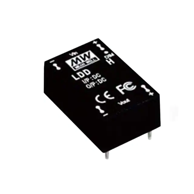

DC-DC Constant Current LED driver Features : LDD-H Constant current output: 300mA to 1000mA series Wide input voltage: 9 ~ 56VDC Wide output LED string voltage: 2 ~ 52VDC High efficiency up to 97% DC/DC step-down converter Built-in EMI filter, comply with EN55015 and FCC part15 without additional input filter and capacitors Built-in PWM and remote ON/OFF control Protections: Short circuit / Over temperature Cooling by free air convection Fully encapsulated with IP67 level Compact size Low cost, high reliability Suitable for driving illumination LED 3 years warranty SPECIFICATION ORDER NO. CURRENT RANGE VOLTAGE RANGE OUTPUT CURRENT ACCURACY (Typ.) LDD-300H 300mA 2 ~ 52VDC 3% at 24VDC input ; 4% at 48VDC input 150mVp-p 150mVp-p 200mVp-p 200mVp-p 350mVp-p LDD-350H 350mA LDD-500H 500mA LDD-600H 600mA LDD-700H 700mA LDD-1000H 1000mA RIPPLE & NOISE(max.) Note.2 150mVp-p 40KHz ~ 1000KHz SWITCHING FREQENCY EXTERNAL CAPACITANCE LOAD (max.) 2.2uF INPUT 9 ~ 56VDC VOLTAGE RANGE 97% at full load and 36VDC/48VDC input EFFICIENCY (max.) 320mA Full load Note.3 270mA DC CURRENT 10mA No load FILTER Capacitor Leave open if not use 450mA 550mA 650mA 900mA PWM REMOTE ON/OFF DIMMING & PWM FREQUENCY ON/OFF CONTROL QUIESCENT INPUT CURRENT IN SHUTDOWN MODE(max.) SHORT CIRCUIT PROTECTION OVER TEMPERATURE WORKING TEMP. WORKING HUMIDITY STORAGE TEMP., HUMIDITY ENVIRONMENT TEMP. COEFFICIENT VIBRATION Power ON with dimming: DIM ~ -Vin >2.5 ~ 6VDC or open circuit Power OFF : DIM ~ -Vin < 0.8VDC or short 100 ~ 1KHz 1mA at PWM dimming OFF and 24VDC input Regulated at rated output current Protection type: Can be continued, recovers automatically after fault condition is removed Tj 150 typically(IC1) detect on main control IC Protection type : Shut down, recovers automatically after temperature goes down -40 ~ + 85 (Refer to derating curve) 20% ~ 90% RH non-condensing -55 ~ +125 , 10 ~ 95% RH 0.03% / 10 ~ 500Hz, 2G 10min./1 cycle, period for 60min. each along X, Y, Z axes OPERATING CASE TEMP. (max.) 100 EMC EMS IMMUNITY MTBF DIMENSION OTHERS WEIGHT POTTING MATERIAL EMI CONDUCTION & RADIATION Compliance to EN55015, FCC part 15 class B Compliance to EN61000-4-2,3,4,6,8, light industry level, criteria A 2000Khrs min. MIL-HDBK-217F (25 ) 31.8*20.3*12.2mm or 1.25"*0.8"*0.48" inch (L*W*H) 18g Expoxy(UL94-V0) Mechanical Specification 20.3 (0.80) Pin Configuration Unit: mm (inch) Pin No. 1,2 11,12 31.8 (1.25) Derating Curve 2.06 (0.08) Output -Vin -Vout +Vout Comment Don't connect to -Vout LED - Connection LED + Connection 13,14 22 LOAD (%) 24 23 22 BOTTOM VI EW 1 2 100 75 71 50 25 for 600~1000mA 85 for 300~500mA SIDE 3.81 (0.15) 2.5 4 (0.10) VI EW ON/OFF and PWM Dimming PWM DIM (Leave open if not used) +Vin DC Supply 14 13 11 12 23,24 -40 0 25 50 71 85 100 15.24 (0.60) 12.2 (0.48) Ta ( ) NOTE 1.All parameters are specified at normal input(48VDC), rated load, 25 70% RH ambient. 2.Ripple & noise are measured at 20MHz by using a 12" twisted pair terminated with a 0.1uf capacitor. 3.Test condition: 48VDC input. File Name:LDD-H-SPEC 2011-06-02 DC-DC Constant Current LED driver PWM Dimming Control H ON ON ON LDD-H series Standard Application +Vin +Vout 1st LED PWM Signal L OFF OFF 100~1KHz OFF PWM Max H L Dimming LDD-H Last LED Output Current 0 During PWM dimming operation, the output current will change to PWM style. 100 Tol : 3%(Typ.) 75 I out (% ) -Vin H: >2.5~6VDC or open circuit L:

### 物料型号 - 型号系列:LDD-H系列
### 器件简介 - 该器件是一个DC-DC恒流LED驱动器,具有以下特点: - 恒流输出:300mA至1000mA - 宽输入电压:9~56VDC - 宽输出LED串电压:2~52VDC - 高效率,高达97% - 内置EMI滤波器,符合EN55015和FCC第15部分,无需额外输入滤波器和电容器 - 内置PWM和远程开关控制 - 保护功能:短路/过温保护 - 通过自然对流冷却 - 全面封装,IP67等级 - 紧凑尺寸,低成本,高可靠性 - 适合潜水照明 - 提供3年保修
### 引脚分配 - 引脚1、2:-Vin(不要连接到-Vout) - 引脚11、12:-Vout(LED连接) - 引脚13、14:+Vout(LED+连接) - 引脚22:PWM DIM(开关和PWM调光,如果不使用则留空) - 引脚23、24:+Vin(直流供电)
### 参数特性 - 输出电流范围:300mA、350mA、600mA、700mA、1000mA - 电压范围:2~52VDC,±3%在24VDC输入,±4%在48VDC输入 - 电流精度(典型值) - 纹波和噪声(最大值):150mVp-p至350mVp-p - 开关频率:150mVp-p,40KHz至1000KHz - 外部电容负载(最大值):2.2uF - 输入电压范围:9-56VDC - 效率(最大值):97%在全负载和36VDC/48VDC输入 - PWM调光和开关控制:如果未使用则留空 - 远程开关电源开启时调光:DIM --Vin >2.5 - 6VDC或开路 - PWM频率:100-1KHz - 待机模式下输入电流(最大值):PWM调光关闭时1mA在24VDC输入 - 保护:短路保护和过温保护
### 功能详解 - 该驱动器支持PWM调光和远程开关控制,具有短路和过温保护功能,能够在不同的输入电压和LED串电压下工作,提供稳定的恒流输出。
### 应用信息 - 适用于需要恒流驱动LED的应用,如潜水照明等。
### 封装信息 - 尺寸:31.820.312.2mm或1.250.80.48英寸(长宽高) - 重量:18g - 灌封材料:环氧树脂(UL94-V0)
