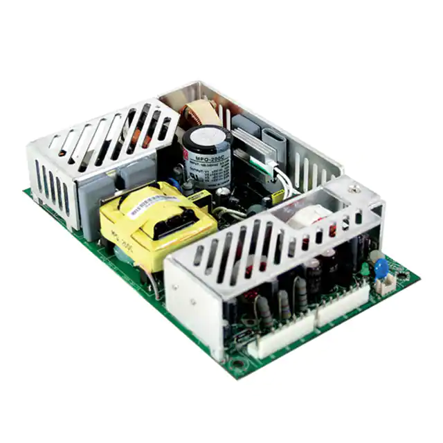

1~4 Output Medical Type 200W Medical Features series Universal AC input / Full range Low leakage current 0.95/230VAC PF>0.98/115VAC at full load WORKING TEMP. Whole series can operate from -20~70 . Please refer to the derating curves. WORKING HUMIDITY 20~90% RH non-condensing. STORAGE TEMP., HUMIDITY -40~+85 , 10~90% RH TEMP. COEFFICIENT 0.04%/ on all outputs at full load between 0~50 of ambient temperature. AC INPUT CURRENT (Typ.) Maximum input current 3.5A at 115VAC, 60Hz or 1.6A at 230VAC, 60Hz with 100% output load. INRUSH CURRENT (Typ.) Inrush current is less than 25A at 115VAC or less than 40A at 230VAC under cold start conditions. Limiting provided by internal thermistors. SETUP, RISE TIME 1000ms, 20ms / 230VAC at full load 3000ms, 20ms / 115VAC at full load HOLD-UP TIME (Typ.) 16ms / 230VAC at full load 16ms / 115VAC at full load LEAKAGE CURRENT Leakage current is less than 180 A at 264VAC for earth leakage current Leakage current is less than 100 A at 264VAC for patient leakage current DC OUTPUT ADJ. RANGE DC output voltage (or CH1 of multiple output models) can be adjusted between -5%~+10% rated output voltage by potential meter. OVERLOAD PROTECTION Fully protected against short circuit and output overload. The hiccup type protection will be activated at 120~160% rated load and recovers automatically after fault condition is removed. OVER VOLTAGE PROTECTION Provided on output channel 1 only at 115%~135% rated output voltage. Output will be shut down when this protection is activated. OVER TEMPERATURE PROTECTION When the temperature of TSW1 which detect on heat sink of power transistor reaches 95 This protection is activated. Then output will be shut down and recovers automatically after temperature goes down. POWER GOOD / FAIL SIGNAL TTL logic high for power good and TTL low for power fail. When the output voltage reaches 90% of rated value, a +5V TTL signal will be sent out with a 10~500ms delay; At least 1ms before the output voltage goes below 90% of the rated value, the TTL signal will be turned off. * MPS-200-3.3 does not have this function. REMOTE CONTROL RC+/RC-:0 ~ 0.8V=power on; 4 ~ 10V=power off sink current100M Ohms for I/P-O/P, I/P-FG, O/P-FG by using 500VDC test voltage. EMI COMPLIANCE EMI Specifications Conducted & Radiation Harmonic distortion Voltage flicker EMS COMPLIANCE EMS Specification ESD air ESD contact RF field susceptibility EFT(Electrical Fast Transient)/Burst Lightning/Surge Conducted RF susceptibility Magnetic field immunity Voltage dip, interruption Digital phone carrier immunity MTBF 262,100 hours min. at full load and 25 calculated per MIL-HDBK-217F. DIMENSION (L*W*H) 177.8x107.2x35.5mm or 7"x4.22"x1.4" PACKING 0.66Kg; 24pcs/16.8Kg/1.04CUFT File Name:200W MEDICAL-SPEC 2008-03-25 Compliance Level EN55011, Class B EN55022, Class B EN61000-3-2 EN61000-3-3 Compliance Level EN61000-4-2, Level 3, 8KV EN61000-4-2, Level 2, 4KV EN61000-4-3, Level 2, 3V/m Level 3, 10V/m EN61000-4-4, Level 2, 1KV/5KHz Level 3, 2KV/5KHz EN61000-4-5, Level 4, 2KV/Line-Line 4KV/Line-Earth EN61000-4-6, Level 2, 3Vrms/m Level 3, 10Vrms/m EN61000-4-8, Level 2, 3A/m Level 3, 10A/m EN61000-4-11,Compliance ENV50204, Level 2, 3V/m, 900MHz Level 3, 10A/m, 900MHz of ambient temperature, 1 ~4 Output Medical Type Output Chart MODEL MPS-200-3.3 MPS-200-5 MPS-200-12 MPS-200-15 MPS-200-24 MPS-200-48 MPD-200A OUTPUT VOLTAGE 3.3V 5V 12V 15V 24V 48V 5V 12V MPD-200B 5V 24V MPT-200A 5V 12V -5V MPT-200B 5V 12V -12V MPT-200C 5V 15V -15V MPT-200D 5V 24V 12V MPQ-200B 5V 12V -5V -12V MPQ-200C 5V 15V -5V -15V MPQ-200D 5V 24V 12V -12V MPQ-200F 5V 24V 15V -15V Notes : 200W Medical WITH FAN (25CFM) 40A 40A 16.7A 13.4A 8.4A 4.2A 20A 8A 20A 4A 20A 7.5A 2A 20A 6A 2A 20A 4.7A 2A 20A 3A 2A 15A 7A 2A 2A 15A 5A 2A 2A 15A 3A 2A 2A 15A 2.7A 2A 2A RIPPLE & NOISE VOLTAGE PEAK LOAD (Max.) TOLERANCE WITH 25CFM FAN (Note 2) (Note 3) 48A 48A 20A 16A 10A 5A 24A 9.6A 24A 4.8A 24A 9A 2.4A 24A 7.2A 2.4A 24A 5.6A 2.4A 24A 3.6A 2.4A 18A 8.4A 2.4A 2.4A 18A 6A 2.4A 2.4A 18A 3.6A 2.4A 2.4A 18A 3.3A 2.4A 2.4A 80mVp-p 80mVp-p 100mVp-p 100mVp-p 150mVp-p 200mVp-p 80mVp-p 120mVp-p 80mVp-p 180mVp-p 80mVp-p 120mVp-p 80mVp-p 80mVp-p 120mVp-p 80mVp-p 80mVp-p 150mVp-p 80mVp-p 80mVp-p 180mVp-p 80mVp-p 80mVp-p 120mVp-p 80mVp-p 80mVp-p 80mVp-p 150mVp-p 80mVp-p 80mVp-p 80mVp-p 180mVp-p 80mVp-p 80mVp-p 80mVp-p 180mVp-p 80mVp-p 80mVp-p 2.0% 2.0% 2.0% 2.0% 1.0% 1.0% 2.0% +8,-5% 2.0% 6.5% 2.0% 8.0% 5.0% 2.0% 8.0% 5.0% 2.0% 8.0% 5.0% 2.0% 8.0% 5.0% 2.0% 8.0% 5.0% 5.0% 2.0% 6.0% 5.0% 5.0% 2.0% 8.0% 5.0% 5.0% 2.0% 8.0% 5.0% 5.0% series RATED CURRENT 40A 40A 16.7A 13.4A 8.4A 4.2A 20A 8A 20A 4A 20A 7.5A 2A 20A 6A 2A 20A 4.7A 2A 20A 3A 2A 15A 7A 2A 2A 15A 5A 2A 2A 15A 3A 2A 2A 15A 2.7A 2A 2A OUTPUT CURRENT MINIMUM LOAD 0A 0A 0A 0A 0A 0A 4A 0.8A 4A 0.4A 4A 0.8A 0A 4A 0.6A 0A 4A 0.5A 0A 4A 0.3A 0A 3A 0.7A 0A 0A 3A 0.5A 0A 0A 3A 0.3A 0A 0A 3A 0.3A 0A 0A CONVECTION (max.) 28A 28A 11.7A 9.4A 5.9A 3A 15A 5.4A 15A 2.7A 15A 5A 1A 15A 4.4A 1A 15A 3.3A 1A 15A 2.2A 1A 12A 5.3A 1A 1A 12A 4A 1A 1A 12A 2.3A 1A 1A 12A 2.1A 1A 1A LINE LOAD EFFICIENCY REGULATION REGULATION (typ.) 0.5% 0.5% 0.5% 0.5% 0.5% 0.5% 0.5% 1.0% 0.5% 1.0% 0.5% 1.0% 0.5% 0.5% 1.0% 0.5% 0.5% 1.0% 0.5% 0.5% 1.0% 0.5% 0.5% 1.0% 0.5% 0.5% 0.5% 1.0% 0.5% 0.5% 0.5% 1.0% 0.5% 0.5% 0.5% 1.0% 0.5% 0.5% 1.0% 1.0% 1.0% 1.0% 1.0% 1.0% 1.0% 4.0% 1.0% +4,-6% 1.0% 5.0% 1.0% 1.0% 5.0% 1.0% 1.0% 5.0% 1.0% 1.0% 5.0% 1.0% 1.0% 5.0% 1.0% 1.0% 1.0% 5.0% 1.0% 1.0% 1.0% 5.0% 1.0% 1.0% 1.0% 5.0% 1.0% 1.0% 81% 79% 78% 78% 81% 80% 80% 80% 77% 81% 84% 85% 86% 87% 82% (Note 4) 83% 1. All parameters NOT specially mentioned are measured at 230VAC input, rated load and 25 of ambient temperature. 2. Ripple & noise are measured at 20MHz of bandwidth by using a 12" twisted pair-wire terminated with a 0.1 f & 47 f parallel capacitor. 3. Tolerance : includes set up tolerance, line regulation and load regulation. 4. 33% Duty cycle maximum within every 30 seconds. Average output power should not exceed the rated power. 5. The power supply is considered a component which will be installed into a final equipment. The final equipment must be re-confirmed that it still meets EMC directives. 6. Derating may be needed under low input voltages. Please check the derating curve for more details. File Name:200W MEDICAL-SPEC 2008-03-25 1~4 Output Medical Type Mechanical Specification(MPS-200) 177.8[7"] 200W Medical series Unit:mm 6.1[0.24"] 165.1[6.5"] 6.35[0.25"] SVR1 LED 1 2 3 4 5 6 CN4 CN1 3 2 1 FG 10 9 8 7 6 5 4 3 2 1 20 19 18 17 16 15 14 13 12 11 107.2[4.22"] 95.25[3.75"] CN2 25CFM min. FAN 4- 3.96[0.156"] 15cm 3[0.118"] max. 35.5[1.4"] AC Input Connector (CN1) : JST B3P-VH or equivalent Pin No. 1 2 3 Assignment AC/N No Pin AC/L Mating Housing JST VHR or equivalent Terminal JST SVH-21T-P1.1 or equivalent DC Output Connector (CN4) : TKP DH2I-2*3 or equivalent Pin No. 1 2 3 4 5 6 Assignment PG RSGND RC+ RS+ RCMating Housing Terminal TKP DH2-2*3 or equivalent TKP DHT or equivalent DC Output Connector (CN2) : MOLEX 5566-20 or equivalent Pin No. 1~5,11~15 6~10,16~20 Assignment DC OUTPUT -V DC OUTPUT +V Mating Housing MOLEX 5557 or equivalent Terminal MOLEX 5556 or equivalent Derating Curve (MPS-200) 100 Static Characteristics (MPS-200) 100 25CFM forced air cooling 80 90 80 60 Convection cooling 70 LOAD (%) 40 LOAD(%) 0 10 20 30 40 50 60 70 (HORIZONTAL) 60 50 40 20 -20 90 100 115 140 160 180 200 220 240 264 AMBIENT TEMPERATURE ( ) INPUT VOLTAGE (V) 60Hz File Name:200W MEDICAL-SPEC 2008-03-25 1~4 Output Medical Type Mechanical Specification(MPD/T/Q-200) 177.8[7"] 200W Medical series 6.1[0.24"] 165.1[6.5"] 6.35[0.25"] SVR1 LED 1 2 3 4 5 6 CN4 1 107.2[4.22"] 95.25[3.75"] CN2 CN1 3 2 1 FG CN3 16 25CFM min. FAN 4- 3.96[0.156"] 15cm 3[0.118"] max. 35.5[1.4"] AC Input Connector (CN1) : JST B3P-VH or equivalent Pin No. 1 2 3 Assignment AC/N No Pin AC/L Mating Housing JST VHR or equivalent Terminal JST SVH-21T-P1.1 or equivalent D C Output Connector (CN4) : TKP DH2I-2*3 or equivalent Pin No. 1 2 3 4 5 6 Assignment PG RSGND RC+ RS+ RCMating Housing Terminal TKP DH2-2*3 or equivalent TKP DHT or equivalent DC Output Connector (CN2,3) : JST B8P-VH*2 or equivalent Pin No. 1,2,3,4 5~11 12,13 14 15 16 Assignment V1 COM V2 V3 No pin V4 Mating Housing Terminal JST VHR or equivalent JST SVH-21T-P1.1 or equivalent Derating Curve (MPD/T/Q-200) 100 Static Characteristics (MPD,T,Q-200) 100 25CFM forced air cooling 80 MPD-200 MPT/Q-200 90 80 60 Convection cooling MPD-200 MPT/Q-200 70 LOAD (%) 40 LOAD(%) 40 50 60 70 (HORIZONTAL) 60 50 40 20 -20 0 10 20 30 90 100 115 140 160 180 200 220 240 264 AMBIENT TEMPERATURE ( ) INPUT VOLTAGE (V) 60Hz File Name:200W MEDICAL-SPEC 2008-03-25
