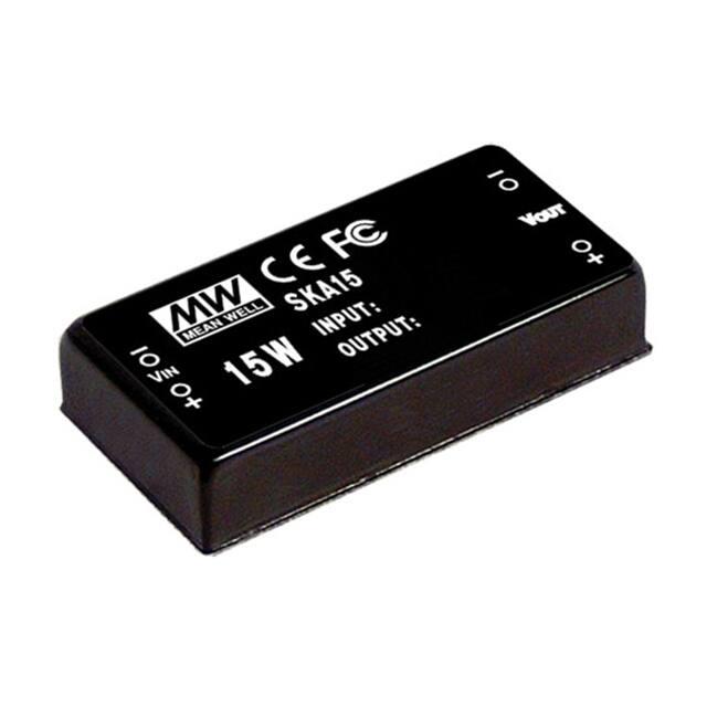

SKA15A-15
SKA15A-15
    MEANWELL(明纬)
    DIP5 模块
    隔离模块 直流转换器 1 输出 15V 1A 9V - 18V 输入
SKA15A-15 数据手册
9.9~15W DC-DC Regulated Single Output Converter Features : 2:1 wide input range 4:1 wide input range(option) 1000VDC I/O isolation 3000VDC I/O isolation(option) Built-in EMI filter SKA15 series Protections: Short circuit / Overload Cooling by free air convection Six-sided shield metal case 100% burn-in test Low cost / High reliability Approvals: FCC / CE 2 years warranty SPECIFICATION ORDER NO. DC VOLTAGE CURRENT RANGE RATED POWER OUTPUT LINE REGULATION LOAD REGULATION VOLTAGE ACCURACY SWITCHING FREQUENCY VOLTAGE RANGE EFFICIENCY (Typ.) INPUT DC CURRENT FILTER PROTECTION OVER CURRENT PROTECTION (Note. 5) Note.3 Note.4 SKA15A- SKA15B- SKA15C- SKA15A- SKA15B- SKA15C- SKA15A- SKA15B- SKA15C- SKA15A- SKA15B- SKA15C12 033 033 033 05 05 05 12 12 15 15 15 3.3V 5V 12V 15V 300 ~ 3000mA 9.9W 0.2% 0.5% 2.0% 150KHz min. A: 9 ~ 18VDC B: 18 ~ 36VDC C: 36 ~ 72VDC 78% 76% 76% 78% 76% Full load No load A: 1700mA B: 800mA A: 20mA B: 30mA C: 400mA C: 15mA 80% 82% 80% 82% 82% 80% 82% 300 ~ 3000mA 15W 50mVp-p 60mVp-p 60mVp-p 125 ~ 1250mA 100 ~ 1000mA RIPPLE & NOISE (max.) Note.2 50mVp-p Pi network Fuse recommended 110% ~ 250% rated output power Protection type : Hiccup mode, recovers automatically after fault condition is removed All output equipped with short circuit Protection type : Hiccup mode, recovers automatically after fault condition is removed SHORT CIRCUIT WORKING TEMP. WORKING HUMIDITY -25 ~ +71 (Refer to output load derating curve) 20% ~ 90% RH non-condensing STORAGE TEMP., HUMIDITY -25 ~ +105 , 10 ~ 95% RH ENVIRONMENT 0.03% / (0 ~ 50 ) TEMP. COEFFICIENT 10 ~ 500Hz, 2G 10min./1cycle, period for 60min. each along X, Y, Z axes VIBRATION I/P-O/P:1KVDC WITHSTAND VOLTAGE I/P-O/P: 100M Ohms / 500VDC / 25 / 70% RH SAFETY & ISOLATION RESISTANCE EMC EMI CONDUCTION & RADIATION Compliance to EN55022 Class B, FCC part 15 Class B Compliance to EN61000-4-2,3,4,5,6,8, light industry level, criteria A EMS IMMUNITY OTHERS MTBF DIMENSION WEIGHT 300Khrs min. MIL-HDBK-217F(25 32g ) 50.8*25.4*11.27 mm or 2"*1"*0.44" inch (L*W*H) Mechanical Specification Unit:mm(inch) 50.8 15.3 20.3 3 4 5 15.2 2.5 Pin Configuration Derating Curve 11.27 Pin No. 1 2 3 4 5 Output 100 25.4 1 2 2.5 BOTTOM VIEW 1.0 + 0.2/-0.1 5.8 + Vi n - Vi n + Vo u t No Pin - Vo u t 10.2 5.1 10.1 LOAD (%) 10.2 10.2 80 -25 0 25 50 60 71 100 Ta ( NOTE 1.All parameters are specified at normal input, rated load, 25 70% RH Ambient. 2.Ripple & noise are measured at 20MHz by using a 12" twisted pair terminated with a 0.1uf & 47uf capacitor. 3.Line regulation is measured from low line to high line at rated load. 4.Load regulation is measured from 10% to 100% rated load. 5.Please prevent the converter from operating in overload or short circuit condition for more than 30 seconds. ) File Name:SKA15-SPEC 2008-05-20
