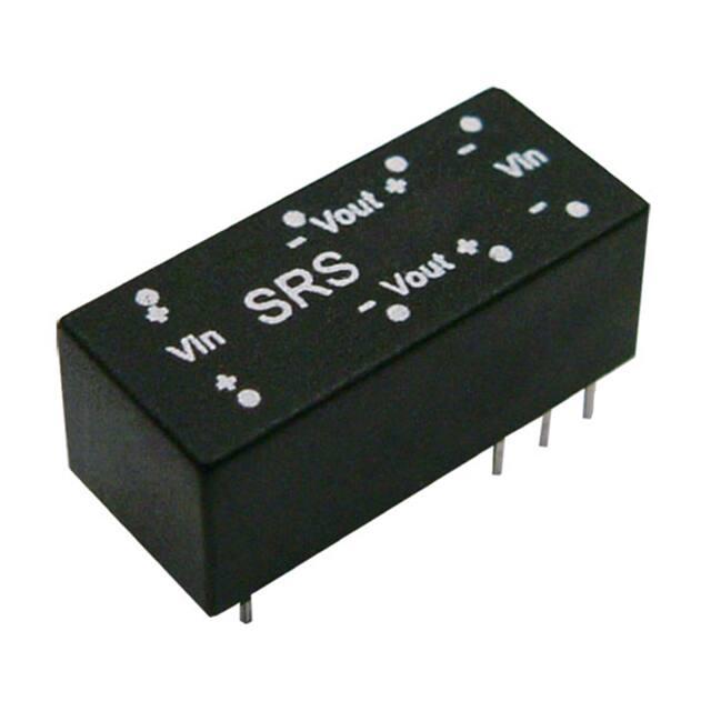

SRS-1205 数据手册
0.5W DC-DC Regulated Single Output Converter Features : 1000VDC I/O isolation Internal SMD technology Built-in EMI filter Cooling by free air convection Non-conductive plastic case Dual in line package SIP packge is available 100% burn-in test Low cost / High reliability 2 years warranty SRS series SELECTION GUIDE ORDER NO. DC VOLTAGE OUTPUT CURRENT RANGE EFFICIENCY (TYP.) ORDER NO. DC VOLTAGE OUTPUT CURRENT RANGE EFFICIENCY (TYP.) SRS-0505 5V 0 ~ 100mA 60% SRS-0512 12V 0 ~ 42mA 60% 0.5W SRS-1212 SRS-2412 SRS-4812 SRS-1205 SRS-2405 SRS-4805 SRS-0509 9V 0 ~ 56mA 60% SRS-0515 15V 0 ~ 34mA 60% SRS-1215 SRS-2415 SRS-4815 SRS-1209 SRS-2409 SRS-4809 SPECIFICATION RATED POWER RIPPLE & NOISE (max.) Note.2 100mVp-p 1.0% LINE REGULATION LOAD REGULATION VOLTAGE ACCURACY SWITCHING FREQUENCY VOLTAGE RANGE NORMAL VOLTAGE INPUT INPUT CURRENT FILTER PROTECTION OVERLOAD PROTECTION (Note. 4) Note.3 OUTPUT 1.0% 2.0%(Typ.) 50KHz min. 4.5 ~ 5.5V 5V 10.8 ~ 13.2V 12V 72mA 15mA 21.6 ~ 26.4V 24V 36mA 9mA 43.2 ~ 52.8V 48V 19mA 5mA 4.5 ~ 5.5V 5V 175mA 37mA 10.8 ~ 13.2V 12V 72mA 15mA 21.6 ~ 26.4V 24V 36mA 9mA 43.2 ~ 52.8V 48V 19mA 5mA 3.0%(max.) Full load 175mA No load 37mA Capacitor type Fuse recommended 150 ~ 350% rated output power Protection type : Hiccup mode, recovers automatically after fault condition is removed All output equipped with short circuit Protection type : Hiccup mode, recovers automatically after fault condition is removed -25 ~ +71 (Refer to output load derating curve) 20% ~ 90% RH non-condensing SHORT CIRCUIT WORKING TEMP. WORKING HUMIDITY ENVIRONMENT STORAGE TEMP., HUMIDITY -25 ~ +105 , 10 ~ 95% RH 0.03% / (0 ~ 50 ) TEMP. COEFFICIENT VIBRATION 10 ~ 500Hz, 2G 10min./1 cycle, period for 60min. each along X, Y, Z axes I/P-O/P:1KVDC WITHSTAND VOLTAGE SAFETY & ISOLATION RESISTANCE I/P-O/P: 100M Ohms / 500VDC / 25 / 70% RH EMC 80pF max. ISOLATION CAPACITANCE 600khrs min. MIL-HDBK-217F(25 ) MTBF OTHERS DIMENSION 22.6*9.9*8.4mm or 0.89"*0.39"*0.33" inch (L*W*H) 3.1g WEIGHT Mechanical Specification Unit: mm (inch) Pin Configuration Pin No. 1 & 16 22.6 (0.89) Derating Curve 9.9 (0.39) 0.5 (0.02) 16 1 3.81 (0.15) Output LOAD (%) 12.7 (0.50) +Vin -Vout +Vout -Vin 100 80 BOTTOM VIEW 6 & 11 7 & 10 8&9 11 10 9 6 7 8 2.54 (0.10) 7.62 (0.30) 8.4 (0.33) -25 0 25 50 60 71 100 Ta ( ) NOTE 1.All parameters are specified at normal input, rated load, 25 70% RH ambient. 2.Ripple & noise are measured at 20MHz by using a 12" twisted pair terminated with a 0.1uf & 47uf capacitor. 3.Load regulation is measured from 10% to 100% rated load. 4.Please prevent the converter from operating in overload or short circuit condition for more than 30 seconds. File Name: SRS-SPEC 2010-06-28
