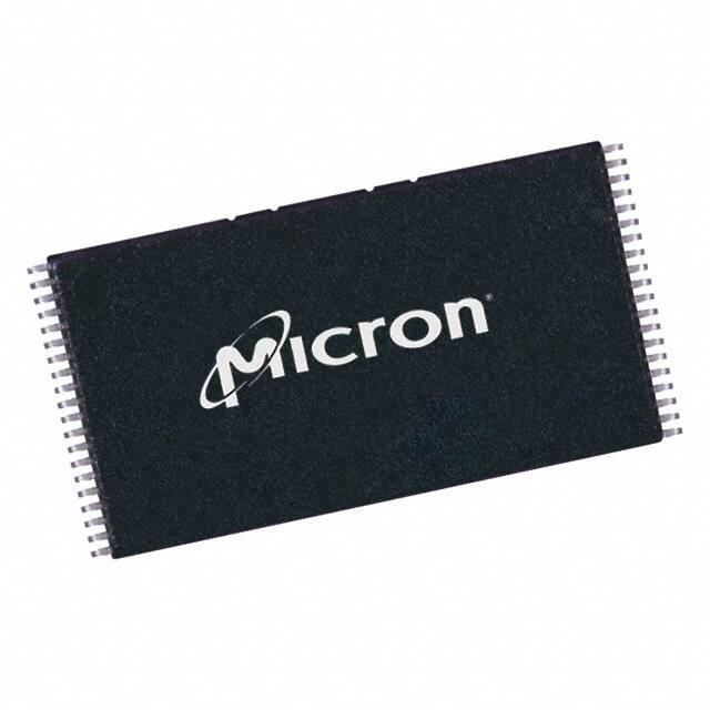

MT28F004B5VG-8 B 数据手册
4Mb SMART 5 BOOT BLOCK FLASH MEMORY FLASH MEMORY MT28F004B5 MT28F400B5 5V Only, Dual Supply (Smart 5) 0.18µm Process Technology FEATURES • Seven erase blocks: 16KB/8K-word boot block (protected) Two 8KB/4K-word parameter blocks Four main memory blocks • Smart 5 technology (B5): 5V ±10% VCC 5V ±10% VPP application/production programming1 • Advanced 0.18µm CMOS floating-gate process • Compatible with 0.3µm Smart 5 device • Address access time: 80ns • 100,000 ERASE cycles • Industry-standard pinouts • Inputs and outputs are fully TTL-compatible • Automated write and erase algorithm • Two-cycle WRITE/ERASE sequence • Byte- or word-wide READ and WRITE (MT28F400B5, 256K x 16/512K x 8) • Byte-wide READ and WRITE only (MT28F004B5, 512K x 8) • TSOP and SOP packaging options OPTIONS 48-Pin TSOP Type I 44-Pin SOP2 GENERAL DESCRIPTION The MT28F004B5 (x8) and MT28F400B5 (x16, x8) are nonvolatile, electrically block-erasable (Flash), programmable, read-only memories containing 4,194,304 bits organized as 262,144 words (16 bits) or 524,288 bytes (8 bits). Writing or erasing the device is done with a 5V VPP voltage, while all operations are performed with a 5V VCC. Due to process technology advances, 5V VPP is optimal for application and production programming. These devices are fabricated with Micron’s advanced 0.18µm CMOS floating-gate process. The MT28F004B5 and MT28F400B5 are organized into seven separately erasable blocks. To ensure that critical firmware is protected from accidental erasure or overwrite, the devices feature a hardware-protected boot block. Writing or erasing the boot block requires either applying a super-voltage to the RP# pin or driving WP# HIGH in addition to executing the normal write or erase sequences. This block may be used to store code implemented in low-level system recovery. The remaining blocks vary in density and are written and erased with no additional security measures. Please refer to Micron’s Web site (www.micron.com/ flash) for the latest data sheet. MARKING • Timing 80ns access • Configurations 512K x 8 256K x 16/512K x 8 • Boot Block Starting Word Address Top (3FFFFh) Bottom (00000h) • Operating Temperature Range Extended (-40ºC to +85ºC) • Packages MT28F004B5 Plastic 40-pin (standard) TSOP Type I Plastic 40-pin (lead free) TSOP Type I MT28F400B5 Plastic 48-pin (standard) TSOP Type I Plastic 48-pin (lead free) TSOP Type I Plastic 44-pin (standard) SOP Plastic 44-pin (lead free) SOP Notes: 40-Pin TSOP Type I -8 MT28F004B5 MT28F400B5 T B ET VG VP WG WP SG2 SP2 1. This generation of devices does not support 12V VPP compatibility production programming; however, 5V VPP application production programming can be used with no loss of performance. 2. Contact factory for availability. Part Number Example: MT28F400B5WG-8 T 09005aef8075d1f1 MT28F004B5.fm - Rev. 4, Pub. 2/2004 1 ©2002 Micron Technology, Inc. PRODUCTS AND SPECIFICATIONS DISCUSSED HEREIN ARE SUBJECT TO CHANGE BY MICRON WITHOUT NOTICE. 4Mb SMART 5 BOOT BLOCK FLASH MEMORY Pin Assignment (Top View) 44-PIN SOP1 48-Pin TSOP Type I A15 A14 A13 A12 A11 A10 A9 A8 NC NC WE# RP# VPP WP# NC NC A17 A7 A6 A5 A4 A3 A2 A1 1 2 3 4 5 6 7 8 9 10 11 12 13 14 15 16 17 18 19 20 21 22 23 24 48 47 46 45 44 43 42 41 40 39 38 37 36 35 34 33 32 31 30 29 28 27 26 25 A16 BYTE# VSS DQ15/(A-1) DQ7 DQ14 DQ6 DQ13 DQ5 DQ12 DQ4 VCC DQ11 DQ3 DQ10 DQ2 DQ9 DQ1 DQ8 DQ0 OE# VSS CE# A0 Order Number and Part Marking MT28F400B5WG-8 B MT28F400B5WP-8 B MT28F400B5WG-8 T MT28F400B5WP-8 T MT28F400B5WG-8 BET MT28F400B5WP-8 BET MT28F400B5WG-8 TET MT28F400B5WP-8 TET VPP 1 44 RP# WP# 2 43 WE# A17 3 42 A8 A7 4 41 A9 A6 5 40 A10 A5 6 39 A11 A4 7 38 A12 A3 8 37 A13 A2 9 36 A14 A1 10 35 A15 A0 11 34 A16 CE# 12 33 BYTE# VSS 13 32 VSS OE# 14 31 DQ15/(A-1) DQ0 15 30 DQ7 DQ8 16 29 DQ14 DQ1 17 28 DQ6 DQ9 18 27 DQ13 DQ2 19 26 DQ5 DQ10 20 25 DQ12 DQ3 21 24 DQ4 DQ11 22 23 VCC Order Number and Part Marking MT28F400B5SG-8 B MT28F400B5SP-8 B MT28F400B5SG-8 T MT28F400B5SP-8 T MT28F400B5SG-8 BET MT28F400B5SPG-8 BET MT28F400B5SG-8 TET MT28F400B5SP-8 TET 40-Pin TSOP Type I A16 A15 A14 A13 A12 A11 A9 A8 WE# RP# VPP WP# A18 A7 A6 A5 A4 A3 A2 A1 40 39 38 37 36 35 34 33 32 31 30 29 28 27 26 25 24 23 22 21 1 2 3 4 5 6 7 8 9 10 11 12 13 14 15 16 17 18 19 20 A17 VSS NC NC A10 DQ7 DQ6 DQ5 DQ4 VCC VCC NC DQ3 DQ2 DQ1 DQ0 OE# VSS CE# A0 Order Number and Part Marking MT28F004B5VG-8 B MT28F004B5VP-8 B MT28F004B5VG-8 T MT28F004B5VP-8 T MT28F400B5SG-8 BET MT28F004B5VP-8 BET MT28F004B5VG-8 TET MT28F004B5VP-8 TET Notes: 1. Contact factory for availability. 09005aef8075d1f1 MT28F004B5.fm - Rev. 4, Pub. 2/2004 2 Micron Technology, Inc., reserves the right to change products or specifications without notice. ©2002 Micron Technology, Inc. 4Mb SMART 5 BOOT BLOCK FLASH MEMORY Functional Block Diagram BYTE#1 8 Input Buffer 7 Input Buffer I/O Control Logic 16KB Boot Block Addr. Buffer/ 18 (19) 9 Latch A9 9 (10) Addr. Power (Current) Control 8KB Parameter Block 8KB Parameter Block X - Decoder/Block Erase Control A0–A17/(18) Counter 96KB Main Block 128KB Main Block A-1 DQ15/(A - 1)1 16 DQ8–DQ141 128KB Main Block Command State Execution Machine Logic YDecoder RP# VCC VPP Input Data Latch/Mux 128KB Main Block WP# CE# OE# WE# Input Buffer DQ0–DQ7 7 Y - Select Gates 8 Sense Amplifiers Write/Erase-Bit Compare and Verify VPP Switch/ Pump Output Buffer DQ15 Status Register Identification Register Output Buffer 7 8 MUX Output Buffer 8 Notes: 1. Does not apply to MT28F004B5. 09005aef8075d1f1 MT28F004B5.fm - Rev. 4, Pub. 2/2004 3 Micron Technology, Inc., reserves the right to change products or specifications without notice. ©2002 Micron Technology, Inc. 4Mb SMART 5 BOOT BLOCK FLASH MEMORY PIN DESCRIPTIONS 44-PIN SOP NUMBERS 40-PIN TSOP NUMBERS 48-PIN TSOP NUMBERS SYMBOL TYPE DESCRIPTION 43 9 11 WE# Input 2 12 14 WP# Input 12 22 26 CE# Input 44 10 12 RP# Input 14 24 28 OE# Input 33 – 47 BYTE# Input 25, 24, 23, 22, 21, 20, 19, 18, 8, 7, 6, 5, 4, 3, 2, 1, 48, 17 A0–A17/ (A18) Input Write Enable: Determines if a given cycle is a WRITE cycle. If WE# is LOW, the cycle is either a WRITE to the command execution logic (CEL) or to the memory array. Write Protect: Unlocks the boot block when HIGH if VPP = 5V and RP# = VIH during a WRITE or ERASE. Does not affect WRITE or ERASE operation on other blocks. Chip Enable: Activates the device when LOW. When CE# is HIGH, the device is disabled and goes into standby power mode. Reset/Power-Down: When LOW, RP# clears the status register, sets the internal state machine (ISM) to the array read mode and places the device in deep power-down mode. All inputs, including CE#, are “Don’t Care,” and all outputs are High-Z. RP# unlocks the boot block and overrides the condition of WP# when at VHH, and must be held at VIH during all other modes of operation. Output Enable: Enables data output buffers when LOW. When OE# is HIGH, the output buffers are disabled. Byte Enable: If BYTE# = HIGH, the upper byte is active through DQ8–DQ15. If BYTE# = LOW, DQ8–DQ14 are High-Z, and all data is accessed through DQ0–DQ7. DQ15/ (A-1) becomes the least significant address input. Address Inputs: Select a unique, 16-bit word or 8-bit byte. The Q15/(A-1) input becomes the lowest order address when BYTE# = LOW (MT28F400B5) to allow for a selection of an 8-bit byte from the 524,288 available. 45 DQ15 (A-1) DQ0–DQ7 VCC VSS NC 11, 10, 9, 8, 21, 20, 19, 7, 6, 5, 4, 18, 17, 42, 41, 40, 16,15, 14, 8, 39, 38, 37, 7, 36, 6, 5, 36, 35, 34, 3 4, 3, 2, 1, 40, 13 31 – 15, 17, 19, 21, 24, 26, 28, 30 16, 18, 20, 22, 25, 27, 29 1 25-28, 32-35 11 29, 31, 33, 35, 38, 40, 42, 44 30, 32, 34, 36, 39, 41, 43 13 23 13, 32 – 30, 31 23, 39 29, 37, 38 37 27, 46 9, 10, 15, 16 – 09005aef8075d1f1 MT28F004B5.fm - Rev. 4, Pub. 2/2004 DQ8– DQ14 VPP Input/ Data I/O: MSB of data when BYTE# = HIGH. Address Input: Output LSB of address input when BYTE# = LOW during READ or WRITE operation. Input/ Data I/Os: Data output pins during any READ operation or Output data input pins during a WRITE. These pins are used to input commands to the CEL. Input/ Data I/Os: Data output pins during any READ operation or Output data input pins during a WRITE when BYTE# = HIGH. These pins are High-Z when BYTE# is LOW. Supply Write/Erase Supply Voltage: From a WRITE or ERASE CONFIRM until completion of the WRITE or ERASE, VPP must be at VPPH (5V). VPP = “Don’t Care” during all other operations. Supply Power Supply: +5V ±10%. Supply Ground. – No Connect: These pins may be driven or left unconnected. 4 Micron Technology, Inc., reserves the right to change products or specifications without notice. ©2002 Micron Technology, Inc. 4Mb SMART 5 BOOT BLOCK FLASH MEMORY TRUTH TABLE (MT28F400B5)1 FUNCTION RP# CE# H H Standby L X Reset READ H L READ (word mode) H L READ (byte mode) H L Output Disable WRITE/ERASE (EXCEPT BOOT BLOCK)2 H L ERASE SETUP 3 H L ERASE CONFIRM H L WRITE SETUP H L WRITE (word mode)4 4 H L WRITE (byte mode) H L READ ARRAY5 WRITE/ERASE (BOOT BLOCK)2 H L ERASE SETUP 3 VHH L ERASE CONFIRM H L ERASE CONFIRM3, 6 H L WRITE SETUP 4 VHH L WRITE (word mode) H L WRITE (word mode)4, 6 VHH L WRITE (byte mode)4 4, 6 H L WRITE (byte mode) H L READ ARRAY5 DEVICE IDENTIFICATION7 H L Manufacturer Compatibility (word mode)8 H L Manufacturer Compatibility (byte mode) H L Device (word mode, top boot)8 H L Device (byte mode, top boot) H L Device (word mode, bottom boot)8 H L Device (byte mode, bottom boot) Notes: 1. 2. 3. 4. 5. 6. 7. 8. OE# WE# WP# BYTE# A0 A9 VPP DQ0– DQ7 DQ8– DQ14 DQ15/ A-1 X X X X X X X X X X X X X X High-Z High-Z High-Z High-Z High-Z High-Z L L H H H H X X X H L X X X X X X X X X X Data-Out Data-Out High-Z Data-Out High-Z High-Z Data-Out A-1 High-Z H H H H H H L L L L L L X X X X X X X X X H L X X X X X X X X X X X X X X 20h D0h 10h/40h Data-In Data-In FFh X X X Data-In X X X X X Data-In A-1 X H H H H H H H H H L L L L L L L L L X X H X X H X H X X X X X H H L L X X X X X X X X X X X X X X X X X X X VPPH VPPH X VPPH VPPH VPPH VPPH X 20h D0h D0h 10h/40h Data-In Data-In Data-In Data-In FFh X X X X Data-In Data-In X X X X X X X Data-In Data-In A-1 A-1 X L H X H L VID X 89hX 00h – L H X L L VID X 89h High-Z X L H X H H VID X 70h 44h – L H X L H VID X 70h High-Z X L H X H H VID X 71h 44h – L H X L H VID X 71h High-Z X VPPH X VPPH VPPH X X L = VIL (LOW), H = VIH (HIGH), X = VIL or VIH (“Don’t Care”). VPPH = 5V. Operation must be preceded by ERASE SETUP command. Operation must be preceded by WRITE SETUP command. The READ ARRAY command must be issued before reading the array after writing or erasing. When WP# = VIH, RP# may be at VIH or VHH. A1–A8, A10–A17 = VIL. Value reflects DQ8–DQ15. 09005aef8075d1f1 MT28F004B5.fm - Rev. 4, Pub. 2/2004 5 Micron Technology, Inc., reserves the right to change products or specifications without notice. ©2002 Micron Technology, Inc. 4Mb SMART 5 BOOT BLOCK FLASH MEMORY TRUTH TABLE (MT28F004B5)1 FUNCTION RP# H Standby L RESET READ H READ H Output Disable WRITE/ERASE (EXCEPT BOOT BLOCK)2 H ERASE SETUP H ERASE CONFIRM3 H WRITE SETUP H WRITE4 H READ ARRAY5 WRITE/ERASE (BOOT BLOCK)2 H ERASE SETUP VHH ERASE CONFIRM3 H ERASE CONFIRM3, 6 H WRITE SETUP VHH WRITE4 H WRITE4, 6 H READ ARRAY5 7 DEVICE IDENTIFICATION H Manufacturer Compatibility H Device (top boot) H Device (bottom boot) Notes: 1. 2. 3. 4. 5. 6. 7. CE# OE# WE# WP# A0 A9 VPP DQ0–DQ7 H X X X X X X X X X X X X X High-Z High-Z L L L H H H X X X X X X X X Data-Out High-Z L L L L L H H H H H L L L L L X X X X X X X X X X X X X X X X VPPH X VPPH X 20h D0h 10h/40h Data-In FFh L L L L L L L H H H H H H H L L L L L L L X X H X X H X X X X X X X X X X X X X X X X VPPH VPPH X VPPH VPPH X 20h D0h D0h 10h/40h Data-In Data-In FFh L L L L L L H H H X X X L H H VID VID VID X X X 89h 78h 79h L = VIL, H = VIH, X = VIL or VIH. VPPH = 5V. Operation must be preceded by ERASE SETUP command. Operation must be preceded by WRITE SETUP command. The READ ARRAY command must be issued before reading the array after writing or erasing. When WP# = VIH, RP# may be at VIH or VHH. A1–A8, A10–A18 = VIL. 09005aef8075d1f1 MT28F004B5.fm - Rev. 4, Pub. 2/2004 6 Micron Technology, Inc., reserves the right to change products or specifications without notice. ©2002 Micron Technology, Inc. 4Mb SMART 5 BOOT BLOCK FLASH MEMORY FUNCTIONAL DESCRIPTION (5V) on the VPP pin, before a WRITE or ERASE will be performed on the boot block. The remaining blocks require that only the VPP voltage be present on the VPP pin before writing or erasing. The MT28F004B5 and MT28F400B5 Flash memories incorporate a number of features ideally suited for system firmware. The memory array is segmented into individual erase blocks. Each block may be erased without affecting data stored in other blocks. These memory blocks are read, written and erased with commands to the command execution logic (CEL). The CEL controls the operation of the internal state machine (ISM), which completely controls all WRITE, BLOCK ERASE, and VERIFY operations. The ISM protects each memory location from over-erasure and optimizes each memory location for maximum data retention. In addition, the ISM greatly simplifies the control necessary for writing the device in-system or in an external programmer. The Functional Description provides detailed information on the operation of the MT28F004B5 and MT28F400B5 and is organized into these sections: • • • • • • • • • • • Hardware-Protected Boot This block of the memory array can be erased or written only when the RP# pin is taken to VHH or when the WP# pin is brought HIGH. This provides additional security for the core firmware during in-system firmware updates should an unintentional power fluctuation or system reset occur. The MT28F004B5 and MT28F400B5 are available with the boot block starting at the bottom of the address space (“B” suffix) or the top of the address space (“T” suffix). Selectable Bus Size (MT28F400B5 only) The MT28F400B5 allows selection of an 8-bit (512K x 8) or 16-bit (256K x 16) data bus for reading and writing the memory. The BYTE# pin is used to select the bus width. In the x16 configuration, control data is read or written only on the lower eight bits (DQ0– DQ7). Data written to the memory array utilizes all active data pins for the selected configuration. When the x8 configuration is selected, data is written in byte form; when the x16 configuration is selected, data is written in word form. Overview Memory Architecture Output (READ) operations Input Operations Command Set ISM Status Register Command Execution Error Handling WRITE/ERASE Cycle Endurance Power Usage Power-Up Internal State Machine (ISM) Block erase and byte/word write timing are simplified with an ISM that controls all erase and write algorithms in the memory array. The ISM ensures protection against overerasure and optimizes write margin to each cell. During WRITE operations, the ISM automatically increments and monitors WRITE attempts, verifies write margin on each memory cell and updates the ISM status register. When BLOCK ERASE is performed, the ISM automatically overwrites the entire addressed block (eliminates overerasure), increments and monitors ERASE attempts, and sets bits in the ISM status register. OVERVIEW Smart 5 Technology (B5) Smart 5 technology allows maximum flexibility for in-system READ, WRITE and ERASE operations. For 5V-only systems, WRITE and ERASE operations may be executed with a VPP voltage of 5V. Due to process technology advances, 5V VPP is optimal for application and production programming. Seven Independently Erasable Memory Blocks The MT28F004B5 and MT28F400B5 are organized into seven independently erasable memory blocks that allow portions of the memory to be erased without affecting the rest of the memory data. A special boot block is hardware-protected against inadvertent erasure or writing by requiring either a super-voltage on the RP# pin or driving the WP# pin HIGH. One of these two conditions must exist, along with the VPP voltage 09005aef8075d1f1 MT28F004B5.fm - Rev. 4, Pub. 2/2004 ISM Status Register The ISM status register enables an external processor to monitor the status of the ISM during WRITE and ERASE operations. Two bits of the 8-bit status register are set and cleared entirely by the ISM. These bits indicate whether the ISM is busy with a WRITE or ERASE task and when an ERASE has been suspended. Addi7 Micron Technology, Inc., reserves the right to change products or specifications without notice. ©2002 Micron Technology, Inc. 4Mb SMART 5 BOOT BLOCK FLASH MEMORY remaining six blocks do not require that either of these two conditions be met before WRITE or ERASE operations. tional error information is set in three other bits: VPP status, write status, and erase status. Command Execution Logic (CEL) Boot Block The CEL receives and interprets commands to the device. These commands control the operation of the ISM and the read path (i.e., memory array, ID register or status register). Commands may be issued to the CEL while the ISM is active. However, there are restrictions on what commands are allowed in this condition. See the Command Execution section for more detail. The hardware-protected boot block provides extra security for the most sensitive portions of the firmware. This 16KB block may only be erased or written when the RP# pin is at the specified boot block unlock voltage (VHH) or when the WP# pin is VIH. During a WRITE or ERASE of the boot block, the RP# pin must be held at VHH or the WP# pin held HIGH until the ERASE or WRITE is completed. The VPP pin must be at VPPH (5V) when the boot block is written to or erased. The MT28F004B5 and MT28F400B5 are available in two configurations and top or bottom boot block. The top boot block version supports processors of the x86 variety. The bottom boot block version is intended for 680X0 and RISC applications. Figure 1 illustrates the memory address maps associated with these two versions. Deep Power-down Mode To allow for maximum power conservation, the MT28F004B5 and MT28F400B5 feature a very low current, deep power-down mode. To enter this mode, the RP# pin is taken to VSS ±0.2V. In this mode, the current draw is a maximum of 20µA at 5V VCC. Entering deep power-down also clears the status register and sets the ISM to the read array mode. MEMORY ARCHITECTURE Parameter Blocks The MT28F004B5 and MT28F400B5 memory array architecture is designed to allow sections to be erased without disturbing the rest of the array. The array is divided into seven addressable blocks that vary in size and are independently erasable. When blocks rather than the entire array are erased, total device endurance is enhanced, as is system flexibility. Only the ERASE function is block-oriented. All READ and WRITE operations are done on a random-access basis. The boot block is protected from unintentional ERASE or WRITE operations with a hardware protection circuit that requires a super-voltage be applied to RP# or that the WP# pin be driven HIGH before erasure is commenced. The boot block is intended for the core firmware required for basic system functionality. The 09005aef8075d1f1 MT28F004B5.fm - Rev. 4, Pub. 2/2004 The two 8KB parameter blocks store less sensitive and more frequently changing system parameters and also may store configuration or diagnostic coding. These blocks are enabled for erasure when the VPP pin is at VPPH. No super-voltage unlock or WP# control is required. Main Memory Blocks The four remaining blocks are general-purpose memory blocks and do not require a super-voltage on RP# or WP# control to be erased or written. These blocks are intended for code storage, ROM-resident applications or operating systems that require in-system update capability. 8 Micron Technology, Inc., reserves the right to change products or specifications without notice. ©2002 Micron Technology, Inc. 4Mb SMART 5 BOOT BLOCK FLASH MEMORY Figure 1 Memory Address Maps Bottom Boot MT28F004B5/400B5xx-xxB Top Boot MT28F004B5/400B5xx-xxT WORD ADDRESS WORD ADDRESS BYTE ADDRESS 3FFFFh 7FFFFh BYTE ADDRESS 3FFFFh 7FFFFh 3E000h 3DFFFh 3D000h 3CFFFh 3C000h 3BFFFh 7C000h 7BFFFh 7A000h 79FFFh 78000h 77FFFh 16KB Boot Block 128KB Main Block 30000h 2FFFFh 60000h 5FFFFh 8KB Parameter Block 8KB Parameter Block 96KB Main Block 128KB Main Block 30000h 2FFFFh 20000h 1FFFFh 60000h 5FFFFh 40000h 3FFFFh 128KB Main Block 128KB Main Block 20000h 1FFFFh 10000h 0FFFFh 40000h 3FFFFh 20000h 1FFFFh 128KB Main Block 96KB Main Block 04000h 03FFFh 03000h 02FFFh 02000h 01FFFh 08000h 07FFFh 06000h 05FFFh 04000h 03FFFh 10000h 0FFFFh 8KB Parameter Block 20000h 1FFFFh 8KB Parameter Block 128KB Main Block 16KB Boot Block 00000h 09005aef8075d1f1 MT28F004B5.fm - Rev. 4, Pub. 2/2004 00000h 00000h 9 00000h Micron Technology, Inc., reserves the right to change products or specifications without notice. ©2002 Micron Technology, Inc. 4Mb SMART 5 BOOT BLOCK FLASH MEMORY OUTPUT (READ) OPERATIONS REGISTER may be given to return to the status register read mode. All commands and their operations are described in the Command Set and Command Execution sections. The MT28F004B5 and MT28F400B5 feature three different types of READS. Depending on the current mode of the device, a READ operation produces data from the memory array, status register or device identification register. In each of these three cases, the WE#, CE# and OE# inputs are controlled in a similar manner. Moving between modes to perform a specific read is described in the Command Execution section. Identification Registers A READ of the two 8-bit device identification registers requires the same input sequencing as a READ of the array. WE# must be HIGH, and OE# and CE# must be LOW. However, ID register data is output only on DQ0–DQ7, regardless of the condition of BYTE# on the MT28F400B5. A0 is used to decode between the two bytes of the device ID register; all other address inputs are “Don’t Care.” When A0 is LOW, the manufacturer compatibility ID is output, and when A0 is HIGH, the device ID is output. DQ8–DQ15 are High-Z when BYTE# is LOW. When BYTE# is HIGH, DQ8–DQ15 are 00h when the manufacturer compatibility ID is read and 44h when the device ID is read. To get to the identification register read mode, READ IDENTIFICATION may be issued while the device is in certain other modes. In addition, the identification register read mode can be reached by applying a super-voltage (VID) to the A9 pin. Using this method, the ID register can be read while the device is in any mode. When A9 is returned to VIL or VIH, the device returns to the previous mode. Memory Array To read the memory array, WE# must be HIGH, and OE# and CE# must be LOW. Valid data is output on the DQ pins when these conditions have been met and a valid address is given. Valid data remains on the DQ pins until the address changes, or until OE# or CE# goes HIGH, whichever occurs first. The DQ pins continue to output new data after each address transition as long as OE# and CE# remain LOW. The MT28F400B5 features selectable bus widths. When the memory array is accessed as a 256K x 16, BYTE# is HIGH, and data will be output on DQ0– DQ15. To access the memory array as a 512K x 8, BYTE# must be LOW, DQ8–DQ14 are High-Z, and all data is output on DQ0–DQ7. The DQ15/(A - 1) pin becomes the lowest order address input so that 524,288 locations can be read. After power-up or RESET, the device is automatically in the array read mode. All commands and their operations are described in the Command Set and Command Execution sections. INPUT OPERATIONS The DQ pins are used either to input data to the array or to input a command to the CEL. A command input issues an 8-bit command to the CEL to control the mode of operation of the device. A WRITE is used to input data to the memory array. The following section describes both types of inputs. More information describing how to use the two types of inputs to write or erase the device is provided in the Command Execution section. Status Register Performing a READ of the status register requires the same input sequencing as a READ of the array except that the address inputs are “Don’t Care.” The status register contents are always output on DQ0– DQ7, regardless of the condition of BYTE# on the MT28F400B5. DQ8–DQ15 are LOW when BYTE# is HIGH, and DQ8–DQ14 are High-Z when BYTE# is LOW. Data from the status register is latched on the falling edge of OE# or CE#, whichever occurs last. If the contents of the status register change during a READ of the status register, either OE# or CE# may be toggled while the other is held LOW to update the output. Following a WRITE or ERASE, the device automatically enters the status register read mode. In addition, a READ during a WRITE or ERASE produces the status register contents on DQ0–DQ7. When the device is in the erase suspend mode, a READ operation produces the status register contents until another command is issued, while in certain other modes, READ STATUS 09005aef8075d1f1 MT28F004B5.fm - Rev. 4, Pub. 2/2004 Commands To perform a command input, OE# must be HIGH, and CE# and WE# must be LOW. Addresses are “Don’t Care” but must be held stable, except during an ERASE CONFIRM (described in a later section). The 8-bit command is input on DQ0–DQ7, while DQ8–DQ15 are “Don’t Care” on the MT28F400B5. The command is latched on the rising edge of CE# (CE#-controlled) or WE# (WE#-controlled), whichever occurs first. The condition of BYTE# on the MT28F400B5 has no effect on a command input. 10 Micron Technology, Inc., reserves the right to change products or specifications without notice. ©2002 Micron Technology, Inc. 4Mb SMART 5 BOOT BLOCK FLASH MEMORY Memory Array Selectable bus sizing applies to WRITEs as it does to READs on the MT28F400B5. When BYTE# is LOW (byte mode), data is input on DQ0–DQ7, DQ8–DQ14 are High-Z and DQ15 becomes the lowest order address input. When BYTE# is HIGH (word mode), data is input on DQ0–DQ15. A WRITE to the memory array sets the desired bits to logic 0s but cannot change a given bit to a logic 1 from a logic 0. Setting any bits to a logic 1 requires that the entire block be erased. To perform a WRITE, OE# must be HIGH, CE# and WE# must be LOW, and VPP must be set to VPPH. Writing to the boot block also requires that the RP# pin be at VHH or WP# be HIGH. A0–A17/(A18) provide the address to be written, while the data to be written to the array is input on the DQ pins. The data and addresses are latched on the rising edge of CE# (CE#-controlled) or WE# (WE#-controlled), whichever occurs first. A WRITE must be preceded by a WRITE SETUP command. Details on how to input data to the array are described in the Write Sequence section. Table 1: COMMAND SET To simplify writing of the memory blocks, the MT28F004B5 and MT28F400B5 incorporate an ISM that controls all internal algorithms for the WRITE and ERASE cycles. An 8-bit command set is used to control the device. Details on how to sequence commands are provided in the Command Execution section. Table 1 lists the valid commands. Command Set COMMAND HEX CODE RESERVED 00h READ ARRAY FFh IDENTIFY DEVICE 90h READ STATUS REGISTER 70h CLEAR STATUS REGISTER ERASE SETUP 50h 20h ERASE CONFIRM/RESUME D0h WRITE SETUP ERASE SUSPEND 09005aef8075d1f1 MT28F004B5.fm - Rev. 4, Pub. 2/2004 40h or 10h B0h DESCRIPTION This command and all unlisted commands are invalid and should not be called. These commands are reserved to allow for future feature enhancements. Must be issued after any other command cycle before the array can be read. It is not necessary to issue this command after power-up or RESET. Allows the device ID and manufacturer compatibility ID to be read. A0 is used to decode between the manufacturer compatibility ID (A0 = LOW) and device ID (A0 = HIGH). Allows the status register to be read. Please refer to Table 2 for more information on the status register bits. Clears status register bits 3–5, which cannot be cleared by the ISM. The first command given in the two-cycle ERASE sequence. The ERASE is not completed unless followed by ERASE CONFIRM. The second command given in the two-cycle ERASE sequence. Must follow an ERASE SETUP command to be valid. Also used during an ERASE SUSPEND to resume the ERASE. The first command given in the two-cycle WRITE sequence. The write data and address are given in the following cycle to complete the WRITE. Requests a halt of the ERASE and puts the device into the erase suspend mode. When the device is in this mode, only READ STATUS REGISTER, READ ARRAY and ERASE RESUME commands may be executed. 11 Micron Technology, Inc., reserves the right to change products or specifications without notice. ©2002 Micron Technology, Inc. 4Mb SMART 5 BOOT BLOCK FLASH MEMORY ISM STATUS REGISTER ISM. The erase, write and VPP status bits must be cleared using CLEAR STATUS REGISTER. If the Vpp status bit (SR3) is set, the CEL does not allow further WRITE or ERASE operations until the status register is cleared. This enables the user to choose when to poll and clear the status register. For example, the host system may perform multiple BYTE WRITE operations before checking the status register instead of checking after each individual WRITE. Asserting the RP# signal or powering down the device also clears the status register. The 8-bit ISM status register (see Table 2) is polled to check for WRITE or ERASE completion or any related errors. During or following a WRITE, ERASE or ERASE SUSPEND, a READ operation outputs the status register contents on DQ0–DQ7 without prior command. While the status register contents are read, the outputs are not updated if there is a change in the ISM status unless OE# or CE# is toggled. If the device is not in the write, erase, erase suspend or status register read mode, READ STATUS REGISTER (70h) can be issued to view the status register contents. All of the defined bits are set by the ISM, but only the ISM and erase suspend status bits are reset by the Table 2: STATUS BIT # SR7 SR6 SR5 SR4 SR3 SR0-2 Status Register STATUS REGISTER BIT DESCRIPTION ISM STATUS 1 = Ready 0 = Busy ERASE SUSPEND STATUS 1 = ERASE suspended 0 = ERASE in progress/completed ERASE STATUS 1 = BLOCK ERASE error 0 = Successful BLOCK ERASE WRITE STATUS 1 = WORD/BYTE WRITE error 0 = Successful WORD/BYTE WRITE VPP STATUS 1 = No VPP voltage detected 0 = VPP present The ISMS bit displays the active status of the state machine during WRITE or BLOCK ERASE operations. The controlling logic polls this bit to determine when the erase and write status bits are valid. Issuing an ERASE SUSPEND places the ISM in the suspend mode and sets this and the ISMS bit to “1.” The ESS bit remains “1” until an ERASE RESUME is issued. ES is set to “1” after the maximum number of ERASE cycles is executed by the ISM without a successful verify. ES is only cleared by a CLEAR STATUS REGISTER command or after a RESET. WS is set to “1” after the maximum number of WRITE cycles is executed by the ISM without a successful verify. WS is only cleared by a CLEAR STATUS REGISTER command or after a RESET. VPPS detects the presence of a VPP voltage. It does not monitor VPP continuously, nor does it indicate a valid VPP voltage. The VPP pin is sampled for 5V after WRITE or ERASE CONFIRM is given. VPPS must be cleared by CLEAR STATUS REGISTER or by a RESET. Reserved for future use. RESERVED 09005aef8075d1f1 MT28F004B5.fm - Rev. 4, Pub. 2/2004 12 Micron Technology, Inc., reserves the right to change products or specifications without notice. ©2002 Micron Technology, Inc. 4Mb SMART 5 BOOT BLOCK FLASH MEMORY COMMAND EXECUTION first cycle. The next cycle is the WRITE, during which the write address and data are issued and VPP is brought to VPPH. Writing to the boot block also requires that the RP# pin be brought to VHH or that the WP# pin be brought HIGH at the same time VPP IS brought to VPPH. The ISM will now begin to write the word or byte. VPP must be held at VPPH until the write is completed (SR7 = 1). While the ISM executes the WRITE, the ISM status bit (SR7) is at “0,” and the device does not respond to any commands. Any READ operation produces the status register contents on DQ0–DQ7. When the ISM status bit (SR7) is set to a logic 1, the write is complete, and the device goes into the status register read mode until another command is given. After the ISM has initiated the WRITE, it cannot be aborted except by a RESET or by powering down the part. Doing either during a WRITE corrupts the data being written. If only the WRITE SETUP command has been given, the WRITE may be nullified by performing a null WRITE. To execute a null WRITE, FFh must be written when BYTE# is LOW, or FFFFh must be written when BYTE# is HIGH. When the ISM status bit (SR7) is set, the device is in the status register read mode until another command is issued. Commands are issued to bring the device into different operational modes. Each mode allows specific operations to be performed. Several modes require a sequence of commands to be written before they are reached. The following section describes the properties of each mode, and Table 3 lists all command sequences required to perform the desired operation. Read Array The array read mode is the initial state of the device upon power-up and after a RESET. If the device is in any other mode, READ ARRAY (FFh) must be given to return to the array read mode. Unlike the WRITE SETUP command (40h), READ ARRAY does not need to be given before each individual read access. Identify Device IDENTIFY DEVICE (90h) may be written to the CEL to enter the identify device mode. While the device is in this mode, any READ produces the device ID when A0 is HIGH and manufacturer compatibility ID when A0 is LOW. The device remains in this mode until another command is given. WRITE Sequence Two consecutive cycles are needed to write data to the array. WRITE SETUP (40h or 10h) is given in the Table 3: Command Sequences COMMANDS READ ARRAY IDENTIFY DEVICE READ STATUS REGISTER CLEAR STATUS REGISTER ERASE SETUP/CONFIRM ERASE SUSPEND/RESUME WRITE SETUP/WRITE ALTERNATE WORD/BYTE WRITE Notes: 1. 2. 3. 4. 5. 6. 7. BUS FIRST CYCLE CYCLES REQ’D OPERATION ADDRESS 1 3 2 1 2 2 2 2 WRITE WRITE WRITE WRITE WRITE WRITE WRITE WRITE X X X X X X X X SECOND CYCLE DATA OPERATION FFh 90h 70h 50h 20h B0h 40h 10h ADDRESS DATA NOTES READ READ IA X ID SRD WRITE WRITE WRITE WRITE BA X WA WA D0h D0h WD WD 1 2, 3 4 5, 6 6, 7 6, 7 Must follow WRITE or ERASE CONFIRM commands to the CEL to enable Flash array READ cycles. IA = Identify Address: 00h for manufacturer compatibility ID; 01h for device ID. ID = Identify Data. SRD = Status Register Data. On x16 (X00) devices BA = Block Address (A12–A17), on x8 (00X) devices BA = Block Address (A13–A18). Addresses are “Don’t Care” in first cycle but must be held stable. WA = Address to be written; WD = Data to be written to WA. 09005aef8075d1f1 MT28F004B5.fm - Rev. 4, Pub. 2/2004 13 Micron Technology, Inc., reserves the right to change products or specifications without notice. ©2002 Micron Technology, Inc. 4Mb SMART 5 BOOT BLOCK FLASH MEMORY ERASE Sequence ERASE Suspension Executing an ERASE sequence sets all bits within a block to logic 1. The command sequence necessary to execute an ERASE is similar to that of a WRITE. To provide added security against accidental block erasure, two consecutive command cycles are required to initiate an ERASE of a block. In the first cycle, addresses are “Don’t Care,” and ERASE SETUP (20h) is given. In the second cycle, VPP must be brought to VPPH, an address within the block to be erased must be issued, and ERASE CONFIRM (D0H) must be given. If a command other than ERASE CONFIRM is given, the write and erase status bits (SR4 and SR5) are set, and the device is in the status register read mode. After the ERASE CONFIRM (D0h) is issued, the ISM starts the ERASE of the addressed block. Any READ operation outputs the status register contents on DQ0–DQ7. VPP must be held at VPPH until the ERASE is completed (SR7 = 1). When the ERASE is completed, the device is in the status register read mode until another command is issued. Erasing the boot block also requires that either the RP# pin be set to VHH or the WP# pin be held HIGH at the same time VPP is set to VPPH. The only command that may be issued while an ERASE is in progress is ERASE SUSPEND. This command enables other commands to be executed while pausing the ERASE in progress. When the device has reached the erase suspend mode, the erase suspend status bit (SR6) and ISM status bit (SR7) is set. The device may now be given a READ ARRAY, ERASE RESUME or READ STATUS REGISTER command. After READ ARRAY has been issued, any location not within the block being erased may be read. If ERASE RESUME is issued before SR6 has been set, the device immediately proceeds with the ERASE in progress. Table 4: ERROR HANDLING After the ISM status bit (SR7) has been set, the VPP (SR3), write (SR4) and erase (SR5) status bits may be checked. If one or a combination of these three bits has been set, an error has occurred. The ISM cannot reset these three bits. To clear these bits, CLEAR STATUS REGISTER (50H) must be given. If the VPP status bit (SR3) is set, further WRITE or ERASE operations cannot resume until the status register is cleared. Table 4 lists the combination of errors. Status Register Error Decode1 STATUS BITS SR5 SR4 SR3 0 0 0 0 1 1 1 1 0 0 1 1 0 0 1 1 0 1 0 1 0 1 0 1 ERROR DESCRIPTION No errors VPP voltage error WRITE error WRITE error, VPP voltage not valid at time of WRITE ERASE error ERASE error, VPP voltage not valid at time of ERASE CONFIRM Command sequencing error or WRITE/ERASE error Command sequencing error, VPP voltage error, with WRITE and ERASE errors Notes: 1. SR3–SR5 must be cleared using CLEAR STATUS REGISTER. 09005aef8075d1f1 MT28F004B5.fm - Rev. 4, Pub. 2/2004 14 Micron Technology, Inc., reserves the right to change products or specifications without notice. ©2002 Micron Technology, Inc. 4Mb SMART 5 BOOT BLOCK FLASH MEMORY WRITE/ERASE CYCLE ENDURANCE POWER-UP The MT28F004B5 and MT28F400B5 are designed and fabricated to meet advanced firmware storage requirements. To ensure this level of reliability, VPP must be at 5V ±10% during WRITE or ERASE cycles. Due to process technology advances, 5V VPP is optimal for application and production programming. The likelihood of unwanted WRITE or ERASE operations is minimized because two consecutive cycles are required to execute either operation. However, to reset the ISM and to provide additional protection while VCC is ramping, one of the following conditions must be met: • RP# must be held LOW until VCC is at valid functional level; or • CE# or WE# may be held HIGH and RP# must be toggled from VCC-GND-VCC. After a power-up or RESET, the status register is reset, and the device enters the array read mode. POWER USAGE The MT28F004B5 and MT28F400B5 offer several power-saving features that may be utilized in the array read mode to conserve power. Deep power-down mode is enabled by bringing RP# LOW. Current draw (ICC) in this mode is a maximum of 20µA at 5V VCC. When CE# is HIGH, the device enters standby mode. In this mode, maximum ICC current is 130µA at 5V. If CE# is brought HIGH during a WRITE or ERASE, the ISM continues to operate, and the device consumes the respective active power until the WRITE or ERASE is completed. Figure 2: Power-Up/Reset Timing Diagram RP# Note 1 VCC (5V) t AA Address VALID VALID Data t RWH UNDEFINED NOTE: 09005aef8075d1f1 MT28F004B5.fm - Rev. 4, Pub. 2/2004 15 1. VCC must be within the valid operating range before RP# goes HIGH. Micron Technology, Inc., reserves the right to change products or specifications without notice. ©2002 Micron Technology, Inc. 4Mb SMART 5 BOOT BLOCK FLASH MEMORY Self-Timed WRITE Sequence (WORD or BYTE WRITE)1 Complete WRITE STATUS-CHECK Sequence Start Start (WRITE completed) WRITE 40h or 10h SR3 = 0? NO VPP Error 4, 5 NO BYTE/WORD WRITE Error5 YES VPP = 5V SR4 = 0? YES WRITE Word or Byte Address/Data WRITE Successful STATUS REGISTER READ SR7 = 1? NO YES Complete Status2 Check (optional) WRITE Complete 3 Notes: 1. Sequence may be repeated for additional BYTE or WORD WRITEs. 2. Complete status check is not required. However, if SR3 = 1, further WRITEs are inhibited until the status register is cleared. 3. Device will be in status register read mode. To return to the array read mode, the FFh command must be issued. 4. If SR3 is set during a WRITE or BLOCK ERASE attempt, CLEAR STATUS REGISTER must be issued before further WRITE or ERASE operations are allowed by the CEL. 5. Status register bits 3-5 must be cleared using CLEAR STATUS REGISTER. 09005aef8075d1f1 MT28F004B5.fm - Rev. 4, Pub. 2/2004 16 Micron Technology, Inc., reserves the right to change products or specifications without notice. ©2002 Micron Technology, Inc. 4Mb SMART 5 BOOT BLOCK FLASH MEMORY Self-Timed BLOCK ERASE Sequence1 Complete BLOCK ERASE STATUS-CHECK Sequence Start Start (ERASE completed) WRITE 20h SR3 = 0? NO VPP Error 5, 6 YES Command Sequence Error6 NO BLOCK ERASE Error6 YES VPP = 5V SR4, 5 = 1? WRITE D0h, Block Address NO SR5 = 0? ERASE Busy STATUS REGISTER READ YES ERASE Successful NO NO SR7 = 1? Suspend ERASE? YES YES Complete Status 2 Check (optional) Suspend 4 Sequence ERASE Resumed ERASE Complete 3 Notes: 1. Sequence may be repeated to erase additional blocks. 2. Complete status check is not required. However, if SR3 = 1, further ERASEs are inhibited until the status register is cleared. 3. To return to the array read mode, the FFh command must be issued. 4. Refer to the ERASE SUSPEND flowchart for more information. 5. If SR3 is set during a WRITE or BLOCK ERASE attempt, CLEAR STATUS REGISTER must be issued before further WRITE or ERASE operations are allowed by the CEL. 6. Status register bits 3-5 must be cleared using CLEAR STATUS REGISTER. 09005aef8075d1f1 MT28F004B5.fm - Rev. 4, Pub. 2/2004 17 Micron Technology, Inc., reserves the right to change products or specifications without notice. ©2002 Micron Technology, Inc. 4Mb SMART 5 BOOT BLOCK FLASH MEMORY ERASE SUSPEND/RESUME Sequence Start (ERASE in progress) WRITE B0h (ERASE SUSPEND) VPP = 5V STATUS REGISTER READ SR7 = 1? NO YES SR6 = 1? NO YES ERASE Completed WRITE FFh (READ ARRAY) Done Reading? NO YES WRITE D0h (ERASE RESUME) Resume ERASE 09005aef8075d1f1 MT28F004B5.fm - Rev. 4, Pub. 2/2004 18 Micron Technology, Inc., reserves the right to change products or specifications without notice. ©2002 Micron Technology, Inc. 4Mb SMART 5 BOOT BLOCK FLASH MEMORY ABSOLUTE MAXIMUM RATINGS* *Stresses greater than those listed under “Absolute Maximum Ratings” may cause permanent damage to the device. This is a stress rating only, and functional operation of the device at these or any other conditions above those indicated in the operational sections of this specification is not implied. Exposure to absolute maximum rating conditions for extended periods may affect reliability. **VCC, input and I/O pins may transition to -2V for
MT28F004B5VG-8 B
物料型号: - 512Kx8: MT28F004B5 - 256Kx16/512Kx8: MT28F400B5
器件简介: Micron的4Mb闪存内存,采用Smart 5技术,具有5V ±10% VCC和5V ±10% VPP的电压适用范围。这些设备使用0.18µm CMOS浮栅工艺制造,兼容0.3µm Smart 5设备。
引脚分配: - 48-Pin TSOP Type I - 40-Pin TSOP Type I - 44-Pin SOP2
参数特性: - 地址访问时间:80ns - 擦写周期:100,000次 - 双周期的写/擦序列 - 字节或字宽的读写
功能详解: - 包含7个可擦除块:1个16KB/8K-word启动块(受保护),2个8KB/4K-word参数块,4个主存储块。 - 硬件保护的启动块,防止意外擦除或覆盖。 - 剩余块密度不同,无需额外安全措施即可擦写。
应用信息: 这些设备适用于需要系统固件的非易失性电可擦除编程只读存储器。
封装信息: - MT28F004B5提供塑料40引脚(标准)TSOP Type I和塑料40引脚(无铅)TSOP Type I封装选项。 - MT28F400B5提供塑料48引脚(标准)TSOP Type I、塑料48引脚(无铅)TSOP Type I、塑料44引脚(标准)SOP和塑料44引脚(无铅)SOP封装选项。
注意: 1. 这一代设备不支持12V VPP兼容性生产编程;但可以使用5V VPP应用生产编程,而不会损失性能。 2. 请联系工厂了解可用性。
