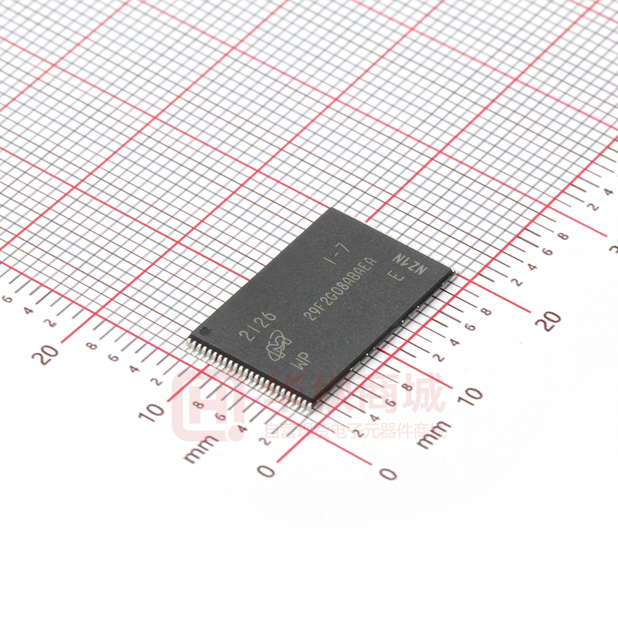

Micron Confidential and Proprietary 2Gb: x8, x16 NAND Flash Memory Features NAND Flash Memory MT29F2G08ABAEAH4, MT29F2G08ABAEAWP, MT29F2G08ABBEAH4 MT29F2G08ABBEAHC, MT29F2G16ABAEAWP, MT29F2G16ABBEAH4 MT29F2G16ABBEAHC • First block (block address 00h) is valid when shipped from factory with ECC. For minimum required ECC, see Error Management. • Block 0 requires 1-bit ECC if PROGRAM/ERASE cycles are less than 1000 • RESET (FFh) required as first command after poweron • Alternate method of device initialization (Nand_Init) after power up (contact factory) • Internal data move operations supported within the plane from which data is read • Quality and reliability – Data retention: 10 years • Operating voltage range – VCC: 2.7–3.6V – VCC: 1.7–1.95V • Operating temperature: – Commercial: 0°C to +70°C – Industrial (IT): –40ºC to +85ºC • Package – 48-pin TSOP type 1, CPL2 – 63-ball VFBGA Features • Open NAND Flash Interface (ONFI) 1.0-compliant1 • Single-level cell (SLC) technology • Organization – Page size x8: 2112 bytes (2048 + 64 bytes) – Page size x16: 1056 words (1024 + 32 words) – Block size: 64 pages (128K + 4K bytes) – Plane size: 2 planes x 1024 blocks per plane – Device size: 2Gb: 2048 blocks • Asynchronous I/O performance – tRC/tWC: 20ns (3.3V), 25ns (1.8V) • Array performance – Read page: 25µs 3 – Program page: 200µs (TYP: 1.8V, 3.3V)3 – Erase block: 700µs (TYP) • Command set: ONFI NAND Flash Protocol • Advanced command set – Program page cache mode4 – Read page cache mode 4 – One-time programmable (OTP) mode – Two-plane commands 4 – Interleaved die (LUN) operations – Read unique ID – Block lock (1.8V only) – Internal data move • Operation status byte provides software method for detecting – Operation completion – Pass/fail condition – Write-protect status • Ready/Busy# (R/B#) signal provides a hardware method of detecting operation completion • WP# signal: Write protect entire device PDF: 09005aef83b83f42 m69a_2gb_nand.pdf – Rev. H 09/10 EN Notes: 1 1. The ONFI 1.0 specification is available at www.onfi.org. 2. CPL = Center parting line. 3. See Electrical Specifications – Program/Erase Characteristics for tR_ECC and tPROG_ECC specifications. 4. These commands supported only with ECC disabled. Micron Technology, Inc. reserves the right to change products or specifications without notice. © 2009 Micron Technology, Inc. All rights reserved. Products and specifications discussed herein are subject to change by Micron without notice. Downloaded from Elcodis.com electronic components distributor Micron Confidential and Proprietary 2Gb: x8, x16 NAND Flash Memory Features Part Numbering Information Micron NAND Flash devices are available in different configurations and densities. Verify valid part numbers by using Micron’s part catalog search at www.micron.com. To compare features and specifications by device type, visit www.micron.com/products. Contact the factory for devices not found. Figure 1: Marketing Part Number Chart MT 29F 2G 08 A B A E A WP xx xx x ES :E Micron Technology Design Revision (shrink) Product Family Production Status 29F = NAND Flash memory Blank = Production ES = Engineering sample Density MS = Mechanical sample 2G = 2Gb QS = Qualification sample Reserved for Future Use Device Width Blank 08 = 8-bit Operating Temperature Range 16 = 16-bit Blank = Commercial (0°C to +70°C) Level IT = Industrial (–40°C to +85°C) A = SLC Speed Grade Classification Mark Die B 1 Blank nCE RnB I/O Channels 1 1 1 Package Code WP = 48-pin TSOP 1 HC = 63-ball VFBGA (10.5 x 13 x 1.0mm) H4 = 63-ball VFBGA (9 x 11 x 1.0mm) Operating Voltage Range A = 3.3V (2.7–3.6V) Interface B = 1.8V (1.7–1.95V) A = Async only Feature Set E = Feature set E PDF: 09005aef83b83f42 m69a_2gb_nand.pdf – Rev. H 09/10 EN Downloaded from Elcodis.com electronic components distributor 2 Micron Technology, Inc. reserves the right to change products or specifications without notice. © 2009 Micron Technology, Inc. All rights reserved. Micron Confidential and Proprietary 2Gb: x8, x16 NAND Flash Memory Features Contents General Description ......................................................................................................................................... 8 Signal Descriptions .......................................................................................................................................... 8 Signal Assignments ........................................................................................................................................... 9 Package Dimensions ...................................................................................................................................... 12 Architecture ................................................................................................................................................... 15 Device and Array Organization ....................................................................................................................... 16 Asynchronous Interface Bus Operation ........................................................................................................... 18 Asynchronous Enable/Standby ................................................................................................................... 18 Asynchronous Commands .......................................................................................................................... 18 Asynchronous Addresses ............................................................................................................................ 20 Asynchronous Data Input ........................................................................................................................... 21 Asynchronous Data Output ........................................................................................................................ 22 Write Protect# ............................................................................................................................................ 23 Ready/Busy# .............................................................................................................................................. 23 Device Initialization ....................................................................................................................................... 28 Command Definitions .................................................................................................................................... 29 Reset Operations ............................................................................................................................................ 32 RESET (FFh) ............................................................................................................................................... 32 Identification Operations ................................................................................................................................ 33 READ ID (90h) ............................................................................................................................................ 33 READ ID Parameter Tables ............................................................................................................................. 34 READ PARAMETER PAGE (ECh) ...................................................................................................................... 36 Parameter Page Data Structure Tables ............................................................................................................. 37 READ UNIQUE ID (EDh) ................................................................................................................................ 41 Feature Operations ......................................................................................................................................... 42 SET FEATURES (EFh) ................................................................................................................................. 43 GET FEATURES (EEh) ................................................................................................................................. 44 Status Operations ........................................................................................................................................... 47 READ STATUS (70h) ................................................................................................................................... 48 READ STATUS ENHANCED (78h) ............................................................................................................... 48 Column Address Operations ........................................................................................................................... 50 RANDOM DATA READ (05h-E0h) ................................................................................................................ 50 RANDOM DATA READ TWO-PLANE (06h-E0h) ........................................................................................... 51 RANDOM DATA INPUT (85h) ..................................................................................................................... 52 PROGRAM FOR INTERNAL DATA INPUT (85h) ........................................................................................... 53 Read Operations ............................................................................................................................................. 55 READ MODE (00h) ..................................................................................................................................... 57 READ PAGE (00h-30h) ................................................................................................................................ 57 READ PAGE CACHE SEQUENTIAL (31h) ..................................................................................................... 58 READ PAGE CACHE RANDOM (00h-31h) .................................................................................................... 59 READ PAGE CACHE LAST (3Fh) .................................................................................................................. 61 READ PAGE TWO-PLANE 00h-00h-30h ....................................................................................................... 62 Program Operations ....................................................................................................................................... 64 PROGRAM PAGE (80h-10h) ........................................................................................................................ 65 PROGRAM PAGE CACHE (80h-15h) ............................................................................................................ 65 PROGRAM PAGE TWO-PLANE (80h-11h) .................................................................................................... 68 Erase Operations ............................................................................................................................................ 70 ERASE BLOCK (60h-D0h) ............................................................................................................................ 70 ERASE BLOCK TWO-PLANE (60h-D1h) ....................................................................................................... 71 Internal Data Move Operations ....................................................................................................................... 72 PDF: 09005aef83b83f42 m69a_2gb_nand.pdf – Rev. H 09/10 EN Downloaded from Elcodis.com electronic components distributor 3 Micron Technology, Inc. reserves the right to change products or specifications without notice. © 2009 Micron Technology, Inc. All rights reserved. Micron Confidential and Proprietary 2Gb: x8, x16 NAND Flash Memory Features READ FOR INTERNAL DATA MOVE (00h-35h) ............................................................................................ 73 PROGRAM FOR INTERNAL DATA MOVE (85h–10h) .................................................................................... 74 PROGRAM FOR INTERNAL DATA MOVE TWO-PLANE (85h-11h) ................................................................ 75 Block Lock Feature ......................................................................................................................................... 76 WP# and Block Lock ................................................................................................................................... 76 UNLOCK (23h-24h) .................................................................................................................................... 76 LOCK (2Ah) ................................................................................................................................................ 79 LOCK TIGHT (2Ch) ..................................................................................................................................... 80 BLOCK LOCK READ STATUS (7Ah) ............................................................................................................. 81 One-Time Programmable (OTP) Operations .................................................................................................... 83 Legacy OTP Commands .............................................................................................................................. 83 OTP DATA PROGRAM (80h-10h) ................................................................................................................. 84 RANDOM DATA INPUT (85h) .................................................................................................................... 85 OTP DATA PROTECT (80h-10) .................................................................................................................... 86 OTP DATA READ (00h-30h) ........................................................................................................................ 88 Two-Plane Operations .................................................................................................................................... 90 Two-Plane Addressing ................................................................................................................................ 90 Interleaved Die (Multi-LUN) Operations ......................................................................................................... 99 Error Management ........................................................................................................................................ 100 Internal ECC and Spare Area Mapping for ECC ............................................................................................... 102 Electrical Specifications ................................................................................................................................. 104 Electrical Specifications – DC Characteristics and Operating Conditions ......................................................... 106 Electrical Specifications – AC Characteristics and Operating Conditions .......................................................... 108 Electrical Specifications – Program/Erase Characteristics ................................................................................ 111 Asynchronous Interface Timing Diagrams ...................................................................................................... 112 Revision History ............................................................................................................................................ 124 Rev. H, Production – 9/10 .......................................................................................................................... 124 Rev. G, Preliminary – 8/10 .......................................................................................................................... 124 Rev. F, Preliminary – 6/10 .......................................................................................................................... 124 Rev. E, Advance – 5/10 ............................................................................................................................... 124 Rev. D, Advance – 3/10 .............................................................................................................................. 124 Rev. C, Advance – 1/10 ............................................................................................................................... 124 Rev. B, Advance – 9/09 ............................................................................................................................... 124 Rev. A, Advance – 7/09 ............................................................................................................................... 124 PDF: 09005aef83b83f42 m69a_2gb_nand.pdf – Rev. H 09/10 EN Downloaded from Elcodis.com electronic components distributor 4 Micron Technology, Inc. reserves the right to change products or specifications without notice. © 2009 Micron Technology, Inc. All rights reserved. Micron Confidential and Proprietary 2Gb: x8, x16 NAND Flash Memory Features List of Tables Table 1: Signal Definitions ............................................................................................................................... 8 Table 2: Array Addressing – MT29F2G08 (x8) .................................................................................................. 16 Table 3: Array Addressing – MT29F2G16 (x16) ................................................................................................ 17 Table 4: Asynchronous Interface Mode Selection ........................................................................................... 18 Table 5: Command Set .................................................................................................................................. 29 Table 6: Two-Plane Command Set ................................................................................................................. 30 Table 7: READ ID Parameters for Address 00h ................................................................................................ 34 Table 8: READ ID Parameters for Address 20h ................................................................................................ 35 Table 9: Parameter Page Data Structure ......................................................................................................... 37 Table 10: Feature Address Definitions ............................................................................................................ 42 Table 11: Feature Address 90h – Array Operation Mode .................................................................................. 43 Table 12: Feature Addresses 01h: Timing Mode .............................................................................................. 45 Table 13: Feature Addresses 80h: Programmable I/O Drive Strength ............................................................... 46 Table 14: Feature Addresses 81h: Programmable R/B# Pull-Down Strength ..................................................... 46 Table 15: Status Register Definition ............................................................................................................... 47 Table 16: Block Lock Address Cycle Assignments ............................................................................................ 78 Table 17: Block Lock Status Register Bit Definitions ........................................................................................ 81 Table 18: Error Management Details ............................................................................................................. 100 Table 19: Absolute Maximum Ratings ........................................................................................................... 104 Table 20: Recommended Operating Conditions ............................................................................................ 104 Table 21: Valid Blocks ................................................................................................................................... 104 Table 22: Capacitance .................................................................................................................................. 105 Table 23: Test Conditions ............................................................................................................................. 105 Table 24: DC Characteristics and Operating Conditions (3.3V) ....................................................................... 106 Table 25: DC Characteristics and Operating Conditions (1.8V) ....................................................................... 107 Table 26: AC Characteristics: Command, Data, and Address Input (3.3V) ........................................................ 108 Table 27: AC Characteristics: Command, Data, and Address Input (1.8V) ........................................................ 108 Table 28: AC Characteristics: Normal Operation (3.3V) .................................................................................. 109 Table 29: AC Characteristics: Normal Operation (1.8V) .................................................................................. 109 Table 30: Program/Erase Characteristics ....................................................................................................... 111 PDF: 09005aef83b83f42 m69a_2gb_nand.pdf – Rev. H 09/10 EN Downloaded from Elcodis.com electronic components distributor 5 Micron Technology, Inc. reserves the right to change products or specifications without notice. © 2009 Micron Technology, Inc. All rights reserved. Micron Confidential and Proprietary 2Gb: x8, x16 NAND Flash Memory Features List of Figures Figure 1: Marketing Part Number Chart ........................................................................................................... 2 Figure 2: 48-Pin TSOP – Type 1, CPL (Top View) ............................................................................................... 9 Figure 3: 63-Ball VFBGA, x8 (Balls Down, Top View) ....................................................................................... 10 Figure 4: 63-Ball VFBGA, x16 (Balls Down, Top View) ...................................................................................... 11 Figure 5: 48-Pin TSOP – Type 1, CPL .............................................................................................................. 12 Figure 6: 63-Ball VFBGA (10.5mm x 13mm) .................................................................................................... 13 Figure 7: 63-Ball VFBGA (9mm x 11mm) ......................................................................................................... 14 Figure 8: NAND Flash Die (LUN) Functional Block Diagram ........................................................................... 15 Figure 9: Array Organization – MT29F2G08 (x8) .............................................................................................. 16 Figure 10: Array Organization – MT29F2G16 (x16) .......................................................................................... 17 Figure 11: Asynchronous Command Latch Cycle ............................................................................................ 19 Figure 12: Asynchronous Address Latch Cycle ................................................................................................ 20 Figure 13: Asynchronous Data Input Cycles ................................................................................................... 21 Figure 14: Asynchronous Data Output Cycles ................................................................................................. 22 Figure 15: Asynchronous Data Output Cycles (EDO Mode) ............................................................................. 23 Figure 16: READ/BUSY# Open Drain ............................................................................................................. 24 Figure 17: tFall and tRise (3.3V VCC) ................................................................................................................ 25 Figure 18: tFall and tRise (1.8V VCC) ................................................................................................................ 25 Figure 19: IOL vs. Rp (VCC = 3.3V VCC) .............................................................................................................. 26 Figure 20: IOL vs. Rp (1.8V VCC) ....................................................................................................................... 26 Figure 21: TC vs. Rp ....................................................................................................................................... 27 Figure 22: R/B# Power-On Behavior ............................................................................................................... 28 Figure 23: RESET (FFh) Operation ................................................................................................................. 32 Figure 24: READ ID (90h) with 00h Address Operation .................................................................................... 33 Figure 25: READ ID (90h) with 20h Address Operation .................................................................................... 33 Figure 26: READ PARAMETER (ECh) Operation .............................................................................................. 36 Figure 27: READ UNIQUE ID (EDh) Operation ............................................................................................... 41 Figure 28: SET FEATURES (EFh) Operation .................................................................................................... 43 Figure 29: GET FEATURES (EEh) Operation ................................................................................................... 44 Figure 30: READ STATUS (70h) Operation ...................................................................................................... 48 Figure 31: READ STATUS ENHANCED (78h) Operation .................................................................................. 49 Figure 32: RANDOM DATA READ (05h-E0h) Operation .................................................................................. 50 Figure 33: RANDOM DATA READ TWO-PLANE (06h-E0h) Operation .............................................................. 51 Figure 34: RANDOM DATA INPUT (85h) Operation ........................................................................................ 52 Figure 35: PROGRAM FOR INTERNAL DATA INPUT (85h) Operation .............................................................. 54 Figure 36: READ PAGE (00h-30h) Operation ................................................................................................... 58 Figure 37: READ PAGE (00h-30h) Operation with Internal ECC Enabled .......................................................... 58 Figure 38: READ PAGE CACHE SEQUENTIAL (31h) Operation ........................................................................ 59 Figure 39: READ PAGE CACHE RANDOM (00h-31h) Operation ....................................................................... 60 Figure 40: READ PAGE CACHE LAST (3Fh) Operation ..................................................................................... 61 Figure 41: READ PAGE TWO-PLANE (00h-00h-30h) Operation ....................................................................... 63 Figure 42: PROGRAM PAGE (80h-10h) Operation ........................................................................................... 65 Figure 43: PROGRAM PAGE CACHE (80h–15h) Operation (Start) .................................................................... 67 Figure 44: PROGRAM PAGE CACHE (80h–15h) Operation (End) ..................................................................... 67 Figure 45: PROGRAM PAGE TWO-PLANE (80h–11h) Operation ...................................................................... 69 Figure 46: ERASE BLOCK (60h-D0h) Operation .............................................................................................. 70 Figure 47: ERASE BLOCK TWO-PLANE (60h–D1h) Operation ......................................................................... 71 Figure 48: READ FOR INTERNAL DATA MOVE (00h-35h) Operation ............................................................... 73 Figure 49: READ FOR INTERNAL DATA MOVE (00h–35h) with RANDOM DATA READ (05h–E0h) ................... 73 Figure 50: INTERNAL DATA MOVE (85h-10h) with Internal ECC Enabled ....................................................... 74 PDF: 09005aef83b83f42 m69a_2gb_nand.pdf – Rev. H 09/10 EN Downloaded from Elcodis.com electronic components distributor 6 Micron Technology, Inc. reserves the right to change products or specifications without notice. © 2009 Micron Technology, Inc. All rights reserved. Micron Confidential and Proprietary 2Gb: x8, x16 NAND Flash Memory Features Figure 51: INTERNAL DATA MOVE (85h-10h) with RANDOM DATA INPUT with Internal ECC Enabled ........... 74 Figure 52: PROGRAM FOR INTERNAL DATA MOVE (85h–10h) Operation ....................................................... 74 Figure 53: PROGRAM FOR INTERNAL DATA MOVE (85h-10h) with RANDOM DATA INPUT (85h) .................. 75 Figure 54: PROGRAM FOR INTERNAL DATA MOVE TWO-PLANE (85h-11h) Operation ................................... 75 Figure 55: Flash Array Protected: Invert Area Bit = 0 ........................................................................................ 77 Figure 56: Flash Array Protected: Invert Area Bit = 1 ........................................................................................ 77 Figure 57: UNLOCK Operation ...................................................................................................................... 78 Figure 58: LOCK Operation ............................................................................................................................ 79 Figure 59: LOCK TIGHT Operation ................................................................................................................ 80 Figure 60: PROGRAM/ERASE Issued to Locked Block ..................................................................................... 81 Figure 61: BLOCK LOCK READ STATUS ......................................................................................................... 81 Figure 62: BLOCK LOCK Flowchart ................................................................................................................ 82 Figure 63: OTP DATA PROGRAM (After Entering OTP Operation Mode) .......................................................... 85 Figure 64: OTP DATA PROGRAM Operation with RANDOM DATA INPUT (After Entering OTP Operation Mode) ........................................................................................................................................................ 86 Figure 65: OTP DATA PROTECT Operation (After Entering OTP Protect Mode) ................................................ 87 Figure 66: OTP DATA READ .......................................................................................................................... 88 Figure 67: OTP DATA READ with RANDOM DATA READ Operation ................................................................ 89 Figure 68: TWO-PLANE PAGE READ .............................................................................................................. 91 Figure 69: TWO-PLANE PAGE READ with RANDOM DATA READ ................................................................... 92 Figure 70: TWO-PLANE PROGRAM PAGE ...................................................................................................... 92 Figure 71: TWO-PLANE PROGRAM PAGE with RANDOM DATA INPUT .......................................................... 93 Figure 72: TWO-PLANE PROGRAM PAGE CACHE MODE ............................................................................... 94 Figure 73: TWO-PLANE INTERNAL DATA MOVE ........................................................................................... 95 Figure 74: TWO-PLANE INTERNAL DATA MOVE with TWO-PLANE RANDOM DATA READ ............................ 96 Figure 75: TWO-PLANE INTERNAL DATA MOVE with RANDOM DATA INPUT ............................................... 97 Figure 76: TWO-PLANE BLOCK ERASE .......................................................................................................... 98 Figure 77: TWO-PLANE/MULTIPLE-DIE READ STATUS Cycle ........................................................................ 98 Figure 78: Spare Area Mapping (x8) ............................................................................................................... 102 Figure 79: Spare Area Mapping (x16) ............................................................................................................. 103 Figure 80: RESET Operation ......................................................................................................................... 112 Figure 81: READ STATUS Cycle ..................................................................................................................... 112 Figure 82: READ STATUS ENHANCED Cycle ................................................................................................. 113 Figure 83: READ PARAMETER PAGE ............................................................................................................. 113 Figure 84: READ PAGE ................................................................................................................................. 114 Figure 85: READ PAGE Operation with CE# “Don’t Care” ............................................................................... 115 Figure 86: RANDOM DATA READ ................................................................................................................. 116 Figure 87: READ PAGE CACHE SEQUENTIAL ................................................................................................ 117 Figure 88: READ PAGE CACHE RANDOM ..................................................................................................... 118 Figure 89: READ ID Operation ...................................................................................................................... 119 Figure 90: PROGRAM PAGE Operation .......................................................................................................... 119 Figure 91: PROGRAM PAGE Operation with CE# “Don’t Care” ....................................................................... 120 Figure 92: PROGRAM PAGE Operation with RANDOM DATA INPUT ............................................................. 120 Figure 93: PROGRAM PAGE CACHE .............................................................................................................. 121 Figure 94: PROGRAM PAGE CACHE Ending on 15h ....................................................................................... 121 Figure 95: INTERNAL DATA MOVE ............................................................................................................... 122 Figure 96: INTERNAL DATA MOVE (85h-10h) with Internal ECC Enabled ...................................................... 122 Figure 97: INTERNAL DATA MOVE (85h-10h) with Random Data Input with Internal ECC Enabled ................ 123 Figure 98: ERASE BLOCK Operation .............................................................................................................. 123 PDF: 09005aef83b83f42 m69a_2gb_nand.pdf – Rev. H 09/10 EN Downloaded from Elcodis.com electronic components distributor 7 Micron Technology, Inc. reserves the right to change products or specifications without notice. © 2009 Micron Technology, Inc. All rights reserved. Micron Confidential and Proprietary 2Gb: x8, x16 NAND Flash Memory General Description General Description Micron NAND Flash devices include an asynchronous data interface for high-performance I/O operations. These devices use a highly multiplexed 8-bit bus (I/Ox) to transfer commands, address, and data. There are five control signals used to implement the asynchronous data interface: CE#, CLE, ALE, WE#, and RE#. Additional signals control hardware write protection and monitor device status (R/B#). This hardware interface creates a low pin-count device with a standard pinout that remains the same from one density to another, enabling future upgrades to higher densities with no board redesign. A target is the unit of memory accessed by a chip enable signal. A target contains one or more NAND Flash die. A NAND Flash die is the minimum unit that can independently execute commands and report status. A NAND Flash die, in the ONFI specification, is referred to as a logical unit (LUN). There is at least one NAND Flash die per chip enable signal. For further details, see Device and Array Organization. This device has an internal 4-bit ECC that can be enabled using the GET/SET features or by factory (always enabled). See Internal ECC and Spare Area Mapping for ECC for more information. Signal Descriptions Table 1: Signal Definitions Signal1 Type Description2 ALE Input Address latch enable: Loads an address from I/O[7:0] into the address register. CE# Input Chip enable: Enables or disables one or more die (LUNs) in a target. CLE Input Command latch enable: Loads a command from I/O[7:0] into the command register. LOCK Input When LOCK is HIGH during power-up, the BLOCK LOCK function is enabled. To disable the BLOCK LOCK, connect LOCK to VSS during power-up, or leave it disconnected (internal pulldown). RE# Input Read enable: Transfers serial data from the NAND Flash to the host system. WE# Input Write enable: Transfers commands, addresses, and serial data from the host system to the NAND Flash. Write protect: Enables or disables array PROGRAM and ERASE operations. WP# Input I/O[7:0] (x8) I/O[15:0] (x16) I/O R/B# Output Ready/busy: An open-drain, active-low output that requires an external pull-up resistor. This signal indicates target array activity. VCC Supply VCC: Core power supply VSS Supply VSS: Core ground connection NC – No connect: NCs are not internally connected. They can be driven or left unconnected. DNU – Do not use: DNUs must be left unconnected. Notes: Data inputs/outputs: The bidirectional I/Os transfer address, data, and command information. 1. See Device and Array Organization for detailed signal connections. 2. See Asynchronous Interface Bus Operation for detailed asynchronous interface signal descriptions. PDF: 09005aef83b83f42 m69a_2gb_nand.pdf – Rev. H 09/10 EN Downloaded from Elcodis.com electronic components distributor 8 Micron Technology, Inc. reserves the right to change products or specifications without notice. © 2009 Micron Technology, Inc. All rights reserved. Micron Confidential and Proprietary 2Gb: x8, x16 NAND Flash Memory Signal Assignments Signal Assignments Figure 2: 48-Pin TSOP – Type 1, CPL (Top View) x16 x8 NC NC NC NC NC NC R/B# RE# CE# NC NC Vcc Vss NC NC CLE ALE WE# WP# NC NC NC NC NC NC NC NC NC NC NC R/B# RE# CE# NC NC Vcc Vss NC NC CLE ALE WE# WP# NC NC NC NC NC Notes: 48 47 46 45 44 43 42 41 40 39 38 37 36 35 34 33 32 31 30 29 28 27 26 25 1 2 3 4 5 6 7 8 9 10 11 12 13 14 15 16 17 18 19 20 21 22 23 24 x8 x16 Vss1 DNU NC NC I/O7 I/O6 I/O5 I/O4 NC Vcc1 DNU2 Vcc Vss NC Vcc1 NC I/O3 I/O2 I/O1 I/O0 NC NC NC Vss1 Vss I/O15 I/O14 I/O13 I/O7 I/O6 I/O5 I/O4 I/O12 Vcc DNU2 Vcc Vss NC Vcc I/O11 I/O3 I/O2 I/O1 I/O0 I/O10 I/O9 I/O8 Vss 1. These pins might not be bonded in the package; however, Micron recommends that the customer connect these pins to the designated external sources for ONFI compatibility. 2. For the 3V device, pin 38 is DNU. For the 1.8V device, pin 38 is LOCK. PDF: 09005aef83b83f42 m69a_2gb_nand.pdf – Rev. H 09/10 EN Downloaded from Elcodis.com electronic components distributor 9 Micron Technology, Inc. reserves the right to change products or specifications without notice. © 2009 Micron Technology, Inc. All rights reserved. Micron Confidential and Proprietary 2Gb: x8, x16 NAND Flash Memory Signal Assignments Figure 3: 63-Ball VFBGA, x8 (Balls Down, Top View) 1 2 A NC NC B NC 3 4 6 5 7 8 C WP# ALE Vss CE# WE# R/B# D Vcc2 RE# CLE NC NC NC E NC NC NC NC NC NC F NC NC NC NC Vss2 NC G DNU Vcc2 LOCK1 NC NC DNU H NC I/O0 NC NC NC Vcc J NC I/O1 NC Vcc I/O5 I/O7 K Vss I/O2 I/O3 I/O4 I/O6 Vss 9 10 NC NC NC NC L NC NC NC NC M NC NC NC NC Notes: 1. For the 3V device, G5 changes to DNU. NO LOCK function is available on the 3.3V device. 2. These pins might not be bonded in the package; however, Micron recommends that the customer connect these pins to the designated external sources for ONFI compatibility. PDF: 09005aef83b83f42 m69a_2gb_nand.pdf – Rev. H 09/10 EN Downloaded from Elcodis.com electronic components distributor 10 Micron Technology, Inc. reserves the right to change products or specifications without notice. © 2009 Micron Technology, Inc. All rights reserved. Micron Confidential and Proprietary 2Gb: x8, x16 NAND Flash Memory Signal Assignments Figure 4: 63-Ball VFBGA, x16 (Balls Down, Top View) 1 2 A NC NC B NC 3 4 6 5 7 8 C WP# ALE Vss CE# WE# R/B# D Vcc RE# CLE NC NC NC E NC NC NC NC NC NC F NC NC NC NC Vss NC G DNU Vcc LOCK1 I/O13 I/O15 DNU H I/O8 I/O0 I/O10 I/O12 I/O14 Vcc J I/O9 I/O1 I/O11 Vcc I/O5 I/O7 K Vss I/O2 I/O3 I/O4 I/O6 Vss 9 10 NC NC NC NC L NC NC NC NC M NC NC NC NC Note: 1. For the 3V device, G5 changes to DNU. NO LOCK function is available on the 3.3V device. PDF: 09005aef83b83f42 m69a_2gb_nand.pdf – Rev. H 09/10 EN Downloaded from Elcodis.com electronic components distributor 11 Micron Technology, Inc. reserves the right to change products or specifications without notice. © 2009 Micron Technology, Inc. All rights reserved. Micron Confidential and Proprietary 2Gb: x8, x16 NAND Flash Memory Package Dimensions Package Dimensions Figure 5: 48-Pin TSOP – Type 1, CPL 20.00 ±0.25 18.40 ±0.08 48 0.25 for reference only 0.50 TYP for reference only 1 Mold compound: Epoxy novolac Plated lead finish: 100% Sn Package width and length do not include mold protrusion. Allowable protrusion is 0.25 per side. 12.00 ±0.08 0.27 MAX 0.17 MIN 24 25 0.25 0.10 0.15 +0.03 -0.02 Gage plane See detail A 1.20 MAX 0.10 +0.10 -0.05 0.50 ±0.1 0.80 Detail A Note: 1. All dimensions are in millimeters. PDF: 09005aef83b83f42 m69a_2gb_nand.pdf – Rev. H 09/10 EN Downloaded from Elcodis.com electronic components distributor 12 Micron Technology, Inc. reserves the right to change products or specifications without notice. © 2009 Micron Technology, Inc. All rights reserved. Micron Confidential and Proprietary 2Gb: x8, x16 NAND Flash Memory Package Dimensions Figure 6: 63-Ball VFBGA (10.5mm x 13mm) 0.65 ±0.05 Seating plane 0.12 A A 63X Ø0.45 Solder ball material: SAC305 (96.5% Sn, 3% Ag, 0.5% Cu). Dimensions apply to solder balls postreflow on Ø0.4 SMD ball pads. 10 9 8 7 6 5 4 3 2 Ball A1 ID 1 Ball A1 ID A B C D E F 8.8 CTR G 13 ±0.1 H J K L 0.8 TYP M 0.8 TYP 1.0 MAX 7.2 CTR 0.25 MIN Bottom side saw fiducials may or may not be covered with soldermask. 10.5 ±0.1 Note: 1. All dimensions are in millimeters. PDF: 09005aef83b83f42 m69a_2gb_nand.pdf – Rev. H 09/10 EN Downloaded from Elcodis.com electronic components distributor 13 Micron Technology, Inc. reserves the right to change products or specifications without notice. © 2009 Micron Technology, Inc. All rights reserved. Micron Confidential and Proprietary 2Gb: x8, x16 NAND Flash Memory Package Dimensions Figure 7: 63-Ball VFBGA (9mm x 11mm) Seating plane 0.12 A 0.65 ±0.05 A 63X Ø0.45 Solder ball material: SAC305. Dimensions apply to solder balls post- 10 9 reflow on Ø0.4 SMD ball pads. Ball A1 ID 8 7 6 5 4 3 2 Ball A1 ID 1 A B C D E F 8.8 CTR G 11 ±0.1 H J K L 0.8 TYP M 1.0 MAX 0.8 TYP 0.25 MIN 7.2 CTR 9 ±0.1 Note: 1. All dimensions are in millimeters. PDF: 09005aef83b83f42 m69a_2gb_nand.pdf – Rev. H 09/10 EN Downloaded from Elcodis.com electronic components distributor 14 Micron Technology, Inc. reserves the right to change products or specifications without notice. © 2009 Micron Technology, Inc. All rights reserved. Micron Confidential and Proprietary 2Gb: x8, x16 NAND Flash Memory Architecture Architecture These devices use NAND Flash electrical and command interfaces. Data, commands, and addresses are multiplexed onto the same pins and received by I/O control circuits. The commands received at the I/O control circuits are latched by a command register and are transferred to control logic circuits for generating internal signals to control device operations. The addresses are latched by an address register and sent to a row decoder to select a row address, or to a column decoder to select a column address. Data is transferred to or from the NAND Flash memory array, byte by byte (x8) or word by word (x16), through a data register and a cache register. The NAND Flash memory array is programmed and read using page-based operations and is erased using block-based operations. During normal page operations, the data and cache registers act as a single register. During cache operations, the data and cache registers operate independently to increase data throughput. The status register reports the status of die operations. Figure 8: NAND Flash Die (LUN) Functional Block Diagram VCC I/Ox I/O control VSS Address register Status register Command register CE# Column decode CLE WE# Control logic Row decode ALE RE# WP# LOCK1 NAND Flash array (2 planes) Data register R/B# Cache register ECC Note: 1. The LOCK pin is used on the 1.8V device. PDF: 09005aef83b83f42 m69a_2gb_nand.pdf – Rev. H 09/10 EN Downloaded from Elcodis.com electronic components distributor 15 Micron Technology, Inc. reserves the right to change products or specifications without notice. © 2009 Micron Technology, Inc. All rights reserved. Micron Confidential and Proprietary 2Gb: x8, x16 NAND Flash Memory Device and Array Organization Device and Array Organization Figure 9: Array Organization – MT29F2G08 (x8) 2112 bytes 2112 bytes DQ7 Cache Register 2048 64 2048 64 Data Register 2048 64 2048 64 1024 blocks per plane 1 block DQ0 1 page = (2K + 64 bytes) 1 block = (2K + 64) bytes x 64 pages = (128K + 4K) bytes 1 plane = (128K + 4K) bytes x 1024 blocks = 1056Mb 1 block 2048 blocks per device 1 device = 1056Mb x 2 planes = 2112Mb Plane of even-numbered blocks (0, 2, 4, 6, ..., 2044, 2046) Plane of odd-numbered blocks (1, 3, 5, 7, ..., 2045, 2047) Table 2: Array Addressing – MT29F2G08 (x8) Cycle I/07 I/06 I/05 I/04 I/03 I/02 I/01 I/00 First CA7 CA6 CA5 CA4 CA3 CA2 CA1 CA0 Second LOW LOW LOW LOW CA11 CA10 CA9 CA8 Third BA7 BA6 PA5 PA4 PA3 PA2 PA1 PA0 Fourth BA15 BA14 BA13 BA12 BA11 BA10 BA9 BA8 Fifth LOW LOW LOW LOW LOW LOW LOW BA16 Notes: 1. Block address concatenated with page address = actual page address. CAx = column address; PAx = page address; BAx = block address. 2. If CA11 is 1, then CA[10:6] must be 0. 3. BA6 controls plane selection. PDF: 09005aef83b83f42 m69a_2gb_nand.pdf – Rev. H 09/10 EN Downloaded from Elcodis.com electronic components distributor 16 Micron Technology, Inc. reserves the right to change products or specifications without notice. © 2009 Micron Technology, Inc. All rights reserved. Micron Confidential and Proprietary 2Gb: x8, x16 NAND Flash Memory Device and Array Organization Figure 10: Array Organization – MT29F2G16 (x16) 1056 words 1056 words DQ15 Cache Register 1024 32 1024 32 Data Register 1024 32 1024 32 1024 blocks per plane 1 block DQ0 1 page = (1K + 32 words) 1 block = (1K + 32) words x 64 pages = (64K + 2K) words 1 plane = (64K + 2K) words x 1024 blocks = 1056Mb 1 device = 1056Mb x 2 planes = 2112Mb 1 block 2048 blocks per device Plane of even-numbered blocks (0, 2, 4, 6, ..., 2044, 2046) Plane of odd-numbered blocks (1, 3, 5, 7, ..., 2045, 2047) Table 3: Array Addressing – MT29F2G16 (x16) Cycle I/O[15:8] I/07 I/06 I/05 I/04 I/03 I/02 I/01 I/00 First LOW CA7 CA6 CA5 CA4 CA3 CA2 CA1 CA0 Second LOW LOW LOW LOW LOW LOW CA10 CA9 CA8 Third LOW BA7 BA6 PA5 PA4 PA3 PA2 PA1 PA0 Fourth LOW BA15 BA14 BA13 BA12 BA11 BA10 BA9 BA8 Fifth LOW LOW LOW LOW LOW LOW LOW LOW BA16 Notes: 1. Block address concatenated with page address = actual page address. CAx = column address; PAx = page address; BAx = block address. 2. If CA10 = 1, then CA[9:5] must be 0. 3. BA6 controls plane selection. PDF: 09005aef83b83f42 m69a_2gb_nand.pdf – Rev. H 09/10 EN Downloaded from Elcodis.com electronic components distributor 17 Micron Technology, Inc. reserves the right to change products or specifications without notice. © 2009 Micron Technology, Inc. All rights reserved. Micron Confidential and Proprietary 2Gb: x8, x16 NAND Flash Memory Asynchronous Interface Bus Operation Asynchronous Interface Bus Operation The bus on the device is multiplexed. Data I/O, addresses, and commands all share the same pins. I/O[15:8] are used only for data in the x16 configuration. Addresses and commands are always supplied on I/O[7:0]. The command sequence typically consists of a COMMAND LATCH cycle, address input cycles, and one or more data cycles, either READ or WRITE. Table 4: Asynchronous Interface Mode Selection Mode1 CE# CLE ALE WE# RE# I/Ox WP# Standby2 H X X X X X 0V/VCC Command input L H L H X H Address input L L H H X H Data input L L L H X H Data output L L L H X X Write protect X X X X X L Notes: X 1. Mode selection settings for this table: H = Logic level HIGH; L = Logic level LOW; X = VIH or VIL. 2. WP# should be biased to CMOS LOW or HIGH for standby. Asynchronous Enable/Standby When the device is not performing an operation, the CE# pin is typically driven HIGH and the device enters standby mode. The memory will enter standby if CE# goes HIGH while data is being transferred and the device is not busy. This helps reduce power consumption. The CE# “Don’t Care” operation enables the NAND Flash to reside on the same asynchronous memory bus as other Flash or SRAM devices. Other devices on the memory bus can then be accessed while the NAND Flash is busy with internal operations. This capability is important for designs that require multiple NAND Flash devices on the same bus. A HIGH CLE signal indicates that a command cycle is taking place. A HIGH ALE signal signifies that an ADDRESS INPUT cycle is occurring. Asynchronous Commands An asynchronous command is written from I/O[7:0] to the command register on the rising edge of WE# when CE# is LOW, ALE is LOW, CLE is HIGH, and RE# is HIGH. Commands are typically ignored by die (LUNs) that are busy (RDY = 0); however, some commands, including READ STATUS (70h) and READ STATUS ENHANCED (78h), are accepted by die (LUNs) even when they are busy. For devices with a x16 interface, I/O[15:8] must be written with zeros when a command is issued. PDF: 09005aef83b83f42 m69a_2gb_nand.pdf – Rev. H 09/10 EN Downloaded from Elcodis.com electronic components distributor 18 Micron Technology, Inc. reserves the right to change products or specifications without notice. © 2009 Micron Technology, Inc. All rights reserved. Micron Confidential and Proprietary 2Gb: x8, x16 NAND Flash Memory Asynchronous Interface Bus Operation Figure 11: Asynchronous Command Latch Cycle CLE tCLS tCS tCLH tCH CE# tWP WE# tALS tALH tDS tDH ALE I/Ox COMMAND Don’t Care PDF: 09005aef83b83f42 m69a_2gb_nand.pdf – Rev. H 09/10 EN Downloaded from Elcodis.com electronic components distributor 19 Micron Technology, Inc. reserves the right to change products or specifications without notice. © 2009 Micron Technology, Inc. All rights reserved. Micron Confidential and Proprietary 2Gb: x8, x16 NAND Flash Memory Asynchronous Interface Bus Operation Asynchronous Addresses An asynchronous address is written from I/O[7:0] to the address register on the rising edge of WE# when CE# is LOW, ALE is HIGH, CLE is LOW, and RE# is HIGH. Bits that are not part of the address space must be LOW (see Device and Array Organization). The number of cycles required for each command varies. Refer to the command descriptions to determine addressing requirements. Addresses are typically ignored by die (LUNs) that are busy (RDY = 0); however, some addresses are accepted by die (LUNs) even when they are busy; for example, like address cycles that follow the READ STATUS ENHANCED (78h) command. Figure 12: Asynchronous Address Latch Cycle CLE tCLS tCS CE# tWP tWC tWH WE# tALS tALH ALE tDS tDH I/Ox Col add 1 Col add 2 Row add 1 Row add 2 Don’t Care PDF: 09005aef83b83f42 m69a_2gb_nand.pdf – Rev. H 09/10 EN Downloaded from Elcodis.com electronic components distributor 20 Row add 3 Undefined Micron Technology, Inc. reserves the right to change products or specifications without notice. © 2009 Micron Technology, Inc. All rights reserved. Micron Confidential and Proprietary 2Gb: x8, x16 NAND Flash Memory Asynchronous Interface Bus Operation Asynchronous Data Input Data is written from I/O[7:0] to the cache register of the selected die (LUN) on the rising edge of WE# when CE# is LOW, ALE is LOW, CLE is LOW, and RE# is HIGH. Data input is ignored by die (LUNs) that are not selected or are busy (RDY = 0). Data is written to the data register on the rising edge of WE# when CE#, CLE, and ALE are LOW, and the device is not busy. Data is input on I/O[7:0] on x8 devices and on I/O[15:0] on x16 devices. Figure 13: Asynchronous Data Input Cycles CLE tCLH CE# tALS tCH ALE tWC tWP tWP tWP WE# tWH tDS I/Ox tDH DIN M tDS tDH DIN M+1 tDS tDH DIN N Don’t Care PDF: 09005aef83b83f42 m69a_2gb_nand.pdf – Rev. H 09/10 EN Downloaded from Elcodis.com electronic components distributor 21 Micron Technology, Inc. reserves the right to change products or specifications without notice. © 2009 Micron Technology, Inc. All rights reserved. Micron Confidential and Proprietary 2Gb: x8, x16 NAND Flash Memory Asynchronous Interface Bus Operation Asynchronous Data Output Data can be output from a die (LUN) if it is in a READY state. Data output is supported following a READ operation from the NAND Flash array. Data is output from the cache register of the selected die (LUN) to I/O[7:0] on the falling edge of RE# when CE# is LOW, ALE is LOW, CLE is LOW, and WE# is HIGH. If the host controller is using a tRC of 30ns or greater, the host can latch the data on the rising edge of RE# (see the figure below for proper timing). If the host controller is using a tRC of less than 30ns, the host can latch the data on the next falling edge of RE#. Using the READ STATUS ENHANCED (78h) command prevents data contention following an interleaved die (multi-LUN) operation. After issuing the READ STATUS ENHANCED (78h) command, to enable data output, issue the READ MODE (00h) command. Data output requests are typically ignored by a die (LUN) that is busy (RDY = 0); however, it is possible to output data from the status register even when a die (LUN) is busy by first issuing the READ STATUS or READ STATUS ENHANCED (78h) command. Figure 14: Asynchronous Data Output Cycles tCEA CE# tREA tREA tRP tCHZ tREA tREH tCOH RE# tRHZ tRHZ tRHOH DOUT I/Ox tRR DOUT DOUT tRC RDY Don’t Care PDF: 09005aef83b83f42 m69a_2gb_nand.pdf – Rev. H 09/10 EN Downloaded from Elcodis.com electronic components distributor 22 Micron Technology, Inc. reserves the right to change products or specifications without notice. © 2009 Micron Technology, Inc. All rights reserved. Micron Confidential and Proprietary 2Gb: x8, x16 NAND Flash Memory Asynchronous Interface Bus Operation Figure 15: Asynchronous Data Output Cycles (EDO Mode) CE# tRC tRP tCHZ tREH tCOH RE# tREA tCEA I/Ox tREA tRHZ tRLOH tRHOH DOUT DOUT DOUT tRR RDY Don’t Care Write Protect# The write protect# (WP#) signal enables or disables PROGRAM and ERASE operations to a target. When WP# is LOW, PROGRAM and ERASE operations are disabled. When WP# is HIGH, PROGRAM and ERASE operations are enabled. It is recommended that the host drive WP# LOW during power-on until VCC is stable to prevent inadvertent PROGRAM and ERASE operations (see Device Initialization for additional details). WP# must be transitioned only when the target is not busy and prior to beginning a command sequence. After a command sequence is complete and the target is ready, WP# can be transitioned. After WP# is transitioned, the host must wait tWW before issuing a new command. The WP# signal is always an active input, even when CE# is HIGH. This signal should not be multiplexed with other signals. Ready/Busy# The ready/busy# (R/B#) signal provides a hardware method of indicating whether a target is ready or busy. A target is busy when one or more of its die (LUNs) are busy (RDY = 0). A target is ready when all of its die (LUNs) are ready (RDY = 1). Because each die (LUN) contains a status register, it is possible to determine the independent status of each die (LUN) by polling its status register instead of using the R/B# signal (see Status Operations for details regarding die (LUN) status). This signal requires a pull-up resistor, Rp, for proper operation. R/B# is HIGH when the target is ready, and transitions LOW when the target is busy. The signal's open-drain PDF: 09005aef83b83f42 m69a_2gb_nand.pdf – Rev. H 09/10 EN Downloaded from Elcodis.com electronic components distributor 23 Micron Technology, Inc. reserves the right to change products or specifications without notice. © 2009 Micron Technology, Inc. All rights reserved. Micron Confidential and Proprietary 2Gb: x8, x16 NAND Flash Memory Asynchronous Interface Bus Operation driver enables multiple R/B# outputs to be OR-tied. Typically, R/B# is connected to an interrupt pin on the system controller. The combination of Rp and capacitive loading of the R/B# circuit determines the rise time of the R/B# signal. The actual value used for Rp depends on the system timing requirements. Large values of Rp cause R/B# to be delayed significantly. Between the 10% and 90% points on the R/B# waveform, the rise time is approximately two time constants (TC). TC = R × C Where R = Rp (resistance of pull-up resistor), and C = total capacitive load. The fall time of the R/B# signal is determined mainly by the output impedance of the R/B# signal and the total load capacitance. Approximate Rp values using a circuit load of 100pF are provided in Figure 21 (page 27). The minimum value for Rp is determined by the output drive capability of the R/B# signal, the output voltage swing, and VCC. V (MAX) - VOL (MAX) Rp = CC IOL + ΣIL Where ΣIL is the sum of the input currents of all devices tied to the R/B# pin. Figure 16: READ/BUSY# Open Drain Rp VCC R/B# Open drain output IOL VSS Device PDF: 09005aef83b83f42 m69a_2gb_nand.pdf – Rev. H 09/10 EN Downloaded from Elcodis.com electronic components distributor 24 Micron Technology, Inc. reserves the right to change products or specifications without notice. © 2009 Micron Technology, Inc. All rights reserved. Micron Confidential and Proprietary 2Gb: x8, x16 NAND Flash Memory Asynchronous Interface Bus Operation Figure 17: tFall and tRise (3.3V VCC) 3.50 3.00 2.50 V tFall tRise 2.00 1.50 1.00 0.50 0.00 –1 0 2 4 0 2 4 TC 6 VCC 3.3V 1. tFall and tRise calculated at 10% and 90% points. 2. tRise dependent on external capacitance and resistive loading and output transistor impedance. 3. tRise primarily dependent on external pull-up resistor and external capacitive loading. 4. tFall = 10ns at 3.3V. 5. See TC values in Figure 21 (page 27) for approximate Rp value and TC. Notes: Figure 18: tFall and tRise (1.8V VCC) 3.50 3.00 2.50 V tFall 2.00 tRise 1.50 1.00 0.50 0.00 -1 0 2 4 0 TC Notes: 1. 2. 3. 4. 2 4 6 VCC1.8V tFall and tRise are calculated at 10% and 90% points. is primarily dependent on external pull-up resistor and external capacitive loading. tFall ≈ 7ns at 1.8V. See TC values in Figure 21 (page 27) for TC and approximate Rp value. tRise PDF: 09005aef83b83f42 m69a_2gb_nand.pdf – Rev. H 09/10 EN Downloaded from Elcodis.com electronic components distributor 25 Micron Technology, Inc. reserves the right to change products or specifications without notice. © 2009 Micron Technology, Inc. All rights reserved. Micron Confidential and Proprietary 2Gb: x8, x16 NAND Flash Memory Asynchronous Interface Bus Operation Figure 19: IOL vs. Rp (VCC = 3.3V VCC) 3.50 3.00 2.50 2.00 I (mA) 1.50 1.00 0.50 0.00 0 2000 400 0 6000 8000 10,000 12,000 Rp (Ω) IOL at VCC (MAX) Figure 20: IOL vs. Rp (1.8V VCC) 3.50 3.00 2.50 2.00 I (mA) 1.50 1.00 0.50 0.00 0 2000 4000 6000 8000 10,000 12,000 Rp (Ω) IOL at VCC (MAX) PDF: 09005aef83b83f42 m69a_2gb_nand.pdf – Rev. H 09/10 EN Downloaded from Elcodis.com electronic components distributor 26 Micron Technology, Inc. reserves the right to change products or specifications without notice. © 2009 Micron Technology, Inc. All rights reserved. Micron Confidential and Proprietary 2Gb: x8, x16 NAND Flash Memory Asynchronous Interface Bus Operation Figure 21: TC vs. Rp 1200 1000 800 T(ns) 600 400 200 0 0 2000 4000 6000 8000 Rp (Ω) PDF: 09005aef83b83f42 m69a_2gb_nand.pdf – Rev. H 09/10 EN Downloaded from Elcodis.com electronic components distributor 27 10,000 12,000 IOL at VCC (MAX) RC = TC C = 100pF Micron Technology, Inc. reserves the right to change products or specifications without notice. © 2009 Micron Technology, Inc. All rights reserved. Micron Confidential and Proprietary 2Gb: x8, x16 NAND Flash Memory Device Initialization Device Initialization Micron NAND Flash devices are designed to prevent data corruption during power transitions. VCC is internally monitored. (The WP# signal supports additional hardware protection during power transitions.) When ramping VCC, use the following procedure to initialize the device: 1. Ramp VCC. 2. The host must wait for R/B# to be valid and HIGH before issuing RESET (FFh) to any target. The R/B# signal becomes valid when 50µs has elapsed since the beginning the VCC ramp, and 10µs has elapsed since VCC reaches VCC (MIN). 3. If not monitoring R/B#, the host must wait at least 100µs after VCC reaches VCC (MIN). If monitoring R/B#, the host must wait until R/B# is HIGH. 4. The asynchronous interface is active by default for each target. Each LUN draws less than an average of 10mA (IST) measured over intervals of 1ms until the RESET (FFh) command is issued. 5. The RESET (FFh) command must be the first command issued to all targets (CE#s) after the NAND Flash device is powered on. Each target will be busy for 1ms after a RESET command is issued. The RESET busy time can be monitored by polling R/ B# or issuing the READ STATUS (70h) command to poll the status register. 6. The device is now initialized and ready for normal operation. Figure 22: R/B# Power-On Behavior 50µs (MIN) VCC VCC = VCC (MIN) 10µs (MAX) R/B# 100µs (MAX) VCC ramp starts Reset (FFh) is issued Invalid PDF: 09005aef83b83f42 m69a_2gb_nand.pdf – Rev. H 09/10 EN Downloaded from Elcodis.com electronic components distributor 28 Micron Technology, Inc. reserves the right to change products or specifications without notice. © 2009 Micron Technology, Inc. All rights reserved. Micron Confidential and Proprietary 2Gb: x8, x16 NAND Flash Memory Command Definitions Command Definitions Table 5: Command Set Command Cycle #1 Number of Valid Address Cycles Data Input Cycles FFh 0 – – Yes Yes READ ID 90h 1 – – No No READ PARAMETER PAGE ECh 1 – – No No READ UNIQUE ID EDh 1 – – No No GET FEATURES EEh 1 – – No No SET FEATURES EFh 1 4 – No No READ STATUS 70h 0 – – Yes READ STATUS ENHANCED 78h 3 – – Yes Yes Command Valid While Command Selected LUN Cycle #2 is Busy1 Valid While Other LUNs are Busy2 Notes Reset Operations RESET Identification Operation Feature Operations Status Operations Column Address Operations RANDOM DATA READ 05h 2 – E0h No Yes RANDOM DATA INPUT 85h 2 Optional – No Yes PROGRAM FOR INTERNAL DATA MOVE 85h 5 Optional – No Yes READ MODE 00h 0 – – No Yes READ PAGE 00h 5 – 30h No Yes READ PAGE CACHE SEQUENTIAL 31h 0 – – No Yes 4, 5 READ PAGE CACHE RANDOM 00h 5 – 31h No Yes 4, 5 READ PAGE CACHE LAST 3Fh 0 – – No Yes 4, 5 PROGRAM PAGE 80h 5 Yes 10h No Yes PROGRAM PAGE CACHE 80h 5 Yes 15h No Yes 60h 3 – D0h No Yes 3 READ OPERATIONS Program Operations 4, 6 Erase Operations ERASE BLOCK Internal Data Move Operations READ FOR INTERNAL DATA MOVE 00h 5 – 35h No Yes PROGRAM FOR INTERNAL DATA MOVE 85h 5 Optional 10h No Yes PDF: 09005aef83b83f42 m69a_2gb_nand.pdf – Rev. H 09/10 EN Downloaded from Elcodis.com electronic components distributor 29 3 Micron Technology, Inc. reserves the right to change products or specifications without notice. © 2009 Micron Technology, Inc. All rights reserved. Micron Confidential and Proprietary 2Gb: x8, x16 NAND Flash Memory Command Definitions Table 5: Command Set (Continued) Command Cycle #1 Number of Valid Address Cycles Data Input Cycles BLOCK UNLOCK LOW 23h 3 – – No Yes BLOCK UNLOCK HIGH 24h 3 – – No Yes BLOCK LOCK 2Ah – – – No Yes BLOCK LOCK-TIGHT 2Ch – – – No Yes BLOCK LOCK READ STATUS 7Ah 3 – – No Yes Command Valid While Command Selected LUN Cycle #2 is Busy1 Valid While Other LUNs are Busy2 Notes Block Lock Operations One-Time Programmable (OTP) Operations OTP DATA LOCK BY BLOCK (ONFI) 80h 5 No 10h No No 7 OTP DATA PROGRAM (ONFI) 80h 5 Yes 10h No No 7 OTP DATA READ (ONFI) 00h 5 No 30h No No 7 Notes: 1. Busy means RDY = 0. 2. These commands can be used for interleaved die (multi-LUN) operations (see on page ). 3. Do not cross plane address boundaries when using READ for INTERNAL DATA MOVE and PROGRAM for INTERNAL DATA MOVE. 4. These commands supported only with ECC disabled. 5. Issuing a READ PAGE CACHE series (31h, 00h-31h, 3Fh) command when the array is busy (RDY = 1, ARDY = 0) is supported if the previous command was a READ PAGE (00h-30h) or READ PAGE CACHE series command; otherwise, it is prohibited. 6. Issuing a PROGRAM PAGE CACHE (80h-15h) command when the array is busy (RDY = 1, ARDY = 0) is supported if the previous command was a PROGRAM PAGE CACHE (80h-15h) command; otherwise, it is prohibited. 7. OTP commands can be entered only after issuing the SET FEATURES command with the feature address. Table 6: Two-Plane Command Set Note 4 applies to all parameters and conditions Number of ComValid mand Address Command Cycle #1 Cycles Command Cycle #2 Number of Valid Address Cycles Command Cycle #3 Valid While Valid While Selected Other LUNs LUN is Busy are Busy Notes READ PAGE TWOPLANE 00h 5 00h 5 30h No Yes READ FOR TWOPLANE INTERNAL DATA MOVE 00h 5 00h 5 35h No Yes 1 RANDOM DATA READ TWO-PLANE 06h 5 E0h – – No Yes 2 PDF: 09005aef83b83f42 m69a_2gb_nand.pdf – Rev. H 09/10 EN Downloaded from Elcodis.com electronic components distributor 30 Micron Technology, Inc. reserves the right to change products or specifications without notice. © 2009 Micron Technology, Inc. All rights reserved. Micron Confidential and Proprietary 2Gb: x8, x16 NAND Flash Memory Command Definitions Table 6: Two-Plane Command Set (Continued) Note 4 applies to all parameters and conditions Number of ComValid mand Address Command Cycle #1 Cycles Command Cycle #2 Number of Valid Address Cycles Command Cycle #3 Valid While Valid While Selected Other LUNs LUN is Busy are Busy Notes PROGRAM PAGE TWO-PLANE 80h 5 11h-80h 5 10h No Yes PROGRAM PAGE CACHE MODE TWOPLANE 80h 5 11h-80h 5 15h No Yes PROGRAM FOR TWOPLANE INTERNAL DATA MOVE 85h 5 11h-85h 5 10h No Yes 1 BLOCK ERASE TWOPLANE 60h 3 D1h-60h – D0h No Yes 3 Notes: 1. Do not cross plane boundaries when using READ FOR INTERNAL DATA MOVE TWOPLANE or PROGRAM FOR TWO-PLANE INTERNAL DATA MOVE. 2. The RANDOM DATA READ TWO-PLANE command is limited to use with the PAGE READ TWO-PLANE command. 3. D1h command can be omitted. 4. These commands supported only with ECC disabled. PDF: 09005aef83b83f42 m69a_2gb_nand.pdf – Rev. H 09/10 EN Downloaded from Elcodis.com electronic components distributor 31 Micron Technology, Inc. reserves the right to change products or specifications without notice. © 2009 Micron Technology, Inc. All rights reserved. Micron Confidential and Proprietary 2Gb: x8, x16 NAND Flash Memory Reset Operations Reset Operations RESET (FFh) The RESET command is used to put the memory device into a known condition and to abort the command sequence in progress. READ, PROGRAM, and ERASE commands can be aborted while the device is in the busy state. The contents of the memory location being programmed or the block being erased are no longer valid. The data may be partially erased or programmed, and is invalid. The command register is cleared and is ready for the next command. The data register and cache register contents are marked invalid. The status register contains the value E0h when WP# is HIGH; otherwise it is written with a 60h value. R/B# goes LOW for tRST after the RESET command is written to the command register. The RESET command must be issued to all CE#s as the first command after power-on. The device will be busy for a maximum of 1ms. Figure 23: RESET (FFh) Operation Cycle type I/O[7:0] Command FF tWB tRST R/B# PDF: 09005aef83b83f42 m69a_2gb_nand.pdf – Rev. H 09/10 EN Downloaded from Elcodis.com electronic components distributor 32 Micron Technology, Inc. reserves the right to change products or specifications without notice. © 2009 Micron Technology, Inc. All rights reserved. Micron Confidential and Proprietary 2Gb: x8, x16 NAND Flash Memory Identification Operations Identification Operations READ ID (90h) The READ ID (90h) command is used to read identifier codes programmed into the target. This command is accepted by the target only when all die (LUNs) on the target are idle. Writing 90h to the command register puts the target in read ID mode. The target stays in this mode until another valid command is issued. When the 90h command is followed by an 00h address cycle, the target returns a 5-byte identifier code that includes the manufacturer ID, device configuration, and part-specific information. When the 90h command is followed by a 20h address cycle, the target returns the 4-byte ONFI identifier code. Figure 24: READ ID (90h) with 00h Address Operation Cycle type Command Address DOUT DOUT DOUT DOUT DOUT Byte 0 Byte 1 Byte 2 Byte 3 Byte 4 tWHR I/O[7:0] Note: 90h 00h 1. See the READ ID Parameter tables for byte definitions. Figure 25: READ ID (90h) with 20h Address Operation Cycle type Command Address DOUT DOUT DOUT DOUT 4Fh 4Eh 46h 49h tWHR I/O[7:0] Note: 90h 20h 1. See READ ID Parameter tables for byte definitions. PDF: 09005aef83b83f42 m69a_2gb_nand.pdf – Rev. H 09/10 EN Downloaded from Elcodis.com electronic components distributor 33 Micron Technology, Inc. reserves the right to change products or specifications without notice. © 2009 Micron Technology, Inc. All rights reserved. Micron Confidential and Proprietary 2Gb: x8, x16 NAND Flash Memory READ ID Parameter Tables READ ID Parameter Tables Table 7: READ ID Parameters for Address 00h I/07 I/06 I/05 I/04 I/03 I/02 I/01 I/00 Value1 Micron 0 0 1 0 1 1 0 0 2Ch MT29F2G08ABBEA 2Gb, x8, 1.8V 1 0 1 0 1 0 1 0 AAh MT29F2G16ABBEA 2Gb, x16, 1.8V 1 0 1 1 1 0 1 0 BAh MT29F2G08ABAEA 2Gb, x8, 3.3V 1 1 0 1 1 0 1 0 DAh MT29F2G16ABAEA 2Gb, x16, 3.3V 1 1 0 0 1 0 1 0 CAh 0 0 00b Options Byte 0 – Manufacturer ID Manufacturer Byte 1 – Device ID Byte 2 Number of die per CE 1 Cell type SLC Number of simultaneously programmed pages 2 Interleaved operations between multiple die Not supported Cache programming Supported 1 Byte value MT29F2G08ABBEA 1 0 0 1 0 0 0 0 90h MT29F2G16ABBEA 1 0 0 1 0 0 0 0 90h MT29F2G08ABAEA 1 0 0 1 0 0 0 0 90h MT29F2G16ABAEA 1 0 0 1 0 0 0 0 90h 0 1 01b 0 0 0 00b 1 01b 0 0b 1b Byte 3 Page size 2KB Spare area size (bytes) 64B Block size (without spare) 128KB Organization x8 0 0b x16 1 1b Serial access (MIN) 1 0 1b 1 01b 1.8V 25ns 0 0 0xxx0b 3.3V 20ns 1 0 1xxx0b MT29F2G08ABBEA 0 0 0 1 0 1 0 1 15h MT29F2G16ABBEA 0 1 0 1 0 1 0 1 55h MT29F2G08ABAEA 1 0 0 1 0 1 0 1 95h MT29F2G16ABAEA 1 1 0 1 0 1 0 1 D5h 1 0 10b Byte value Byte 4 ECC level 4-bit ECC/512 (main) + 4 (spare) + 8 (parity)bytes Planes per CE# 2 Plane size 1Gb PDF: 09005aef83b83f42 m69a_2gb_nand.pdf – Rev. H 09/10 EN Downloaded from Elcodis.com electronic components distributor 0 0 34 0 0 1 01b 000b Micron Technology, Inc. reserves the right to change products or specifications without notice. © 2009 Micron Technology, Inc. All rights reserved. Micron Confidential and Proprietary 2Gb: x8, x16 NAND Flash Memory READ ID Parameter Tables Table 7: READ ID Parameters for Address 00h (Continued) Options Internal ECC Byte value Note: I/07 I/06 I/05 I/04 I/03 I/02 I/01 I/00 Value1 ECC disabled 0 0b ECC enabled 1 1b MT29F2G08ABBEA 0 0 0 0 0 1 1 0 06h MT29F2G16ABBEA 0 0 0 0 0 1 1 0 06h MT29F2G08ABAEA 0 0 0 0 0 1 1 0 06h MT29F2G16ABAEA 0 0 0 0 0 1 1 0 06h 1. b = binary; h = hexadecimal. Table 8: READ ID Parameters for Address 20h Byte Options I/07 I/06 I/05 I/04 I/03 I/02 I/01 I/00 Value1 0 “O” 0 1 0 0 1 1 1 1 4Fh 1 “N” 0 1 0 0 1 1 1 0 4Eh 2 “F” 0 1 0 0 0 1 1 0 46h 3 “I” 0 1 0 0 1 0 0 1 49h 4 Undefined X X X X X X X X XXh Note: 1. h = hexadecimal. PDF: 09005aef83b83f42 m69a_2gb_nand.pdf – Rev. H 09/10 EN Downloaded from Elcodis.com electronic components distributor 35 Micron Technology, Inc. reserves the right to change products or specifications without notice. © 2009 Micron Technology, Inc. All rights reserved. Micron Confidential and Proprietary 2Gb: x8, x16 NAND Flash Memory READ PARAMETER PAGE (ECh) READ PARAMETER PAGE (ECh) The READ PARAMETER PAGE (ECh) command is used to read the ONFI parameter page programmed into the target. This command is accepted by the target only when all die (LUNs) on the target are idle. Writing ECh to the command register puts the target in read parameter page mode. The target stays in this mode until another valid command is issued. When the ECh command is followed by an 00h address cycle, the target goes busy for tR. If the READ STATUS (70h) command is used to monitor for command completion, the READ MODE (00h) command must be used to re-enable data output mode. Use of the READ STATUS ENHANCED (78h) command is prohibited while the target is busy and during data output. A minimum of three copies of the parameter page are stored in the device. Each parameter page is 256 bytes. If desired, the RANDOM DATA READ (05h-E0h) command can be used to change the location of data output. Figure 26: READ PARAMETER (ECh) Operation Cycle type I/O[7:0] Command Address ECh 00h tWB tR DOUT DOUT DOUT DOUT DOUT DOUT P00 P10 … P01 P11 … tRR R/B# PDF: 09005aef83b83f42 m69a_2gb_nand.pdf – Rev. H 09/10 EN Downloaded from Elcodis.com electronic components distributor 36 Micron Technology, Inc. reserves the right to change products or specifications without notice. © 2009 Micron Technology, Inc. All rights reserved. Micron Confidential and Proprietary 2Gb: x8, x16 NAND Flash Memory Parameter Page Data Structure Tables Parameter Page Data Structure Tables Table 9: Parameter Page Data Structure Description Value1 0–3 Parameter page signature 4Fh, 4Eh, 46h, 49h 4–5 Revision number 6–7 Features supported Byte 8–9 02h, 00h MT29F2G08ABAEA3W 18h, 00h MT29F2G08ABBEA3W 18h, 00h MT29F2G16ABAEA3W 19h, 00h MT29F2G16ABBEA3W 19h, 00h MT29F2G08ABBEAH4 18h, 00h MT29F2G16ABBEAH4 19h, 00h MT29F2G08ABAEAWP 18h, 00h MT29F2G16ABAEAWP 19h, 00h MT29F2G08ABAEAH4 18h, 00h MT29F2G08ABBEAHC 18h, 00h MT29F2G16ABBEAHC 19h, 00h Optional commands supported 3Fh, 00h 10–31 Reserved 00h, 00h, 00h, 00h, 00h, 00h, 00h, 00h, 00h, 00h, 00h, 00h, 00h, 00h, 00h, 00h, 00h, 00h, 00h, 00h, 00h, 00h 32–43 Device manufacturer 4Dh, 49h, 43h, 52h, 4Fh, 4Eh, 20h, 20h, 20h, 20h, 20h, 20h PDF: 09005aef83b83f42 m69a_2gb_nand.pdf – Rev. H 09/10 EN Downloaded from Elcodis.com electronic components distributor 37 Micron Technology, Inc. reserves the right to change products or specifications without notice. © 2009 Micron Technology, Inc. All rights reserved. Micron Confidential and Proprietary 2Gb: x8, x16 NAND Flash Memory Parameter Page Data Structure Tables Table 9: Parameter Page Data Structure (Continued) Byte Description 44–63 Device model 64 Value1 MT29F2G08ABAEA3W 4Dh, 54h, 32h, 39h, 46h, 32h, 47h, 30h, 38h, 41h, 42h, 41h, 45h, 41h, 33h, 57h, 20h, 20h, 20h, 20h MT29F2G08ABBEA3W 4Dh, 54h, 32h, 39h, 46h, 32h, 47h, 30h, 38h, 41h, 42h, 42h, 45h, 41h, 33h, 57h, 20h, 20h, 20h, 20h MT29F2G16ABAEA3W 4Dh, 54h, 32h, 39h, 46h, 32h, 47h, 31h, 36h, 41h, 42h, 41h, 45h, 41h, 33h, 57h, 20h, 20h, 20h, 20h MT29F2G16ABBEA3W 4Dh, 54h, 32h, 39h, 46h, 32h, 47h, 31h, 36h, 41h, 42h, 42h, 45h, 41h, 33h, 57h, 20h, 20h, 20h, 20h MT29F2G08ABBEAH4 4Dh, 54h, 32h, 39h, 46h, 32h, 47h, 30h, 38h, 41h, 42h, 42h, 45h, 41h, 48h, 34h, 20h, 20h, 20h, 20h MT29F2G16ABBEAH4 4Dh, 54h, 32h, 39h, 46h, 32h, 47h, 31h, 36h, 41h, 42h, 42h, 45h, 41h, 48h, 34h, 20h, 20h, 20h, 20h MT29F2G08ABAEAWP 4Dh, 54h, 32h, 39h, 46h, 32h, 47h, 30h, 38h, 41h, 42h, 41h, 45h, 41h, 57h, 50h, 20h, 20h, 20h, 20h MT29F2G16ABAEAWP 4Dh, 54h, 32h, 39h, 46h, 32h, 47h, 31h, 36h, 41h, 42h, 41h, 45h, 41h, 57h, 50h, 20h, 20h, 20h, 20h MT29F2G08ABAEAH4 4Dh, 54h, 32h, 39h, 46h, 32h, 47h, 30h, 38h, 41h, 42h, 41h, 45h, 41h, 48h, 34h, 20h, 20h, 20h, 20h MT29F2G08ABBEAHC 4Dh, 54h, 32h, 39h, 46h, 32h, 47h, 30h, 38h, 41h, 42h, 42h, 45h, 41h, 48h, 34h, 20h, 20h, 20h, 20h MT29F2G16ABBEAHC 4Dh, 54h, 32h, 39h, 46h, 32h, 47h, 31h, 36h, 41h, 42h, 42h, 45h, 41h, 48h, 34h, 20h, 20h, 20h, 20h Manufacturer ID 2Ch 65–66 Date code 00h, 00h 67–79 Reserved 00h, 00h, 00h, 00h, 00h, 00h, 00h, 00h, 00h, 00h, 00h, 00h, 00h 80–83 Number of data bytes per page 00h, 08h, 00h, 00h 84–85 Number of spare bytes per page 40h, 00h 86–89 Number of data bytes per partial page 00h, 02h, 00h, 00h 90–91 Number of spare bytes per partial page 10h, 00h 92–95 Number of pages per block 40h, 00h, 00h, 00h 96–99 Number of blocks per unit 00h, 08h, 00h, 00h 100 Number of logical units 01h 101 Number of address cycles 23h 102 Number of bits per cell 01h 103–104 Bad blocks maximum per unit 28h, 00h 105–106 Block endurance 01h, 05h Guaranteed valid blocks at beginning of target 01h Block endurance for guaranteed valid blocks 00h, 00h 110 Number of programs per page 04h 111 Partial programming attributes 00h 107 108–109 PDF: 09005aef83b83f42 m69a_2gb_nand.pdf – Rev. H 09/10 EN Downloaded from Elcodis.com electronic components distributor 38 Micron Technology, Inc. reserves the right to change products or specifications without notice. © 2009 Micron Technology, Inc. All rights reserved. Micron Confidential and Proprietary 2Gb: x8, x16 NAND Flash Memory Parameter Page Data Structure Tables Table 9: Parameter Page Data Structure (Continued) Description Value1 112 Number of bits ECC bits 04h 113 Number of interleaved address bits 01h 114 Interleaved operation attributes 0Eh Reserved 00h, 00h, 00h, 00h, 00h, 00h, 00h, 00h, 00h, 00h, 00h, 00h, 00h I/O pin capacitance 0Ah Byte 115–127 128 129–130 131–132 Timing mode support Program cache timing mode support MT29F2G08ABAEA3W 3Fh, 00h MT29F2G08ABBEA3W 1Fh, 00h MT29F2G16ABAEA3W 3Fh, 00h MT29F2G16ABBEA3W 1Fh, 00h MT29F2G08ABBEAH4 1Fh, 00h MT29F2G16ABBEAH4 1Fh, 00h MT29F2G08ABAEAWP 3Fh, 00h MT29F2G16ABAEAWP 3Fh, 00h MT29F2G08ABAEAH4 3Fh, 00h MT29F2G08ABBEAHC 1Fh, 00h MT29F2G16ABBEAHC 1Fh, 00h MT29F2G08ABAEA3W 3Fh, 00h MT29F2G08ABBEA3W 1Fh, 00h MT29F2G16ABAEA3W 3Fh, 00h MT29F2G16ABBEA3W 1Fh, 00h MT29F2G08ABBEAH4 1Fh, 00h MT29F2G16ABBEAH4 1Fh, 00h MT29F2G08ABAEAWP 3Fh, 00h MT29F2G16ABAEAWP 3Fh, 00h MT29F2G08ABAEAH4 3Fh, 00h MT29F2G08ABBEAHC 1Fh, 00h MT29F2G16ABBEAHC 1Fh, 00h 133–134 tPROG 135–136 tBERS 137–138 tR 139–140 tCCS 141–163 Reserved 00h, 00h, 00h, 00h, 00h, 00h, 00h, 00h, 00h, 00h, 00h, 00h, 00h, 00h, 00h, 00h, 00h, 00h, 00h, 00h, 00h, 00h, 00h 164–165 Vendor-specific revision number 01h, 00h (MAX) page program time 58h, 02h (MAX) block erase time B8h, 0Bh (MAX) page read time 19h, 00h (MIN) PDF: 09005aef83b83f42 m69a_2gb_nand.pdf – Rev. H 09/10 EN Downloaded from Elcodis.com electronic components distributor 64h, 00h 39 Micron Technology, Inc. reserves the right to change products or specifications without notice. © 2009 Micron Technology, Inc. All rights reserved. Micron Confidential and Proprietary 2Gb: x8, x16 NAND Flash Memory Parameter Page Data Structure Tables Table 9: Parameter Page Data Structure (Continued) Description Value1 166–253 Vendor-specific 01h, 00h, 00h, 02h, 04h, 80h, 01h, 81h, 04h, 01h, 02h, 01h,0Ah, 00h, 00h, 00h, 00h, 00h, 00h, 00h, 00h, 00h, 00h, 00h,00h, 00h, 00h, 00h, 00h, 00h, 00h, 00h, 00h, 00h, 00h, 00h,00h, 00h, 00h, 00h, 00h, 00h, 00h, 00h, 00h, 00h, 00h, 00h,00h, 00h, 00h, 00h, 00h, 00h, 00h, 00h, 00h, 00h, 00h, 00h, 00h, 254–255 Integrity CRC Set at test 256–511 Value of bytes 0–255 512–767 Value of bytes 0–255 Byte 768+ Additional redundant parameter pages Note: 1. h = hexadecimal. PDF: 09005aef83b83f42 m69a_2gb_nand.pdf – Rev. H 09/10 EN Downloaded from Elcodis.com electronic components distributor 40 Micron Technology, Inc. reserves the right to change products or specifications without notice. © 2009 Micron Technology, Inc. All rights reserved. Micron Confidential and Proprietary 2Gb: x8, x16 NAND Flash Memory READ UNIQUE ID (EDh) READ UNIQUE ID (EDh) The READ UNIQUE ID (EDh) command is used to read a unique identifier programmed into the target. This command is accepted by the target only when all die (LUNs) on the target are idle. Writing EDh to the command register puts the target in read unique ID mode. The target stays in this mode until another valid command is issued. When the EDh command is followed by an 00h address cycle, the target goes busy for tR. If the READ STATUS (70h) command is used to monitor for command completion, the READ MODE (00h) command must be used to re-enable data output mode. After tR completes, the host enables data output mode to read the unique ID. When the asynchronous interface is active, one data byte is output per RE# toggle. Sixteen copies of the unique ID data are stored in the device. Each copy is 32 bytes. The first 16 bytes of a 32-byte copy are unique data, and the second 16 bytes are the complement of the first 16 bytes. The host should XOR the first 16 bytes with the second 16 bytes. If the result is 16 bytes of FFh, then that copy of the unique ID data is correct. In the event that a non-FFh result is returned, the host can repeat the XOR operation on a subsequent copy of the unique ID data. If desired, the RANDOM DATA READ (05h-E0h) command can be used to change the data output location. The upper eight I/Os on a x16 device are not used and are a “Don’t Care” for x16 devices. Figure 27: READ UNIQUE ID (EDh) Operation Cycle type I/O[7:0] Command Address EDh 00h tWB tR DOUT DOUT DOUT DOUT DOUT DOUT U00 U10 … U01 U11 … tRR R/B# PDF: 09005aef83b83f42 m69a_2gb_nand.pdf – Rev. H 09/10 EN Downloaded from Elcodis.com electronic components distributor 41 Micron Technology, Inc. reserves the right to change products or specifications without notice. © 2009 Micron Technology, Inc. All rights reserved. Micron Confidential and Proprietary 2Gb: x8, x16 NAND Flash Memory Feature Operations Feature Operations The SET FEATURES (EFh) and GET FEATURES (EEh) commands are used to modify the target's default power-on behavior. These commands use a one-byte feature address to determine which subfeature parameters will be read or modified. Each feature address (in the 00h to FFh range) is defined in below. The SET FEATURES (EFh) command writes subfeature parameters (P1–P4) to the specified feature address. The GET FEATURES command reads the subfeature parameters (P1–P4) at the specified feature address. When a feature is set, by default it remains active until the device is power cycled. It is volatile. Unless otherwise specified in the features table, once a device is set it remains set, even if a RESET (FFh) command is issued. GET/SET FEATURES commands can be used after required RESET to enable features before system BOOT ROM process. Internal ECC can be enabled/disabled using SET FEATURES (EFh). The SET FEATURES command (EFh), followed by address 90h, followed by four data bytes (only the first data byte is used) will enable/disable internal ECC. The sequence to enable internal ECC with SET FEATURES is EFh(cmd)-90h(addr)08h(data)-00h(data)-00h(data)-00h(data)-wait(tFEAT). The sequence to disable internal ECC with SET FEATURES is EFh(cmd)-90h(addr)00h(data)-00h(data)-00h(data)-00h(data)-wait(tFEAT). The GET FEATURES command is EEh. Table 10: Feature Address Definitions Feature Address Reserved 01h Timing mode 02h–7Fh Programmable output drive strength 81h Programmable RB# pull-down strength 90h Downloaded from Elcodis.com electronic components distributor Reserved 80h 82h–FFh PDF: 09005aef83b83f42 m69a_2gb_nand.pdf – Rev. H 09/10 EN Definition 00h Reserved Array operation mode 42 Micron Technology, Inc. reserves the right to change products or specifications without notice. © 2009 Micron Technology, Inc. All rights reserved. Micron Confidential and Proprietary 2Gb: x8, x16 NAND Flash Memory Feature Operations Table 11: Feature Address 90h – Array Operation Mode Subfeature Parameter Options 1/O7 I/O6 I/O5 I/O4 I/O3 I/O2 I/O1 I/O0 Value Notes 1 P1 Operation mode option Normal Reserved (0) 0 00h OTP operation Reserved (0) 1 01h 1 1 03h OTP protection Reserved (0) Disable ECC Reserved (0) 0 0 0 0 00h 1 Enable ECC Reserved (0) 1 0 0 0 08h 1 P2 Reserved Reserved (0) 00h Reserved (0) 00h Reserved (0) 00h P3 Reserved P4 Reserved 1. These bits are reset to 00h on power cycle. Note: SET FEATURES (EFh) The SET FEATURES (EFh) command writes the subfeature parameters (P1–P4) to the specified feature address to enable or disable target-specific features. This command is accepted by the target only when all die (LUNs) on the target are idle. Writing EFh to the command register puts the target in the set features mode. The target stays in this mode until another command is issued. The EFh command is followed by a valid feature address. The host waits for tADL before the subfeature parameters are input. When the asynchronous interface is active, one subfeature parameter is latched per rising edge of WE#. After all four subfeature parameters are input, the target goes busy for tFEAT. The READ STATUS (70h) command can be used to monitor for command completion. Feature address 01h (timing mode) operation is unique. If SET FEATURES is used to modify the interface type, the target will be busy for tITC. Figure 28: SET FEATURES (EFh) Operation Cycle type Command Address DIN DIN DIN DIN P1 P2 P3 P4 tADL I/O[7:0] EFh FA tWB tFEAT R/B# PDF: 09005aef83b83f42 m69a_2gb_nand.pdf – Rev. H 09/10 EN Downloaded from Elcodis.com electronic components distributor 43 Micron Technology, Inc. reserves the right to change products or specifications without notice. © 2009 Micron Technology, Inc. All rights reserved. Micron Confidential and Proprietary 2Gb: x8, x16 NAND Flash Memory Feature Operations GET FEATURES (EEh) The GET FEATURES (EEh) command reads the subfeature parameters (P1–P4) from the specified feature address. This command is accepted by the target only when all die (LUNs) on the target are idle. Writing EEh to the command register puts the target in get features mode. The target stays in this mode until another valid command is issued. When the EEh command is followed by a feature address, the target goes busy for tFEAT. If the READ STATUS (70h) command is used to monitor for command completion, the READ MODE (00h) command must be used to re-enable data output mode. After tFEAT completes, the host enables data output mode to read the subfeature parameters. Figure 29: GET FEATURES (EEh) Operation Cycle type I/Ox Command Address EEh FA tWB tFEAT DOUT DOUT DOUT DOUT P1 P2 P3 P4 tRR R/B# PDF: 09005aef83b83f42 m69a_2gb_nand.pdf – Rev. H 09/10 EN Downloaded from Elcodis.com electronic components distributor 44 Micron Technology, Inc. reserves the right to change products or specifications without notice. © 2009 Micron Technology, Inc. All rights reserved. Micron Confidential and Proprietary 2Gb: x8, x16 NAND Flash Memory Feature Operations Table 12: Feature Addresses 01h: Timing Mode Subfeature Parameter Options I/O7 I/O6 I/O5 I/O4 I/O3 I/O2 I/O1 I/O0 Value Notes P1 Timing mode Mode 0 (default) Reserved (0) 0 0 0 00h 1, 2 Mode 1 Reserved (0) 0 0 1 01h 2 Mode 2 Reserved (0) 0 1 0 01h 2 Mode 3 Reserved (0) 0 1 1 01h 2 Mode 4 Reserved (0) 1 0 0 01h 2 Mode 5 Reserved (0) 1 0 1 01h 3 P2 Reserved (0) 00h Reserved (0) 00h Reserved (0) 00h P3 P4 Notes: 1. The timing mode feature address is used to change the default timing mode. The timing mode should be selected to indicate the maximum speed at which the device will receive commands, addresses, and data cycles. The five supported settings for the timing mode are shown. The default timing mode is mode 0. The device returns to mode 0 when the device is power cycled. Supported timing modes are reported in the parameter page. 2. Supported for both 1.8V and 3.3V. 3. Supported for 3.3V only. PDF: 09005aef83b83f42 m69a_2gb_nand.pdf – Rev. H 09/10 EN Downloaded from Elcodis.com electronic components distributor 45 Micron Technology, Inc. reserves the right to change products or specifications without notice. © 2009 Micron Technology, Inc. All rights reserved. Micron Confidential and Proprietary 2Gb: x8, x16 NAND Flash Memory Feature Operations Table 13: Feature Addresses 80h: Programmable I/O Drive Strength Subfeature Parameter Options I/O7 I/O6 I/O5 I/O4 I/O3 I/O2 I/O1 I/O0 Value Notes 1 P1 I/O drive strength Full (default) Reserved (0) 0 0 00h Three-quarters Reserved (0) 0 1 01h One-half Reserved (0) 1 0 02h One-quarter Reserved (0) 1 1 03h P2 Reserved (0) 00h Reserved (0) 00h Reserved (0) 00h P3 P4 Note: 1. The programmable drive strength feature address is used to change the default I/O drive strength. Drive strength should be selected based on expected loading of the memory bus. This table shows the four supported output drive strength settings. The default drive strength is full strength. The device returns to the default drive strength mode when the device is power cycled. AC timing parameters may need to be relaxed if I/O drive strength is not set to full. Table 14: Feature Addresses 81h: Programmable R/B# Pull-Down Strength Subfeature Parameter Options I/O7 I/O6 I/O5 I/O4 I/O3 I/O2 I/O1 I/O0 Value Notes Full (default) 0 0 00h 1 Three-quarters 0 1 01h One-half 1 0 02h One-quarter 1 1 03h P1 R/B# pull-down strength P2 Reserved (0) 00h Reserved (0) 00h Reserved (0) 00h P3 P4 Note: 1. This feature address is used to change the default R/B# pull-down strength. Its strength should be selected based on the expected loading of R/B#. Full strength is the default, power-on value. PDF: 09005aef83b83f42 m69a_2gb_nand.pdf – Rev. H 09/10 EN Downloaded from Elcodis.com electronic components distributor 46 Micron Technology, Inc. reserves the right to change products or specifications without notice. © 2009 Micron Technology, Inc. All rights reserved. Micron Confidential and Proprietary 2Gb: x8, x16 NAND Flash Memory Status Operations Status Operations Each die (LUN) provides its status independently of other die (LUNs) on the same target through its 8-bit status register. After the READ STATUS (70h) or READ STATUS ENHANCED (78h) command is issued, status register output is enabled. The contents of the status register are returned on I/ O[7:0] for each data output request. When the asynchronous interface is active and status register output is enabled, changes in the status register are seen on I/O[7:0] as long as CE# and RE# are LOW; it is not necessary to toggle RE# to see the status register update. While monitoring the status register to determine when a data transfer from the Flash array to the data register (tR) is complete, the host must issue the READ MODE (00h) command to disable the status register and enable data output (see Read Operations). The READ STATUS (70h) command returns the status of the most recently selected die (LUN). To prevent data contention during or following an interleaved die (multi-LUN) operation, the host must enable only one die (LUN) for status output by using the READ STATUS ENHANCED (78h) command (see Interleaved Die (Multi-LUN) Operations). With internal ECC enabled, a READ STATUS command is required after completion of the data transfer (tR_ECC) to determine whether an uncorrectable read error occurred. Table 15: Status Register Definition SR Bit Program Page Program Page Cache Mode Page Read Page Read Cache Mode 7 Write protect Write protect Write protect Write protect 6 RDY RDY1 cache RDY RDY1 cache RDY 0 = Busy 1 = Ready 5 ARDY ARDY2 ARDY ARDY2 ARDY Don't Care 4 – – – – – Don't Care 3 – – Rewrite recommended3 – – 0 = Normal or uncorrectable 1 = Rewrite recommended Block Erase Description Write protect 0 = Protected 1 = Not protected 2 – – – – – Don't Care 1 Reserved FAILC (N - 1) Reserved – – Don't Care FAIL (N) FAIL4 – FAIL 0 FAIL Notes: 0 = Successful PROGRAM/ ERASE/READ 1 = Error in PROGRAM/ ERASE/READ 1. Status register bit 6 is 1 when the cache is ready to accept new data. R/B# follows bit 6. 2. Status register bit 5 is 0 during the actual programming operation. If cache mode is used, this bit will be 1 when all internal operations are complete. 3. A status register bit defined as Rewrite Recommended signifies that the page includes acertain number of READ errors per sector (512B (main) + 4B (spare) + 8B (parity). A rewriteof this page is recommended. (Up to a 4-bit error has been corrected if internal ECC was enabled.) 4. A status register bit defined as FAIL signifies that an uncorrectable READ error has occurred. PDF: 09005aef83b83f42 m69a_2gb_nand.pdf – Rev. H 09/10 EN Downloaded from Elcodis.com electronic components distributor 47 Micron Technology, Inc. reserves the right to change products or specifications without notice. © 2009 Micron Technology, Inc. All rights reserved. Micron Confidential and Proprietary 2Gb: x8, x16 NAND Flash Memory Status Operations READ STATUS (70h) The READ STATUS (70h) command returns the status of the last-selected die (LUN) on a target. This command is accepted by the last-selected die (LUN) even when it is busy (RDY = 0). If there is only one die (LUN) per target, the READ STATUS (70h) command can be used to return status following any NAND command. In devices that have more than one die (LUN) per target, during and following interleaved die (multi-LUN) operations, the READ STATUS ENHANCED (78h) command must be used to select the die (LUN) that should report status. In this situation, using the READ STATUS (70h) command will result in bus contention, as two or more die (LUNs) could respond until the next operation is issued. The READ STATUS (70h) command can be used following all single-die (LUN) operations. Figure 30: READ STATUS (70h) Operation Cycle type Command DOUT tWHR I/O[7:0] 70h SR READ STATUS ENHANCED (78h) The READ STATUS ENHANCED (78h) command returns the status of the addressed die (LUN) on a target even when it is busy (RDY = 0). This command is accepted by all die (LUNs), even when they are BUSY (RDY = 0). Writing 78h to the command register, followed by three row address cycles containing the page, block, and LUN addresses, puts the selected die (LUN) into read status mode. The selected die (LUN) stays in this mode until another valid command is issued. Die (LUNs) that are not addressed are deselected to avoid bus contention. The selected LUN's status is returned when the host requests data output. The RDY and ARDY bits of the status register are shared for all planes on the selected die (LUN). The FAILC and FAIL bits are specific to the plane specified in the row address. The READ STATUS ENHANCED (78h) command also enables the selected die (LUN) for data output. To begin data output following a READ-series operation after the selected die (LUN) is ready (RDY = 1), issue the READ MODE (00h) command, then begin data output. If the host needs to change the cache register that will output data, use the RANDOM DATA READ TWO-PLANE (06h-E0h) command after the die (LUN) is ready. Use of the READ STATUS ENHANCED (78h) command is prohibited during the poweron RESET (FFh) command and when OTP mode is enabled. It is also prohibited following some of the other reset, identification, and configuration operations. See individual operations for specific details. PDF: 09005aef83b83f42 m69a_2gb_nand.pdf – Rev. H 09/10 EN Downloaded from Elcodis.com electronic components distributor 48 Micron Technology, Inc. reserves the right to change products or specifications without notice. © 2009 Micron Technology, Inc. All rights reserved. Micron Confidential and Proprietary 2Gb: x8, x16 NAND Flash Memory Status Operations Figure 31: READ STATUS ENHANCED (78h) Operation Cycle type Command Address Address Address DOUT tWHR I/Ox PDF: 09005aef83b83f42 m69a_2gb_nand.pdf – Rev. H 09/10 EN Downloaded from Elcodis.com electronic components distributor 78h R1 R2 49 R3 SR Micron Technology, Inc. reserves the right to change products or specifications without notice. © 2009 Micron Technology, Inc. All rights reserved. Micron Confidential and Proprietary 2Gb: x8, x16 NAND Flash Memory Column Address Operations Column Address Operations The column address operations affect how data is input to and output from the cache registers within the selected die (LUNs). These features provide host flexibility for managing data, especially when the host internal buffer is smaller than the number of data bytes or words in the cache register. When the asynchronous interface is active, column address operations can address any byte in the selected cache register. RANDOM DATA READ (05h-E0h) The RANDOM DATA READ (05h-E0h) command changes the column address of the selected cache register and enables data output from the last selected die (LUN). This command is accepted by the selected die (LUN) when it is ready (RDY = 1; ARDY = 1). It is also accepted by the selected die (LUN) during CACHE READ operations (RDY = 1; ARDY = 0). Writing 05h to the command register, followed by two column address cycles containing the column address, followed by the E0h command, puts the selected die (LUN) into data output mode. After the E0h command cycle is issued, the host must wait at least tWHR before requesting data output. The selected die (LUN) stays in data output mode until another valid command is issued. In devices with more than one die (LUN) per target, during and following interleaved die (multi-LUN) operations, the READ STATUS ENHANCED (78h) command must be issued prior to issuing the RANDOM DATA READ (05h-E0h). In this situation, using the RANDOM DATA READ (05h-E0h) command without the READ STATUS ENHANCED (78h) command will result in bus contention because two or more die (LUNs) could output data. Figure 32: RANDOM DATA READ (05h-E0h) Operation Cycle type DOUT DOUT Command Address Address Command tRHW I/O[7:0] Dn Dn + 1 DOUT DOUT DOUT Dk Dk + 1 Dk + 2 tWHR 05h C1 C2 E0h SR[6] PDF: 09005aef83b83f42 m69a_2gb_nand.pdf – Rev. H 09/10 EN Downloaded from Elcodis.com electronic components distributor 50 Micron Technology, Inc. reserves the right to change products or specifications without notice. © 2009 Micron Technology, Inc. All rights reserved. Micron Confidential and Proprietary 2Gb: x8, x16 NAND Flash Memory Column Address Operations RANDOM DATA READ TWO-PLANE (06h-E0h) The RANDOM DATA READ TWO-PLANE (06h-E0h) command enables data output on the addressed die’s (LUN’s) cache register at the specified column address. This command is accepted by a die (LUN) when it is ready (RDY = 1; ARDY = 1). Writing 06h to the command register, followed by two column address cycles and three row address cycles, followed by E0h, enables data output mode on the address LUN’s cache register at the specified column address. After the E0h command cycle is issued, the host must wait at least tWHR before requesting data output. The selected die (LUN) stays in data output mode until another valid command is issued. Following a two-plane read page operation, the RANDOM DATA READ TWO-PLANE (06h-E0h) command is used to select the cache register to be enabled for data output. After data output is complete on the selected plane, the command can be issued again to begin data output on another plane. In devices with more than one die (LUN) per target, after all of the die (LUNs) on the target are ready (RDY = 1), the RANDOM DATA READ TWO-PLANE (06h-E0h) command can be used following an interleaved die (multi-LUN) read operation. Die (LUNs) that are not addressed are deselected to avoid bus contention. In devices with more than one die (LUN) per target, during interleaved die (multi-LUN) operations where more than one or more die (LUNs) are busy (RDY = 1; ARDY = 0 or RDY = 0; ARDY = 0), the READ STATUS ENHANCED (78h) command must be issued to the die (LUN) to be selected prior to issuing the RANDOM DATA READ TWO-PLANE (06hE0h). In this situation, using the RANDOM DATA READ TWO-PLANE (06h-E0h) command without the READ STATUS ENHANCED (78h) command will result in bus contention, as two or more die (LUNs) could output data. If there is a need to update the column address without selecting a new cache register or LUN, the RANDOM DATA READ (05h-E0h) command can be used instead. Figure 33: RANDOM DATA READ TWO-PLANE (06h-E0h) Operation Cycle type I/O[7:0] DOUT DOUT Command Address Address Address Address Address Command tRHW Dn Dn + 1 DOUT DOUT DOUT Dk Dk + 1 Dk + 2 tWHR 06h PDF: 09005aef83b83f42 m69a_2gb_nand.pdf – Rev. H 09/10 EN Downloaded from Elcodis.com electronic components distributor C1 C2 R1 R2 51 R3 E0h Micron Technology, Inc. reserves the right to change products or specifications without notice. © 2009 Micron Technology, Inc. All rights reserved. Micron Confidential and Proprietary 2Gb: x8, x16 NAND Flash Memory Column Address Operations RANDOM DATA INPUT (85h) The RANDOM DATA INPUT (85h) command changes the column address of the selected cache register and enables data input on the last-selected die (LUN). This command is accepted by the selected die (LUN) when it is ready (RDY = 1; ARDY = 1). It is also accepted by the selected die (LUN) during cache program operations (RDY = 1; ARDY = 0). Writing 85h to the command register, followed by two column address cycles containing the column address, puts the selected die (LUN) into data input mode. After the second address cycle is issued, the host must wait at least tADL before inputting data. The selected die (LUN) stays in data input mode until another valid command is issued. Though data input mode is enabled, data input from the host is optional. Data input begins at the column address specified. The RANDOM DATA INPUT (85h) command is allowed after the required address cycles are specified, but prior to the final command cycle (10h, 11h, 15h) of the following commands while data input is permitted: PROGRAM PAGE (80h-10h), PROGRAM PAGE CACHE (80h-15h), PROGRAM FOR INTERNAL DATA MOVE (85h-10h), and PROGRAM FOR TWO-PLANE INTERNAL DATA MOVE (85h-11h). In devices that have more than one die (LUN) per target, the RANDOM DATA INPUT (85h) command can be used with other commands that support interleaved die (multiLUN) operations. Figure 34: RANDOM DATA INPUT (85h) Operation As defined for PAGE (CACHE) PROGRAM Cycle type DIN DIN As defined for PAGE (CACHE) PROGRAM Command Address Address DIN DIN DIN Dk Dk + 1 Dk + 2 tADL I/O[7:0] Dn Dn + 1 85h C1 C2 RDY PDF: 09005aef83b83f42 m69a_2gb_nand.pdf – Rev. H 09/10 EN Downloaded from Elcodis.com electronic components distributor 52 Micron Technology, Inc. reserves the right to change products or specifications without notice. © 2009 Micron Technology, Inc. All rights reserved. Micron Confidential and Proprietary 2Gb: x8, x16 NAND Flash Memory Column Address Operations PROGRAM FOR INTERNAL DATA INPUT (85h) The PROGRAM FOR INTERNAL DATA INPUT (85h) command changes the row address (block and page) where the cache register contents will be programmed in the NAND Flash array. It also changes the column address of the selected cache register and enables data input on the specified die (LUN). This command is accepted by the selected die (LUN) when it is ready (RDY = 1; ARDY = 1). It is also accepted by the selected die (LUN) during cache programming operations (RDY = 1; ARDY = 0). Write 85h to the command register. Then write two column address cycles and three row address cycles. This updates the page and block destination of the selected device for the addressed LUN and puts the cache register into data input mode. After the fifth address cycle is issued the host must wait at least tADL before inputting data. The selected LUN stays in data input mode until another valid command is issued. Though data input mode is enabled, data input from the host is optional. Data input begins at the column address specified. The PROGRAM FOR INTERNAL DATA INPUT (85h) command is allowed after the required address cycles are specified, but prior to the final command cycle (10h, 11h, 15h) of the following commands while data input is permitted: PROGRAM PAGE (80h-10h), PROGRAM PAGE TWO-PLANE (80h-11h), PROGRAM PAGE CACHE (80h-15h), PROGRAM FOR INTERNAL DATA MOVE (85h-10h), and PROGRAM FOR TWO-PLANE INTERNAL DATA MOVE (85h-11h). When used with these commands, the LUN address and plane select bits are required to be identical to the LUN address and plane select bits originally specified. The PROGRAM FOR INTERNAL DATA INPUT (85h) command enables the host to modify the original page and block address for the data in the cache register to a new page and block address. In devices that have more than one die (LUN) per target, the PROGRAM FOR INTERNAL DATA INPUT (85h) command can be used with other commands that support interleaved die (multi-LUN) operations. The PROGRAM FOR INTERNAL DATA INPUT (85h) command can be used with the RANDOM DATA READ (05h-E0h) or RANDOM DATA READ TWO-PLANE (06h-E0h) commands to read and modify cache register contents in small sections prior to programming cache register contents to the NAND Flash array. This capability can reduce the amount of buffer memory used in the host controller. The RANDOM DATA INPUT (85h) command can be used during the PROGRAM FOR INTERNAL DATA MOVE command sequence to modify one or more bytes of the original data. First, data is copied into the cache register using the 00h-35h command sequence, then the RANDOM DATA INPUT (85h) command is written along with the address of the data to be modified next. New data is input on the external data pins. This copies the new data into the cache register. PDF: 09005aef83b83f42 m69a_2gb_nand.pdf – Rev. H 09/10 EN Downloaded from Elcodis.com electronic components distributor 53 Micron Technology, Inc. reserves the right to change products or specifications without notice. © 2009 Micron Technology, Inc. All rights reserved. Micron Confidential and Proprietary 2Gb: x8, x16 NAND Flash Memory Column Address Operations Figure 35: PROGRAM FOR INTERNAL DATA INPUT (85h) Operation As defined for PAGE (CACHE) PROGRAM Cycle type DIN DIN As defined for PAGE (CACHE) PROGRAM Command Address Address Address Address Address DIN DIN DIN Dk Dk + 1 Dk + 2 tADL I/O[7:0] Dn Dn + 1 85h C1 C2 R1 R2 R3 RDY PDF: 09005aef83b83f42 m69a_2gb_nand.pdf – Rev. H 09/10 EN Downloaded from Elcodis.com electronic components distributor 54 Micron Technology, Inc. reserves the right to change products or specifications without notice. © 2009 Micron Technology, Inc. All rights reserved. Micron Confidential and Proprietary 2Gb: x8, x16 NAND Flash Memory Read Operations Read Operations The READ PAGE (00h-30h) command, when issued by itself, reads one page from the NAND Flash array to its cache register and enables data output for that cache register. During data output the following commands can be used to read and modify the data in the cache registers: RANDOM DATA READ (05h-E0h) and RANDOM DATA INPUT (85h). Read Cache Operations To increase data throughput, the READ PAGE CACHE series (31h, 00h-31h) commands can be used to output data from the cache register while concurrently copying a page from the NAND Flash array to the data register. To begin a read page cache sequence, begin by reading a page from the NAND Flash array to its corresponding cache register using the READ PAGE (00h-30h) command. R/B# goes LOW during tR and the selected die (LUN) is busy (RDY = 0, ARDY = 0). After tR (R/B# is HIGH and RDY = 1, ARDY = 1), issue either of these commands: • READ PAGE CACHE SEQUENTIAL (31h) – copies the next sequential page from the NAND Flash array to the data register • READ PAGE CACHE RANDOM (00h-31h) – copies the page specified in this command from the NAND Flash array to its corresponding data register After the READ PAGE CACHE series (31h, 00h-31h) command has been issued, R/B# goes LOW on the target, and RDY = 0 and ARDY = 0 on the die (LUN) for tRCBSY while the next page begins copying data from the array to the data register. After tRCBSY, R/B# goes HIGH and the die’s (LUN’s) status register bits indicate the device is busy with a cache operation (RDY = 1, ARDY = 0). The cache register becomes available and the page requested in the READ PAGE CACHE operation is transferred to the data register. At this point, data can be output from the cache register, beginning at column address 0. The RANDOM DATA READ (05h-E0h) command can be used to change the column address of the data output by the die (LUN). After outputting the desired number of bytes from the cache register, either an additional READ PAGE CACHE series (31h, 00h-31h) operation can be started or the READ PAGE CACHE LAST (3Fh) command can be issued. If the READ PAGE CACHE LAST (3Fh) command is issued, R/B# goes LOW on the target, and RDY = 0 and ARDY = 0 on the die (LUN) for tRCBSY while the data register is copied into the cache register. After tRCBSY, R/B# goes HIGH and RDY = 1 and ARDY = 1, indicating that the cache register is available and that the die (LUN) is ready. Data can then be output from the cache register, beginning at column address 0. The RANDOM DATA READ (05h-E0h) command can be used to change the column address of the data being output. For READ PAGE CACHE series (31h, 00h-31h, 3Fh), during the die (LUN) busy time, tRCBSY, when RDY = 0 and ARDY = 0, the only valid commands are status operations (70h, 78h) and RESET (FFh). When RDY = 1 and ARDY = 0, the only valid commands during READ PAGE CACHE series (31h, 00h-31h) operations are status operations (70h, 78h), READ MODE (00h), READ PAGE CACHE series (31h, 00h-31h), RANDOM DATA READ (05h-E0h), and RESET (FFh). PDF: 09005aef83b83f42 m69a_2gb_nand.pdf – Rev. H 09/10 EN Downloaded from Elcodis.com electronic components distributor 55 Micron Technology, Inc. reserves the right to change products or specifications without notice. © 2009 Micron Technology, Inc. All rights reserved. Micron Confidential and Proprietary 2Gb: x8, x16 NAND Flash Memory Read Operations Two-Plane Read Operations Two-plane read page operations improve data throughput by copying data from more than one plane simultaneously to the specified cache registers. This is done by prepending one or more READ PAGE TWO-PLANE (00h-00h-30h) commands in front of the READ PAGE (00h-30h) command. When the die (LUN) is ready, the RANDOM DATA READ TWO-PLANE (06h-E0h) command determines which plane outputs data. During data output, the following commands can be used to read and modify the data in the cache registers: RANDOM DATA READ (05h-E0h) and RANDOM DATA INPUT (85h). Two-Plane Read Cache Operations Two-plane read cache operations can be used to output data from more than one cache register while concurrently copying one or more pages from the NAND Flash array to the data register. This is done by prepending READ PAGE TWO-PLANE (00h-00h-30h) commands in front of the PAGE READ CACHE RANDOM (00h-31h) command. To begin a two-plane read page cache sequence, begin by issuing a READ PAGE TWOPLANE operation using the READ PAGE TWO-PLANE (00h-00h-30h) and READ PAGE (00h-30h) commands. R/B# goes LOW during tR and the selected die (LUN) is busy (RDY = 0, ARDY = 0). After tR (R/B# is HIGH and RDY = 1, ARDY = 1), issue either of these commands: • READ PAGE CACHE SEQUENTIAL (31h) – copies the next sequential pages from the previously addressed planes from the NAND Flash array to the data registers. • READ PAGE TWO-PLANE (00h-00h-30h) [in some cases, followed by READ PAGE CACHE RANDOM (00h-31h)] – copies the pages specified from the NAND Flash array to the corresponding data registers. After the READ PAGE CACHE series (31h, 00h-31h) command has been issued, R/B# goes LOW on the target, and RDY = 0 and ARDY = 0 on the die (LUN) for tRCBSY while the next pages begin copying data from the array to the data registers. After tRCBSY, R/B# goes HIGH and the LUN’s status register bits indicate the device is busy with a cache operation (RDY = 1, ARDY = 0). The cache registers become available and the pages requested in the READ PAGE CACHE operation are transferred to the data registers. Issue the RANDOM DATA READ TWO-PLANE (06h-E0h) command to determine which cache register will output data. After data is output, the RANDOM DATA READ TWOPLANE (06h-E0h) command can be used to output data from other cache registers. After a cache register has been selected, the RANDOM DATA READ (05h-E0h) command can be used to change the column address of the data output. After outputting data from the cache registers, either an additional TWO-PLANE READ CACHE series (31h, 00h-31h) operation can be started or the READ PAGE CACHE LAST (3Fh) command can be issued. If the READ PAGE CACHE LAST (3Fh) command is issued, R/B# goes LOW on the target, and RDY = 0 and ARDY = 0 on the die (LUN) for tRCBSY while the data registers are copied into the cache registers. After tRCBSY, R/B# goes HIGH and RDY = 1 and ARDY = 1, indicating that the cache registers are available and that the die (LUN) is ready. Issue the RANDOM DATA READ TWO-PLANE (06h-E0h) command to determine which cache register will output data. After data is output, the RANDOM DATA READ TWOPLANE (06h-E0h) command can be used to output data from other cache registers. After a cache register has been selected, the RANDOM DATA READ (05h-E0h) command can be used to change the column address of the data output. PDF: 09005aef83b83f42 m69a_2gb_nand.pdf – Rev. H 09/10 EN Downloaded from Elcodis.com electronic components distributor 56 Micron Technology, Inc. reserves the right to change products or specifications without notice. © 2009 Micron Technology, Inc. All rights reserved. Micron Confidential and Proprietary 2Gb: x8, x16 NAND Flash Memory Read Operations For READ PAGE CACHE series (31h, 00h-31h, 3Fh), during the die (LUN) busy time, tRCBSY, when RDY = 0 and ARDY = 0, the only valid commands are status operations (70h, 78h) and RESET (FFh). When RDY = 1 and ARDY = 0, the only valid commands during READ PAGE CACHE series (31h, 00h-31h) operations are status operations (70h, 78h), READ MODE (00h), two-plane read cache series (31h, 00h-00h-30h, 00h-31h), RANDOM DATA READ (06h-E0h, 05h-E0h), and RESET (FFh). READ MODE (00h) The READ MODE (00h) command disables status output and enables data output for the last-selected die (LUN) and cache register after a READ operation (00h-30h, 00h-3Ah, 00h-35h) has been monitored with a status operation (70h, 78h). This command is accepted by the die (LUN) when it is ready (RDY = 1, ARDY = 1). It is also accepted by the die (LUN) during READ PAGE CACHE (31h, 00h-31h) operations (RDY = 1 and ARDY = 0). In devices that have more than one die (LUN) per target, during and following interleaved die (multi-LUN) operations, the READ STATUS ENHANCED (78h) command must be used to select only one die (LUN) prior to issuing the READ MODE (00h) command. This prevents bus contention. READ PAGE (00h-30h) The READ PAGE (00h–30h) command copies a page from the NAND Flash array to its respective cache register and enables data output. This command is accepted by the die (LUN) when it is ready (RDY = 1, ARDY = 1). To read a page from the NAND Flash array, write the 00h command to the command register, then write n address cycles to the address registers, and conclude with the 30h command. The selected die (LUN) will go busy (RDY = 0, ARDY = 0) for tR as data is transferred. To determine the progress of the data transfer, the host can monitor the target's R/B# signal or, alternatively, the status operations (70h, 78h) can be used. If the status operations are used to monitor the LUN's status, when the die (LUN) is ready (RDY = 1, ARDY = 1), the host disables status output and enables data output by issuing the READ MODE (00h) command. When the host requests data output, output begins at the column address specified. During data output the RANDOM DATA READ (05h-E0h) command can be issued. When internal ECC is enabled, the READ STATUS (70h) command is required after the completion of the data transfer (tR_ECC) to determine whether an uncorrectable read error occured. (tR_ECC is the data transferred with internal ECC enabled.) In devices that have more than one die (LUN) per target, during and following interleaved die (multi-LUN) operations the READ STATUS ENHANCED (78h) command must be used to select only one die (LUN) prior to the issue of the READ MODE (00h) command. This prevents bus contention. The READ PAGE (00h-30h) command is used as the final command of a two-plane read operation. It is preceded by one or more READ PAGE TWO-PLANE (00h-00h-30h) commands. Data is transferred from the NAND Flash array for all of the addressed planes to their respective cache registers. When the die (LUN) is ready (RDY = 1, ARDY = 1), data output is enabled for the cache register linked to the plane addressed in the READ PAGE (00h-30h) command. When the host requests data output, PDF: 09005aef83b83f42 m69a_2gb_nand.pdf – Rev. H 09/10 EN Downloaded from Elcodis.com electronic components distributor 57 Micron Technology, Inc. reserves the right to change products or specifications without notice. © 2009 Micron Technology, Inc. All rights reserved. Micron Confidential and Proprietary 2Gb: x8, x16 NAND Flash Memory Read Operations output begins at the column address last specified in the READ PAGE (00h-30h) command. The RANDOM DATA READ TWO-PLANE (06h-E0h) command is used to enable data output in the other cache registers. Figure 36: READ PAGE (00h-30h) Operation Cycle type I/O[7:0] Command Address Address Address Address Address Command 00h C1 C2 R1 R2 R3 30h tWB tR DOUT DOUT DOUT Dn Dn+1 Dn+2 tRR RDY Figure 37: READ PAGE (00h-30h) Operation with Internal ECC Enabled tR_ECC RDY I/O[7:0] 00h Address Address Address Address Address 30h 70h Status 00h DOUT (serial access) SR bit 0 = 0 READ successful SR bit 1 = 0 READ error READ PAGE CACHE SEQUENTIAL (31h) The READ PAGE CACHE SEQUENTIAL (31h) command reads the next sequential page within a block into the data register while the previous page is output from the cache register. This command is accepted by the die (LUN) when it is ready (RDY = 1, ARDY = 1). It is also accepted by the die (LUN) during READ PAGE CACHE (31h, 00h-31h) operations (RDY = 1 and ARDY = 0). To issue this command, write 31h to the command register. After this command is issued, R/B# goes LOW and the die (LUN) is busy (RDY = 0, ARDY = 0) for tRCBSY. After tRCBSY, R/B# goes HIGH and the die (LUN) is busy with a cache operation (RDY = 1, ARDY = 0), indicating that the cache register is available and that the specified page is copying from the NAND Flash array to the data register. At this point, data can be output from the cache register beginning at column address 0. The RANDOM DATA READ (05h-E0h) command can be used to change the column address of the data being output from the cache register. The READ PAGE CACHE SEQUENTIAL (31h) command can be used to cross block boundaries. If the READ PAGE CACHE SEQUENTIAL (31h) command is issued after the last page of a block is read into the data register, the next page read will be the next logical block in which the 31h command was issued. Do not issue the READ PAGE CACHE SEQUENTIAL (31h) to cross die (LUN) boundaries. Instead, issue the READ PAGE CACHE LAST (3Fh) command. PDF: 09005aef83b83f42 m69a_2gb_nand.pdf – Rev. H 09/10 EN Downloaded from Elcodis.com electronic components distributor 58 Micron Technology, Inc. reserves the right to change products or specifications without notice. © 2009 Micron Technology, Inc. All rights reserved. Micron Confidential and Proprietary 2Gb: x8, x16 NAND Flash Memory Read Operations Figure 38: READ PAGE CACHE SEQUENTIAL (31h) Operation Cycle type I/O[7:0] Command Address x5 Command 00h Page Address M 30h tWB Command 31h tR RR tWB tRCBSY DOUT DOUT DOUT Command D0 … Dn 31h tWB tRR DOUT D0 tRCBSY tRR RDY Page M Page M+1 READ PAGE CACHE RANDOM (00h-31h) The READ PAGE CACHE RANDOM (00h-31h) command reads the specified block and page into the data register while the previous page is output from the cache register. This command is accepted by the die (LUN) when it is ready (RDY = 1, ARDY = 1). It is also accepted by the die (LUN) during READ PAGE CACHE (31h, 00h-31h) operations (RDY = 1 and ARDY = 0). To issue this command, write 00h to the command register, then write n address cycles to the address register, and conclude by writing 31h to the command register. The column address in the address specified is ignored. The die (LUN) address must match the same die (LUN) address as the previous READ PAGE (00h-30h) command or, if applicable, the previous READ PAGE CACHE RANDOM (00h-31h) command. After this command is issued, R/B# goes LOW and the die (LUN) is busy (RDY = 0, ARDY = 0) for tRCBSY. After tRCBSY, R/B# goes HIGH and the die (LUN) is busy with a cache operation (RDY = 1, ARDY = 0), indicating that the cache register is available and that the specified page is copying from the NAND Flash array to the data register. At this point, data can be output from the cache register beginning at column address 0. The RANDOM DATA READ (05h-E0h) command can be used to change the column address of the data being output from the cache register. In devices that have more than one die (LUN) per target, during and following interleaved die (multi-LUN) operations the READ STATUS ENHANCED (78h) command followed by the READ MODE (00h) command must be used to select only one die (LUN) and prevent bus contention. PDF: 09005aef83b83f42 m69a_2gb_nand.pdf – Rev. H 09/10 EN Downloaded from Elcodis.com electronic components distributor 59 Micron Technology, Inc. reserves the right to change products or specifications without notice. © 2009 Micron Technology, Inc. All rights reserved. Micron Confidential and Proprietary 2Gb: x8, x16 NAND Flash Memory Read Operations Figure 39: READ PAGE CACHE RANDOM (00h-31h) Operation Cycle type I/O[7:0] Command Address x5 Command 00h Page Address M 30h tWB tR Command Address x5 Command 00h Page Address N 31h tWB RR tRCBSY DOUT DOUT DOUT Command D0 … Dn 00h tRR RDY Page M 1 Cycle type I/O[7:0] DOUT Command Address x5 Command Dn 00h Page Address P 31h tWB DOUT D0 tRCBSY tRR RDY Page N 1 PDF: 09005aef83b83f42 m69a_2gb_nand.pdf – Rev. H 09/10 EN Downloaded from Elcodis.com electronic components distributor 60 Micron Technology, Inc. reserves the right to change products or specifications without notice. © 2009 Micron Technology, Inc. All rights reserved. Micron Confidential and Proprietary 2Gb: x8, x16 NAND Flash Memory Read Operations READ PAGE CACHE LAST (3Fh) The READ PAGE CACHE LAST (3Fh) command ends the read page cache sequence and copies a page from the data register to the cache register. This command is accepted by the die (LUN) when it is ready (RDY = 1, ARDY = 1). It is also accepted by the die (LUN) during READ PAGE CACHE (31h, 00h-31h) operations (RDY = 1 and ARDY = 0). To issue the READ PAGE CACHE LAST (3Fh) command, write 3Fh to the command register. After this command is issued, R/B# goes LOW and the die (LUN) is busy (RDY = 0, ARDY = 0) for tRCBSY. After tRCBSY, R/B# goes HIGH and the die (LUN) is ready (RDY = 1, ARDY = 1). At this point, data can be output from the cache register, beginning at column address 0. The RANDOM DATA READ (05h-E0h) command can be used to change the column address of the data being output from the cache register. In devices that have more than one LUN per target, during and following interleaved die (multi-LUN) operations the READ STATUS ENHANCED (78h) command followed by the READ MODE (00h) command must be used to select only one die (LUN) and prevent bus contention. Figure 40: READ PAGE CACHE LAST (3Fh) Operation As defined for READ PAGE CACHE (SEQUENTIAL OR RANDOM) Cycle type I/O[7:0] Command 31h tWB tRCBSY DOUT DOUT DOUT Command D0 … Dn 3Fh tRR tWB tRCBSY DOUT DOUT DOUT D0 … Dn tRR RDY Page Address N PDF: 09005aef83b83f42 m69a_2gb_nand.pdf – Rev. H 09/10 EN Downloaded from Elcodis.com electronic components distributor Page N 61 Micron Technology, Inc. reserves the right to change products or specifications without notice. © 2009 Micron Technology, Inc. All rights reserved. Micron Confidential and Proprietary 2Gb: x8, x16 NAND Flash Memory Read Operations READ PAGE TWO-PLANE 00h-00h-30h The READ PAGE TWO-PLANE (00h-00h-30h) operation is similar to the PAGE READ (00h-30h) operation. It transfers two pages of data from the NAND Flash array to the data registers. Each page must be from a different plane on the same die. To enter the READ PAGE TWO-PLANE mode, write the 00h command to the command register, and then write five address cycles for plane 0 (BA6 = 0). Next, write the 00h command to the command register, and five address cycles for plane 1 (BA6 = 1). Finally, issue the 30h command. The first-plane and second-plane addresses must meet the two-plane addressing requirements, and, in addition, they must have identical column addresses. After the 30h command is written, page data is transferred from both planes to their respective data registers in tR. During these transfers, R/B# goes LOW. When the transfers are complete, R/B# goes HIGH. To read out the data from the plane 0 data register, pulse RE# repeatedly. After the data cycle from the plane 0 address completes, issue a RANDOM DATA READ TWO-PLANE (06h-E0h) command to select the plane 1 address, then repeatedly pulse RE# to read out the data from the plane 1 data register. Alternatively, the READ STATUS (70h) command can monitor data transfers. When the transfers are complete, status register bit 6 is set to 1. To read data from the first of the two planes, the user must first issue the RANDOM DATA READ TWO-PLANE (06h-E0h) command and pulse RE# repeatedly. When the data cycle is complete, issue a RANDOM DATA READ TWO-PLANE (06h-E0h) command to select the other plane. To output the data beginning at the specified column address, pulse RE# repeatedly. Use of the READ STATUS ENHANCED (78h) command is prohibited during and following a PAGE READ TWO-PLANE operation. PDF: 09005aef83b83f42 m69a_2gb_nand.pdf – Rev. H 09/10 EN Downloaded from Elcodis.com electronic components distributor 62 Micron Technology, Inc. reserves the right to change products or specifications without notice. © 2009 Micron Technology, Inc. All rights reserved. Micron Confidential and Proprietary 2Gb: x8, x16 NAND Flash Memory Read Operations Figure 41: READ PAGE TWO-PLANE (00h-00h-30h) Operation CLE WE# ALE RE# Page address M 00h I/Ox Col add 1 Col add 2 Row add 1 Column address J Row add 2 Page address M Row add 3 Col add 1 00h Plane 0 address Col add 2 Row add 1 Column address J Row add 2 Row add 3 30h tR Plane 1 address R/B# 1 CLE WE# ALE RE# I/Ox DOUT 0 DOUT 1 DOUT 06h Col add 1 Col add 2 Row add 1 Plane 0 data Row add 2 Row add 3 Plane 1 address E0h DOUT 0 DOUT 1 DOUT Plane 1 data R/B# 1 PDF: 09005aef83b83f42 m69a_2gb_nand.pdf – Rev. H 09/10 EN Downloaded from Elcodis.com electronic components distributor 63 Micron Technology, Inc. reserves the right to change products or specifications without notice. © 2009 Micron Technology, Inc. All rights reserved. Micron Confidential and Proprietary 2Gb: x8, x16 NAND Flash Memory Program Operations Program Operations Program operations are used to move data from the cache or data registers to the NAND array. During a program operation the contents of the cache and/or data registers are modified by the internal control logic. Within a block, pages must be programmed sequentially from the least significant page address to the most significant page address (0, 1, 2, ….., 63). During a program operation, the contents of the cache and/or data registers are modified by the internal control logic. Program Operations The PROGRAM PAGE (80h-10h) command, when not preceded by the PROGRAM PAGE TWO-PLANE (80h-11h) command, programs one page from the cache register to the NAND Flash array. When the die (LUN) is ready (RDY = 1, ARDY = 1), the host should check the FAIL bit to verify that the operation has completed successfully. Program Cache Operations The PROGRAM PAGE CACHE (80h-15h) command can be used to improve program operation system performance. When this command is issued, the die (LUN) goes busy (RDY = 0, ARDY = 0) while the cache register contents are copied to the data register, and the die (LUN) is busy with a program cache operation (RDY = 1, ARDY = 0. While the contents of the data register are moved to the NAND Flash array, the cache register is available for an additional PROGRAM PAGE CACHE (80h-15h) or PROGRAM PAGE (80h-10h) command. For PROGRAM PAGE CACHE series (80h-15h) operations, during the die (LUN) busy times, tCBSY and tLPROG, when RDY = 0 and ARDY = 0, the only valid commands are status operations (70h, 78h) and reset (FFh). When RDY = 1 and ARDY = 0, the only valid commands during PROGRAM PAGE CACHE series (80h-15h) operations are status operations (70h, 78h), PROGRAM PAGE CACHE (80h-15h), PROGRAM PAGE (80h-10h), RANDOM DATA INPUT (85h), PROGRAM FOR INTERNAL DATA INPUT (85h), and RESET (FFh). Two-Plane Program Operations The PROGRAM PAGE TWO-PLANE (80h-11h) command can be used to improve program operation system performance by enabling multiple pages to be moved from the cache registers to different planes of the NAND Flash array. This is done by prepending one or more PROGRAM PAGE TWO-PLANE (80h-11h) commands in front of the PROGRAM PAGE (80h-10h) command. Two-Plane Program Cache Operations The PROGRAM PAGE TWO-PLANE (80h-11h) command can be used to improve program cache operation system performance by enabling multiple pages to be moved from the cache registers to the data registers and, while the pages are being transferred from the data registers to different planes of the NAND Flash array, free the cache registers to receive data input from the host. This is done by prepending one or more PROGRAM PAGE TWO-PLANE (80h-11h) commands in front of the PROGRAM PAGE CACHE (80h-15h) command. PDF: 09005aef83b83f42 m69a_2gb_nand.pdf – Rev. H 09/10 EN Downloaded from Elcodis.com electronic components distributor 64 Micron Technology, Inc. reserves the right to change products or specifications without notice. © 2009 Micron Technology, Inc. All rights reserved. Micron Confidential and Proprietary 2Gb: x8, x16 NAND Flash Memory Program Operations PROGRAM PAGE (80h-10h) The PROGRAM PAGE (80h-10h) command enables the host to input data to a cache register, and moves the data from the cache register to the specified block and page address in the array of the selected die (LUN). This command is accepted by the die (LUN) when it is ready (RDY = 1, ARDY = 1). It is also accepted by the die (LUN) when it is busy with a PROGRAM PAGE CACHE (80h-15h) operation (RDY = 1, ARDY = 0). To input a page to the cache register and move it to the NAND array at the block and page address specified, write 80h to the command register. Unless this command has been preceded by a PROGRAM PAGE TWO-PLANE (80h-11h) command, issuing the 80h to the command register clears all of the cache registers' contents on the selected target. Then write n address cycles containing the column address and row address. Data input cycles follow. Serial data is input beginning at the column address specified. At any time during the data input cycle the RANDOM DATA INPUT (85h) and PROGRAM FOR INTERNAL DATA INPUT (85h) commands may be issued. When data input is complete, write 10h to the command register. The selected LUN will go busy (RDY = 0, ARDY = 0) for tPROG as data is transferred. To determine the progress of the data transfer, the host can monitor the target's R/B# signal or, alternatively, the status operations (70h, 78h) may be used. When the die (LUN) is ready (RDY = 1, ARDY = 1), the host should check the status of the FAIL bit. In devices that have more than one die (LUN) per target, during and following interleaved die (multi-LUN) operations, the READ STATUS ENHANCED (78h) command must be used to select only one die (LUN) for status output. Use of the READ STATUS (70h) command could cause more than one die (LUN) to respond, resulting in bus contention. The PROGRAM PAGE (80h-10h) command is used as the final command of a two-plane program operation. It is preceded by one or more PROGRAM PAGE TWO-PLANE (80h-11h) commands. Data is transferred from the cache registers for all of the addressed planes to the NAND array. The host should check the status of the operation by using the status operations (70h, 78h). When internal ECC is enabled, the duration of array programming time is tPROG_ECC. During tPROG_ECC, the internal ECC generates parity bits when error detection is complete. Figure 42: PROGRAM PAGE (80h-10h) Operation Cycle type Command Address Address Address Address Address DIN DIN DIN DIN Command D0 D1 … Dn 10h Command DOUT 70h Status tADL I/O[7:0] 80h C1 C2 R1 R2 R3 tWB tPROG or tPROG_ECC RDY PROGRAM PAGE CACHE (80h-15h) The PROGRAM PAGE CACHE (80h-15h) command enables the host to input data to a cache register; copies the data from the cache register to the data register; then moves the data register contents to the specified block and page address in the array of the selected die (LUN). After the data is copied to the data register, the cache register is avail- PDF: 09005aef83b83f42 m69a_2gb_nand.pdf – Rev. H 09/10 EN Downloaded from Elcodis.com electronic components distributor 65 Micron Technology, Inc. reserves the right to change products or specifications without notice. © 2009 Micron Technology, Inc. All rights reserved. Micron Confidential and Proprietary 2Gb: x8, x16 NAND Flash Memory Program Operations able for additional PROGRAM PAGE CACHE (80h-15h) or PROGRAM PAGE (80h-10h) commands. The PROGRAM PAGE CACHE (80h-15h) command is accepted by the die (LUN) when it is ready (RDY =1, ARDY = 1). It is also accepted by the die (LUN) when busy with a PROGRAM PAGE CACHE (80h-15h) operation (RDY = 1, ARDY = 0). To input a page to the cache register to move it to the NAND array at the block and page address specified, write 80h to the command register. Unless this command has been preceded by a PROGRAM PAGE TWO-PLANE (80h-11h) command, issuing the 80h to the command register clears all of the cache registers' contents on the selected target. Then write n address cycles containing the column address and row address. Data input cycles follow. Serial data is input beginning at the column address specified. At any time during the data input cycle the RANDOM DATA INPUT (85h) and PROGRAM FOR INTERNAL DATA INPUT (85h) commands may be issued. When data input is complete, write 15h to the command register. The selected LUN will go busy (RDY = 0, ARDY = 0) for tCBSY to allow the data register to become available from a previous program cache operation, to copy data from the cache register to the data register, and then to begin moving the data register contents to the specified page and block address. To determine the progress of tCBSY, the host can monitor the target's R/B# signal or, alternatively, the status operations (70h, 78h) can be used. When the LUN’s status shows that it is busy with a PROGRAM CACHE operation (RDY = 1, ARDY = 0), the host should check the status of the FAILC bit to see if a previous cache operation was successful. If, after tCBSY, the host wants to wait for the program cache operation to complete, without issuing the PROGRAM PAGE (80h-10h) command, the host should monitor ARDY until it is 1. The host should then check the status of the FAIL and FAILC bits. In devices with more than one die (LUN) per target, during and following interleaved die (multi-LUN) operations, the READ STATUS ENHANCED (78h) command must be used to select only one die (LUN) for status output. Use of the READ STATUS (70h) command could cause more than one die (LUN) to respond, resulting in bus contention. The PROGRAM PAGE CACHE (80h-15h) command is used as the final command of a twoplane program cache operation. It is preceded by one or more PROGRAM PAGE TWOPLANE (80h-11h) commands. Data for all of the addressed planes is transferred from the cache registers to the corresponding data registers, then moved to the NAND Flash array. The host should check the status of the operation by using the status operations (70h, 78h). PDF: 09005aef83b83f42 m69a_2gb_nand.pdf – Rev. H 09/10 EN Downloaded from Elcodis.com electronic components distributor 66 Micron Technology, Inc. reserves the right to change products or specifications without notice. © 2009 Micron Technology, Inc. All rights reserved. Micron Confidential and Proprietary 2Gb: x8, x16 NAND Flash Memory Program Operations Figure 43: PROGRAM PAGE CACHE (80h–15h) Operation (Start) Cycle type Command Address Address Address Address Address DIN DIN DIN DIN Command D0 D1 … Dn 15h tADL I/O[7:0] 80h C1 C2 R1 R2 R3 tWB tCBSY RDY 1 Cycle type Command Address Address Address Address Address DIN DIN DIN DIN Command D0 D1 … Dn 15h tADL I/O[7:0] 80h C1 C2 R1 R2 R3 tWB tCBSY RDY 1 Figure 44: PROGRAM PAGE CACHE (80h–15h) Operation (End) As defined for PAGE CACHE PROGRAM Cycle type Command Address Address Address Address Address DIN DIN DIN DIN Command D0 D1 … Dn 15h tADL I/O[7:0] 80h C1 C2 R1 R2 R3 tWB tCBSY RDY 1 Cycle type Command Address Address Address Address Address DIN DIN DIN DIN Command D0 D1 … Dn 10h tADL I/O[7:0] 80h C1 C2 R1 R2 R3 tWB tLPROG RDY 1 PDF: 09005aef83b83f42 m69a_2gb_nand.pdf – Rev. H 09/10 EN Downloaded from Elcodis.com electronic components distributor 67 Micron Technology, Inc. reserves the right to change products or specifications without notice. © 2009 Micron Technology, Inc. All rights reserved. Micron Confidential and Proprietary 2Gb: x8, x16 NAND Flash Memory Program Operations PROGRAM PAGE TWO-PLANE (80h-11h) The PROGRAM PAGE TWO-PLANE (80h-11h) command enables the host to input data to the addressed plane's cache register and queue the cache register to ultimately be moved to the NAND Flash array. This command can be issued one or more times. Each time a new plane address is specified that plane is also queued for data transfer. To input data for the final plane and to begin the program operation for all previously queued planes, issue either the PROGRAM PAGE (80h-10h) command or the PROGRAM PAGE CACHE (80h-15h) command. All of the queued planes will move the data to the NAND Flash array. This command is accepted by the die (LUN) when it is ready (RDY = 1). To input a page to the cache register and queue it to be moved to the NAND Flash array at the block and page address specified, write 80h to the command register. Unless this command has been preceded by a PROGRAM PAGE TWO-PLANE (80h-11h) command, issuing the 80h to the command register clears all of the cache registers' contents on the selected target. Write five address cycles containing the column address and row address; data input cycles follow. Serial data is input beginning at the column address specified. At any time during the data input cycle, the RANDOM DATA INPUT (85h) and PROGRAM FOR INTERNAL DATA INPUT (85h) commands can be issued. When data input is complete, write 11h to the command register. The selected die (LUN) will go busy (RDY = 0, ARDY = 0) for tDBSY. To determine the progress of tDBSY, the host can monitor the target's R/B# signal or, alternatively, the status operations (70h, 78h) can be used. When the LUN's status shows that it is ready (RDY = 1), additional PROGRAM PAGE TWO-PLANE (80h-11h) commands can be issued to queue additional planes for data transfer. Alternatively, the PROGRAM PAGE (80h-10h) or PROGRAM PAGE CACHE (80h-15h) commands can be issued. When the PROGRAM PAGE (80h-10h) command is used as the final command of a twoplane program operation, data is transferred from the cache registers to the NAND Flash array for all of the addressed planes during tPROG. When the die (LUN) is ready (RDY = 1, ARDY = 1), the host should check the status of the FAIL bit for each of the planes to verify that programming completed successfully. When the PROGRAM PAGE CACHE (80h-15h) command is used as the final command of a program cache two-plane operation, data is transferred from the cache registers to the data registers after the previous array operations finish. The data is then moved from the data registers to the NAND Flash array for all of the addressed planes. This occurs during tCBSY. After tCBSY, the host should check the status of the FAILC bit for each of the planes from the previous program cache operation, if any, to verify that programming completed successfully. For the PROGRAM PAGE TWO-PLANE (80h-11h), PROGRAM PAGE (80h-10h), and PROGRAM PAGE CACHE (80h-15h) commands, see Two-Plane Operations for two-plane addressing requirements. PDF: 09005aef83b83f42 m69a_2gb_nand.pdf – Rev. H 09/10 EN Downloaded from Elcodis.com electronic components distributor 68 Micron Technology, Inc. reserves the right to change products or specifications without notice. © 2009 Micron Technology, Inc. All rights reserved. Micron Confidential and Proprietary 2Gb: x8, x16 NAND Flash Memory Program Operations Figure 45: PROGRAM PAGE TWO-PLANE (80h–11h) Operation Cycle type Command Address Address Address Address Address DIN DIN DIN Command Command Address D0 … Dn 11h 80h ... tADL I/O[7:0] 80h C1 C2 R1 R2 R3 tWB tDBSY RDY PDF: 09005aef83b83f42 m69a_2gb_nand.pdf – Rev. H 09/10 EN Downloaded from Elcodis.com electronic components distributor 69 Micron Technology, Inc. reserves the right to change products or specifications without notice. © 2009 Micron Technology, Inc. All rights reserved. Micron Confidential and Proprietary 2Gb: x8, x16 NAND Flash Memory Erase Operations Erase Operations Erase operations are used to clear the contents of a block in the NAND Flash array to prepare its pages for program operations. Erase Operations The ERASE BLOCK (60h-D0h) command, when not preceded by the ERASE BLOCK TWOPLANE (60h-D1h) command, erases one block in the NAND Flash array. When the die (LUN) is ready (RDY = 1, ARDY = 1), the host should check the FAIL bit to verify that this operation completed successfully. TWO-PLANE ERASE Operations The ERASE BLOCK TWO-PLANE (60h-D1h) command can be used to further system performance of erase operations by allowing more than one block to be erased in the NAND array. This is done by prepending one or more ERASE BLOCK TWO-PLANE (60hD1h) commands in front of the ERASE BLOCK (60h-D0h) command. See Two-Plane Operations for details. ERASE BLOCK (60h-D0h) The ERASE BLOCK (60h-D0h) command erases the specified block in the NAND Flash array. This command is accepted by the die (LUN) when it is ready (RDY = 1, ARDY = 1). To erase a block, write 60h to the command register. Then write three address cycles containing the row address; the page address is ignored. Conclude by writing D0h to the command register. The selected die (LUN) will go busy (RDY = 0, ARDY = 0) for tBERS while the block is erased. To determine the progress of an ERASE operation, the host can monitor the target's R/ B# signal, or alternatively, the status operations (70h, 78h) can be used. When the die (LUN) is ready (RDY = 1, ARDY = 1) the host should check the status of the FAIL bit. In devices that have more than one die (LUN) per target, during and following interleaved die (multi-LUN) operations, the READ STATUS ENHANCED (78h) command must be used to select only one die (LUN) for status output. Use of the READ STATUS (70h) command could cause more than one die (LUN) to respond, resulting in bus contention. The ERASE BLOCK (60h-D0h) command is used as the final command of an erase twoplane operation. It is preceded by one or more ERASE BLOCK TWO-PLANE (60h-D1h) commands. All blocks in the addressed planes are erased. The host should check the status of the operation by using the status operations (70h, 78h). See Two-Plane Operations for two-plane addressing requirements. Figure 46: ERASE BLOCK (60h-D0h) Operation Cycle type I/O[7:0] Command Address Address Address Command 60h R1 R2 R3 D0h tWB tBERS RDY PDF: 09005aef83b83f42 m69a_2gb_nand.pdf – Rev. H 09/10 EN Downloaded from Elcodis.com electronic components distributor 70 Micron Technology, Inc. reserves the right to change products or specifications without notice. © 2009 Micron Technology, Inc. All rights reserved. Micron Confidential and Proprietary 2Gb: x8, x16 NAND Flash Memory Erase Operations ERASE BLOCK TWO-PLANE (60h-D1h) The ERASE BLOCK TWO-PLANE (60h-D1h) command queues a block in the specified plane to be erased in the NAND Flash array. This command can be issued one or more times. Each time a new plane address is specified, that plane is also queued for a block to be erased. To specify the final block to be erased and to begin the ERASE operation for all previously queued planes, issue the ERASE BLOCK (60h-D0h) command. This command is accepted by the die (LUN) when it is ready (RDY = 1, ARDY = 1). To queue a block to be erased, write 60h to the command register, then write three address cycles containing the row address; the page address is ignored. Conclude by writing D1h to the command register. The selected die (LUN) will go busy (RDY = 0, ARDY = 0) for tDBSY. To determine the progress of tDBSY, the host can monitor the target's R/B# signal, or alternatively, the status operations (70h, 78h) can be used. When the LUN's status shows that it is ready (RDY = 1, ARDY = 1), additional ERASE BLOCK TWO-PLANE (60hD1h) commands can be issued to queue additional planes for erase. Alternatively, the ERASE BLOCK (60h-D0h) command can be issued to erase all of the queued blocks. For two-plane addressing requirements for the ERASE BLOCK TWO-PLANE (60h-D1h) and ERASE BLOCK (60h-D0h) commands, see Two-Plane Operations. Figure 47: ERASE BLOCK TWO-PLANE (60h–D1h) Operation Cycle type I/O[7:0] Command Address Address Address Command 60h R1 R2 R3 D1h tWB Command Address 60h ... tDBSY RDY PDF: 09005aef83b83f42 m69a_2gb_nand.pdf – Rev. H 09/10 EN Downloaded from Elcodis.com electronic components distributor 71 Micron Technology, Inc. reserves the right to change products or specifications without notice. © 2009 Micron Technology, Inc. All rights reserved. Micron Confidential and Proprietary 2Gb: x8, x16 NAND Flash Memory Internal Data Move Operations Internal Data Move Operations Internal data move operations make it possible to transfer data within a device from one page to another using the cache register. This is particularly useful for block management and wear leveling. The INTERNAL DATA MOVE operation is a two-step process consisting of a READ FOR INTERNAL DATA MOVE (00h-35h) and a PROGRAM FOR INTERNAL DATA MOVE (85h-10h) command. To move data from one page to another on the same plane, first issue the READ FOR INTERNAL DATA MOVE (00h-35h) command. When the die (LUN) is ready (RDY = 1, ARDY = 1), the host can transfer the data to a new page by issuing the PROGRAM FOR INTERNAL DATA MOVE (85h-10h) command. When the die (LUN) is again ready (RDY = 1, ARDY = 1), the host should check the FAIL bit to verify that this operation completed successfully. To prevent bit errors from accumulating over multiple INTERNAL DATA MOVE operations, it is recommended that the host read the data out of the cache register after the READ FOR INTERNAL DATA MOVE (00h-35h) completes and prior to issuing the PROGRAM FOR INTERNAL DATA MOVE (85h-10h) command. The RANDOM DATA READ (05h-E0h) command can be used to change the column address. The host should check the data for ECC errors and correct them. When the PROGRAM FOR INTERNAL DATA MOVE (85h-10h) command is issued, any corrected data can be input. The PROGRAM FOR INTERNAL DATA INPUT (85h) command can be used to change the column address. It is not possible to use the READ FOR INTERNAL DATA MOVE operation to move data from one plane to another or from one die (LUN) to another. Instead, use a READ PAGE (00h-30h) or READ FOR INTERNAL DATA MOVE (00h-35h) command to read the data out of the NAND, and then use a PROGRAM PAGE (80h-10h) command with data input to program the data to a new plane or die (LUN). Between the READ FOR INTERNAL DATA MOVE (00h-35h) and PROGRAM FOR INTERNAL DATA MOVE (85h-10h) commands, the following commands are supported: status operations (70h, 78h) and column address operations (05h-E0h, 06h-E0h, 85h). The RESET operation (FFh) can be issued after READ FOR INTERNAL DATA MOVE (00h-35h), but the contents of the cache registers on the target are not valid. In devices that have more than one die (LUN) per target, once the READ FOR INTERNAL DATA MOVE (00h-35h) is issued, interleaved die (multi-LUN) operations are prohibited until after the PROGRAM FOR INTERNAL DATA MOVE (85h-10h) command is issued. Two-Plane Read for Internal Data Move Operations Two-plane internal data move read operations improve read data throughput by copying data simultaneously from more than one plane to the specified cache registers. This is done by issuing the READ PAGE TWO-PLANE (00h-00h-30h) command or the READ FOR INTERNAL DATA MOVE (00h-00h-35h) command. The INTERNAL DATA MOVE PROGRAM TWO-PLANE (85h-11h) command can be used to further system performance of PROGRAM FOR INTERNAL DATA MOVE operations by enabling movement of multiple pages from the cache registers to different planes of the NAND Flash array. This is done by prepending one or more PROGRAM FOR INTERNAL DATA MOVE (85h-11h) commands in front of the PROGRAM FOR INTERNAL DATA MOVE (85h-10h) command. See Two-Plane Operations for details. PDF: 09005aef83b83f42 m69a_2gb_nand.pdf – Rev. H 09/10 EN Downloaded from Elcodis.com electronic components distributor 72 Micron Technology, Inc. reserves the right to change products or specifications without notice. © 2009 Micron Technology, Inc. All rights reserved. Micron Confidential and Proprietary 2Gb: x8, x16 NAND Flash Memory Internal Data Move Operations READ FOR INTERNAL DATA MOVE (00h-35h) The READ FOR INTERNAL DATA MOVE (00h-35h) command is functionally identical to the READ PAGE (00h-30h) command, except that 35h is written to the command register instead of 30h. Though it is not required, it is recommended that the host read the data out of the device to verify the data prior to issuing the PROGRAM FOR INTERNAL DATA MOVE (85h-10h) command to prevent the propagation of data errors. If internal ECC is enabled, the data does not need to be toggled out by the host to be corrected and moving data can then be written to a new page without data reloading, which improves system performance. Figure 48: READ FOR INTERNAL DATA MOVE (00h-35h) Operation Cycle type Command Address Address Address Address Address Command 00h C1 C2 R1 R2 R3 35h I/O[7:0] tWB tR DOUT DOUT DOUT Dn Dn+1 Dn+2 tRR RDY Figure 49: READ FOR INTERNAL DATA MOVE (00h–35h) with RANDOM DATA READ (05h–E0h) Cycle type I/O[7:0] Command Address Address Address Address Address Command 00h C1 C2 R1 R2 R3 35h tWB tR DOUT DOUT DOUT D0 … Dj + n tRR RDY 1 Cycle type Command Address Address Command DOUT DOUT DOUT Dk Dk + 1 Dk + 2 tWHR I/O[7:0] 05h C1 C2 E0h RDY 1 PDF: 09005aef83b83f42 m69a_2gb_nand.pdf – Rev. H 09/10 EN Downloaded from Elcodis.com electronic components distributor 73 Micron Technology, Inc. reserves the right to change products or specifications without notice. © 2009 Micron Technology, Inc. All rights reserved. Micron Confidential and Proprietary 2Gb: x8, x16 NAND Flash Memory Internal Data Move Operations Figure 50: INTERNAL DATA MOVE (85h-10h) with Internal ECC Enabled tR_ECC tPROG_ECC R/B# I/O[7:0] 00h Address (5 cycles) 35h 70h Source address Status DOUT 00h SR bit 0 = 0 READ successful SR bit 1 = 0 READ error 85h Address (5 cycles) 10h 70h Destination address DOUT is optional Status 00h SR bit 0 = 0 READ successful SR bit 1 = 0 READ error Figure 51: INTERNAL DATA MOVE (85h-10h) with RANDOM DATA INPUT with Internal ECC Enabled tR_ECC tPROG_ECC R/B# I/O[7:0] 00h Address (5 cycles) 35h Source address 70h Status DOUT 00h SR bit 0 = 0 READ successful SR bit 1 = 0 READ error Address (5 cycles) Data 85h 85h DOUT is optional Address (2 cycles) Data 10h 70h Destination address Column address 1, 2 (Unlimitted repetitions are possible) PROGRAM FOR INTERNAL DATA MOVE (85h–10h) The PROGRAM FOR INTERNAL DATA MOVE (85h-10h) command is functionally identical to the PROGRAM PAGE (80h-10h) command, except that when 85h is written to the command register, cache register contents are not cleared. Figure 52: PROGRAM FOR INTERNAL DATA MOVE (85h–10h) Operation Cycle type I/O[7:0] Command Address Address Address Address Address Command 85h C1 C2 R1 R2 R3 10h tWB tPROG RDY PDF: 09005aef83b83f42 m69a_2gb_nand.pdf – Rev. H 09/10 EN Downloaded from Elcodis.com electronic components distributor 74 Micron Technology, Inc. reserves the right to change products or specifications without notice. © 2009 Micron Technology, Inc. All rights reserved. Micron Confidential and Proprietary 2Gb: x8, x16 NAND Flash Memory Internal Data Move Operations Figure 53: PROGRAM FOR INTERNAL DATA MOVE (85h-10h) with RANDOM DATA INPUT (85h) Cycle type Command Address Address Address Address Address DIN DIN Di Di + 1 tWHR I/O[7:0] 85h C1 C2 R1 R2 R3 RDY 1 Cycle type Command Address Address DIN DIN DIN Command Dj Dj + 1 Dj + 2 10h tWHR I/O[7:0] 85h C1 C2 tWB tPROG RDY 1 PROGRAM FOR INTERNAL DATA MOVE TWO-PLANE (85h-11h) The PROGRAM FOR INTERNAL DATA MOVE TWO-PLANE (85h-11h) command is functionally identical to the PROGRAM PAGE TWO-PLANE (85h-11h) command, except that when 85h is written to the command register, cache register contents are not cleared. See Program Operations for further details. Figure 54: PROGRAM FOR INTERNAL DATA MOVE TWO-PLANE (85h-11h) Operation Cycle type Command Address Address Address Address Address DIN DIN DIN Command Command Address D0 … Dn 11h 85h ... tADL I/O[7:0] 85h C1 C2 R1 R2 R3 tWB tDBSY RDY PDF: 09005aef83b83f42 m69a_2gb_nand.pdf – Rev. H 09/10 EN Downloaded from Elcodis.com electronic components distributor 75 Micron Technology, Inc. reserves the right to change products or specifications without notice. © 2009 Micron Technology, Inc. All rights reserved. Micron Confidential and Proprietary 2Gb: x8, x16 NAND Flash Memory Block Lock Feature Block Lock Feature The block lock feature protects either the entire device or ranges of blocks from being programmed and erased. Using the block lock feature is preferable to using WP# to prevent PROGRAM and ERASE operations. Block lock is enabled and disabled at power-on through the LOCK pin. At power-on, if LOCK is LOW, all BLOCK LOCK commands are disabled. However if LOCK is HIGH at power-on, the BLOCK LOCK commands are enabled and, by default, all the blocks on the device are protected, or locked, from PROGRAM and ERASE operations, even if WP# is HIGH. Before the contents of the device can be modified, the device must first be unlocked. Either a range of blocks or the entire device may be unlocked. PROGRAM and ERASE operations complete successfully only in the block ranges that have been unlocked. Blocks, once unlocked, can be locked again to protect them from further PROGRAM and ERASE operations. Blocks that are locked can be protected further, or locked tight. When locked tight, the device’s blocks can no longer be locked or unlocked until the device is power cycled. WP# and Block Lock The following is true when the block lock feature is enabled: • Holding WP# LOW locks all blocks, provided the blocks are not locked tight. • If WP# is held LOW to lock blocks, then returned to HIGH, a new UNLOCK command must be issued to unlock blocks. UNLOCK (23h-24h) By default at power-on, if LOCK is HIGH, all the blocks are locked and protected from PROGRAM and ERASE operations. The UNLOCK (23h) command is used to unlock a range of blocks. Unlocked blocks have no protection and can be programmed or erased. The UNLOCK command uses two registers, a lower boundary block address register and an upper boundary block address register, and the invert area bit to determine what range of blocks are unlocked. When the invert area bit = 0, the range of blocks within the lower and upper boundary address registers are unlocked. When the invert area bit = 1, the range of blocks outside the boundaries of the lower and upper boundary address registers are unlocked. The lower boundary block address must be less than the upper boundary block address. The figures below show examples of how the lower and upper boundary address registers work with the invert area bit. To unlock a range of blocks, issue the UNLOCK (23h) command followed by the appropriate address cycles that indicate the lower boundary block address. Then issue the 24h command followed by the appropriate address cycles that indicate the upper boundary block address. The least significant page address bit, PA0, should be set to 1 if setting the invert area bit; otherwise, it should be 0. The other page address bits should be 0. Only one range of blocks can be specified in the lower and upper boundary block address registers. If after unlocking a range of blocks the UNLOCK command is again issued, the new block address range determines which blocks are unlocked. The previous unlocked block address range is not retained. PDF: 09005aef83b83f42 m69a_2gb_nand.pdf – Rev. H 09/10 EN Downloaded from Elcodis.com electronic components distributor 76 Micron Technology, Inc. reserves the right to change products or specifications without notice. © 2009 Micron Technology, Inc. All rights reserved. Micron Confidential and Proprietary 2Gb: x8, x16 NAND Flash Memory Block Lock Feature Figure 55: Flash Array Protected: Invert Area Bit = 0 Block 2047 Block 2046 Block 2045 Block 2044 Block 2043 Block 2042 Block 2041 Block 2040 Block. 2039 .. .. .. .. .. .. . Block 0002 Block 0001 Block 0000 Protected area 7FCh Upper block boundary 7F8h Lower block boundary Unprotected area Protected area Figure 56: Flash Array Protected: Invert Area Bit = 1 Block 2047 Block 2046 Block 2045 Block 2044 Block 2043 Block 2042 Block 2041 Block 2040 Block. 2039 .. .. .. .. .. .. . Block 0002 Block 0001 Block 0000 PDF: 09005aef83b83f42 m69a_2gb_nand.pdf – Rev. H 09/10 EN Downloaded from Elcodis.com electronic components distributor Unprotected Area 7FCh Upper block boundary 7F8h Lower block boundary Protected area Unprotected area 77 Micron Technology, Inc. reserves the right to change products or specifications without notice. © 2009 Micron Technology, Inc. All rights reserved. Micron Confidential and Proprietary 2Gb: x8, x16 NAND Flash Memory Block Lock Feature Table 16: Block Lock Address Cycle Assignments I/O[15:8]1 I/O7 I/O6 I/O5 I/O4 I/O3 I/O2 I/O1 I/O0 First LOW BA7 BA6 LOW LOW LOW LOW LOW Invert area bit2 Second LOW BA15 BA14 BA13 BA12 BA11 BA10 BA9 BA8 Third LOW LOW LOW LOW LOW LOW LOW BA17 BA16 ALE Cycle Notes: 1. I/O[15:8] is applicable only for x16 devices. 2. Invert area bit is applicable for 24h command; it may be LOW or HIGH for 23h command. Figure 57: UNLOCK Operation WP# CLE CE# WE# ALE RE# I/Ox 23h Unlock Block Block Block add 1 add 2 add 3 Lower boundary 24h Block Block Block add 1 add 2 add 3 Upper boundary R/B# PDF: 09005aef83b83f42 m69a_2gb_nand.pdf – Rev. H 09/10 EN Downloaded from Elcodis.com electronic components distributor 78 Micron Technology, Inc. reserves the right to change products or specifications without notice. © 2009 Micron Technology, Inc. All rights reserved. Micron Confidential and Proprietary 2Gb: x8, x16 NAND Flash Memory Block Lock Feature LOCK (2Ah) By default at power-on, if LOCK is HIGH, all the blocks are locked and protected from PROGRAM and ERASE operations. If portions of the device are unlocked using the UNLOCK (23h) command, they can be locked again using the LOCK (2Ah) command. The LOCK command locks all of the blocks in the device. Locked blocks are write-protected from PROGRAM and ERASE operations. To lock all of the blocks in the device, issue the LOCK (2Ah) command. When a PROGRAM or ERASE operation is issued to a locked block, R/B# goes LOW for tLBSY. The PROGRAM or ERASE operation does not complete. Any READ STATUS command reports bit 7 as 0, indicating that the block is protected. The LOCK (2Ah) command is disabled if LOCK is LOW at power-on or if the device is locked tight. Figure 58: LOCK Operation CLE CE# WE# 2Ah I/Ox LOCK command PDF: 09005aef83b83f42 m69a_2gb_nand.pdf – Rev. H 09/10 EN Downloaded from Elcodis.com electronic components distributor 79 Micron Technology, Inc. reserves the right to change products or specifications without notice. © 2009 Micron Technology, Inc. All rights reserved. Micron Confidential and Proprietary 2Gb: x8, x16 NAND Flash Memory Block Lock Feature LOCK TIGHT (2Ch) The LOCK TIGHT (2Ch) command prevents locked blocks from being unlocked and also prevents unlocked blocks from being locked. When this command is issued, the UNLOCK (23h) and LOCK (2Ah) commands are disabled. This provides an additional level of protection against inadvertent PROGRAM and ERASE operations to locked blocks. To implement LOCK TIGHT in all of the locked blocks in the device, verify that WP# is HIGH and then issue the LOCK TIGHT (2Ch) command. When a PROGRAM or ERASE operation is issued to a locked block that has also been locked tight, R/B# goes LOW for tLBSY. The PROGRAM or ERASE operation does not complete. The READ STATUS (70h) command reports bit 7 as 0, indicating that the block is protected. PROGRAM and ERASE operations complete successfully to blocks that were not locked at the time the LOCK TIGHT command was issued. After the LOCK TIGHT command is issued, the command cannot be disabled via a software command. The only ways to disable the lock tight status is to power cycle the device. When the lock tight status is disabled, all of the blocks become locked, the same as if the LOCK (2Ah) command had been issued. The LOCK TIGHT (2Ch) command is disabled if LOCK is LOW at power-on. Figure 59: LOCK TIGHT Operation LOCK WP# CLE CE# WE# I/Ox 2Ch LOCK TIGHT command R/B# PDF: 09005aef83b83f42 m69a_2gb_nand.pdf – Rev. H 09/10 EN Downloaded from Elcodis.com electronic components distributor 80 Micron Technology, Inc. reserves the right to change products or specifications without notice. © 2009 Micron Technology, Inc. All rights reserved. Micron Confidential and Proprietary 2Gb: x8, x16 NAND Flash Memory Block Lock Feature Figure 60: PROGRAM/ERASE Issued to Locked Block LBSY t R/B# I/Ox PROGRAM or ERASE Address/data input CONFIRM 70h Locked block 60h READ STATUS BLOCK LOCK READ STATUS (7Ah) The BLOCK LOCK READ STATUS (7Ah) command is used to determine the protection status of individual blocks. The address cycles have the same format, as shown below, and the invert area bit should be set LOW. On the falling edge of RE# the I/O pins output the block lock status register, which contains the information on the protection status of the block. Table 17: Block Lock Status Register Bit Definitions Block Lock Status Register Definitions I/O[7:3] I/O2 (Lock#) I/O1 (LT#) I/O0 (LT) Block is locked tight X 0 0 1 Block is locked X 0 1 0 Block is unlocked, and device is locked tight X 1 0 1 Block is unlocked, and device is not locked tight X 1 1 0 Figure 61: BLOCK LOCK READ STATUS CLE CE# WE# tWHR ALE RE# I/Ox 7Ah BLOCK LOCK READ STATUS PDF: 09005aef83b83f42 m69a_2gb_nand.pdf – Rev. H 09/10 EN Downloaded from Elcodis.com electronic components distributor Add 1 Add 2 Add 3 Status Block address 81 Micron Technology, Inc. reserves the right to change products or specifications without notice. © 2009 Micron Technology, Inc. All rights reserved. Micron Confidential and Proprietary 2Gb: x8, x16 NAND Flash Memory Block Lock Feature Figure 62: BLOCK LOCK Flowchart Power-up Power-up with LOCK LOW (default) Power-up with LOCK HIGH Entire NAND Flash array locked BLOCK LOCK function disabled LOCK TIGHT Cmd with WP# and LOCK HIGH Entire NAND Flash array locked tight UNLOCK Cmd with invert area bit = 1 UNLOCK Cmd with invert area bit = 0 WP# LOW >100ns or LOCK Cmd Unlocked range WP# LOW >100ns or LOCK Cmd Locked range Locked range Unlocked range UNLOCK Cmd with invert area bit = 0 UNLOCK Cmd with invert area bit = 1 Unlocked range UNLOCK Cmd with invert area bit = 1 UNLOCK Cmd with invert area bit = 0 LOCK TIGHT Cmd with WP# and LOCK HIGH Locked range LOCK TIGHT Cmd with WP# and LOCK HIGH Unlocked range Locked tight range Locked tight range Unlocked range Unlocked range Locked-tight range PDF: 09005aef83b83f42 m69a_2gb_nand.pdf – Rev. H 09/10 EN Downloaded from Elcodis.com electronic components distributor 82 Micron Technology, Inc. reserves the right to change products or specifications without notice. © 2009 Micron Technology, Inc. All rights reserved. Micron Confidential and Proprietary 2Gb: x8, x16 NAND Flash Memory One-Time Programmable (OTP) Operations One-Time Programmable (OTP) Operations This Micron NAND Flash device offers a protected, one-time programmable NAND Flash memory area. Thirty full pages (2112 bytes per page) of OTP data are available on the device, and the entire range is guaranteed to be good. The OTP area is accessible only through the OTP commands. Customers can use the OTP area any way they choose; typical uses include programming serial numbers or other data for permanent storage. The OTP area leaves the factory in an unwritten state (all bits are 1s). Programming or partial-page programming enables the user to program only 0 bits in the OTP area. The OTP area cannot be erased, whether it is protected or not. Protecting the OTP area prevents further programming of that area. Micron provides a unique way to program and verify data before permanently protecting it and preventing future changes. The OTP area is only accessible while in OTP operation mode. To set the device to OTP operation mode, issue the SET FEATURE (EFh) command to feature address 90h and write 01h to P1, followed by three cycles of 00h to P2-P4. For parameters to enter OTP mode, see Features Operations. When the device is in OTP operation mode, all subsequent PAGE READ (00h-30h) and PROGRAM PAGE (80h-10h) commands are applied to the OTP area. The OTP area is assigned to page addresses 02h-1Fh. To program an OTP page, issue the PROGRAM PAGE (80h-10h) command. The pages must be programmed in the ascending order. Similarly, to read an OTP page, issue the PAGE READ (00h-30h) command. Protecting the OTP is done by entering OTP protect mode. To set the device to OTP protect mode, issue the SET FEATURE (EFh) command to feature address 90h and write 03h to P1, followed by three cycles of 00h to P2-P4. To determine whether the device is busy during an OTP operation, either monitor R/B# or use the READ STATUS (70h) command. To exit OTP operation or protect mode, write 00h to P1 at feature address 90h. Legacy OTP Commands For legacy OTP commands, OTP DATA PROGRAM (A0h-10h), OTP DATA PROTECT (A5h-10h), and OTP DATA READ (AFh-30h), refer to the MT29F4GxxAxC data sheet. PDF: 09005aef83b83f42 m69a_2gb_nand.pdf – Rev. H 09/10 EN Downloaded from Elcodis.com electronic components distributor 83 Micron Technology, Inc. reserves the right to change products or specifications without notice. © 2009 Micron Technology, Inc. All rights reserved. Micron Confidential and Proprietary 2Gb: x8, x16 NAND Flash Memory One-Time Programmable (OTP) Operations OTP DATA PROGRAM (80h-10h) The OTP DATA PROGRAM (80h-10h) command is used to write data to the pages within the OTP area. An entire page can be programmed at one time, or a page can be partially programmed up to eight times. Only the OTP area allows up to eight partial-page programs. The rest of the blocks support only four partial-page programs. There is no ERASE operation for OTP pages. PROGRAM PAGE enables programming into an offset of an OTP page using two bytes of the column address (CA[12:0]). The command is compatible with the RANDOM DATA INPUT (85h) command. The PROGRAM PAGE command will not execute if the OTP area has been protected. To use the PROGRAM PAGE command, issue the 80h command. Issue n address cycles. The first two address cycles are the column address. For the remaining cycles, select a page in the range of 02h-00h through 1Fh-00h. Next, write from 1–2112 bytes of data. After data input is complete, issue the 10h command. The internal control logic automatically executes the proper programming algorithm and controls the necessary timing for programming and verification. R/B# goes LOW for the duration of the array programming time (tPROG). The READ STATUS (70h) command is the only valid command for reading status in OTP operation mode. Bit 5 of the status register reflects the state of R/B#. When the device is ready, read bit 0 of the status register to determine whether the operation passed or failed (see Status Operations). Each OTP page can be programmed to 8 partial-page programming. PDF: 09005aef83b83f42 m69a_2gb_nand.pdf – Rev. H 09/10 EN Downloaded from Elcodis.com electronic components distributor 84 Micron Technology, Inc. reserves the right to change products or specifications without notice. © 2009 Micron Technology, Inc. All rights reserved. Micron Confidential and Proprietary 2Gb: x8, x16 NAND Flash Memory One-Time Programmable (OTP) Operations RANDOM DATA INPUT (85h) After the initial OTP data set is input, additional data can be written to a new column address with the RANDOM DATA INPUT (85h) command. The RANDOM DATA INPUT command can be used any number of times in the same page prior to the OTP PAGE WRITE (10h) command being issued. Figure 63: OTP DATA PROGRAM (After Entering OTP Operation Mode) CLE CE# tWC WE# tWB tPROG ALE RE# I/Ox Col add 1 80h OTP DATA INPUT command Col add 2 OTP page1 OTP address1 00h 00h DIN n DIN m 1 up to m bytes serial input 10h 70h PROGRAM command READ STATUS command Status R/B# x8 device: m = 2112 bytes x16 device: m = 1056 words OTP data written (following good status confirmation) Don’t Care Note: 1. The OTP page must be within the 02h–1Fh range. PDF: 09005aef83b83f42 m69a_2gb_nand.pdf – Rev. H 09/10 EN Downloaded from Elcodis.com electronic components distributor 85 Micron Technology, Inc. reserves the right to change products or specifications without notice. © 2009 Micron Technology, Inc. All rights reserved. Micron Confidential and Proprietary 2Gb: x8, x16 NAND Flash Memory One-Time Programmable (OTP) Operations Figure 64: OTP DATA PROGRAM Operation with RANDOM DATA INPUT (After Entering OTP Operation Mode) CLE CE# tWC tADL tADL WE# tWB tPROG ALE RE# I/Ox 80h Col add1 OTP Col add2 page1 00h 00h SERIAL DATA INPUT command DIN Col Col 85h add1 add2 n+1 Serial input RANDOM DATA Column address INPUT command DIN n DIN 10h n+1 Serial input PROGRAM command DIN n 70h Status READ STATUS command R/B# Don‘t Care OTP DATA PROTECT (80h-10) The OTP area is protected on a block basis. To protect a block, set the device to OTP protect mode, then issue the PROGRAM PAGE (80h-10h) command and write OTP address 00h, 00h, 00h, 00h. To set the device to OTP protect mode, issue the SET FEATURE (EFh) command to 90h (feature address) and write 03h to P1, followed by three cycles of 00h to P2-P4. After the data is protected, it cannot be programmed further. When the OTP area is protected, the pages within the area are no longer programmable and cannot be unprotected. To use the PROGRAM PAGE command to protect the OTP area, issue the 80h command, followed by n address cycles, write 00h data, data cycle of 00h, followed by the 10h command. (An example of the address sequence is shown in the following figure.) If an OTP DATA PROGRAM command is issued after the OTP area has been protected, R/ B# will go LOW for tOBSY. The READ STATUS (70h) command is the only valid command for reading status in OTP operation mode. Bit 5 of the status register reflects the state of R/B#. When the device is ready, read bit 0 of the status register to determine whether the operation passed or failed (see Status Operations). PDF: 09005aef83b83f42 m69a_2gb_nand.pdf – Rev. H 09/10 EN Downloaded from Elcodis.com electronic components distributor 86 Micron Technology, Inc. reserves the right to change products or specifications without notice. © 2009 Micron Technology, Inc. All rights reserved. Micron Confidential and Proprietary 2Gb: x8, x16 NAND Flash Memory One-Time Programmable (OTP) Operations Figure 65: OTP DATA PROTECT Operation (After Entering OTP Protect Mode) CLE CE# tWC WE# tWB tPROG ALE RE# I/Ox Col 00h 80h OTP DATA PROTECT command OTP page Col 00h 00h 00h DIN OTP address 10h 70h PROGRAM command READ STATUS command R/B# Status OTP data protected1 Don’t Care Note: 1. OTP data is protected following a good status confirmation. PDF: 09005aef83b83f42 m69a_2gb_nand.pdf – Rev. H 09/10 EN Downloaded from Elcodis.com electronic components distributor 87 Micron Technology, Inc. reserves the right to change products or specifications without notice. © 2009 Micron Technology, Inc. All rights reserved. Micron Confidential and Proprietary 2Gb: x8, x16 NAND Flash Memory One-Time Programmable (OTP) Operations OTP DATA READ (00h-30h) To read data from the OTP area, set the device to OTP operation mode, then issue the PAGE READ (00h-30h) command. Data can be read from OTP pages within the OTP area whether the area is protected or not. To use the PAGE READ command for reading data from the OTP area, issue the 00h command, and then issue five address cycles: for the first two cycles, the column address; and for the remaining address cycles, select a page in the range of 02h-00h-00h through 1Fh-00h-00h. Lastly, issue the 30h command. The PAGE READ CACHE MODE command is not supported on OTP pages. R/B# goes LOW (tR) while the data is moved from the OTP page to the data register. The READ STATUS (70h) command is the only valid command for reading status in OTP operation mode. Bit 5 of the status register reflects the state of R/B# (see Status Operations). Normal READ operation timings apply to OTP read accesses. Additional pages within the OTP area can be selected by repeating the OTP DATA READ command. The PAGE READ command is compatible with the RANDOM DATA OUTPUT (05h-E0h) command. Only data on the current page can be read. Pulsing RE# outputs data sequentially. Figure 66: OTP DATA READ CLE CE# WE# ALE tR RE# I/Ox 00h Col add 1 Col add 2 OTP page1 00h 00h OTP address DOUT n 30h DOUT n+1 DOUT m Busy R/B# Don’t Care Note: 1. The OTP page must be within the 02h–1Fh range. PDF: 09005aef83b83f42 m69a_2gb_nand.pdf – Rev. H 09/10 EN Downloaded from Elcodis.com electronic components distributor 88 Micron Technology, Inc. reserves the right to change products or specifications without notice. © 2009 Micron Technology, Inc. All rights reserved. Micron Confidential and Proprietary 2Gb: x8, x16 NAND Flash Memory One-Time Programmable (OTP) Operations Figure 67: OTP DATA READ with RANDOM DATA READ Operation CLE tCLR CE# WE# tWB tAR tWHR ALE tREA tRC RE# tRR I/Ox 00h Col add 1 Col add 2 OTP page1 00h 00h DOUT n 30h DOUT n+1 05h tR Column addressn Col add 2 E0h DOUT m DOUT m+1 Column addressm Busy R/B# Col add 1 Don’t Care Note: 1. The OTP page must be within the range 02h–1Fh. PDF: 09005aef83b83f42 m69a_2gb_nand.pdf – Rev. H 09/10 EN Downloaded from Elcodis.com electronic components distributor 89 Micron Technology, Inc. reserves the right to change products or specifications without notice. © 2009 Micron Technology, Inc. All rights reserved. Micron Confidential and Proprietary 2Gb: x8, x16 NAND Flash Memory Two-Plane Operations Two-Plane Operations Each NAND Flash logical unit (LUN) is divided into multiple physical planes. Each plane contains a cache register and a data register independent of the other planes. The planes are addressed via the low-order block address bits. Specific details are provided in Device and Array Organization. Two-plane operations make better use of the NAND Flash arrays on these physical planes by performing concurrent READ, PROGRAM, or ERASE operations on multiple planes, significantly improving system performance. Two-plane operations must be of the same type across the planes; for example, it is not possible to perform a PROGRAM operation on one plane with an ERASE operation on another. When issuing two-plane program or erase operations, use the READ STATUS (70h) command and check whether the previous operation(s) failed. If the READ STATUS (70h) command indicates that an error occurred (FAIL = 1 and/or FAILC = 1), use the READ STATUS ENHANCED (78h) command to determine which plane operation failed. Two-Plane Addressing Two-plane commands require multiple, five-cycle addresses, one address per operational plane. For a given two-plane operation, these addresses are subject to the following requirements: • The LUN address bit(s) must be identical for all of the issued addresses. • The plane select bit, BA[6], must be different for each issued address. • The page address bits, PA[5:0], must be identical for each issued address. The READ STATUS (70h) command should be used following two-plane program page and erase block operations on a single die (LUN). PDF: 09005aef83b83f42 m69a_2gb_nand.pdf – Rev. H 09/10 EN Downloaded from Elcodis.com electronic components distributor 90 Micron Technology, Inc. reserves the right to change products or specifications without notice. © 2009 Micron Technology, Inc. All rights reserved. Micron Confidential and Proprietary 2Gb: x8, x16 NAND Flash Memory Two-Plane Operations Figure 68: TWO-PLANE PAGE READ CLE WE# ALE RE# Page address M 00h I/Ox Col add 1 Col add 2 Row add 1 Column address J Row add 2 Page address M Row add 3 Col add 1 00h Plane 0 address Col add 2 Row add 1 Column address J Row add 2 Row add 3 30h tR Plane 1 address R/B# 1 CLE WE# ALE RE# I/Ox DOUT 0 DOUT 1 DOUT 06h Col add 1 Col add 2 Row add 1 Plane 0 data Row add 2 Row add 3 Plane 1 address E0h DOUT 0 DOUT 1 DOUT Plane 1 data R/B# 1 Notes: 1. Column and page addresses must be the same. 2. The least significant block address bit, BA6, must be different for the first- and secondplane addresses. PDF: 09005aef83b83f42 m69a_2gb_nand.pdf – Rev. H 09/10 EN Downloaded from Elcodis.com electronic components distributor 91 Micron Technology, Inc. reserves the right to change products or specifications without notice. © 2009 Micron Technology, Inc. All rights reserved. Micron Confidential and Proprietary 2Gb: x8, x16 NAND Flash Memory Two-Plane Operations Figure 69: TWO-PLANE PAGE READ with RANDOM DATA READ tR R/B# RE# I/Ox 00h Address (5 cycles) 00h Address (5 cycles) 30h Plane 0 address Data output Plane 1 address 05h Address (2 cycles) E0h Data output Plane 0 data Plane 0 data 1 R/B# RE# 06h I/Ox Address (5 cycles) E0h Data output Plane 1 address 05h Address (2 cycles) E0h Data output Plane 1 data Plane 1 data 1 Figure 70: TWO-PLANE PROGRAM PAGE tDBSY tPROG R/B# I/Ox 80h Address (5 cycles) Data input 11h 1st-plane address PDF: 09005aef83b83f42 m69a_2gb_nand.pdf – Rev. H 09/10 EN Downloaded from Elcodis.com electronic components distributor 80h Address (5 cycles) Data input 10h 70h Status 2nd-plane address 92 Micron Technology, Inc. reserves the right to change products or specifications without notice. © 2009 Micron Technology, Inc. All rights reserved. Micron Confidential and Proprietary 2Gb: x8, x16 NAND Flash Memory Two-Plane Operations Figure 71: TWO-PLANE PROGRAM PAGE with RANDOM DATA INPUT tDBSY R/B# I/Ox 80h Address (5 cycles) Data 85h input Data Address (2 cycles) input Different column address than previous 5 address cycles, for 1st plane only 1st-plane address 11h 80h Address (5 cycles) Data input 2nd-plane address 1 Unlimited number of repetitions tPROG R/B# 85h I/Ox 1 Address (2 cycles) Data input 10h Different column address than previous 5 address cycles, for 2nd plane only Unlimited number of repetitions PDF: 09005aef83b83f42 m69a_2gb_nand.pdf – Rev. H 09/10 EN Downloaded from Elcodis.com electronic components distributor 93 Micron Technology, Inc. reserves the right to change products or specifications without notice. © 2009 Micron Technology, Inc. All rights reserved. Micron Confidential and Proprietary 2Gb: x8, x16 NAND Flash Memory Two-Plane Operations Figure 72: TWO-PLANE PROGRAM PAGE CACHE MODE tDBSY tCBSY R/B# 80h I/Ox Address/data input 11h 80h 1st plane Address/data input 15h 2nd plane 1 tDBSY tCBSY R/B# 80h I/Ox Address/data input 11h 80h 1st plane Address/data input 15h 2nd plane 1 2 tDBSY tLPROG R/B# 80h I/Ox Address/data input 11h 80h 1st plane Address/data input 10h 2nd plane 2 PDF: 09005aef83b83f42 m69a_2gb_nand.pdf – Rev. H 09/10 EN Downloaded from Elcodis.com electronic components distributor 94 Micron Technology, Inc. reserves the right to change products or specifications without notice. © 2009 Micron Technology, Inc. All rights reserved. Micron Confidential and Proprietary 2Gb: x8, x16 NAND Flash Memory Two-Plane Operations Figure 73: TWO-PLANE INTERNAL DATA MOVE tR tDBSY R/B# 00h I/Ox Address (5 cycles) 00h 1st-plane source Address (5 cycles) 35h 85h 2nd-plane source Address (5 cycles) 11h 1st-plane destination 1 tPROG R/B# 85h I/Ox Address (5 cycles) 10h 70h Status 2nd-plane destination 1 PDF: 09005aef83b83f42 m69a_2gb_nand.pdf – Rev. H 09/10 EN Downloaded from Elcodis.com electronic components distributor 95 Micron Technology, Inc. reserves the right to change products or specifications without notice. © 2009 Micron Technology, Inc. All rights reserved. Micron Confidential and Proprietary 2Gb: x8, x16 NAND Flash Memory Two-Plane Operations Figure 74: TWO-PLANE INTERNAL DATA MOVE with TWO-PLANE RANDOM DATA READ tR R/B# RE# I/Ox 00h Address (5 cycles) 00h Address (5 cycles) 35h 1st-plane source Data output 2nd-plane source 06h Data from 1st-plane source Address (5 cycles) E0h 2nd-plane source address 1 R/B# RE# I/Ox Data output 05h Data from 2nd-plane source 1 Address (2 cycles) E0h Data output 2nd-plane source column address Data from 2nd-plane source from new column address 2 Optional tDBSY tPROG R/B# RE# I/Ox 85h 2 Address (5 cycles) 11h 1st-plane destination PDF: 09005aef83b83f42 m69a_2gb_nand.pdf – Rev. H 09/10 EN Downloaded from Elcodis.com electronic components distributor 85h Address (5 cycles) 10h 70h Status 2nd-plane destination 96 Micron Technology, Inc. reserves the right to change products or specifications without notice. © 2009 Micron Technology, Inc. All rights reserved. Micron Confidential and Proprietary 2Gb: x8, x16 NAND Flash Memory Two-Plane Operations Figure 75: TWO-PLANE INTERNAL DATA MOVE with RANDOM DATA INPUT tR R/B# 00h I/Ox Address (5 cycles) 00h Address (5 cycles) 1st-plane source 35h 85h 2nd-plane source Address (5 cycles) Data 85h 1st-plane destination Optional Address (2 cycles) Data 11h Unlimited number of repetitions 1 tPROG tDBSY R/B# 85h I/Ox Address (5 cycles) Data Optional 2nd-plane destination 85h Address (2 cycles) Data 10h 70h Status Unlimited number of repetitions 1 PDF: 09005aef83b83f42 m69a_2gb_nand.pdf – Rev. H 09/10 EN Downloaded from Elcodis.com electronic components distributor 97 Micron Technology, Inc. reserves the right to change products or specifications without notice. © 2009 Micron Technology, Inc. All rights reserved. Micron Confidential and Proprietary 2Gb: x8, x16 NAND Flash Memory Two-Plane Operations Figure 76: TWO-PLANE BLOCK ERASE CLE CE# WE# ALE tDBSY tBERS R/B# RE# I/Ox 60h Address input (3 cycles) D1h 60h 1st plane Address input (3 cycles) D0h 70h Status or 78h 2nd plane Don‘t Care Optional Figure 77: TWO-PLANE/MULTIPLE-DIE READ STATUS Cycle CE# CLE WE# tAR ALE RE# tWHR I/Ox 78h PDF: 09005aef83b83f42 m69a_2gb_nand.pdf – Rev. H 09/10 EN Downloaded from Elcodis.com electronic components distributor Address (3 cycles) 98 tREA Status output Micron Technology, Inc. reserves the right to change products or specifications without notice. © 2009 Micron Technology, Inc. All rights reserved. Micron Confidential and Proprietary 2Gb: x8, x16 NAND Flash Memory Interleaved Die (Multi-LUN) Operations Interleaved Die (Multi-LUN) Operations In devices that have more than one die (LUN) per target, it is possible to improve performance by interleaving operations between the die (LUNs). An interleaved die (multiLUN) operation is one that is issued to an idle die (LUN) (RDY = 1) while another die (LUN) is busy (RDY = 0). Interleaved die (multi-LUN) operations are prohibited following RESET (FFh), identification (90h, ECh, EDh), and configuration (EEh, EFh) operations until ARDY =1 for all of the die (LUNs) on the target. During an interleaved die (multi-LUN) operation, there are two methods to determine operation completion. The R/B# signal indicates when all of the die (LUNs) have finished their operations. R/B# remains LOW while any die (LUN) is busy. When R/B# goes HIGH, all of the die (LUNs) are idle and the operations are complete. Alternatively, the READ STATUS ENHANCED (78h) command can report the status of each die (LUN) individually. If a die (LUN) is performing a cache operation, like PROGRAM PAGE CACHE (80h-15h), then the die (LUN) is able to accept the data for another cache operation when status register bit 6 is 1. All operations, including cache operations, are complete on a die when status register bit 5 is 1. During and following interleaved die (multi-LUN) operations, the READ STATUS (70h) command is prohibited. Instead, use the READ STATUS ENHANCED (78h) command to monitor status. This command selects which die (LUN) will report status. When twoplane commands are used with interleaved die (multi-LUN) operations, the two-plane commands must also meet the requirements in Two-Plane Operations. See Command Definitions for the list of commands that can be issued while other die (LUNs) are busy. During an interleaved die (multi-LUN) operation that involves a PROGRAM series (80h-10h, 80h-15h) operation and a READ operation, the PROGRAM series operation must be issued before the READ series operation. The data from the READ series operation must be output to the host before the next PROGRAM series operation is issued. This is because the 80h command clears the cache register contents of all cache registers on all planes. PDF: 09005aef83b83f42 m69a_2gb_nand.pdf – Rev. H 09/10 EN Downloaded from Elcodis.com electronic components distributor 99 Micron Technology, Inc. reserves the right to change products or specifications without notice. © 2009 Micron Technology, Inc. All rights reserved. Micron Confidential and Proprietary 2Gb: x8, x16 NAND Flash Memory Error Management Error Management Each NAND Flash die (LUN) is specified to have a minimum number of valid blocks (NVB) of the total available blocks. This means the die (LUNs) could have blocks that are invalid when shipped from the factory. An invalid block is one that contains at least one page that has more bad bits than can be corrected by the minimum required ECC. Additional blocks can develop with use. However, the total number of available blocks per die (LUN) will not fall below NVB during the endurance life of the product. Although NAND Flash memory devices could contain bad blocks, they can be used quite reliably in systems that provide bad block management and error-correction algorithms. This type of software environment ensures data integrity. Internal circuitry isolates each block from other blocks, so the presence of a bad block does not affect the operation of the rest of the NAND Flash array. NAND Flash devices are shipped from the factory erased. The factory identifies invalid blocks before shipping by attempting to program the bad block mark into every location in the first page of each invalid block. It may not be possible to program every location with the bad block mark. However, the first spare area location in each bad block is guaranteed to contain the bad block mark. This method is compliant with ONFI Factory Defect Mapping requirements. See the following table for the first spare area location and the bad block mark. System software should check the first spare area location on the first page of each block prior to performing any PROGRAM or ERASE operations on the NAND Flash device. A bad block table can then be created, enabling system software to map around these areas. Factory testing is performed under worst-case conditions. Because invalid blocks could be marginal, it may not be possible to recover this information if the block is erased. Over time, some memory locations may fail to program or erase properly. In order to ensure that data is stored properly over the life of the NAND Flash device, the following precautions are required: • Always check status after a PROGRAM or ERASE operation • Under typical conditions, use the minimum required ECC (see table below) • Use bad block management and wear-leveling algorithms The first block (physical block address 00h) for each CE# is guaranteed to be valid with ECC when shipped from the factory. Table 18: Error Management Details Description Requirement Minimum number of valid blocks (NVB) per LUN 2008 Total available blocks per LUN 2048 First spare area location x8: byte 2048 x16: word 1024 Bad-block mark x8: 00h x16: 0000h Minimum required ECC 4-bit ECC per 528 bytes PDF: 09005aef83b83f42 m69a_2gb_nand.pdf – Rev. H 09/10 EN Downloaded from Elcodis.com electronic components distributor 100 Micron Technology, Inc. reserves the right to change products or specifications without notice. © 2009 Micron Technology, Inc. All rights reserved. Micron Confidential and Proprietary 2Gb: x8, x16 NAND Flash Memory Error Management Table 18: Error Management Details (Continued) Description Requirement Minimum ECC with internal ECC enabled 4-bit ECC per 516 bytes (user data) + 8 bytes (parity data) Minimum required ECC for block 0 if PROGRAM/ ERASE cycles are less than 1000 1-bit ECC per 528 bytes PDF: 09005aef83b83f42 m69a_2gb_nand.pdf – Rev. H 09/10 EN Downloaded from Elcodis.com electronic components distributor 101 Micron Technology, Inc. reserves the right to change products or specifications without notice. © 2009 Micron Technology, Inc. All rights reserved. Micron Confidential and Proprietary 2Gb: x8, x16 NAND Flash Memory Internal ECC and Spare Area Mapping for ECC Internal ECC and Spare Area Mapping for ECC Internal ECC enables 5-bit detection and 4-bit error correction in 512 bytes (x8) or 256 words (x16) of the main area and 4 bytes (x8) or 2 words (x16) of metadata I in the spare area. The metadata II area, which consists of two bytes (x8) and one word (x16), is not ECC protected. During the busy time for PROGRAM operations, internal ECC generates parity bits when error detection is complete. During READ operations the device executes the internal ECC engine (5-bit detection and 4-bit error correction). When the READ operaton is complete, read status bit 0 must be checked to determine whether errors larger than four bits have occurred. Following the READ STATUS command, the device must be returned to read mode by issuing the 00h command. Limitations of internal ECC include the spare area, defined in the figures below, and ECC parity areas that cannot be written to. Each ECC user area (referred to as main and spare) must be written within one partial-page program so that the NAND device can calculate the proper ECC parity. The number of partial-page programs within a page cannot exceed four. Figure 78: Spare Area Mapping (x8) Max Byte Min Byte Address Address ECC Protected 1FFh 000h Yes 3FFh 200h Yes 5FFh 400h Yes 7FFh 600h Yes 801h 800h No 803h 802h No 807h 804h Yes 80Fh 808h Yes 811h 810h No 813h 812h No 817h 814h Yes 81Fh 818h Yes 821h 820h No 823h 822h No 827h 824h Yes 82Fh 828h Yes 831h 830h No 833h 832h No 837h 834h Yes 83Fh 838h Yes PDF: 09005aef83b83f42 m69a_2gb_nand.pdf – Rev. H 09/10 EN Downloaded from Elcodis.com electronic components distributor Area Main 0 Main 1 Main 2 Main 3 Spare 0 Spare 0 Spare 1 Spare 1 Spare 2 Spare 2 Spare 3 Spare 3 Description User data User data User data User data Reserved User metadata II User metadata I ECC for main/spare 0 Reserved User metadata II User metadata I ECC for main/spare 1 Reserved User metadata II User metadata I ECC for main/spare 2 User data User metadata II User metadata I ECC for main/spare 3 102 Bad Block Information ECC Parity User Data (Metadata) 2 bytes 8 bytes 6 bytes Micron Technology, Inc. reserves the right to change products or specifications without notice. © 2009 Micron Technology, Inc. All rights reserved. Micron Confidential and Proprietary 2Gb: x8, x16 NAND Flash Memory Internal ECC and Spare Area Mapping for ECC Figure 79: Spare Area Mapping (x16) Max word Min word Address Address ECC Protected 0FFh 000h Yes 1FFh 100h Yes 2FFh 200h Yes 3FFh 300h Yes 400h 400h No 401h 401h No 403h 402h Yes 407h 404h Yes 408h 408h No 409h 409h No 40Bh 40Ah Yes 40Fh 40Ch Yes 410h 410h No 411h 411h No 413h 412h Yes 417h 414h Yes 418h 418h No 419h 419h No 41Bh 41Ah Yes 41Fh 41Ch Yes PDF: 09005aef83b83f42 m69a_2gb_nand.pdf – Rev. H 09/10 EN Downloaded from Elcodis.com electronic components distributor Area Main 0 Main 1 Main 2 Main 3 Spare 0 Spare 0 Spare 1 Spare 1 Spare 2 Spare 2 Spare 3 Spare 3 Description User data User data User data User data Reserved User metadata II User metadata I ECC for main/spare 0 Reserved User metadata II User metadata I ECC for main/spare 1 Reserved User metadata II User metadata I ECC for main/spare 2 User data User metadata II User metadata I ECC for main/spare 3 103 Bad Block Information ECC Parity User Data (Metadata) 1 word 4 words 3 words Micron Technology, Inc. reserves the right to change products or specifications without notice. © 2009 Micron Technology, Inc. All rights reserved. Micron Confidential and Proprietary 2Gb: x8, x16 NAND Flash Memory Electrical Specifications Electrical Specifications Stresses greater than those listed can cause permanent damage to the device. This is stress rating only, and functional operation of the device at these or any other conditions above those indicated in the operational sections of this specification is not guaranteed. Exposure to absolute maximum rating conditions for extended periods can affect reliability. Table 19: Absolute Maximum Ratings Voltage on any pin relative to VSS Parameter/Condition Voltage input Symbol Min Max Unit VIN –0.6 2.4 V –0.6 4.6 V –0.6 2.4 V –0.6 4.6 V TSTG –65 150 °C – – 5 mA 1.8V 3.3V Vcc supply voltage 1.8V VCC 3.3V Storage temperature Short circuit output current, I/Os Table 20: Recommended Operating Conditions Parameter/Condition Symbol Min Typ Max Unit TA 0 – 70 °C Operating temperature Commercial Industrial Vcc supply voltage 1.8V VCC 3.3V Ground supply voltage VSS –40 – 85 °C 1.7 1.8 1.95 V 2.7 3.3 3.6 V 0 0 0 V Table 21: Valid Blocks Notes: Parameter Symbol Device Min Max Unit Notes Valid block number NVB MT29F2G 2008 2048 Blocks 1, 2 1. Invalid blocks are blocks that contain one or more bad bits. The device may contain bad blocks upon shipment. Additional bad blocks may develop over time; however, the total number of available blocks will not drop below NVB during the endurance life of the device. Do not erase or program blocks marked invalid by the factory. 2. Block 00h (the first block) is guaranteed to be valid with ECC when shipped from the factory. PDF: 09005aef83b83f42 m69a_2gb_nand.pdf – Rev. H 09/10 EN Downloaded from Elcodis.com electronic components distributor 104 Micron Technology, Inc. reserves the right to change products or specifications without notice. © 2009 Micron Technology, Inc. All rights reserved. Micron Confidential and Proprietary 2Gb: x8, x16 NAND Flash Memory Electrical Specifications Table 22: Capacitance Notes 1–2 apply to all parameters and conditions Description Symbol Notes: Max Unit Input capacitance CIN 10 pF Input/output capacitance (I/O) CIO 10 pF 1. These parameters are verified in device characterization and are not 100% tested. 2. Test conditions: TC = 25°C; f = 1 MHz; Vin = 0V. Table 23: Test Conditions Parameter Value Input pulse levels Notes 0.0V to VCC Input rise and fall times 1.8V 2.5ns 3.3V 5.0ns Input and output timing levels Output load VCC/2 1 TTL GATE and CL = 30pF (1.8V) 1 1 TTL GATE and CL = 50pF (3.3V) Output load 1 TTL GATE and CL = 30pF (1.8V) 1 1 TTL GATE and CL = 50pF (3.3V) Note: 1. Verified in device characterization, not 100% tested. PDF: 09005aef83b83f42 m69a_2gb_nand.pdf – Rev. H 09/10 EN Downloaded from Elcodis.com electronic components distributor 105 Micron Technology, Inc. reserves the right to change products or specifications without notice. © 2009 Micron Technology, Inc. All rights reserved. Micron Confidential and Proprietary 2Gb: x8, x16 NAND Flash Memory Electrical Specifications – DC Characteristics and Operating Conditions Electrical Specifications – DC Characteristics and Operating Conditions Table 24: DC Characteristics and Operating Conditions (3.3V) Parameter Conditions Sequential READ current tRC = tRC (MIN); CE# = VIL; IOUT = 0mA Symbol Min Typ Max Unit ICC1 – 25 35 mA Notes PROGRAM current – ICC2 – 25 35 mA ERASE current – ICC3 – 25 35 mA CE# = VIH; WP# = 0V/VCC ISB1 – – 1 mA Standby current (CMOS) CE# = VCC - 0.2V; WP# = 0V/VCC ISB2 – 10 50 µA Staggered power-up current Rise time = 1ms Line capacitance = 0.1µF IST – – 10 per die mA VIN = 0V to VCC ILI – – ±10 µA VOUT = 0V to VCC ILO – – ±10 µA I/O[7:0], I/O[15:0], CE#, CLE, ALE, WE#, RE#, WP# VIH 0.8 x VCC – VCC + 0.3 V – VIL –0.3 – 0.2 x VCC V Output high voltage IOH = –400µA VOH 0.67 x VCC – – V 3 Output low voltage IOL = 2.1mA VOL – – 0.4 V 3 Output low current VOL = 0.4V IOL (R/B#) 8 10 – mA 2 Standby current (TTL) Input leakage current Output leakage current Input high voltage Input low voltage, all inputs Notes: 1 1. Measurement is taken with 1ms averaging intervals and begins after VCC reaches VCC(MIN). 2. IOL (RB#) may need to be relaxed if R/B pull-down strength is not set to full. 3. VOH and VOL may need to be relaxed if I/O drive strength is not set to full. PDF: 09005aef83b83f42 m69a_2gb_nand.pdf – Rev. H 09/10 EN Downloaded from Elcodis.com electronic components distributor 106 Micron Technology, Inc. reserves the right to change products or specifications without notice. © 2009 Micron Technology, Inc. All rights reserved. Micron Confidential and Proprietary 2Gb: x8, x16 NAND Flash Memory Electrical Specifications – DC Characteristics and Operating Conditions Table 25: DC Characteristics and Operating Conditions (1.8V) Parameter Conditions Sequential READ current tRC = tRC (MIN); CE# = VIL; IOUT = 0mA Symbol Min Typ Max Unit Notes ICC1 – 13 20 mA 1, 2 PROGRAM current – ICC2 – 10 20 mA 1, 2 ERASE current – ICC3 – 10 20 mA 1, 2 CE# = VIH; WP# = 0V/VCC ISB1 – – 1 mA Standby current (CMOS) CE# = VCC - 0.2V; WP# = 0V/VCC ISB2 – 10 50 µA Staggered power-up current Rise time = 1ms Line capacitance = 0.1µF IST – – 10 per die mA VIN = 0V to VCC ILI – – ±10 µA VOUT = 0V to VCC ILO – – ±10 µA I/O[7:0], I/O[15:0], CE#, CLE, ALE, WE#, RE#, WP# VIH 0.8 x VCC – VCC + 0.3 V – VIL –0.3 – 0.2 x VCC V Output high voltage IOH = –100µA VOH VCC - 0.1 – – V 4 Output low voltage IOL = +100µA VOL – – 0.1 V 4 VOL = 0.2V IOL (R/B#) 3 4 – mA 5 Standby current (TTL) Input leakage current Output leakage current Input high voltage Input low voltage, all inputs Output low current (R/B#) Notes: 3 1. Typical and maximum values are for single-plane operation only. If device supports dualplane operation, values are 20mA (TYP) and 40mA (MAX). 2. Values are for single-die operations. Values could be higher for interleaved-die operations. 3. Measurement is taken with 1ms averaging intervals and begins after VCC reaches VCC(MIN). 4. Test conditions for VOH and VOL. 5. DC characteristics may need to be relaxed if R/B# pull-down strength is not set to full. PDF: 09005aef83b83f42 m69a_2gb_nand.pdf – Rev. H 09/10 EN Downloaded from Elcodis.com electronic components distributor 107 Micron Technology, Inc. reserves the right to change products or specifications without notice. © 2009 Micron Technology, Inc. All rights reserved. Micron Confidential and Proprietary 2Gb: x8, x16 NAND Flash Memory Electrical Specifications – AC Characteristics and Operating Conditions Electrical Specifications – AC Characteristics and Operating Conditions Table 26: AC Characteristics: Command, Data, and Address Input (3.3V) Note 1 applies to all Parameter Symbol Min Max Unit Notes ALE to data start tADL 70 – ns 2 ALE hold time tALH 5 – ns ALE setup time tALS 10 – ns CE# hold time tCH 5 – ns CLE hold time tCLH 5 – ns CLE setup time tCLS 10 – ns CE# setup time tCS 15 – ns Data hold time tDH 5 – ns Data setup time tDS 7 – ns WRITE cycle time tWC 20 – ns 2 WE# pulse width HIGH tWH 7 – ns 2 WE# pulse width tWP 10 – ns 2 WP# transition to WE# LOW tWW 100 – ns Notes: 1. Operating mode timings meet ONFI timing mode 5 parameters. 2. Timing for tADL begins in the address cycle, on the final rising edge of WE#, and ends with the first rising edge of WE# for data input. Table 27: AC Characteristics: Command, Data, and Address Input (1.8V) Note 1 applies to all Parameter Symbol Min Max Unit Notes ALE to data start tADL 70 – ns 2 ALE hold time tALH 5 – ns ALE setup time tALS 10 – ns CE# hold time tCH 5 – ns CLE hold time tCLH 5 – ns CLE setup time tCLS 10 – ns CE# setup time tCS 20 – ns Data hold time tDH 5 – ns Data setup time tDS 10 – ns WRITE cycle time tWC 25 – ns 2 WE# pulse width HIGH tWH 10 – ns 2 WE# pulse width tWP 12 – ns 2 WP# transition to WE# LOW tWW 100 – ns Notes: 1. Operating mode timings meet ONFI timing mode 4 parameters. 2. Timing for tADL begins in the address cycle on the final rising edge of WE#, and ends with the first rising edge of WE# for data input. PDF: 09005aef83b83f42 m69a_2gb_nand.pdf – Rev. H 09/10 EN Downloaded from Elcodis.com electronic components distributor 108 Micron Technology, Inc. reserves the right to change products or specifications without notice. © 2009 Micron Technology, Inc. All rights reserved. Micron Confidential and Proprietary 2Gb: x8, x16 NAND Flash Memory Electrical Specifications – AC Characteristics and Operating Conditions Table 28: AC Characteristics: Normal Operation (3.3V) Note 1 applies to all Parameter Symbol Min tAR Max Unit CE# access time tCEA 10 – ns – 25 CE# HIGH to output High-Z tCHZ ns CLE to RE# delay tCLR – 50 ns CE# HIGH to output hold tCOH 10 – ns Output High-Z to RE# LOW tIR 15 – ns 0 – ns READ cycle time tRC 20 – ns RE# access time tREA – 16 ns RE# HIGH hold time tREH 7 – ns tRHOH 15 – ns RE# HIGH to WE# LOW tRHW 100 – ns RE# HIGH to output High-Z tRHZ ALE to RE# delay RE# HIGH to output hold – 100 ns tRLOH 5 – ns RE# pulse width tRP 10 – ns Ready to RE# LOW tRR 20 – ns Reset time (READ/PROGRAM/ERASE) tRST – 5/10/500 µs WE# HIGH to busy tWB – 100 ns tWHR 60 – ns RE# LOW to output hold WE# HIGH to RE# LOW Notes: Notes 2 2 3 1. AC characteristics may need to be relaxed if I/O drive strength is not set to full. 2. Transition is measured ±200mV from steady-state voltage with load. This parameter is sampled and not 100% tested. 3. The first time the RESET (FFh) command is issued while the device is idle, the device will go busy for a maximum of 1ms. Thereafter, the device goes busy for a maximum of 5µs. Table 29: AC Characteristics: Normal Operation (1.8V) Note 1 applies to all Parameter Symbol Min tAR Max Unit CE# access time tCEA 10 – ns – 25 CE# HIGH to output High-Z tCHZ ns CLE to RE# delay tCLR – 50 ns CE# HIGH to output hold tCOH 10 – ns Output High-Z to RE# LOW tIR 15 – ns 0 – ns READ cycle time tRC 25 – ns RE# access time tREA – 22 ns RE# HIGH hold time tREH 10 – ns tRHOH 15 – ns tRHW 100 – ns ALE to RE# delay RE# HIGH to output hold RE# HIGH to WE# LOW PDF: 09005aef83b83f42 m69a_2gb_nand.pdf – Rev. H 09/10 EN Downloaded from Elcodis.com electronic components distributor 109 Notes 2 Micron Technology, Inc. reserves the right to change products or specifications without notice. © 2009 Micron Technology, Inc. All rights reserved. Micron Confidential and Proprietary 2Gb: x8, x16 NAND Flash Memory Electrical Specifications – AC Characteristics and Operating Conditions Table 29: AC Characteristics: Normal Operation (1.8V) (Continued) Note 1 applies to all Parameter Symbol Min Max Unit Notes tRHZ – 65 ns 2 tRLOH 3 – ns RE# pulse width tRP 12 – ns Ready to RE# LOW tRR 20 – ns Reset time (READ/PROGRAM/ERASE) tRST – 5/10/500 µs WE# HIGH to busy tWB – 100 ns tWHR 80 – ns RE# HIGH to output High-Z RE# LOW to output hold WE# HIGH to RE# LOW Notes: 3 1. AC characteristics may need to be relaxed if I/O drive strength is not set to full. 2. Transition is measured ±200mV from steady-state voltage with load. This parameter is sampled and not 100% tested. 3. The first time the RESET (FFh) command is issued while the device is idle, the device will be busy for a maximum of 1ms. Thereafter, the device is busy for a maximum of 5µs. PDF: 09005aef83b83f42 m69a_2gb_nand.pdf – Rev. H 09/10 EN Downloaded from Elcodis.com electronic components distributor 110 Micron Technology, Inc. reserves the right to change products or specifications without notice. © 2009 Micron Technology, Inc. All rights reserved. Micron Confidential and Proprietary 2Gb: x8, x16 NAND Flash Memory Electrical Specifications – Program/Erase Characteristics Electrical Specifications – Program/Erase Characteristics Table 30: Program/Erase Characteristics Parameter Symbol Typ Max Unit Notes 4 cycles 1 NOP – BLOCK ERASE operation time tBERS 0.7 3 ms Busy time for PROGRAM CACHE operation tCBSY 3 600 µs tRCBSY 3 25 µs Busy time for SET FEATURES and GET FEATURES operations tFEAT – 1 µs Busy time for OTP DATA PROGRAM operation if OTP is protected tOBSY – 30 µs Busy time for PROGRAM/ERASE on locked blocks tLBSY – 3 µs PROGRAM PAGE operation time, internal ECC disabled tPROG 200 600 µs 8 PROGRAM PAGE operation time, internal ECC enabled tPROG_ECC 220 600 µs 3, 8 Data transfer from Flash array to data register, internal ECC disabled tR – 25 µs 6, 7 Data transfer from Flash array to data register, internal ECC enabled tR_ECC 45 70 µs 3, 5 tOBSY_ECC – 50 µs tDBSY 0.5 1 µs Number of partial-page programs Cache read busy time Busy time for OTP DATA PROGRAM operation if OTP is protected, internal ECC enabled Busy time for TWO-PLANE PROGRAM PAGE or TWO-PLANE BLOCK ERASE operation Notes: 2 1. Four total partial-page programs to the same page. If ECC is enabled, then the device is limited to one partial-page program per ECC user area, not exceeding four partial-page programs per page. 2. tCBSY MAX time depends on timing between internal program completion and data-in. 3. Parameters are with internal ECC enabled. 4. Typical is nominal voltage and room temperature. 5. Typical tR_ECC is under typical process corner, nominal voltage, and at room temperature. 6. Data transfer from Flash array to data register with internal ECC disabled. 7. AC characteristics may need to be relaxed if I/O drive strength is not set to full. 8. Typical program time is defined as the time within which more than 50% of the pages are programmed at nominal voltage and room temperature. PDF: 09005aef83b83f42 m69a_2gb_nand.pdf – Rev. H 09/10 EN Downloaded from Elcodis.com electronic components distributor 111 Micron Technology, Inc. reserves the right to change products or specifications without notice. © 2009 Micron Technology, Inc. All rights reserved. Micron Confidential and Proprietary 2Gb: x8, x16 NAND Flash Memory Asynchronous Interface Timing Diagrams Asynchronous Interface Timing Diagrams Figure 80: RESET Operation CLE CE# tWB WE# tRST R/B# I/O[7:0] FFh RESET command Figure 81: READ STATUS Cycle tCLR CLE CE# tCLS tCLH tCS tWP tCH WE# tCEA tWHR tRP tCOH tCHZ RE# tRHZ tDS I/O[7:0] tDH tIR tREA tRHOH Status output 70h Don’t Care PDF: 09005aef83b83f42 m69a_2gb_nand.pdf – Rev. H 09/10 EN Downloaded from Elcodis.com electronic components distributor 112 Micron Technology, Inc. reserves the right to change products or specifications without notice. © 2009 Micron Technology, Inc. All rights reserved. Micron Confidential and Proprietary 2Gb: x8, x16 NAND Flash Memory Asynchronous Interface Timing Diagrams Figure 82: READ STATUS ENHANCED Cycle tCS CE# tCLS tCLH CLE tWC tWP tWP tWH tCH WE# tALH tALS tALH tAR tCHZ tCEA tCOH ALE RE# tRHZ tDS I/O[7:0] tDH tWHR Row add 1 78h Row add 2 tREA tRHOH Status output Row add 3 Don’t Care Figure 83: READ PARAMETER PAGE CLE WE# tWB ALE tRC RE# tRR I/O[7:0] ECh 00h R/B# PDF: 09005aef83b83f42 m69a_2gb_nand.pdf – Rev. H 09/10 EN Downloaded from Elcodis.com electronic components distributor tR or tR_ECC tRP P00 113 P10 P2550 P01 Micron Technology, Inc. reserves the right to change products or specifications without notice. © 2009 Micron Technology, Inc. All rights reserved. Micron Confidential and Proprietary 2Gb: x8, x16 NAND Flash Memory Asynchronous Interface Timing Diagrams Figure 84: READ PAGE CLE tCLR CE# tWC WE# tWB tAR ALE tR RE# tRC or tR_ECC tRP tRR I/Ox 00h Col add 1 Col add 2 Row add 1 Row add 2 Row add 3 DOUT N 30h tRHZ DOUT N+1 DOUT M Busy RDY Don’t Care PDF: 09005aef83b83f42 m69a_2gb_nand.pdf – Rev. H 09/10 EN Downloaded from Elcodis.com electronic components distributor 114 Micron Technology, Inc. reserves the right to change products or specifications without notice. © 2009 Micron Technology, Inc. All rights reserved. Micron Confidential and Proprietary 2Gb: x8, x16 NAND Flash Memory Asynchronous Interface Timing Diagrams Figure 85: READ PAGE Operation with CE# “Don’t Care” CLE CE# RE# ALE tR or tR_ECC RDY WE# I/Ox 00h Address (5 cycles) 30h Data output tCEA CE# tREA tCOH RE# Downloaded from Elcodis.com electronic components distributor Don’t Care Out I/Ox PDF: 09005aef83b83f42 m69a_2gb_nand.pdf – Rev. H 09/10 EN tCHZ 115 Micron Technology, Inc. reserves the right to change products or specifications without notice. © 2009 Micron Technology, Inc. All rights reserved. Micron Confidential and Proprietary 2Gb: x8, x16 NAND Flash Memory Asynchronous Interface Timing Diagrams Figure 86: RANDOM DATA READ CLE tCLR CE# WE# tRHW tWHR ALE tRC tREA RE# I/Ox DOUT N-1 DOUT N 05h Col add 1 Col add 2 E0h DOUT M DOUT M+1 Column address M RDY PDF: 09005aef83b83f42 m69a_2gb_nand.pdf – Rev. H 09/10 EN Downloaded from Elcodis.com electronic components distributor 116 Micron Technology, Inc. reserves the right to change products or specifications without notice. © 2009 Micron Technology, Inc. All rights reserved. Micron Confidential and Proprietary 2Gb: x8, x16 NAND Flash Memory Asynchronous Interface Timing Diagrams Figure 87: READ PAGE CACHE SEQUENTIAL CLE tCLS tCLS tCLH tCS tCH tCS tCLH tCH CE# tWC WE# tCEA tRHW ALE tRC RE# tDH tDS tR tWB I/Ox Col add 1 00h Col add 2 Row add 1 Column address 00h Row add 2 Row add 3 tRR 30h Dout 0 31h Page address M tWB tREA tDS Dout 1 Dout tDH 31h Page address M tRCBSY RDY Column address 0 1 CLE tCLS tCLH tCS tCH CE# WE# tRHW tRHW tCEA ALE tRC tRC RE# tWB tREA tDS tRR tDH I/Ox Dout 0 Dout 1 Dout Page address M tREA Dout 0 31h tRCBSY Dout 1 Dout Page address M+1 Dout 0 3Fh tRCBSY Dout 1 Dout Page address M+2 RDY Column address 0 Column address 0 Column address 0 1 PDF: 09005aef83b83f42 m69a_2gb_nand.pdf – Rev. H 09/10 EN Downloaded from Elcodis.com electronic components distributor Don’t Care 117 Micron Technology, Inc. reserves the right to change products or specifications without notice. © 2009 Micron Technology, Inc. All rights reserved. Micron Confidential and Proprietary 2Gb: x8, x16 NAND Flash Memory Asynchronous Interface Timing Diagrams Figure 88: READ PAGE CACHE RANDOM CLE tCLS tCLH tCH tCS CE# tWC WE# ALE RE# tDH tWB tDS I/Ox Col add 1 00h Row add 1 Col add 2 Column address 00h Row add 2 Row add 3 tR 30h Col add 1 00h Page address M Row add 1 Col add 2 Column address 00h Row add 2 Page address N RDY 1 CLE tCLS tCLH tCS tCH CE# WE# tCEA ALE tRC tWB RE# tDS tDH I/Ox tRHW Col add 1 Row add 1 Col add 2 Column address 00h Row add 2 Row add 3 Page address N RDY tRR tREA Dout 0 31h Dout 1 Page address M tRCBSY Column address 0 1 PDF: 09005aef83b83f42 m69a_2gb_nand.pdf – Rev. H 09/10 EN Downloaded from Elcodis.com electronic components distributor Dout Dout 0 3Fh tRCBSY Dout 1 Dout Page address N Column address 0 Don’t Care 118 Micron Technology, Inc. reserves the right to change products or specifications without notice. © 2009 Micron Technology, Inc. All rights reserved. Micron Confidential and Proprietary 2Gb: x8, x16 NAND Flash Memory Asynchronous Interface Timing Diagrams Figure 89: READ ID Operation CLE CE# WE# tAR ALE RE# tWHR I/Ox 90h tREA Byte 1 Byte 0 00h or 20h Byte 2 Byte 3 Byte 4 Address, 1 cycle Figure 90: PROGRAM PAGE Operation CLE CE# tWC tADL WE# tWB tPROG or tWHR tPROG_ECC ALE RE# I/Ox 80h Col add 1 Col add 2 Row add 1 Row add 2 Row add 3 DIN N DIN M 10h 70h Status 1 up to m byte serial Input RDY Don’t Care PDF: 09005aef83b83f42 m69a_2gb_nand.pdf – Rev. H 09/10 EN Downloaded from Elcodis.com electronic components distributor 119 Micron Technology, Inc. reserves the right to change products or specifications without notice. © 2009 Micron Technology, Inc. All rights reserved. Micron Confidential and Proprietary 2Gb: x8, x16 NAND Flash Memory Asynchronous Interface Timing Diagrams Figure 91: PROGRAM PAGE Operation with CE# “Don’t Care” CLE CE# WE# ALE I/Ox Address (5 cycles) 80h Data Data input input 10h tCH tCS CE# tWP WE# Don’t Care Figure 92: PROGRAM PAGE Operation with RANDOM DATA INPUT CLE CE# tADL tWC tADL WE# tPROG or tWB tPROG_ECC tWHR ALE RE# I/Ox 80h Col add 1 Col add 2 Row add 1 Row add 2 Row add 3 DIN M DIN N Serial input 85h Col add 1 Col add 2 CHANGE WRITE Column address COLUMN command DIN P DIN Q Serial input 10h 70h Status READ STATUS command RDY Don’t Care PDF: 09005aef83b83f42 m69a_2gb_nand.pdf – Rev. H 09/10 EN Downloaded from Elcodis.com electronic components distributor 120 Micron Technology, Inc. reserves the right to change products or specifications without notice. © 2009 Micron Technology, Inc. All rights reserved. Micron Confidential and Proprietary 2Gb: x8, x16 NAND Flash Memory Asynchronous Interface Timing Diagrams Figure 93: PROGRAM PAGE CACHE CLE CE# tADL tWC WE# tWB tCBSY tWB tLPROG tWHR ALE RE# I/Ox 80h Row Row Row Col Col add 1 add 2 add 1 add 2 add 3 Din N Din M 15h 80h Col Col Row Row Row add 1 add 2 add 1 add 2 add 3 Din N Din M 10h 70h Status Serial input RDY Last page - 1 Last page Don’t Care Figure 94: PROGRAM PAGE CACHE Ending on 15h CLE CE# tADL tADL tWC WE# tWHR tWHR ALE RE# I/Ox 80h Col Row Row Row Col add 1 add 2 add 1 add 2 add 3 Din Din N M Serial input 15h 70h Status 80h Col Row Row Row Din Col add 1 add 2 add 1 add 2 add 3 N Last page – 1 Din M 15h 70h Status 70h Status Last page Poll status until: I/O6 = 1, Ready To verify successful completion of the last 2 pages: I/O5 = 1, Ready I/O0 = 0, Last page PROGRAM successful I/O1 = 0, Last page – 1 PROGRAM successful Don’t Care PDF: 09005aef83b83f42 m69a_2gb_nand.pdf – Rev. H 09/10 EN Downloaded from Elcodis.com electronic components distributor 121 Micron Technology, Inc. reserves the right to change products or specifications without notice. © 2009 Micron Technology, Inc. All rights reserved. Micron Confidential and Proprietary 2Gb: x8, x16 NAND Flash Memory Asynchronous Interface Timing Diagrams Figure 95: INTERNAL DATA MOVE CLE CE# tADL tWC WE# tWB tPROG tWB tWHR ALE RE# I/Ox tR Col add 1 00h Col add 2 Row add 1 Row add 2 Row add 3 35h (or 30h) 85h Col Row Row Row Col add 1 add 2 add 1 add 2 add 3 Data 1 Data N 10h Status 70h READ STATUS Busy command Busy RDY Data Input Optional Don’t Care Figure 96: INTERNAL DATA MOVE (85h-10h) with Internal ECC Enabled tR_ECC tPROG_ECC R/B# I/O[7:0] 00h Address (5 cycles) Source address 35h 70h Status 00h SR bit 0 = 0 READ successful SR bit 1 = 0 READ error PDF: 09005aef83b83f42 m69a_2gb_nand.pdf – Rev. H 09/10 EN Downloaded from Elcodis.com electronic components distributor DOUT 85h DOUT is optional 122 Address (5 cycles) 10h Destination address 70h Status 00h SR bit 0 = 0 READ successful SR bit 1 = 0 READ error Micron Technology, Inc. reserves the right to change products or specifications without notice. © 2009 Micron Technology, Inc. All rights reserved. Micron Confidential and Proprietary 2Gb: x8, x16 NAND Flash Memory Asynchronous Interface Timing Diagrams Figure 97: INTERNAL DATA MOVE (85h-10h) with Random Data Input with Internal ECC Enabled tR_ECC tPROG_ECC R/B# I/O[7:0] 00h Address (5 cycles) 35h 70h Source address Status DOUT 00h SR bit 0 = 0 READ successful SR bit 1 = 0 READ error 85h DOUT is optional Address (5 cycles) Data 85h Address (2 cycles) Data 10h 70h Destination address Column address 1, 2 (Unlimitted repetitions are possible) Figure 98: ERASE BLOCK Operation CLE CE# WC t WE# WB WHR t t ALE RE# BERS t I/O[7:0] 60h Row add 1 Row add 2 Row add 3 D0h 70h Row address RDY Status READ STATUS command Busy I/O0 = 0, Pass I/O0 = 1, Fail PDF: 09005aef83b83f42 m69a_2gb_nand.pdf – Rev. H 09/10 EN Downloaded from Elcodis.com electronic components distributor 123 Don’t Care Micron Technology, Inc. reserves the right to change products or specifications without notice. © 2009 Micron Technology, Inc. All rights reserved. Micron Confidential and Proprietary 2Gb: x8, x16 NAND Flash Memory Revision History Revision History Rev. H, Production – 9/10 • From preliminary to production status Rev. G, Preliminary – 8/10 • Corrected errors in bytes 44–63 in Parameter Page Data Structure Table Rev. F, Preliminary – 6/10 • Added block endurance info back in to Parameter Page Data Structure Table Rev. E, Advance – 5/10 • • • • • Added part numbers to document Removed Endurance spec from Features and Parameter Page Data Structure Table Updated values in Parameter Page Data Structure Table Corrected commands in OTP operations Replaced Status Register Definition table with the correct one for ECC Rev. D, Advance – 3/10 • Updated value for byte 113 to 01h; value for byte 114 to 0Eh in Parameter Page Data Structure Tables • Updated note 6 in Electrical Specifications – Program/Erase Characteristics to say "disabled" • Fixed note typo in Features Rev. C, Advance – 1/10 • Removed unsupported part numbers from Parameter Page Data Structure Tables and added new ones • Removed Boot Block Rev. B, Advance – 9/09 • Updated "Internal Data Move with Internal ECC Enabled" graphic spec from tR to tR_ECC • Updated "Internal Data Move with Random Data Input with Internal ECC Enabled" graphic spec from tR to tR_ECC • Updated Boot Block Operation to include dual-plane restrictions • Added tRCBSY spec to Electrical Specifications - Program/Erase Characteristics • Added note for tPROG and tPROG_ECC specifications to Electrical Specifications - Program/Erase Characteristics • Moved note from tRHW to tRHZ in AC Characteristics and Operating Conditions Rev. A, Advance – 7/09 • Initial release PDF: 09005aef83b83f42 m69a_2gb_nand.pdf – Rev. H 09/10 EN Downloaded from Elcodis.com electronic components distributor 124 Micron Technology, Inc. reserves the right to change products or specifications without notice. © 2009 Micron Technology, Inc. All rights reserved. Micron Confidential and Proprietary 2Gb: x8, x16 NAND Flash Memory Revision History 8000 S. Federal Way, P.O. Box 6, Boise, ID 83707-0006, Tel: 208-368-3900 www.micron.com/productsupport Customer Comment Line: 800-932-4992 Micron and the Micron logo are trademarks of Micron Technology, Inc. All other trademarks are the property of their respective owners. This data sheet contains minimum and maximum limits specified over the power supply and temperature range set forth herein. Although considered final, these specifications are subject to change, as further product development and data characterization sometimes occur. PDF: 09005aef83b83f42 m69a_2gb_nand.pdf – Rev. H 09/10 EN Downloaded from Elcodis.com electronic components distributor 125 Micron Technology, Inc. reserves the right to change products or specifications without notice. © 2009 Micron Technology, Inc. All rights reserved.
