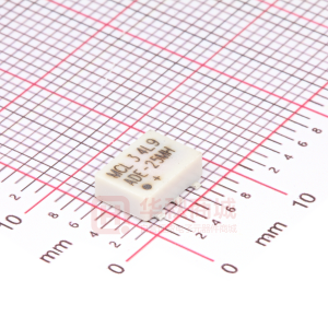

Surface Mount Frequency Mixer Level 13 (LO Power +13 dBm) 10 to 1200 MHz Maximum Ratings Operating Temperature Storage Temperature RF Power IF Current -40°C to 85°C -55°C to 100°C 200mW 40mA ADE-12MH+ ADE-12MH Features • low conversion loss, 6.3 dB typ. • good L-R isolation, 45 dB typ.; L-I isolation, 42 dB typ. • low profile package • aqueous washable • protected by U.S. Patent 6,133,525 CASE STYLE: CD542 PRICE: $6.45 ea. QTY (10-49) + RoHS compliant in accordance with EU Directive (2002/95/EC) The +Suffix identifies RoHS Compliance. See our web site for RoHS Compliance methodologies and qualifications. Pin Connections LO RF IF GROUND 6 3 2 1,4,5 Applications • cellular • VHF/UHF receivers Electrical Specifications FREQUENCY (MHz) LO/RF fL-fU 10-1200 DC-1200 IF — X 6.3 Outline Drawing CONVERSION LOSS (dB) Mid-Band m σ 0.10 Max. 8.0 Total Range Max. 8.5 LO-RF ISOLATION (dB) L Typ. Min. 62 45 M Typ. Min. 45 32 U Typ. Min. 40 26 LO-IF ISOLATION (dB) L Typ. Min. 68 40 M Typ. Min. 42 27 U Typ. Min. 30 20 IP3 at center band (dBm) Typ. 22 1 dB COMP.: +9 dBm typ. L = low range [fL to 10 fL] m= mid band [2fL to fU/2] M = mid range [10 fL to fU/2] U = upper range [fU/2 to fU] Typical Performance Data PCB Land Pattern Frequency (MHz) Conversion Loss (dB) LO LO +13dBm 6.42 6.45 6.41 6.40 6.50 6.48 6.56 6.44 6.49 6.61 6.63 6.78 6.77 7.05 7.74 6.98 6.54 6.37 6.60 6.70 Isolation L-R (dB) LO +13dBm 66.67 65.33 64.50 62.00 58.50 56.16 53.49 51.17 48.50 47.17 45.33 44.67 44.67 45.33 43.17 40.83 40.33 39.50 37.67 37.00 Isolation L-I (dB) LO +13dBm 60.68 59.84 59.34 56.67 54.67 53.17 52.50 55.51 49.00 44.16 39.67 38.33 38.01 37.17 35.66 32.34 30.99 29.83 29.34 29.34 VSWR RF Port (:1) LO +13dBm 1.54 1.52 1.54 1.55 1.52 1.54 1.56 1.56 1.61 1.62 1.65 1.74 1.73 1.77 1.95 2.07 2.10 2.13 2.28 2.41 VSWR LO Port (:1) LO +13dBm 1.59 1.59 1.56 1.52 1.46 1.48 1.50 1.50 1.50 1.49 1.51 1.56 1.54 1.49 1.46 1.45 1.36 1.28 1.12 1.09 RF 10.00 15.00 20.00 40.00 70.00 105.74 150.00 210.97 316.21 421.45 526.68 570.00 600.00 737.16 842.40 947.63 1000.00 1052.87 1170.00 1200.00 Suggested Layout, Tolerance to be within ±.002 Outline Dimensions ( inch ) mm A .272 6.91 H .030 0.76 40.00 45.00 50.00 70.00 100.00 135.74 180.00 240.97 346.21 451.45 556.68 600.00 630.00 767.16 872.40 977.63 1030.00 1082.87 1200.00 1230.00 B .310 7.87 J .026 0.66 C .220 5.59 K .065 1.65 D .100 2.54 L .300 7.62 E .112 2.84 F .055 1.40 G .100 2.54 wt grams 0.20 Demo Board MCL P/N: TB-03 Suggested PCB Layout (PL-052) Electrical Schematic Mini-Circuits ISO 9001 ISO 14001 CERTIFIED RF/IF MICROWAVE COMPONENTS ® minicircuits.com EW ALL N P.O. Box 350166, Brooklyn, New York 11235-0003 (718) 934-4500 Fax (718) 332-4661 For detailed performance specs & shopping online see Mini-Circuits web site The Design Engineers Search Engine Provides ACTUAL Data Instantly From MINI-CIRCUITS At: www.minicircuits.com REV. D M102713 ADE-12MH ED-7607/1 DJ/TD/CP/AM 070412 Page 1 of 2 Performance Charts 9.0 CONVERSION LOSS (dB) 8.0 7.0 6.0 5.0 4.0 3.0 0 200 400 600 800 FREQUENCY (MHz) 1000 1200 at IF Freq of 30 MHz ADE-12MH+ ADE-12MH 70 60 50 40 30 20 0 200 400 600 800 FREQUENCY (MHz) ADE-12MH RF VSWR LO=+10 dBm LO=+13 dBm LO=+16 dBm ADE-12MH CONVERSION LOSS ADE-12MH L-R ISOLATION ISOLATION (dB) LO=+10 dBm LO=+13 dBm LO=+16 dBm LO=+10 dBm LO=+13 dBm LO=+16 dBm 1000 1200 70 ISOLATION (dB) 60 ADE-12MH L-I ISOLATION LO=+10 dBm LO=+13 dBm LO=+16 dBm 4.0 3.5 3.0 VSWR 2.5 2.0 1.5 1.0 50 40 30 20 0 200 400 600 800 FREQUENCY (MHz) ADE-12MH LO VSWR LO=+10 dBm LO=+13 dBm LO=+16 dBm 1000 1200 0 200 400 600 800 FREQUENCY (MHz) ADE-12MH IF VSWR 1000 1200 2.5 VSWR 1.5 1.0 0 200 400 600 800 FREQUENCY (MHz) 1000 1200 VSWR 2.0 3.0 2.8 2.6 2.4 2.2 2.0 1.8 1.6 1.4 1.2 1.0 0 LO=+10 dBm LO=+13 dBm LO=+16 dBm 200 400 600 800 FREQUENCY (MHz) 1000 1200 Mini-Circuits ISO 9001 ISO 14001 CERTIFIED RF/IF MICROWAVE COMPONENTS ® minicircuits.com EW ALL N P.O. Box 350166, Brooklyn, New York 11235-0003 (718) 934-4500 Fax (718) 332-4661 For detailed performance specs & shopping online see Mini-Circuits web site The Design Engineers Search Engine Provides ACTUAL Data Instantly From MINI-CIRCUITS At: www.minicircuits.com Page 2 of 2
