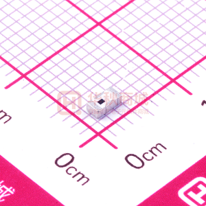

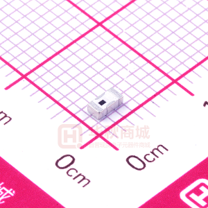

Ceramic High Pass Filter 1700 to 5000 MHz Maximum Ratings Operating Temperature Storage Temperature RF Power Input* -55°C to 100°C -55°C to 100°C 7W max. at 25°C ! NEW HFCN-1320 Features • • • • • low cost small size 7 sections temperature stable excellent power handling, 7W CASE STYLE: FV1206 Model HFCN-1320 HFCN-1320D Price $1.99 $2.49 Qty. (10-49) (10-49) *Passband rating, derate linearly to 3W at 100°C ambient. Applications Pin Connections RF IN RF OUT GROUND ** RF IN & RF OUT can be interchanged 1** 3** 2,4 • sub-harmonic rejection • transmitters/receivers • lab use High Pass Filter Electrical Specifications1 (TAMB=25°C) MODEL NO. STOP BAND (MHz) Min. (loss>40 dB) HFCN-1320 910 (loss>20 dB) 1060 Outline Drawing fco, MHz Nom. (loss 3 dB) Typ. 1320 PASSBAND (MHz) (loss20 >20 >20 5.42 2.08 1.86 1.57 1.41 1.06 1.67 2.61 4.00 6.07 7.83 Outline Dimensions ( inch ) mm A .126 3.20 H .087 2.21 B .063 1.60 J .024 0.61 C .037 0.94 K .122 3.10 D .020 0.51 L .024 0.61 E .032 0.81 M .087 2.21 F .009 0.23 N .012 0.30 G .169 4.29 P wt .071 grams 1.80 .020 Demo Board MCL P/N: TB-270 Suggested PCB Layout (PL-137) HFCN-1320 INSERTION LOSS 100 90 INSERTION LOSS (dB) 80 70 50 40 30 20 10 0 0 1000 2000 3000 4000 5000 6000 7000 FREQUENCY (MHz) 1 0 1000 2000 10 VSWR 60 1000 10000 HFCN-1320 VSWR 100 3000 4000 5000 6000 7000 FREQUENCY (MHz) Mini-Circuits ® INTERNET http://www.minicircuits.com P.O. Box 350166, Brooklyn, New York 11235-0003 (718) 934-4500 Fax (718) 332-4661 Distribution Centers NORTH AMERICA 800-654-7949 • 417-335-5935 • Fax 417-335-5945 • EUROPE 44-1252-832600 • Fax 44-1252-837010 Mini-Circuits ISO 9001 & ISO 14001 Certified NO. OF SECTIONS 7 REV.C M96263 EDR-6437/2 HFCN-1320 RVN/AD/CP 050113
