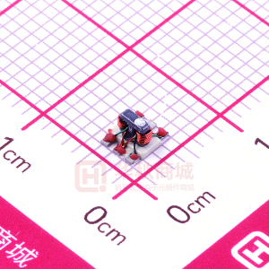

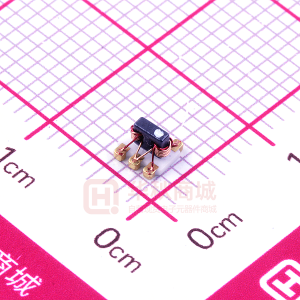

TCD-10-4-75
TCD-10-4-75
    MINI
    TCD-10-4-75 - Directional Coupler 75Ω 5 to 1000 MHz - Mini-Circuits
TCD-10-4-75 数据手册
Directional Coupler 75Ω Maximum Ratings Operating Temperature Storage Temperature -40°C to 85°C -55°C to 100°C Surface Mount TCD-10-4-75+ 5 to 1000 MHz Features • wideband, 5-1000 MHz • excellent flatness, ±0.1 dB typ. • better performance than MA-COM EMDC-10-1-75 • footprint compatible to EMDC-10-1-75 • aqueous washable CASE STYLE: AT224-1 PRICE: $1.49 ea. QTY (25-49) Pin Connections INPUT OUTPUT COUPLED GROUND 75Ω TERM EXTERNAL 3 4 1 2 6 + RoHS compliant in accordance with EU Directive (2002/95/EC) The +Suffix has been added in order to identify RoHS Compliance. See our web site for RoHS Compliance methodologies and qualifications. Applications • CATV Directional Coupler Electrical Specifications FREQ. (MHz) COUPLING (dB) L fL-fU 5-1000 Nom. 9.9±0.5 Flatness ±0.3 Typ. 1.0 Max. 1.5 Typ. 1.1 Outline Drawing MAINLINE LOSS1 (dB) M Max. 1.5 Typ. 1.3 U Max. 1.9 Typ. 22 L Min. 19 DIRECTIVITY (dB) M Typ. 20 Min. 13 Typ. 15 U Min. 11 VSWR POWER (:1) INPUT, W Typ. 1.25 Max. 1.0 L= 5-50 MHz M= 50-500 MHz U= 500-1000 MHz 1. Mainline loss includes theoretical power loss at coupled port. Typical Performance Data PCB Land Pattern Frequency (MHz) Mainline Loss (dB) In-Out 1.06 1.01 1.05 1.08 1.14 1.24 1.31 1.39 1.45 1.51 TCD-10-4-75+ MAINLINE LOSS Coupling (dB) In-Cpl 9.94 9.90 9.93 9.95 9.96 9.92 9.86 9.85 9.82 9.83 Directivity (dB) In 19.73 20.57 20.35 20.17 19.68 19.39 19.74 20.28 22.54 26.00 Return Loss (dB) Out 28.50 35.13 38.95 33.10 25.68 21.07 20.28 19.92 20.29 21.07 Cpl 19.46 20.26 20.20 20.18 20.63 23.17 25.18 25.99 25.37 24.19 5.00 10.00 50.00 100.00 250.00 Suggested Layout, Tolerance to be within ±.002 22.66 22.91 22.54 22.09 20.05 16.74 15.28 14.81 14.88 15.23 Outline Dimensions ( inch ) mm A .150 3.81 G .028 0.71 B .150 3.81 H .065 1.65 C .160 4.06 J .190 4.83 D .050 1.27 K .030 0.76 E .040 1.02 F .025 0.64 MAINLINE LOSS (dB) 500.00 650.00 800.00 900.00 1000.00 TCD-10-4-75+ COUPLING & DIRECTIVITY COUPLING & DIRECTIVITY (dB) 25 20 15 10 5 0 200 400 600 FREQUENCY (MHz) 800 1000 at RF level of -10 dBm 1.60 1.40 1.20 1.00 0.80 at RF level of -10 dBm L wt .007 grams 0.18 0.15 COUPLING DIRECTIVITY Demo Board MCL P/N: TB-72 Suggested PCB Layout (PL-010) 0 200 400 600 800 1000 FREQUENCY (MHz) TCD-10-4-75+ RETURN LOSS 40 RETURN LOSS (dB) 35 30 25 20 15 0 200 400 600 FREQUENCY (MHz) 800 1000 at RF level of -10 dBm Electrical Schematic IN OUT CPL Mini-Circuits TM ® minicircuits.com ISO 9001 ISO 14001 AS 9100 CERTIFIED P.O. Box 350166, Brooklyn, New York 11235-0003 (718) 934-4500 Fax (718) 332-4661 For detailed performance specs & shopping online see Mini-Circuits web site The Design Engineers Search Engine Provides ACTUAL Data Instantly From MINI-CIRCUITS At: www.minicircuits.com IF/RF MICROWAVE COMPONENTS REV. A M119986 ED-12467 TCD-10-4-75+ DY/LC/CP/AM 081113
