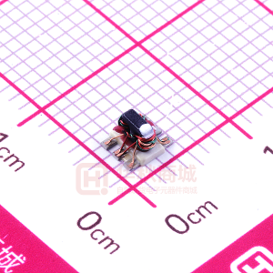

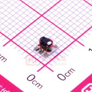

    TCD-20-4 - Directional Coupler 50Ω 5 to 1000 MHz - Mini-Circuits
TCD-20-4 数据手册
Directional Coupler 50Ω Maximum Ratings Operating Temperature Storage Temperature -40°C to 85°C -55°C to 100°C Surface Mount TCD-20-4+ TCD-20-4 5 to 1000 MHz Features • wideband, 5 to 1000 MHz • low mainline loss, 0.4 dB typ. • aqueous washable • leads for excellent solderability • protected by US Patent 6,140,887 CASE STYLE: DB714 PRICE: $1.49 ea. QTY (25) Pin Connections INPUT OUTPUT COUPLED GROUND 50Ω TERM EXTERNAL NOT USED 3 4 1 2 6 5 + RoHS compliant in accordance with EU Directive (2002/95/EC) The +Suffix identifies RoHS Compliance. See our web site for RoHS Compliance methodologies and qualifications. Applications • VHF/UHF • communications • cellular • signal processing Directional Coupler Electrical Specifications FREQ. RANGE (MHz) fL-fU 5-1000 Outline Drawing COUPLING (dB) Nom. 20.0±0.5 Flatness ±0.8 MAINLINE LOSS1 (dB) L Typ. Max. 0.3 0.9 M Typ. Max. 0.4 0.8 U Typ. Max. 0.7 1.1 L Typ. Min. 20 11 DIRECTIVITY (dB) M Typ. Min. 21 15 U Typ. Min. 15 — VSWR POWER (:1) INPUT, W Typ. 1.20 L MU Max. Max. 1.0 1.0 L = low range [fL to 10 fL] M = mid range [10 fL to fU/2] U= upper range [fU/2 to fU] 1. Mainline loss includes theoretical power loss at coupled port. Typical Performance Data PCB Land Pattern Frequency (MHz) Mainline Loss (dB) In-Out 0.34 0.32 0.31 0.31 0.32 0.33 0.37 0.43 0.49 0.62 TCD-20-4 MAINLINE LOSS Coupling (dB) In-Cpl 20.10 20.07 20.06 20.09 20.10 20.10 20.04 19.88 19.70 19.48 Directivity (dB) In 27.09 28.28 29.20 30.62 30.88 31.23 32.86 34.37 34.61 34.14 Return Loss (dB) Out 28.80 30.52 32.01 34.67 35.14 35.70 37.54 31.56 27.04 23.85 Cpl 25.84 26.99 27.84 28.98 29.17 29.43 30.26 31.08 32.38 35.39 Suggested Layout, Tolerance to be within ±.002 5.00 7.00 10.00 50.00 70.00 100.00 300.00 500.00 700.00 1000.00 18.84 20.01 20.88 21.80 21.88 22.10 25.05 36.45 28.77 19.03 Outline Dimensions ( inch ) mm A .160 4.06 G .028 0.71 B .150 3.81 H .065 1.65 C .160 4.06 J .190 4.83 D .050 1.27 K .030 0.76 E .040 1.02 F .025 0.64 MAINLINE LOSS (dB) TCD-20-4 COUPLING & DIRECTIVITY 50 COUPLING & DIRECTIVITY (dB) 40 30 20 10 0 at RF level of -10 dBm wt grams 0.15 1.2 1.0 0.8 0.6 0.4 0.2 0.0 0 at RF level of -10 dBm COUPLING DIRECTIVITY Demo Board MCL P/N: TB-71 Suggested PCB Layout (PL-009) 200 400 600 FREQUENCY (MHz) 800 1000 0 200 400 600 FREQUENCY (MHz) 800 1000 TCD-20-4 RETURN LOSS 60 RETURN LOSS (dB) 50 40 30 20 10 0 200 400 600 FREQUENCY (MHz) 800 1000 at RF level of -10 dBm Electrical Schematic CPL IN OUT Mini-Circuits TM ® minicircuits.com ISO 9001 ISO 14001 AS 9100 CERTIFIED P.O. Box 350166, Brooklyn, New York 11235-0003 (718) 934-4500 Fax (718) 332-4661 For detailed performance specs & shopping online see Mini-Circuits web site The Design Engineers Search Engine Provides ACTUAL Data Instantly From MINI-CIRCUITS At: www.minicircuits.com IF/RF MICROWAVE COMPONENTS REV. F M119986 ED-8564/1 TCD-20-4 WZ/TD/CP/AM 081113
TCD-20-4
1. 物料型号: - 型号为TCD-20-4,这是一个50Ω方向耦合器,表面贴装型。
2. 器件简介: - 该器件工作频段为5至1000MHz,具有宽带特性,低主线损耗(典型值0.4dB),可水洗且具有优良的焊接性,受美国专利6,140,887保护。
3. 引脚分配: - 输入(INPUT):引脚3 - 输出(OUTPUT):引脚4 - 耦合(COUPLED):引脚1 - 地(GROUND):引脚2 - 50欧姆外部终端(50 TERM EXTERNAL):引脚6 - 未使用(NOT USED):引脚5
4. 参数特性: - 工作温度范围:-40°C至85°C - 存储温度范围:-55°C至100°C - 符合RoHS标准,符合欧盟指令2002/95/EC,带有“+”后缀标识RoHS合规性。
5. 功能详解: - 方向耦合器能够在5至1000MHz的频段内工作,具有20dB的耦合度,0.4dB的主线损耗,以及高方向性。
6. 应用信息: - 应用于VHF/UHF通信、蜂窝通信和信号处理等领域。
7. 封装信息: - 封装风格为DB714,单价为1.49美元每个,25个起售。 - 提供外形图和PCB布线图,建议布局公差在±0.002英寸以内。
