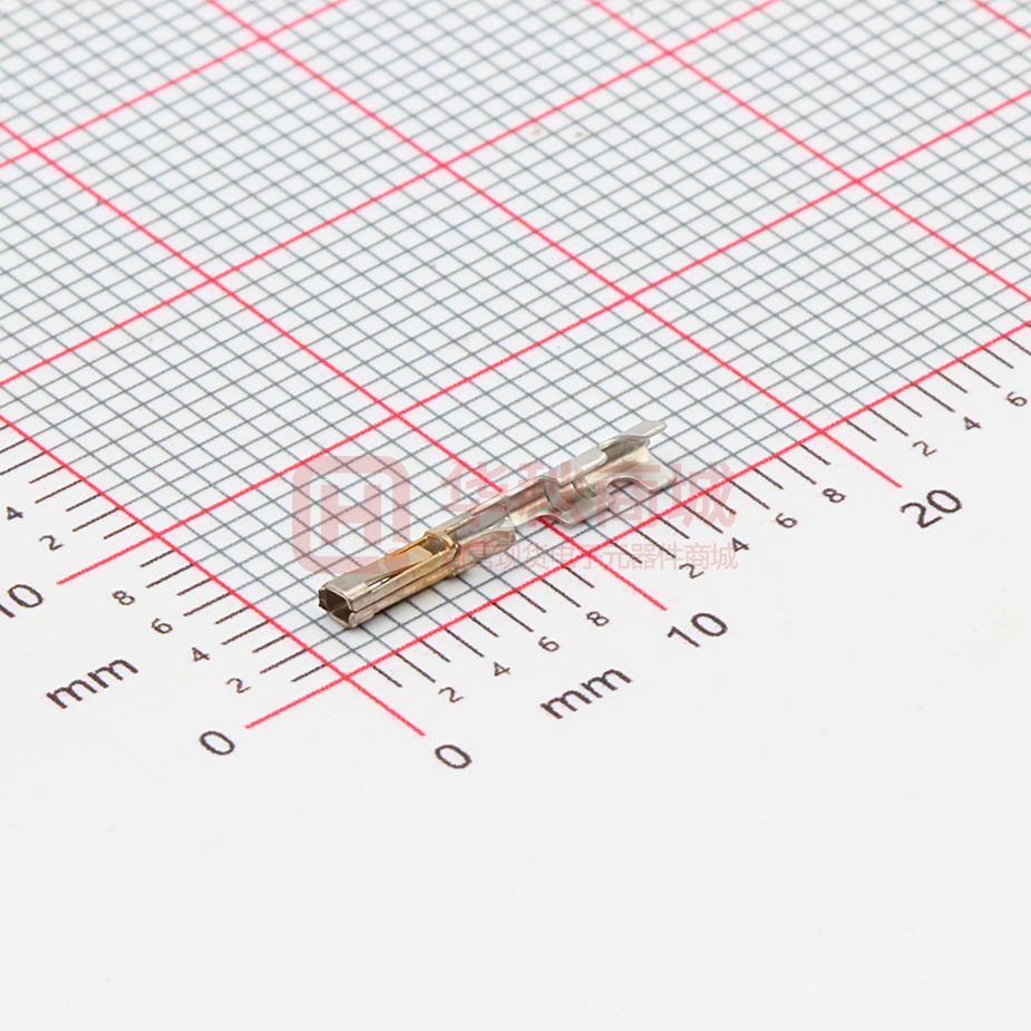

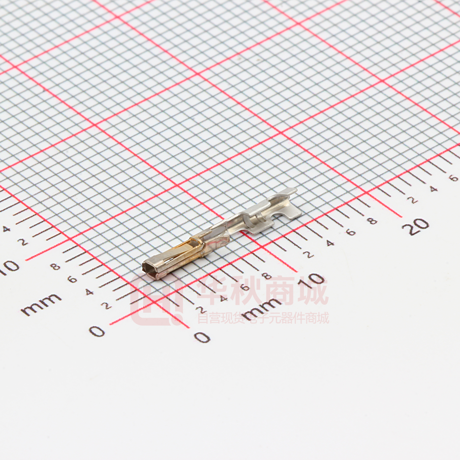

10 9 7 8 6 5 1.32 E 1.52 3 2 1 NOTES: 1. MATERIAL: PHOSPHOR BRONZE 2. PLATING: 124 = SELECT BRIGHT TIN: 3.75 MICROMETERS MIN OVER NICKEL P124 = PREPLATED BRIGHT TIN: 3.75 MICROMETERS MIN OVER MATTE NICKEL (BARE EDGES) 207 = SELECT HARD GOLD: 0.38 MICROMETERS MIN. SELECT TIN: 2.0 MICROMETERS MIN BOTH OVER NICKEL 206 = SELECT HARD GOLD: 0.75 MICROMETERS MIN. SELECT TIN: 2.0 MICROMETERS MIN BOTH OVER NICKEL 3. PRODUCT SPECIFICATION: TERMINALS CONFORM TO PS-70058 AND PS-70400 WHEN CRIMPED WITH MOLEX CRIMP TOOLS. 4. COSMETIC SPECIFICATION: PS-45499-002 CLASS B 5. TERMINAL FOR USE WITH HOUSING SERIES 70066 AND 70450 6. WIRE SPECIFICATION: TERMINALS STAMPED WITH THE LETTER: A = ACCEPTS 24-30 AWG STRANDED WIRE WITH A 1.52 MAX INSULATION DIA 7. SEE 700580000-SD FOR THIS PART WITH SINGLE NUMBER SYSTEM 12.88 F 4 2.18 ±0.10 0.08 MAX F E CARRIER CUTOFF D D TERMINALS STAMPED WITH THE LETTER "A" ACCEPT 24-30 AWG WIRE WITH A 1.52 MAX INSULATION DIA. TERMINALS ON THIS SHEET ARE FOR USE WITH 24-30 AWG WIRE. SEE SHEETS 2 AND 3 FOR OTHER WIRE SIZES C C PART NUMBER / ENGINEERING NO B A 16-02-0069 70058-0004 16-02-0096 70058-0204 16-02-0082 70058-0006 16-02-0097 70058-0206 16-02-0083 70058-0008 16-02-0098 70058-0208 DOCUMENT STATUS FORMAT: master-tb-prod-B REVISION: J DATE: 2020/01/14 PACKAGING REEL LOOSE WIRE SIZE PLATING SEE NOTE 2 MAX INSULATION DIA 124 SELECT TIN B (24-30 AWG WIRE) THIS DRAWING CONTAINS INFORMATION THAT IS PROPRIETARY TO MOLEX ELECTRONIC TECHNOLOGIES, LLC AND SHOULD NOT BE USED WITHOUT WRITTEN PERMISSION REEL LOOSE REEL LOOSE P1 RELEASE DATE 9 207 0.38 GOLD 24-30 AWG 1.52 DIA MAX SCALE mm 8:1 ANGULAR TOL ± 4 PLACES ± 3 PLACES ± 2 PLACES ± ° 0.15 1 PLACE ± 0.25 0 PLACES ± 0.0 DRAFT WHERE APPLICABLE MUST REMAIN WITHIN DIMENSIONS 11:14:02 8 7 CURRENT REV DESC: OBSOLETED PART NUMBER AS PER PCN#508517 GENERAL TOLERANCES (UNLESS SPECIFIED) 206 0.75 GOLD 2021/06/29 DIMENSION UNITS 6 5 4 SL CRIMP TERMINAL EC NO: 667105 DRWN: SUGEEB CHK'D: GGA APPR: GGA INITIAL REVISION: DRWN: KSAMIEC APPR: FSMITH THIRD ANGLE PROJECTION 3 2021/05/27 2021/06/29 2021/06/29 PRODUCT CUSTOMER DRAWING DOC TYPE DOC PART REVISION DOCUMENT NUMBER 2018/07/23 2018/08/27 DRAWING SERIES B-SIZE 70058 700580001-SD MATERIAL NUMBER SEE TABLE 2 PSD 000 CUSTOMER GENERAL MARKET B1 SHEET NUMBER 1 OF 4 1 A 10 9 7 8 6 5 1.32 E 1.52 3 2 1 NOTES: 1. MATERIAL: PHOSPHOR BRONZE 2. PLATING: 207 = SELECT HARD GOLD: 0.38 MICROMETERS MIN. SELECT TIN: 2.0 MICROMETERS MIN BOTH OVER NICKEL 206 = SELECT HARD GOLD: 0.75 MICROMETERS MIN. SELECT TIN: 2.0 MICROMETERS MIN BOTH OVER NICKEL 3. PRODUCT SPECIFICATION: TERMINALS CONFORM TO PS-70058 AND PS-70400 WHEN CRIMPED WITH MOLEX CRIMP TOOLS. 4. COSMETIC SPECIFICATION: PS-45499-002 CLASS B 5. TERMINAL FOR USE WITH HOUSING SERIES 70066 AND 70450 6. WIRE SPECIFICATION: TERMINALS STAMPED WITH THE LETTER: B = ACCEPTS 32-36 AWG STRANDED WIRE WITH A 0.64 MAX INSULATION DIA. 12.88 F 4 2.18 ±0.10 F E 0.08 MAX CARRIER CUTOFF B D D TERMINALS STAMPED WITH THE LETTER "B" ACCEPT 32-36 AWG WIRE WITH A 0.64 MAX INSULATION DIA TERMINALS ON THIS SHEET ARE FOR USE WITH 32-36 AWG WIRE. SEE SHEETS 1 AND 3 FOR OTHER WIRE SIZES C B PART NUMBER / PACKAGING ENGINEERING NO WIRE SIZE PLATING SEE NOTE 2 MAX INSULATION DIA C B (32-36 AWG WIRE) THIS DRAWING CONTAINS INFORMATION THAT IS PROPRIETARY TO MOLEX ELECTRONIC TECHNOLOGIES, LLC AND SHOULD NOT BE USED WITHOUT WRITTEN PERMISSION 16-02-0074 70058-0015 A REEL FORMAT: master-tb-prod-B REVISION: J DATE: 2020/01/14 REEL LOOSE P1 RELEASE DATE 9 0.64 DIA MAX 206 0.75 GOLD 2021/06/29 SCALE mm 8:1 CURRENT REV DESC: OBSOLETED PART NUMBER AS PER PCN#508517 GENERAL TOLERANCES (UNLESS SPECIFIED) 32-36 16-02-0085 70058-0017 16-02-0101 70058-0217 DOCUMENT STATUS 207 0.38 GOLD DIMENSION UNITS ANGULAR TOL ± 4 PLACES ± 3 PLACES ± 2 PLACES ± ° 0.15 1 PLACE ± 0.25 0 PLACES ± 0.0 DRAFT WHERE APPLICABLE MUST REMAIN WITHIN DIMENSIONS 11:14:02 8 7 6 5 4 SL CRIMP TERMINAL EC NO: 667105 DRWN: SUGEEB CHK'D: GGA APPR: GGA INITIAL REVISION: DRWN: KSAMIEC APPR: FSMITH THIRD ANGLE PROJECTION 3 2021/05/27 2021/06/29 2021/06/29 PRODUCT CUSTOMER DRAWING DOC TYPE DOC PART REVISION DOCUMENT NUMBER 2018/07/23 2018/08/27 DRAWING SERIES B-SIZE 70058 700580001-SD MATERIAL NUMBER SEE TABLE 2 PSD 000 CUSTOMER GENERAL MARKET B1 SHEET NUMBER 2 OF 4 1 A 10 9 7 8 6 5 1.32 E 1.52 3 2 1 NOTES: 1. MATERIAL: PHOSPHOR BRONZE 2. PLATING: 124 = SELECT BRIGHT TIN: 3.75 MICROMETERS MIN OVER NICKEL P124 = PREPLATED BRIGHT TIN: 3.75 MICROMETERS MIN OVER MATTE NICKEL (BARE EDGES) 207 = SELECT HARD GOLD: 0.38 MICROMETERS MIN. SELECT TIN: 2.0 MICROMETERS MIN BOTH OVER NICKEL 206 = SELECT HARD GOLD: 0.75 MICROMETERS MIN. SELECT TIN: 2.0 MICROMETERS MIN BOTH OVER NICKEL 3. PRODUCT SPECIFICATION: TERMINALS CONFORM TO PS-70058 AND PS-70400 WHEN CRIMPED WITH MOLEX CRIMP TOOLS. 4. COSMETIC SPECIFICATION: PS-45499-002 CLASS B 5. TERMINAL FOR USE WITH HOUSING SERIES 70066 AND 70450 6. WIRE SPECIFICATION: TERMINALS STAMPED WITH THE LETTER: C = ACCEPTS 22-24 AWG STRANDED WIRE WITH A 1.63 MAX INSULATION DIA 12.88 F 4 2.18 ±0.10 F E 0.08 MAX C CARRIER CUTOFF D D TERMINALS STAMPED WITH THE LETTER "C" ACCEPT 22-24 AWG WIRE WITH A 1.63 MAX INSULATION DIA C PART NUMBER / ENGINEERING NO: 16-02-0086 70058-0022 16-02-0102 70058-0222 B A 70058-4086 16-02-0087 70058-0024 16-02-0103 70058-0224 16-02-0088 70058-0026 16-02-0104 70058-0226 DOCUMENT STATUS FORMAT: master-tb-prod-B REVISION: J DATE: 2020/01/14 P1 PACKAGING REEL LOOSE REEL REEL LOOSE REEL LOOSE RELEASE DATE 9 WIRE SIZE PLATING SEE NOTE 2 C TERMINALS ON THIS SHEET ARE FOR USE WITH 22-24 AWG WIRE. SEE SHEETS 1 AND 2 FOR OTHER WIRE SIZES MAX INSULATION DIA 124 SELECT TIN 124 OVERALL TIN B (22-24 AWG WIRE) 22-24 AWG THIS DRAWING CONTAINS INFORMATION THAT IS PROPRIETARY TO MOLEX ELECTRONIC TECHNOLOGIES, LLC AND SHOULD NOT BE USED WITHOUT WRITTEN PERMISSION 1.63 DIA MAX 207 0.38 GOLD SCALE mm 8:1 CURRENT REV DESC: OBSOLETED PART NUMBER AS PER PCN#508517 GENERAL TOLERANCES (UNLESS SPECIFIED) 206 0.75 GOLD 2021/06/29 DIMENSION UNITS ANGULAR TOL ± 4 PLACES ± 3 PLACES ± 2 PLACES ± ° 0.15 1 PLACE ± 0.25 0 PLACES ± 0.0 DRAFT WHERE APPLICABLE MUST REMAIN WITHIN DIMENSIONS 11:14:02 8 7 6 5 4 SL CRIMP TERMINAL EC NO: 667105 DRWN: SUGEEB CHK'D: GGA APPR: GGA INITIAL REVISION: DRWN: KSAMIEC APPR: FSMITH THIRD ANGLE PROJECTION 3 2021/05/27 2021/06/29 2021/06/29 PRODUCT CUSTOMER DRAWING DOC TYPE DOC PART REVISION DOCUMENT NUMBER 2018/07/23 2018/08/27 DRAWING SERIES B-SIZE 70058 700580001-SD MATERIAL NUMBER SEE TABLE 2 PSD 000 CUSTOMER GENERAL MARKET B1 SHEET NUMBER 3 OF 4 1 A 10 9 8 7 6 5 4 3 LOOSE PACKED F 2 1 REEL PACKED WHEN TERMINALS ARE FULLY INSERTED INTO THE HOUSINGS. F PARTS PER BAG: 10,000 BAGS PER BOX: 2 PARTS PER BOX: 20,000 THE TERMINAL'S LOCKING TANG SHOULD BE VISABLE IN THE HOUSING'S WINDOWS A UNWINDING DIRECT TO CRIMP MACHINE E E PARTS PER REEL: 20,000 REELS PER BOX: 3 PARTS PER BOX: 60,000 D D A HOUSING WINDOWS C C TERMINAL LOCKING TANGS B B SECTION A-A THIS DRAWING CONTAINS INFORMATION THAT IS PROPRIETARY TO MOLEX ELECTRONIC TECHNOLOGIES, LLC AND SHOULD NOT BE USED WITHOUT WRITTEN PERMISSION A FORMAT: master-tb-prod-B REVISION: J DATE: 2020/01/14 P1 RELEASE DATE 9 2021/06/29 SCALE mm 1:15 ANGULAR TOL ± 4 PLACES ± 3 PLACES ± 2 PLACES ± ° 0.15 1 PLACE ± 0.25 0 PLACES ± 0.0 DRAFT WHERE APPLICABLE MUST REMAIN WITHIN DIMENSIONS 11:14:02 8 7 6 CURRENT REV DESC: OBSOLETED PART NUMBER AS PER PCN#508517 GENERAL TOLERANCES (UNLESS SPECIFIED) CRIMPED TERMINALS SHOULD BE INSERTED INTO THE HOUSING IN THIS DIRECTION WITH THE LOCKING TANGS FACING UP TOWARD THE HOUSING WINDOWS DOCUMENT STATUS DIMENSION UNITS 5 4 SL CRIMP TERMINAL EC NO: 667105 DRWN: SUGEEB CHK'D: GGA APPR: GGA INITIAL REVISION: DRWN: KSAMIEC APPR: FSMITH THIRD ANGLE PROJECTION 3 2021/05/27 2021/06/29 2021/06/29 PRODUCT CUSTOMER DRAWING DOC TYPE DOC PART REVISION DOCUMENT NUMBER 2018/07/23 2018/08/27 DRAWING SERIES B-SIZE 70058 700580001-SD MATERIAL NUMBER SEE TABLE 2 PSD 000 CUSTOMER GENERAL MARKET B1 SHEET NUMBER 4 OF 4 1 A

1. 物料型号:文档列出了多个型号,例如16-02-0069 70058-0004、16-02-0096 70058-0204等,它们都与不同的封装和电镀类型相关联。 2. 器件简介:文档提到了这些器件是用于不同线规的电线,如24-30 AWG、32-36 AWG和22-24 AWG。 3. 引脚分配:文档中没有明确提到引脚分配,但提到了不同型号的端子适用于不同线规的电线。 4. 参数特性:文档提供了一些尺寸参数,例如最大绝缘直径为1.52mm、0.64mm和1.63mm。 5. 功能详解:文档详细说明了端子的功能,包括它们接受的电线规格和电镀类型,如选择性亮锡、硬金电镀等。 6. 应用信息:端子适用于Housing系列70066和70450,并且当使用Molex压接工具压接时,端子符合PS-70058和PS-70400的产品规格。 7. 封装信息:文档提到了不同的封装类型,如REEL(卷装)和LOOSE(散装)。
