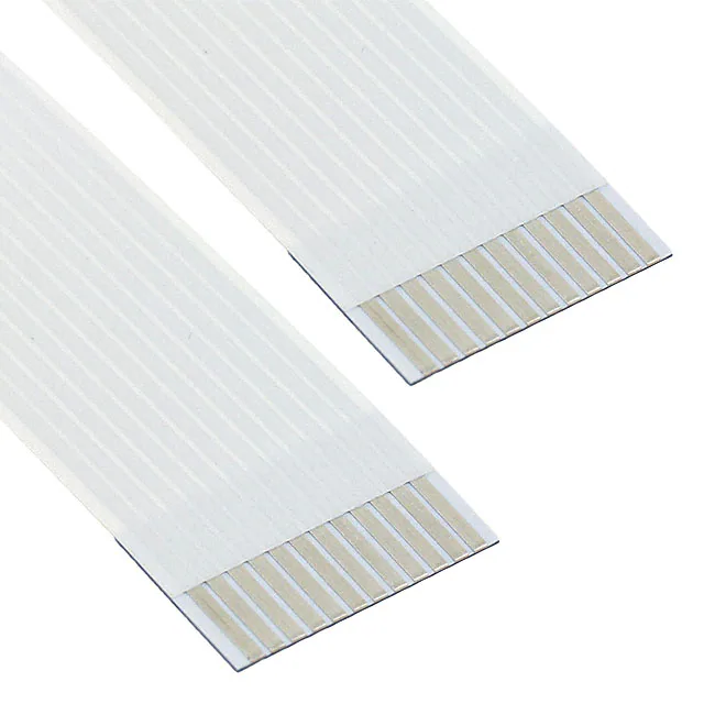

Premo-Flex™ FFC jumpers, available in a variety of pitches, cable lengths and thicknesses, plus high-temperature ratings up to +105°C, deliver durable, ultra flexible, low-cost solutions for PCB connections in virtually any industry The complete line of 0.50, 1.00 and 1.25mm pitch flat flex cable (FFC) jumpers offers standard lengths, pitches and circuit sizes to accommodate a wide range of flexible interconnect requirements between two PC boards. Standard, off-the-shelf FFC cable jumpers reduce lead-times and tooling costs to the customer. In addition, Molex can also accommodate custom requirements for FFC cable jumpers in lengths of over 305mm, with prototype lead-times of around 1 week. The flat flex jumpers are terminated to Zero Insertion Force (ZIF), non-ZIF or Low Insertion Force (LIF) FFC connectors, available from Molex. Premo-Flex standard flat flex jumpers are now available in extra flexible 0.12mm cable, ideal for complex board-toboard interconnections in confined spaces. Molex offers an extensive range of FFC connectors and is able to design customized FFC connectors to customer requirements. Type A (same-side) and Type D (opposite-side) contact layouts allow for mirrored contacts in top- and bottom-mount ZIF applications. For additional information visit: www.molex.com/product/premoflex_ffc-fpc.html FEATURES AND BENEFITS • Available in numerous circuit sizes (4 to 60) and custom lengths • Provides limitless design-in options • Contact area can be configured on the same or opposite sides of the flexible cable jumper • Cable mirrors signal layout between PCBs • Rated up to +105°C • Meets industry-standard requirements • Simple assembly process • Ideal for electrical connections between PCBs, display boards, etc. • Various cable termination thicknesses • Meets industry-standard ZIF connector requirements • Ease-of-assembly in hard-to-reach applications • Polyester insulation • Meets Registration Evaluation, Authorization and Restriction of Chemicals (REACH) requirements • Extra flexible 0.12mm cable option • Extends life of cable: 900,000 cycles vs. standard jumper flex life of 6,000 cycles Premo-Flex™ Flat Flex Cable Jumpers Cable Thickness 0.12mm 15166 Tin, 0.50mm Pitch, 105°C 15167 Tin, 1.00mm Pitch, 105°C 15168 Tin, 1.25mm Pitch, 105°C Cable Thickness 0.22mm 98266 Tin, 0.50mm Pitch, 105°C 98267 Tin, 1.00mm Pitch, 105°C 98268 Tin, 1.25mm Pitch, 105°C Cable Thickness 0.27mm 15266 Tin, 0.50mm Pitch, 105°C 15267 Tin, 1.00mm Pitch, 105°C 15268 Tin, 1.25mm Pitch, 105°C 15020 Gold, 0.50mm Pitch, 105°C 15039 Gold, 1.00mm Pitch, 105°C 15049 Gold, 1.25mm Pitch, 105°C Premo-Flex™ Flat Flex Jumpers MARKETS AND APPLICATIONS • Automotive - Radio, CD, DVD, GPS device - LCD display - Keyboard - Moveable units • • • • Industrial Medical Equipment Military Home Appliance - Control Panels • Consumer - Set top box - Camcorder - Plasma display • Computer - Notebook - Printer - Scanner - Keyboard - LCD flat panel Automotive Electronics Surgery Lamp SPECIFICATIONS Electrical Voltage (max.): 60V Current (max.): 0.50mm Pitch — 0.5A 1.00mm Pitch — 1.2A 1.25mm Pitch — 1.4A Conductor Resistance: 730 ohms per km. max. Insulation Resistance: 10 Megohms per km. min. Dielectric Test: 200V AC for 1 minute, no disrupted discharge Reference Information Packaging: Box UL Style No: 20706 (copper wire) Flame Resistance: UL 758 VW-1 RoHS: Yes Halogen Free: Yes Physical Temperature Rating: -40 to +105°C Heat Resistance: 168 hours at +136°C Moisture Resistance: 96 hours at +60°C, 95% Relative Humidity (RH) Folding: Specimen to be folded manually at +180° over a 4.00mm (.157") radius, min. 20 cycles Premo-Flex™ Flat Flex Cable Jumpers Cable Thickness 0.12mm 15166 Tin, 0.50mm Pitch, 105°C 15167 Tin, 1.00mm Pitch, 105°C 15168 Tin, 1.25mm Pitch, 105°C Cable Thickness 0.22mm 98266 Tin, 0.50mm Pitch, 105°C 98267 Tin, 1.00mm Pitch, 105°C 98268 Tin, 1.25mm Pitch, 105°C Cable Thickness 0.27mm 15266 Tin, 0.50mm Pitch, 105°C 15267 Tin, 1.00mm Pitch, 105°C 15268 Tin, 1.25mm Pitch, 105°C 15020 Gold, 0.50mm Pitch, 105°C 15039 Gold, 1.00mm Pitch, 105°C 15049 Gold, 1.25mm Pitch, 105°C Control Panels ORDERING INFORMATION Series No. Plating Material Cable Thickness mm Flex Life Cycles Pitch mm Temp Rating Max. °C Circuits Contact Layout Type Cable Lengths Minimum Order Quantity 0.50 15166-XXXX 15167-XXXX 0.12 2.5M 1.00 15168-XXXX 1.25 98266-XXXX 0.50 6 to 60 105 98267-XXXX Tin 0.22 100K 6 to 50 1.00 Standard lengths 30 up to 305mm 4 to 50 98268-XXXX 1.25 15266-XXXX 0.50 15267-XXXX 1.00 15268-XXXX 1.25 1000 A or D Custom lengths available over 305mm 4 to 50 .27 15020-XXXX 15039-XXXX 10K 105 0.50 Gold 6 to 50 1.00 4 to 50 15049-XXXX 1.25 www.molex.com/product/premoflex_ffc-fpc.html Order No. 987650-6631 Rev. 1 Printed in EUR/GF/2015.05 ©2015, Molex
